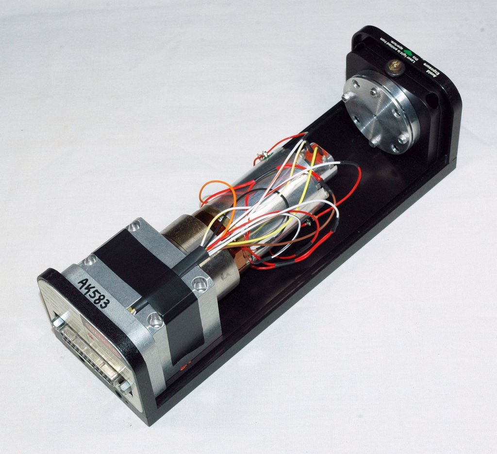

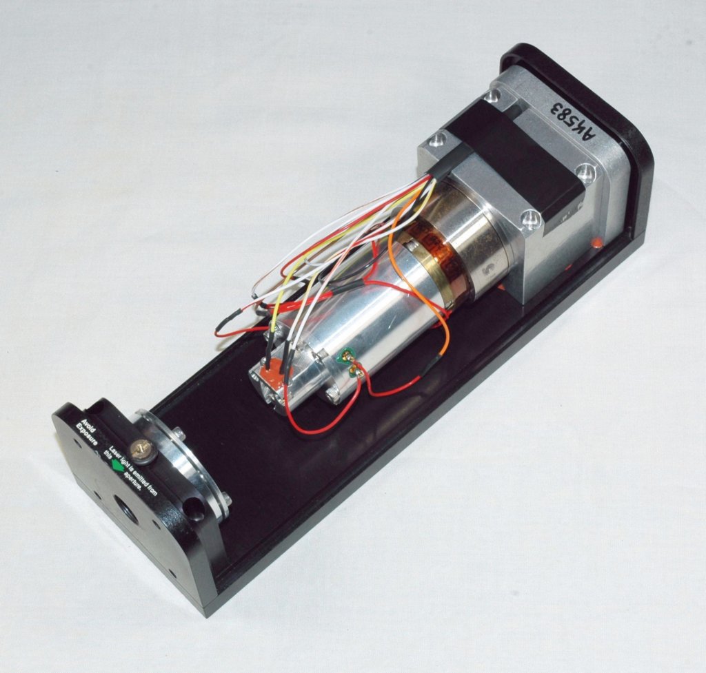

Laser Head Right Back Interior View. Getting inside requires carefully prying off the nameplate, removing 4 in the back, 4 screws underneath, and another captive screw underneath to permit the shutter post to be lowered so the cover clears it. There is a rubber O-ring to mostly seal the head all around (long since removed).
