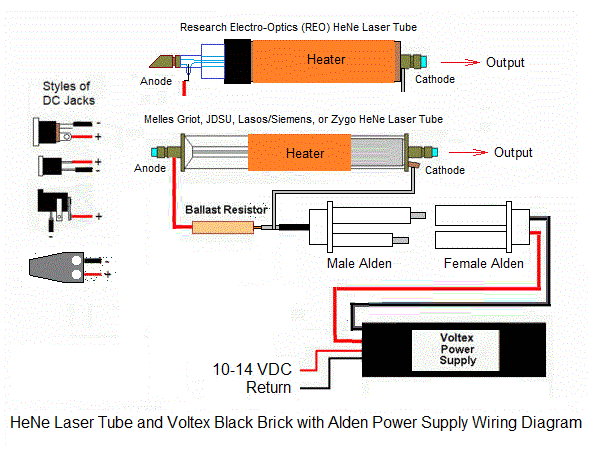

Power and wiring:
Power supplies are required for the laser tube, heater, and the Arduino (when not connected to USB). These can all run off the pair of 12 VDC or 15 VDc power packs / wall adapters included:

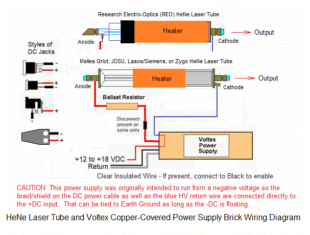

Summary for Voltex copper-covered brick ONLY:
NONE OF THESE BRICKS ARE AUTOSWITCHING! POWERING THE BRICK WITH THE WRONG WIRING CAN DESTROY IT ISNTANTLY.
But here are the guidelines:
In most cases, I will have labeled the wires and/or tied together wires as appropriate. But if at all in doubt, contact me before doing something you may regret.
CAUTION: DO NOT power the Nano from both a line-powered computer's USB and a power supply. This may include a laptop using its AC power pack. In my experience, bad things happen, like the CPU or USB chip on the Nano board dying. See the info in the µSLC1 manual.
Hooking up power to the tube correctly is critical to its survival and life. This is extermely important since the laser tube is the most expensive part of the kit by far.
This shows tubes with the output from the cathode-end. Most of the kits will be this way but double check to be sure. The output comes from the end of the tube with a blue-ish AR-coating on the mirror. HOWEVER, THE CONNECTIONS MUST BE AS SHOWN: The positive (red) wire and ballast goes to the glass-end of the tube (usually the mirror mount stem or a pin fused into the side of the glass tube). The negative (black) wire goes to the cathode which may be an aluminum can (all but REO and Zygo), shiny coating on the glass (Zygo), or all metal (REO). Otherwise, the tube may be destroyed quickly even if the laser appears to work.
Make sure the anode-end of the tube and the connection to it are well insulated and cannot arc to anything. Keeping anything conductive (including stupid humans) at least an inch away should be adequate. Or it can be protected inside an insulated housing. During starting, there may be up to 10 kV there and any leakage or arcing will prevent starting and may destroy the power supply. And accidentally touching it, while not dangerous, will be unpleasent and may cause you to toss the entire thing across the room, which is bad form at the very least. ;-(

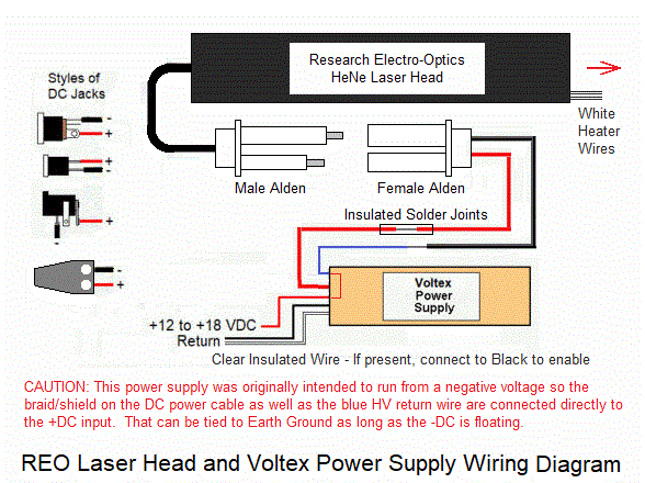

For the REO tube ONLY, the anode connection is to the pin sticking out of the side of the glass, NOT the HR mirror stem. There may be a 1M ohm resistor between it and the mirror stem to aid in starting. The mirror stem itself can be Used instead of the pin and will actually result in slighlty more output power but may reduce tube life slightly. How much is not known.
The power supply should have a ballast resistor already attached to it along with a suitable connector for the tube anode. If not, contact me before proceeding. The exception for the REO tube enclosed in an aluminum cylinder where the ballast is inside.
It is essential that the wiring to the HeNe laser tube have the correct polarity as noted above. Reverse polarity may ruin the tube in a few minutes even though it may appear to light up and lase normally. The tube is the most expensive part of this kit by far. For all but the REO tubes, the end that has the thick glass capillary is the anode, positive, fat red wire, and ballast resistors. The end of the tube with the aluminum can or shiny coating is the cathode, negative, fat black wire or blue wire of the power supply brick. (Where the brick has multiple black wires, they are probably connected internally.)
WARNING: There may be over 2,000 V present while running and over 10,000 V at startup on the anode mirror mount of the tube! Stay clear! There will be a significant charge remaining for a while after shutting off power. Touching the anode probably won't kill you but throwing the tube across the room as a result of a reflex reaction is bad form and may upset your thesis advisor.
The laser head has the tube wired internally with a ballast resistor and a cable with a white "Alden" high voltage male connector. For kits shipped with the head, a mating female Alden connector and short cable will be provided. The required heater is also pre-installed inside the cylinder with a pair of thin white wires exiting from the front of the head cylinder. A loose-fitting end-cap is included to cover the front of the head while permitting the white wires to exit. It can be taped in place or some tape can be wrapped around the perimeter so it fits snugly.

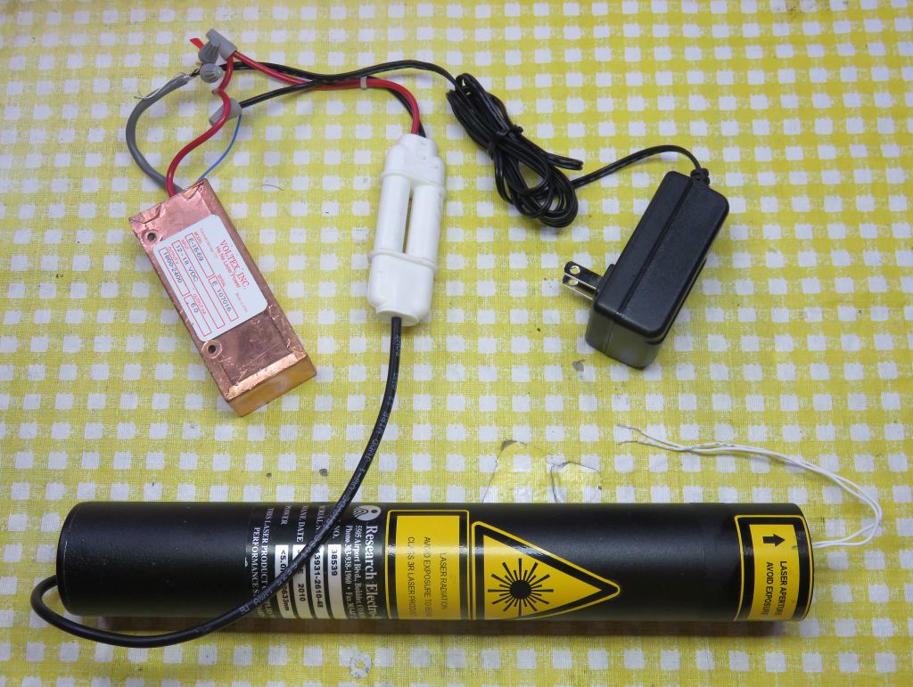

The wiring may be connected with "Wire Nuts" for testing as shown in the right-hand graphic, but proper permanent wiring - preferably soldered - should be done at least for the connection between the fat red wires on the power supply and Alden, along with high voltage insulation consisting of several layers of electrical tape or similar.
CAUTION: For the Voltex brick specifically, DO NOT connect the negatives of the DC adapters together or cheat and use a single higher current power supply for both HeNe and heater power - that will result in smoke or damage to the adapter(s). But it should be possible to tie the positive of the Voltex brick to system negative and Earth ground. Confirm that the red and black power wires of the Voltex brick are not shorted before powering. Please contact me if this isn't crystal clear.
Make sure all connections are secure before applying power. Solder is recommended as noted above, but ues of "wire nuts" is acceptable, in which case the one for the high voltage should be further insulated with electrical tape.
The tube should light within a few seconds of applying DC power to the brick. The output power from the laser tube may start relatively low (llke 2.0 mW) and climb to between 2.5 mW and 3 mW or more. (This modest increase probably won't even be obvious using only Mark I eyeballs.) The beam should be on continuously with no pulsing, flickering, or sputtering. If not, double check connections and DC power. If it continues to misbehave, contact me. Once the operation of the tube has been confirmed, power down and discharge the power supply and tube capacitance by shorting between the two ends of a tube with a pair of clip leads, touching the negative FIRST to avoid a shocking experience.
