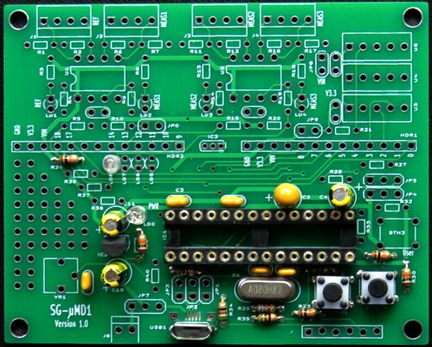

SG-µMD1 PCB Layout Version 1.0
Refer to the SG-µMD1 board layout below.
SG-µMD1 V1.0 PCB Layout Diagram (Left) and MPLAB Version Populated PCB (Right)
In essense, most parts below the headers (mid-board) are required to run the PIC32 and for it to communcate with the MPLAB programmer.

  2. ( ) Install the USB Micro B connector on the top of the PCB. First solder the through-hole tabs. Confirm that the connector is flush on the board before soldering the pins. The tabs and pins may not quite poke through the PCB so assure that solder actually flows down inside the holes and reaches them. Take care to avoid solder bridges between the very closely spaced pins.
    Note that the through-hole USB connector is installed at a right angle to the PCB. If you would prefer one that is parallel to the PCB and are comfortable soldering an SMD connector with legs that are only 1.3 mm apart and barely accessible even with a narrow-tip soldering iron, they are readily available from electronics distributors or eBay and should be compatible with the PCB layout pattern. Or if you can locate a through-hole connector that installs flat on the PCB, contact me via the email links at the top of this page. :)
  3. ( ) Install a jumper wire between the two right-most pads of JP7 (near the USB connector). For µMD1 there should never really be any need so use external power.
  4. ( ) Install IC2 (MCP1703T, TO92). It should stand off from the PCB by 1/8th inch or so. Make sure the outline matches
  5. ( ) Install C10,C11 (4.7 uF). Note polarity: Positive is marked on the PCB and is also the square pad. Negative on the capacitor is marked by a line.
  6. ( ) Install LD0 (3 mm LED). The anode is the longer lead and the square pad on the PCB. The cathode is the shorter lead and the flat on the body of the LED. Cut the leads about 1/10" from the body if the LED can't be inserted to sit flush on the PCB. Take care not to overheat or stress the leads on the LED when soldering.
  7. ( ) Install R26 (10K ohms).
  8. ( ) Smoke test #1: Plug the board into a live USB A socket or charger via the included USB A to USB Micro B cable. LD0 (Power) should come on immediately. If a DMM is available confirm that the voltage measured across pins 28 and 27 of IC1 is between 3.2 V and 3.4 V. Unplug. And, uh, nothing should smoke. ;-)
  9. ( ) Install R22,R34,R35 (51 ohms).
  10. ( ) Install R24 (200 ohms).
  11. ( ) Install R25 (680 ohms).
  12. ( ) Install R23,R30,R31 (10K ohms).
  13. ( ) Install R4,R9 (150 ohms).
  14. ( ) Install R5,R10 (330 ohms).
  15. ( ) Install C6,C7 (33 pF). These may not be labeled on the silk-screen. They are adjacent to pins 8,9 and 10,11 of IC1.
    Note: The 33 pF and 0.1 µF capacitors may appear identical. Inspect their marking to identify them.
  16. ( ) Install C3,C8,C9 (0.1 µF). Some of these may not be labeled on the silk-screen. 0.1x0.2 inch parts having rounded ends without part numbers are 0.1 µF caps. They are near VR1, and pins 23,24 and 27,28 of IC1.
  17. ( ) Install C4 (4.7 µF). Note polarity: Positive is marked on the PCB and is also the square pad. Negative on the capacitor is the line.
  18. ( ) Install C5 (10 µF or 22 µF tantalum capacitor, yellow gum drop.) Pay particular attention to the polarity. These tend to explode eventually if installed backwards. The labeling should face away from the PIC32 socket.
  19. ( ) Install LD8 (3 mm LED) and R39 (10K). The anode on the LEDs is the longer lead and the square pad on the PCB. The cathode is the shorter lead and the flat on the body of the LED. Take care not to overheat or stress the leads on the LED(s) when soldering.
  20. ( ) Install BTN1,BTN2 (pushbuttons). Press in place flush against the PCB. Solder all 4 pins on each.
  21. ( ) Install SKT1 (28 pin SDIP socket). The cutout on the socket should match the cutout on the PCB. First solder two diagonal corner pins and confirm the socket is flush against the PCB. Then solder the rest.
  22. ( ) Install X1 (8 MHz crystal in sardine can).
  23. ( ) Carefully inspect for unsoldered pins, solder bridges and other blemishes. Correct as needed. THIS IS ESSENTIAL! It would be bad form to blow the PIC32 due to an errant blob of solder. :(
  24. ( ) Install 6 pin socket strip or right angle header at JP6.
  25. ( ) Carefully plug in the PIC32 confirming that all pins are seated and none are bent. The dot or cutout on the chip should match the PCB labeling.
  26. ( ) Smoke test #2. :) Plug the board into a USB A socket on your PC or laptop or charger using the included cable. The power LED should come on. And no smoke. :)
  27. ( ) If the PIC32 has the bootloader installed, Press Reset (BTN1) and hold it while also pressing Program (BTN2). Release Reset and then release Program. LED1 (LD8) should be flashing rapidly indicating that the board is salivating in anticipation of having new and improved firmware uploaded to it. ;-) This confirms that the button circuitry is functional. There should be no actual need to load firmware as the latest version for µMD1 will have been pre-installed so press Reset to exit boot mode. Remove the USB cable.
    If nothing happens even after multiple attempts, the PIC32 isn't running for any number of reasons, or the bootloader is not present (as would be the case if the PIC32 were ordered from an electronics distributor). In that case go to the next step.
  28. ( ) Follow instructions for using MPLAB to download the bootloader. For this, the PCB must be powered from external 5 VDC or USB, NOT the programming header. Once the bootloader is installed, UECIDE can be used to download firmware. Details on both in the Micro Measurement Display 1 (µMD1) Installation and Operation Manual.
  29. ( ) Congratulations! It should now be possible to run internal programs and/or to program the PIC32 via MPLAB.
