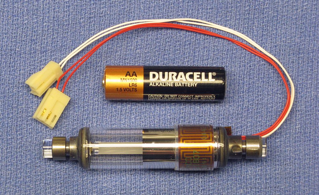

View 24 - Tube/heater assembly without anode insulator next to AA battery
for size comparison (battery not included)

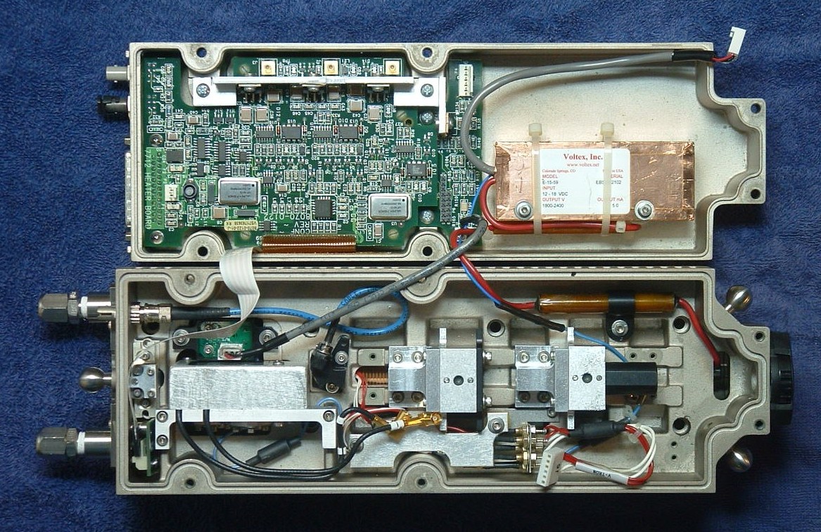

The 7712 is in a much higher quality sealed case and uses
water cooling to achieve a long term stability about 10 times that of
the 7701 or 7702. Its output power is also about double that of
the 7701 or 7702. And there is an additional 42 MHz AOM to offset
the output from the lasing frequency to miminize effects of
back-reflections on laser stability. The microprocessor-based
controller is packaged on two PCBs with an RS232 interface
similar to that of the 7702.

View 07 - Interior showing optics and control PCBs.
