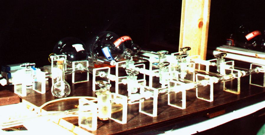

Since the laser involved here operates with a gas pressure in the 1-5 torr range, a vacuum pumping system had to be built. At first refrigerator compressors were used as vacuum pumps, but only a base pressures of 10-20 torr could be reached. Thus, a surplus Sargent-Welch vacuum pump was obtained that gave a base pressure of <1.0 millitorr.
Processing and Filling the Tube with He and Ne:
To reach of vacuum of <1.0 millitorr in a laser tube was a difficult task. When the tube was connected to the vacuum system and pumped out the pressure gauge did indeed indicate a pressure about 10 millitorr. Further pumping produced little reduction in pressure. At this point it was decided to add a He-Ne gas mixture to the tube to bring up the pressure to 3.0 torr. However, after an electrical discharge was applied across the tube the glow was not the characteristic pink color of a He-Ne laser, but was bright blue in color. The temperature of the tube wall also became quite hot. Subsequent examination of the discharge spectra by a diffraction grating showed the presence of N2 and O2 gas impurities, presumably liberated from the walls of the glass tube and metal electrodes.
To remove N2 and O2
gas impurities that had leached from the electrodes and the tube
wall, the technique of ion bombardment was used. (4)
This involved pumping the laser tube down to a pressure of 1.0
torr and then applying a 10 KV, 500 mA AC electrical discharge
across the tube. With high power applied the electrodes were
heated by direct ion bombardment until they glowed bright red.
The discharge also heated the tube wall to a temperature of
approximately 150-200C. This caused N2 and O2
gas impurities to be released and be carried away by the vacuum
system. After the tube had cooled and the pressure reduced to
less than 1.0 millitorr, a 10:1 He-Ne mixture was pumped into the
tube and brought up to a pressure of 3.0 torr.
The pumping station used for this work is
shown at the left. Afterwards, when the tube was removed from the
pumping system and high voltage reapplied, the discharge gave the
characteristic pink He-Ne laser glow with no spectroscopic trace
of N2 or O2 gas impurities. To completely
eliminate any remaining unreacted N2 or O2
gas, coated "Helium-Grade" neon sign electrodes were
used. During heating residual N2 and O2 gases would react with the getter
materials on the surface of the electrodes to form stable
inorganic compounds. Since the He and Ne are inert gases, the
original amount present of the He-Ne gas mixture remained a
constant.

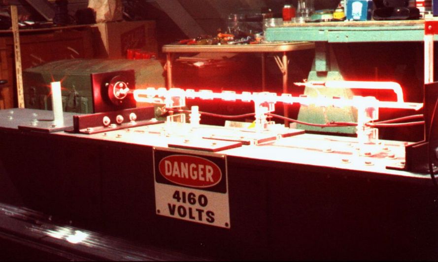

The H-Beam Optical Bench:
After the laser tube was filled with the
He-Ne mixture it was removed from the vacuum pumping system and
placed onto supports of the optical bench. The optical bench
consisted of a 500 lb. steel H beam, providing for great
mechanical stability. (In retrospect, way overkill.)

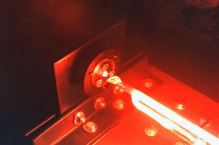

Adjustable mirror mounts, made from 0.375 in. thick steel plates,
were located at each end of the laser tube at a distance of one
meter apart. These mounts held commercially made multi-layered
dielectric mirrors specifically coated for maximum reflectance at
6328A. Each mirror had a radius of curvature of 1.00 meter,
thereby giving a stable confocal resonant cavity. (5)
Alignment of the mirrors was achieved by first aligning the high reflector mirror parallel to a small Metrologic He-Ne laser outside the laser cavity. Then the output mirror was also aligned parallel to the Metrologic laser. It was interesting to note that when the laser tube was first turned on, no laser oscillation occurred. Only after some slight adjustment of the mirror positioning set screws was laser oscillation finally achieved. To increase the power output the high reflector mirror was moved downward to compensate for the lateral beam displacement caused by the Brewster windows. Later on, the mounting system holding the laser tube was redesigned to provide for both adjustable vertical and horizontal movement. This allowed for exactly aligning the laser tube along the optical axis between the two mirrors.
Another problem that reduced the laser output was dust on the inside of the Brewster windows. Prior to cementing the Brewster windows on the laser tube, the windows were immaculately cleaned. However, when the laser tube was operating a layer of dust could be seen on the inner surface of the windows. Later on, the cause of the dust contamination was found. When the laser tube was ready to be pumped down a glass to glass tube-seal was made between the laser tube and the vacuum inlet. To keep the glass seal from collapsing, air was blown in. Unfortunately this air wasnt filtered and thus blew dust into the laser tube and consequently onto the inner surfaces of the Brewster windows. At this point it was impossible to clean the windows without breaking the tube seal.
As a consequence of the scattering at the Brewster windows the laser output was diminished. Measurement of the output was less than 5 mW, while for commercially built one-meter lasers have power outputs typically above 50 mW.
No Frills, but Super Heavy Duty Power Supply:
To increase the laser output the power
source was changed from 60 Hz AC excitation to that of a 15 KV 30
mA DC excitation. Because gas discharge tubes exhibit negative
dynamic resistance, external 30 K ohm ballast resistors were
added in series with the laser tube. Switching from AC to DC
power increased the tube output by about 100 %. Also the power
supply was made variable in voltage, thus providing for an
optimum operating voltage.
The best operating voltage occurred at minimum driving current
and voltage - almost at the point were the tube would wink out.
Higher driving voltages and current would cause the tube to glow
much brighter, but laser oscillation would diminish and
eventually stop at high currents. (6)
(Note the large 1.0 uF, 20KV HV capacitor in the lower right. This was a simple "brute force" power supply made from a neon sign transformer, a full-wave set of microwave HV rectifiers, and lots of jumper clips to connect everything together. The ballast resistors are the big 100W green cylinders. These days there are much better and safer power supplies...)
