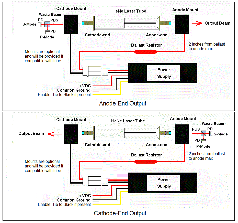

This is detailed info on assembling the Melles Griot 05-LPM-847 power supply brick with ballast resistor(s) and tube mounting brackets. The diagrams below shows the general arrangement. It is critical that the polarity be correct. The diagrams also show the polarizing beam sampler that would be required for the stabilized laser kits (or for other experiments).

  1. Attach the thin red wire to the positive of the wall adapter. Attach the black wire to the negative of the wall adapter. If there is a yellow wire, attach it to the thin black wire. DOUBLE CHECK THE WIRING. REVERSE POLARITY WILL BLOW THE HENE LASER POWER SUPPLY OR DAMAGE IT SUCH THAT THERE IS NO OUTPUT CURRENT REGULATION - WHICH WILL DAMAGE THE TUBE. AND MAY BLOW THE WALL ADAPTER AS WELL.
  2. A screw terminal to barrel adapter is usually included to make this wiring painless. If not, or you would rather hard-wire it, cut off the barrel connector on the DC adapter cord and connect directly to the wires of the brick Refer to the diagram above for the terminals on the DC jack depending on the style that you have. DOUBLE CHECK POLARITY WITH A MULTIMETER BEFORE ATTEMPTING TO POWER THE BRICK AND TUBE!!!!

Wiring using the brackets:
  1. If the output is from the cathode-end of the tube, there should be a hole in the cathode-end bracket so the photons can escape. ;-) If not, it is possible to swap the two brackets or drill a hole. But the bracket with the red wire MUST have the anode-end of the tube. Or drill a hole. ;-)

  5. CAREFULLY lay the tube ends on the mounting brackets paying particular attention to polarity: The positive has the fat red wire and receives the anode (glass)-end of the tube; The negative has the fat black and receives the cathode (aluminum can)-end of the tube. Make sure the anode-end bracket isn't too cockeyed to permit the beam from getting out of the hole. :) Make sure the tip-off (exhaust tube) at the cathode end clears the structure of the bracket.
