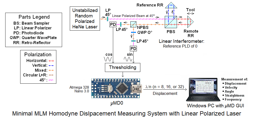

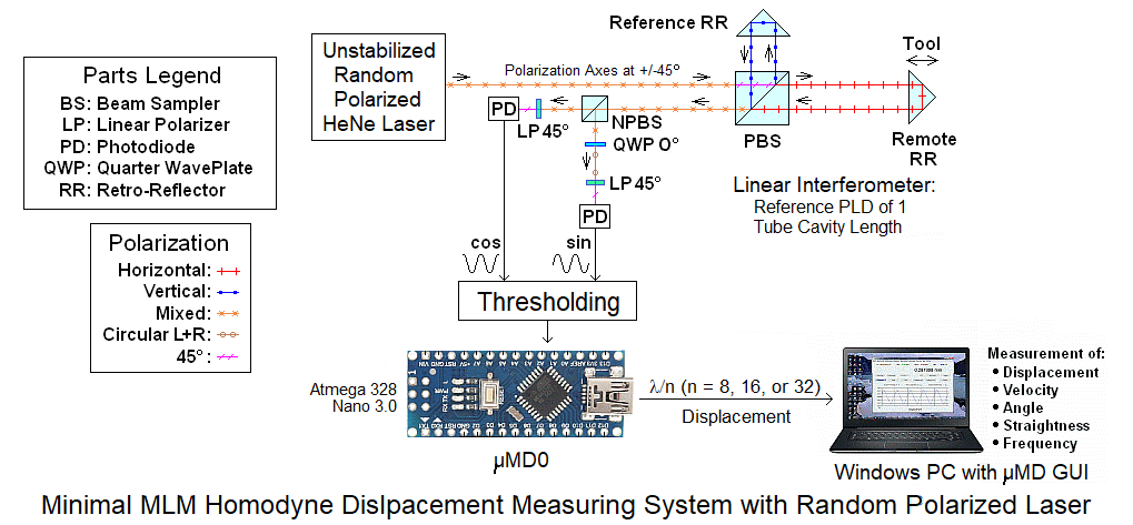

The general organization of two examples of the minimal homodyne displacement measuring systems that can be constructed from these kits are shown below:
These only differ in how the polarization of the laser is set up and the optimal zero reference Path Length Difference (PLD).
The systems have three major parts:
These subsystems can be constructed and tested separately. Although not a specific option, an upgrade to a higher performance setup will be available.

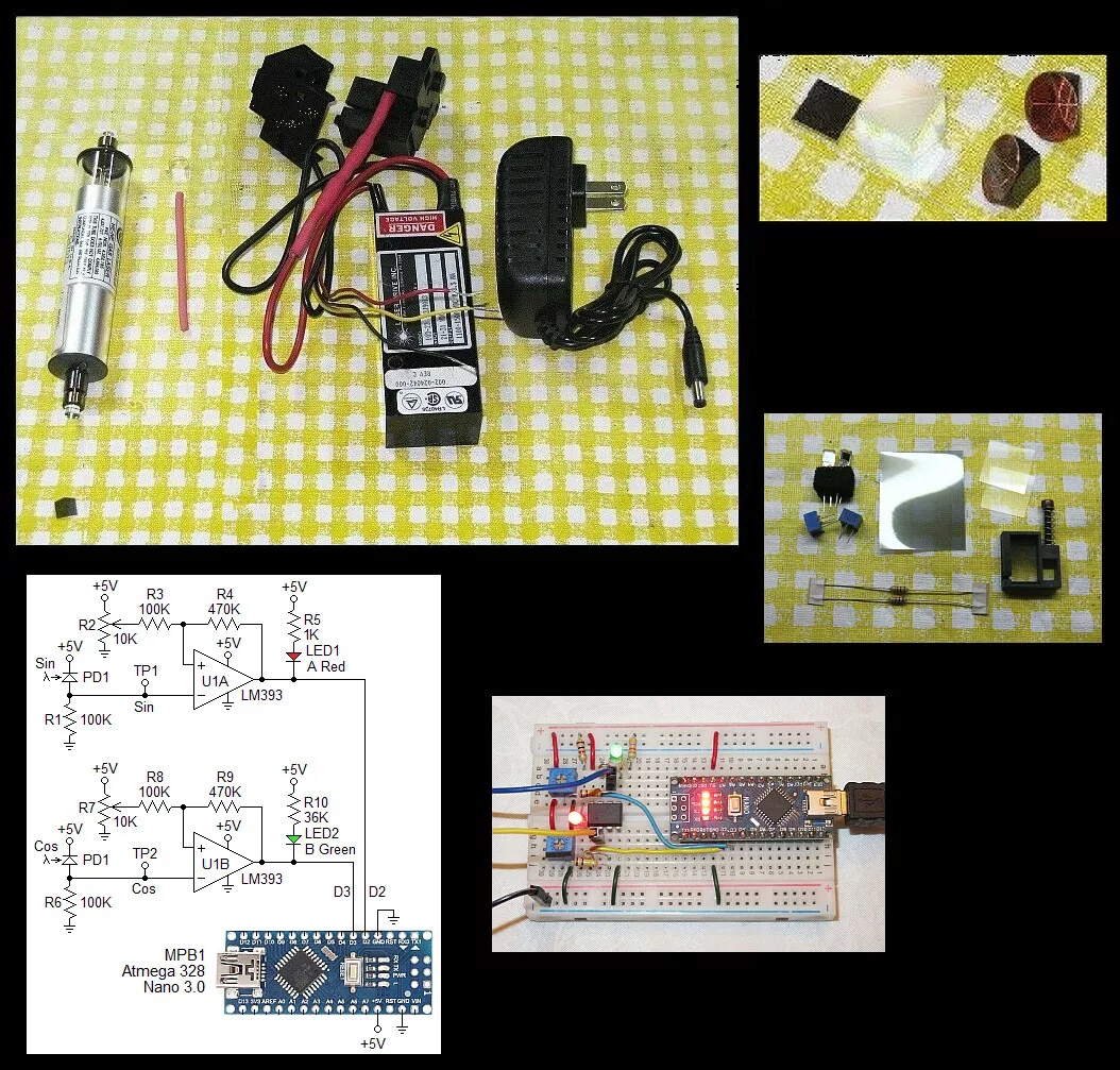

The typical parts are shown below:
Although not shown, bare PCBs for the Quad Decoder and µMD0 will probably be included. This is simple enough that they do not need to be used, at least for initial testing. However, anything more permanent would benefit greatly in terms of reliability and aesthetics. ;-)
Setting up and powering the laser tube:
For use in an interferometer, stable mounting of all components is critical.
To power the laser tube proceed as follows:
Please go to: Wiring Instructions for Laser Drive 103-23 HeNe Laser Power Supply.
The top diagram showing anode-end output is probably the one relevant here.
As noted there are two beams from the tube. The main beam is the stronger one than the "waste" beam (typically by a factor of 25-100 or more). Which end of the tube is which is set at the time of manufacture. For the tube in the kit, it will need to be determined as both types have been shipped. The output beam emerges from the end with the AR coating, which appears blue-ish in reflection. However, it may be the anode-end or cathode-end. Also as noted, the tube MUST be oriented so the glass-end is wired to the positive (red wire with ballast) of the HeNe laser power supply or else bad things will likely happen.
There may be a variable attenuator plate in the anode-end mounting bracket. Since reducing the power of these tubes is silly, that should be removed and has probably already been done. At least one is included in the kit packed separately. These can be used as beam-splitters or beam samplers - more below.
Carefully install the tube within the brackets with the clamps almost flush against the end-bells so that they do not press on the mirror stems. No more than a fraction of a mm of lateral movement possible. The entire assembly should be securely attached to the mounting surface but make sure not to stress the tube in the process, especially the glass-metal seals. If the clamps seem loose, they should be tightened slightly by bending the leaf spring(s) or stuffing some foam in the gap in the plastic clamp.
Apply power. The tube should light almost immediately and a beam similar in intensity to that of a wimpy laser pointer should be produced. If no beam is visible or only a very weak beam, shut down and determine why. The tube may be installed incorrectly.

  1. Converting to linear polarization:
    This is the simplest but more than half the laser power gets thrown away. After determining the polarization axes of the tube, orient it so that they are at 0/90 degrees and install a Linear Polarizer (LP) at 45 degrees. This will produce a beam that is similar to that of a linear polarized tube. The 0 reference PLD should be set at 0.
  2. Taking advantage of both polarized modes for maximum power: Orient the tube so that the polarization axes are at ±45 degrees. The PBS cube will combine them but this means the PLD should be set to 1 cavity length. This counterintuitive result is due to the use of the Polarizing Beam Splitter (PBS) rather than a partially reflecting mirror or Non-PBS. For the typical ~150 mm (~6") tube in these kits, the cavity length is 141.1 mm (5.56"). The zero reference difference between the lengths of the arms should then be set as follows:
    Both of these have identical path lengths in each arm if the reflectors are at the same distance. Asymmetric arrangements like that of the more common Plane Mirror Interferometer (PMI) are a bit trickier to figure out: For the PMI the REF beam is single pass but the MEAS beam is double pass.
