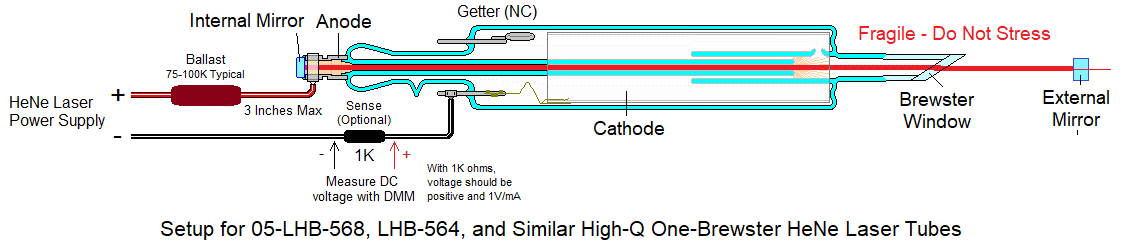

- Unlike most modern internal mirror HeNe laser tubes which use one of
the mirror stems for the cathode connection, the
negative wiring on these is via a pair feed-through posts
which should be treated gently when installing the slip-on connector(s).
- As with all HeNe laser tubes, polarity is critical. The positive
(usually fat red wire) from the HeNe laser power supplly goes to the
metal mirror stem. The negative goes to one or both of the pins
attached internally to the cathode ONLY. Failure to adhere to this will
totally ruin the tube in a few minutes of operation even though it may
appear to light and lase normally.
- The operating current for the long LHB-56x tubes is spec'd at 6.5 mA
but 4 mA to 6.5 mA is acceptable as long as the dicharge is stable.
Lower current results in less heat dissipation in the ballast and tube
with only a small reduction
in available output power. The operating current for the LHB-564 is spec'd
at 3 mA ±0.2 mA but 3.5 mA is acceptable (and is probably what
the power supply in the kits provides). The diagram below shows a low
(shocking) risk way of measuring the tube current.
Failure due to screwups in any of these is not covered under the warranty.

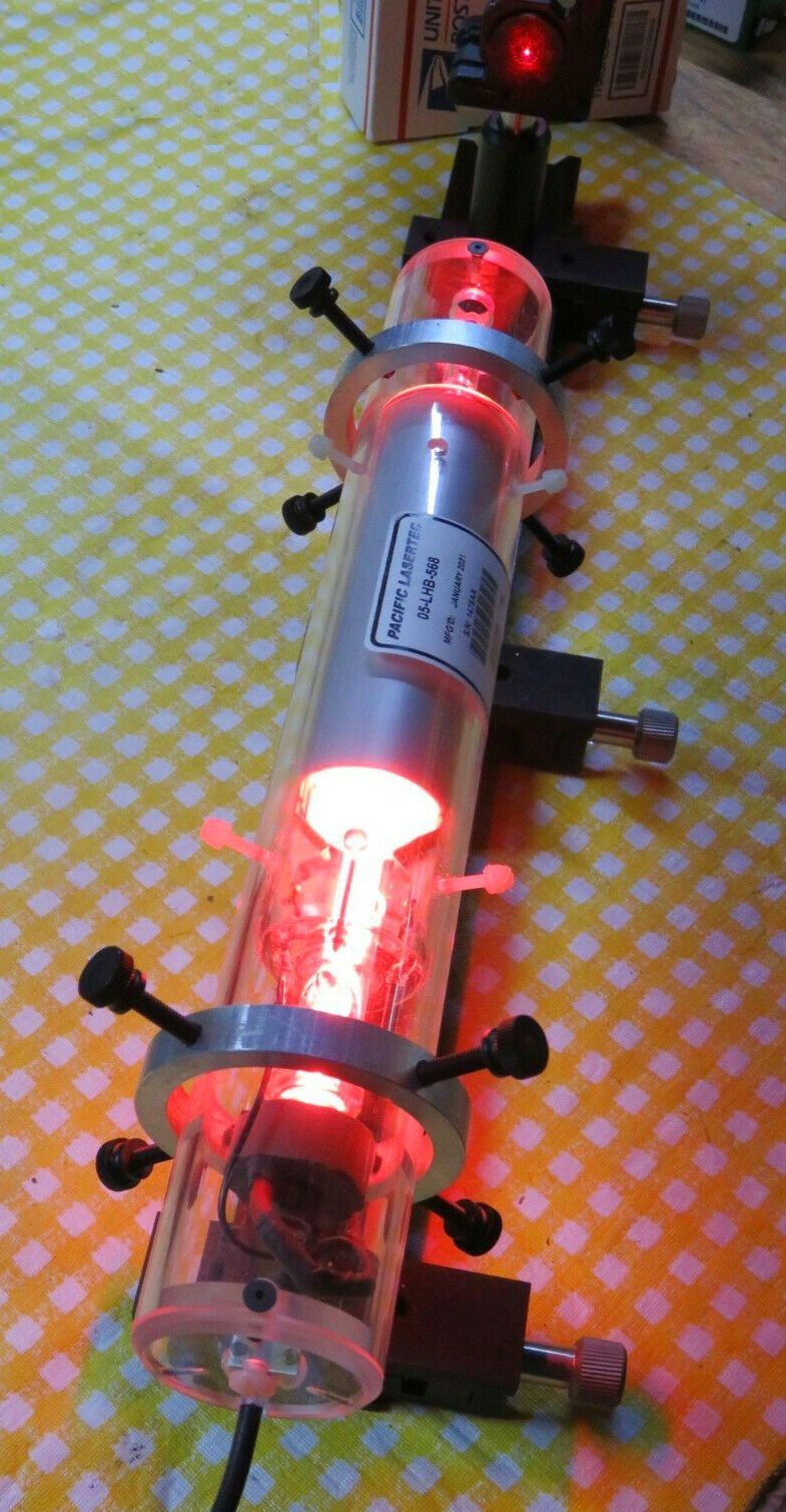

Mounting the Tube and Mirror
Pacific Lasertec 05-LHB-568 One-Brewster HeNe Laser Tube on Rail with External Mirror in Kinematic Mount
The tube is installed in a custom Plexiglas enclosure that protects the
tube from humans and protects humans from shocking experiences due toh
the high voltage. ;-)
The "4-screw ring mounts facilitates the adjustment of the alignment of the
tube with respect to the rail and mirror.

- Alignment laser: A separate low power laser like red
HeNe, or even a green pointer, can be used. (Red pointers usually have
somewhat crappy beam large beams.) But this will require that
the Brewster or Window tube and alignment laser be rigidly
mounted in-line with adjustments to aim the alignment laser. Then
the mirror will be added. If commercial opto-mechanical hardware
is available, this is best done on a rail.
- Set up the Brewster or Window tube on a pair of 3-screw or
preferably 4-screw ring mounts so its centering and angle can be
easily adjusted. Adjust it to be level and centered.
- Set up the alignment laser to shoot its beam directly into the
Brewster or perpendicular window from a distance of 12-15 inches.
- Since there is no mirror to interfere with the beam and these tubes
have wide bores, it is easy or at least straightforward to
align the two lasers so that the alignment beam passes cleanly through
the bore of the window tube and reflects directly back to the
alignment laser from its internal mirror. Putting a white card
with a ~1 mm hole in it on the front of the alignment laser can
aid in this alignment.
- When that has been achieved, the external mirror can be added between
the window tube and alignment laser and adjusted so that the reflection of
the alignment laser from it goes directly back to the alignment laser's
aperture. By simple geometry, when that occurs, the mirror is also
aligned with the window tube and lasing should occur.
