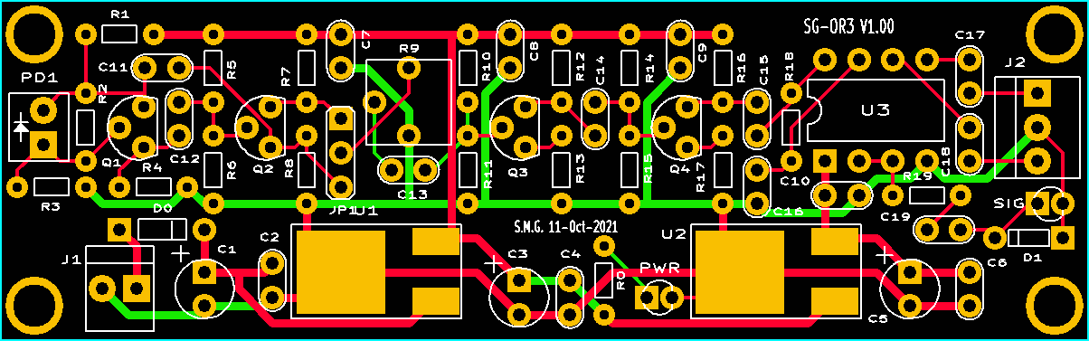

SG-OR3 consists of a 3.2 x 1.0 inch PCB with a 2 pin header for a silicon photodiode at one end and a 3 pin connector for RS422 at the other. Power comes in via a separate 2 pin connector and would normally be between 12 and 15 VDC. However, bypassing the on-board regulators and running it on 5 VDC should be possible with a slight reduction in bandwidth and sensitivity. It is a very simple but flexible design consisting of 4 transistors worth of PD signal conditioning and gain, and an SN75179 RS422/RS485 receiver/driver chip to convert to RS422. The front-end buffer is based loosely on the design of the 10780 but replaces the JFET (used in all HP/Agilent as well a Excel optical receivers) with a biased bipolar transistor, which seems to work at least as well at over the relevant bandwidth. (It is not clear that the JFET which is nearly extinct at this point ever provided any real benefits.) There is a single trimpot for overall gain, and a Signal LED. The trimpot setting should not be at all critical and may never need to be touched once set up for the first time. This version has no external signal level test-point or signal enable as with the commercial units. Only the Signal LED. So be it for now.
SG-OR3 Version 1.00 PCB: Layout (Left) and Partially Assembled (Right)
It's called "SG-OR3" because the dual channel version (velow) was actually originally OR2. SG-OR1 was an aborted attempt to adapt the Teletrac reference receiver design for general purpose use but that was less than totally successful as its sensitivity was too low. Got that? ;-) All components are through-hole except for the 78M09 and 78M05 voltage regulators, but they are trivial to solder. On later versions, the conversion to RS422 which currently uses a SN75179B receiver/transmitter pair in an 8 pin DIP may become an SOIC8 due to availability and cost considerations. Soldering a single SOIC8 SMT package isn't terrible. (You will never have to solder a zillion itty-bitty chip resistors and capacitors!) The sensitivity is below 10 µW out of the laser at 2 MHz (which is the typical maximum MEAS frequency for the DIY kits) with two of the transistors set up as a buffer and the other two as an amplifier with a gain of around 100. Where the beam power is above 100 µW, the third transistor stage may be bypassed. And it may be configured with another factor of ~10 of gain with minor changes to the first stage, but it's not clear how stable that would be. The only need for higher sensitivity may be to monitor REF via the waste beam from the laser tube, which could be below 10 µW.
The current status is that the PCB (above) works with a sensitivity below 2 µW at 2 MHz, but oscillates with no signal. :( ;-) Actually, it doesn't appear to be an oscillation but rather pickup of a stray ~1 MHz signal out of the air.
With only the first two stages, it has a sensitivity of under 5 µW at 2 MHz and under 10 µW at 3 MHz with no oscillation. These values should be quite acceptable for any of the DIY kits. With 3 stages popilated, the performance is just about the same before the noise pickup kicks in.
So the plan is for the first released version to have 3 stages though 2 should suffice.

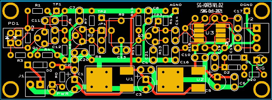

Here is the revised PCB layout:
SG-OR3 Version 1.01 PCB Layout
It's a bit smaller - 1x2.75" compared to 1x3.2" - and easier to assemble. And the pattern for the SMT version of the RS422 transmitter/receiver pair has been added. So either type can be installed.

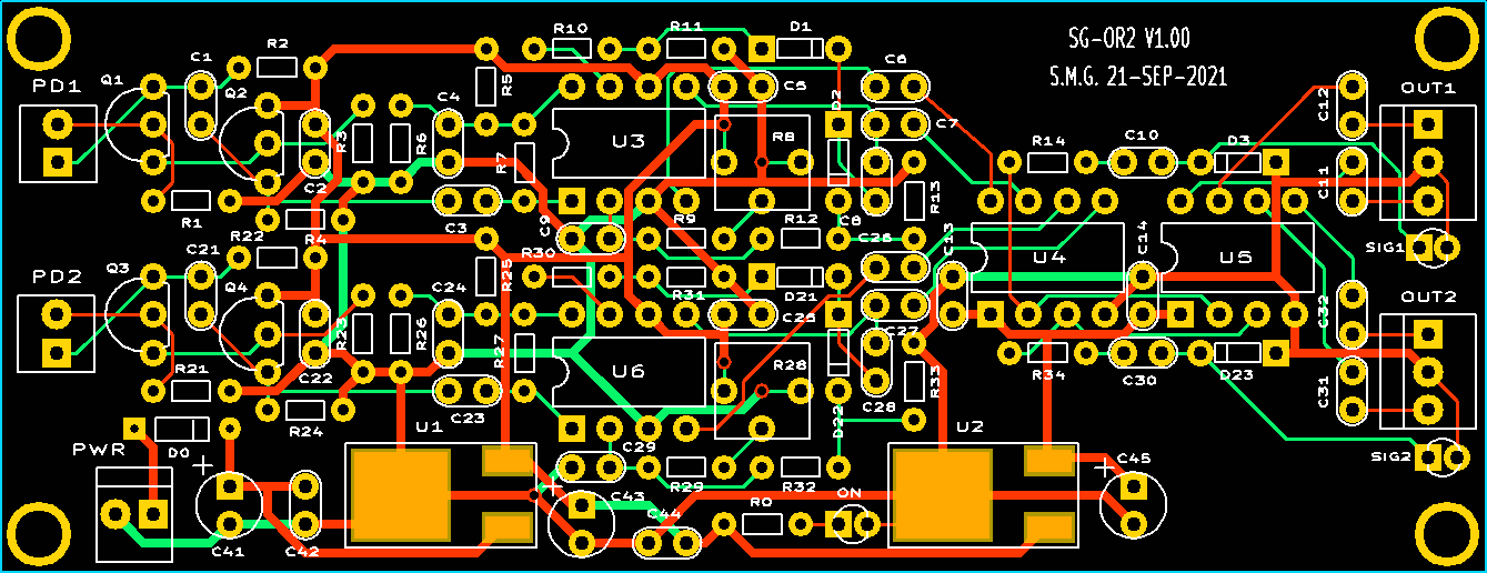

SG-DOR1 has up to two channels and consists of a 4.0x1.5 inch PCB which runs on 12 to 15 VDC with a pair of connectors or screw terminal headers for the RS422 output signals. For a single channel, a portion of the PCB can remain unpopulated.
SG-OR2 Version 1.00 PCB
The PhotoDiodes (PDs) may be mounted on the PCB, or remoted using coax up to at least 1 foot away. Any small area silicon PD should be satisfactory, though the default are the ones included in the various kits. The required Linear Polarizer (LP) can be a piece of self adhesive LP or CP sheet stuck directly on PD. Or if used with a fiber, the LP should be at the fiber input and the LP on the PD would be omitted.
The design is based on a simplified version of the 10780 with a discrete front-end but then uses a high bandwidth integrated TL026 amplifier with AGC or TL592B adjustable gain amplifier, and UA9638/UA9837 pair to convert to two channels of RS422. Where only a single channel is needed, the front-end parts can be omitted for the second channel. On-board regulators provide 9 VDC for the analog circuitry and 5 VDC for the UA9638/UA9837.
The usable sensitivity of the soldered bread-boarded prototype using a random JFET found in a junk cabinet is from a laser power of less than 15 µW to at least 1 mW. With the correct part, it the sensetivity should be better. So it should be suitable for use with the waste beam for the REF signal and the maximum power available from almost any Zeeman HeNe laser. The upper limit should easily cover anything needed for the types of two frequency lasers found in either the DIY DMS kit or Hobby Special displacement measuring systems.
