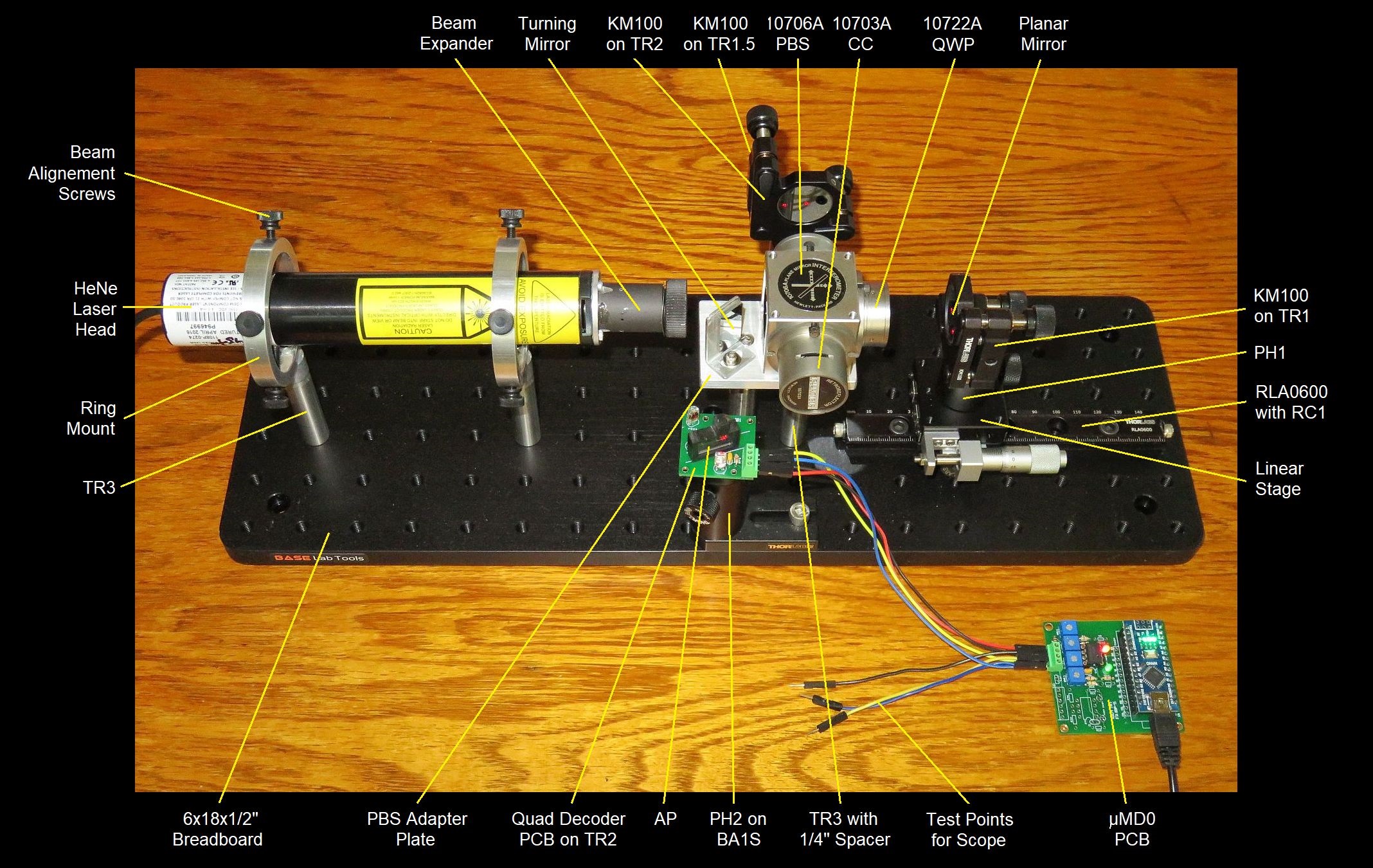

But first are annotated photos of the V2.1 setups for both Homodyne and Heterodyne with all the optics on the PBS cube for reference. V2.0 is virtually identical except for the height of the optical centerline. V1.0 and V1.5 (homodyne only) will be generally similar except primarily for the custom un-anodized breadboard and classy wood block PBS mount. But this should serve for parts identification. Click on the relevant annotated graphic for a high resolution view displayed in a single new window or tab depending on your browser's settings.
Deluxe Version of Homodyne Setup with µMD0 and Compact Version of Heterodyne Setup Configured for the High Stability Plane Mirror Interferometer
