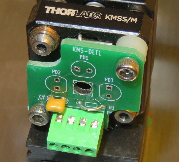

This document describes the various simple PCBs used to convert a (usually laser) beam into two electrical signals, typically differentiated by polarization or phase. Common to all are that there are locations for two bare photodiodes and for a plate or cube beam-splitter. The electrical output is the photo-current which may be used directly with a load resistor. Minor modifications are required to use these with the AB2 pre-amp.
There are several versions of these PCBs but all have the following:

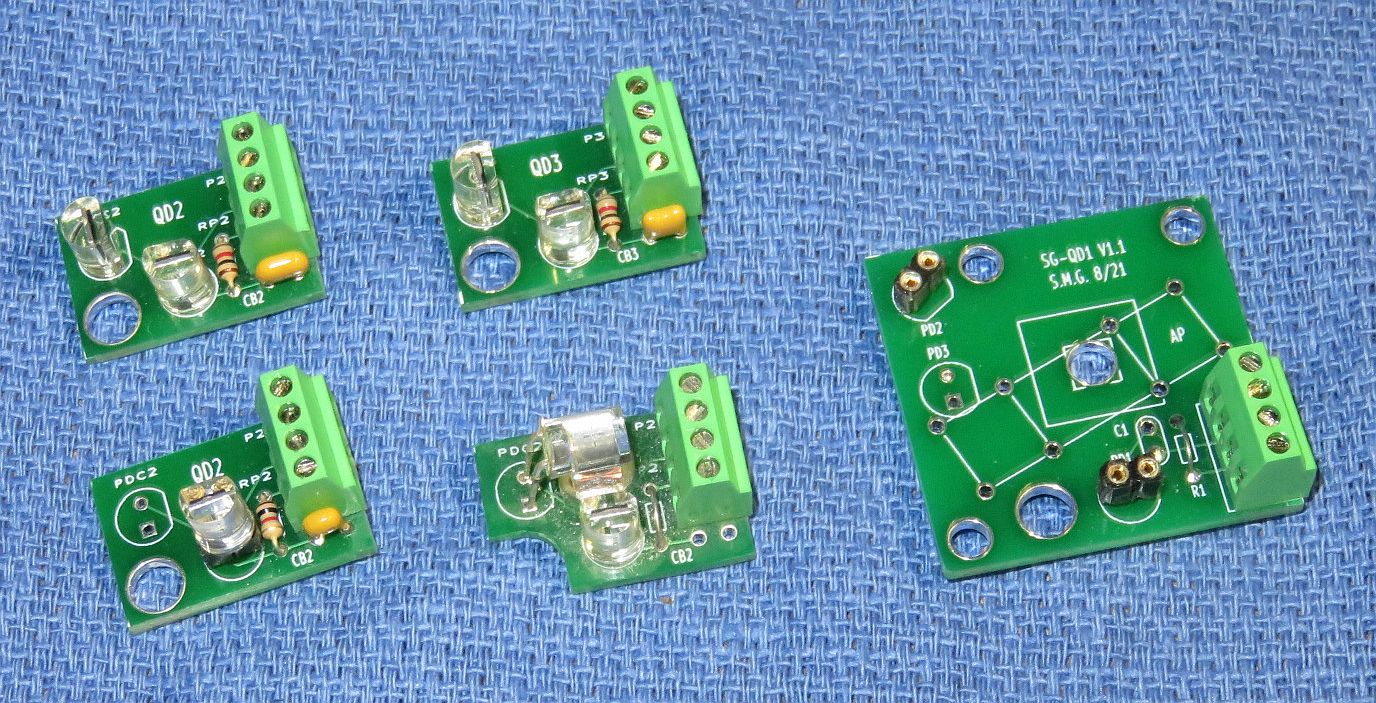

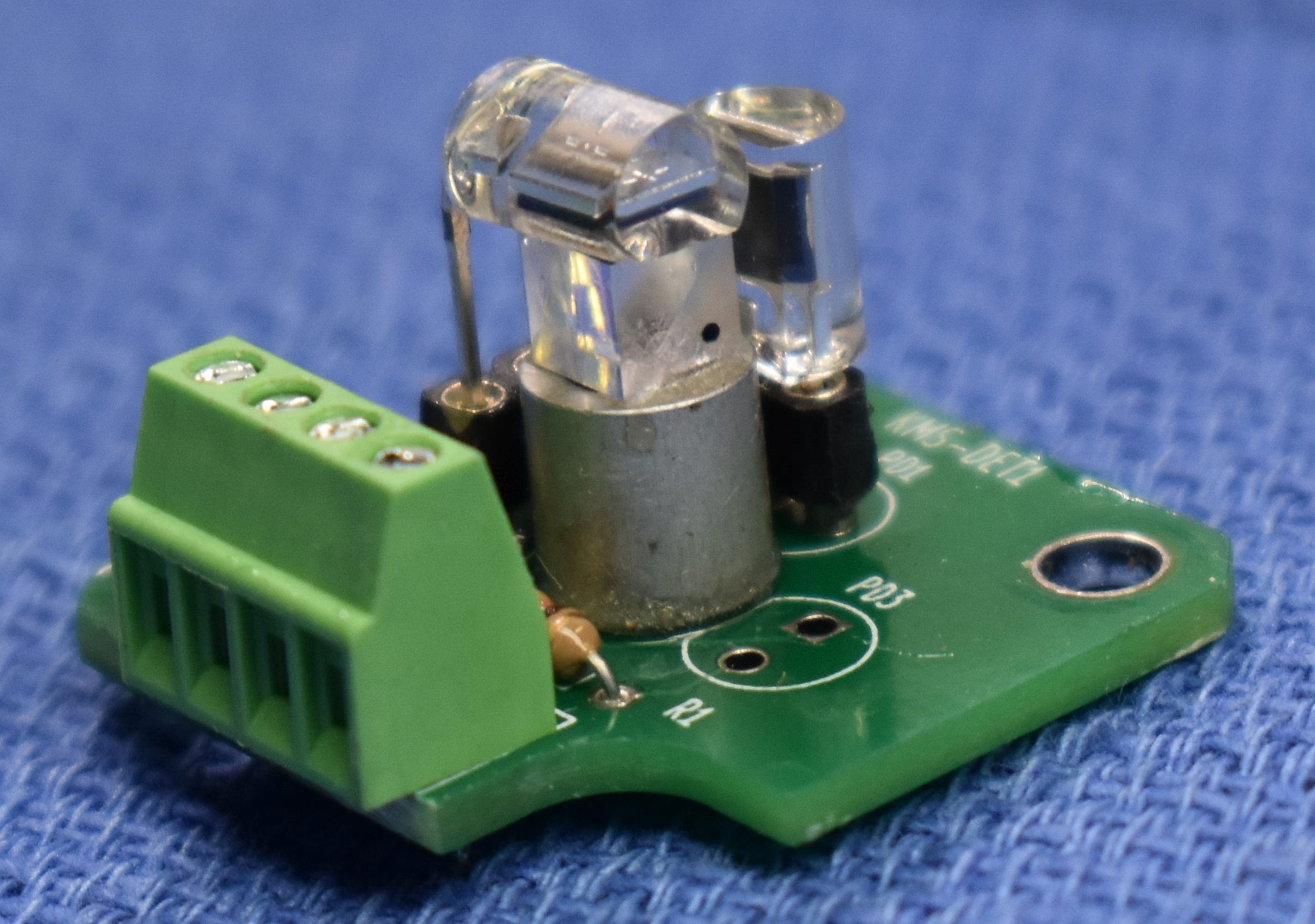

The photos below show some of the versions of the DP1 PCBs in various stages of assembly.
Various SG-DP1 PCBs: Single Channel, Two Channel, with PBS and Beam from Behind, QD1 Modified for AB2, Mounted on KMS, QD1 Quad Decoder using AP and bits of CP Sheet
The PCB designations are kind of arbitrary. ;-)

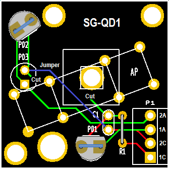

The schematics for the DP1 Version 1.0 PCBs are the same except for a spot for PD3 in parallel with PD2 on some. The SG-QD1 version is set up to use a variable attenuator plate as a non-polarizing beam-splitter. To minimize polarization effects, the AP is set at a 20 or 30 degree angle instead of 45 degrees, so the reflection is in a different direction. If used with a PBS or NPBS cube, PD3 can be used instead. KMD-DET1 can use PD2 or PD3 which are wired in parallel.

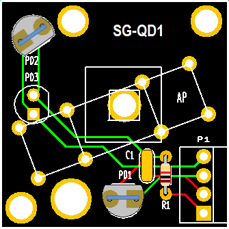

The graphics below show the layout diagrams for the various versions of the PCB with the parts installed:
SG-DP1 PCB Layouts Version 1.00: Small with Beam from the Side, Small with Beam from Behind, Medium, Large, SFPI with Beam from Behind, Quad Decoder, Quad Decoder Modified for AB2
To use these PCBs for a quad decoder requires an optical setup such as one of the following:
The left diagram is the classic arrangement with a plate-type Non-Polariziing Beam-Splitter (NPBS) at 45 degrees. An NPBS cube could also be used.
The center and right diagrams use a variable Attenuator Plate (AP) in place of the NPBS, primarily due to cost. But so as not to mess with the polarization too much, it is set at a small angle, so its photodiode needs to be mounted at a different location. The difference between the two diagrams is only in the arrangement of the LPs and QWP: The one on the right can use the same type of CP sheet for both.
