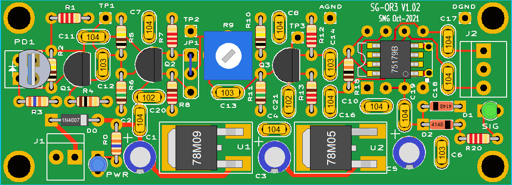

OR3 is on a 1 inch by 2.75 inch PCB and remedies most of these deficiencies. The optical input is a beam up to ~3 mm in diameter (using the default photodiode) with an optical power from <10 µW to >1 mW. While OR3 as tested doesn't have the frequency response of the commercial ORs, its >3 MHz bandwidth is more than adequate for systems using the kit lasers. And it is expected that the bandwidth limit can be extended with trivial changes to only a few part values. This is left as an exercise for the student. ;-)
A case with a copper foil liner or wrap for shielding could easily be fabricated for this using that lonely 3-D printer eagerly awaiting something to 3-D print. ;-)
The actual SG-OR3 PCB is four layers with internal power and ground planes. This does appear to have better sensitivity without stray noise pickup than a two layer PCB with the same component placement but no planes. The gain can be set at the half way point and still be quiet with no signal without shielding. And the sensitivity there is better than 2 µW at 3 MHz. Typical populated SG-OR3 PCBs are shown below. They may look HUGE in your Web browser. Don't be fooled. ;-)
Typical Populated OR3 V1.02 PCBs
The main or only difference is headers versus screw terminal blocks for connections.

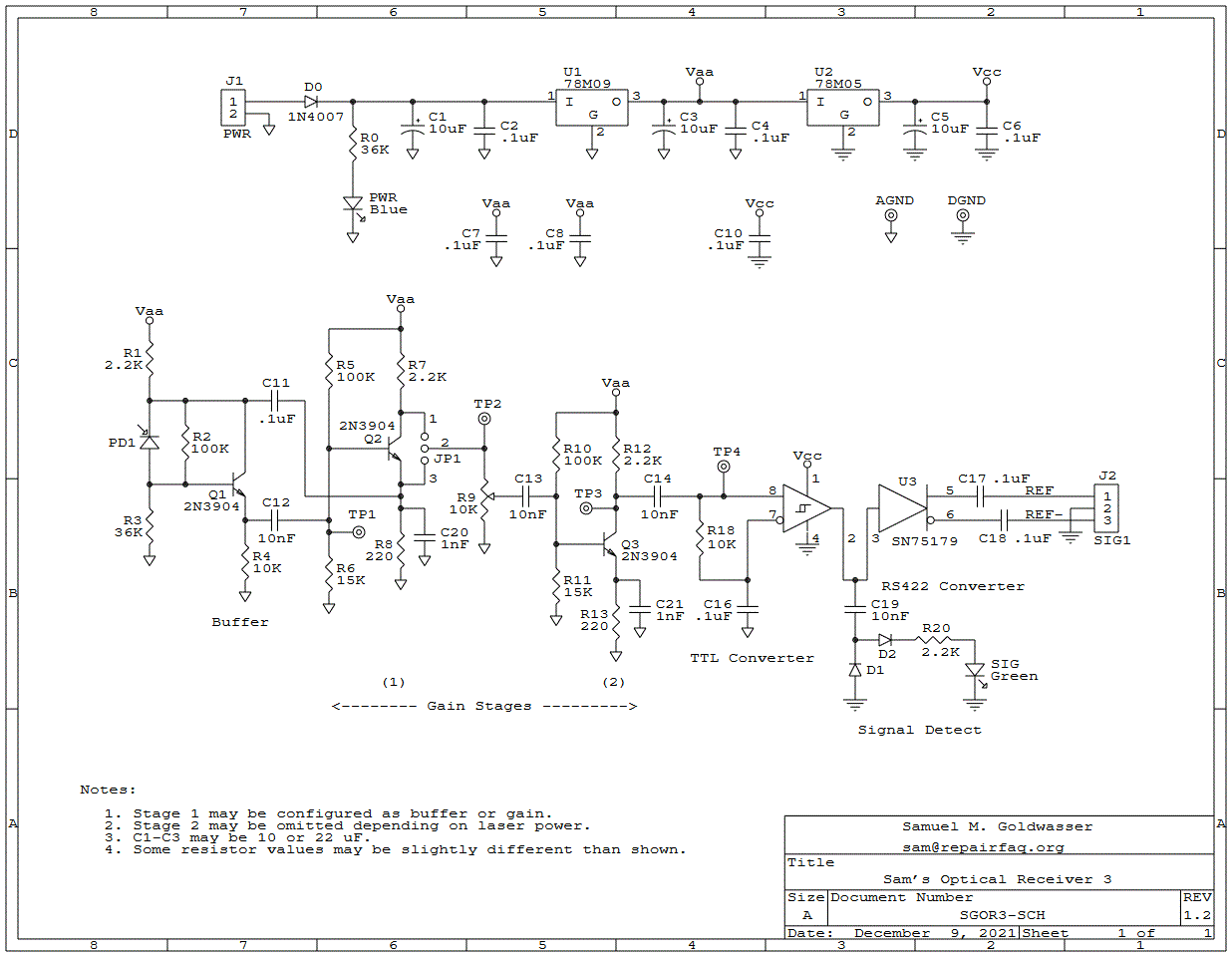

Schematic for the OR3 Version 1.2
The schematic for OR3 is shown below. (Schematic version numbers are not the same as PCB version numbers.)
OR3 Version 1.2 Schematic
The graphic below shows the general appearance of the PCB with most of the parts installed for the three levels of gain:
SG-OR3 PCB Version 1.02: Location of most Components with 75179B DIP (Left) and SOIC (Right)

Theory of Operation
OR3 consists of an impedance matching stage, 1 or 2 stages of amplification, a differential-to-TTL converter, TTL-to-RS422 converter, and SIG LED driver circuit as follows:
