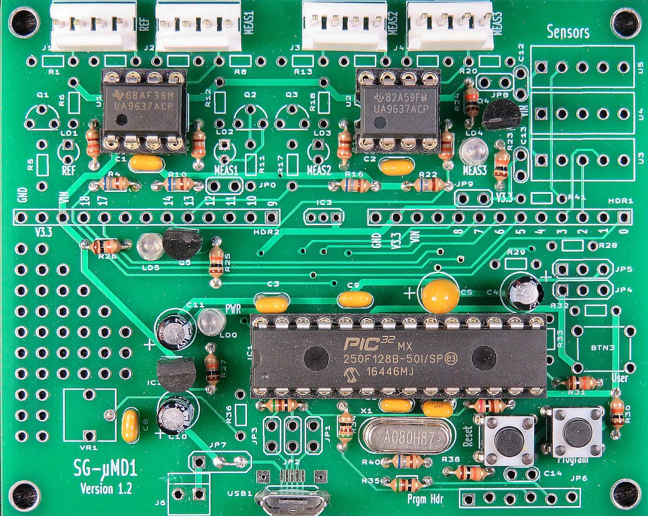

Assembly using the SG-µMD1 Board
The SG-µMD1 Boards are now available and have replaced the chipKit boards. They will be supplied unpopulated with a kit of parts for up to a 3 channel µMD1 system with the PIC32 preprogrammed with the boot loader and µMD1 firmware. Although assembling them from a pile of parts may appear to be more work than using the chipKit board, no hand-wiring or decisions on parts placement will be required. So it is actually simpler in some ways as parts need only to be inserted and soldered. All parts are through-hole so it should be quite straightforward with a total time from start to finish of under 2 hours for anyone reasonably proficient in fine soldering.
The first SG-µMD1 PCBs to be available were Version 1.0. No more of those are being shipped. But if you purchased an SG-µMD1 kit awhile ago, it may have a V1.0 PCB. Version 1.2 will be in all future kits. They differ primarily in the LEDs and are equally good at doing their µMD1 thing. ;-) V1.2 has all the chipKit LEDs as well as one additional one so that REF and MEAS1-3 are illuminated. ;-) However, parts numbering has also changed slightly between V1.0 and V1.2 and thus it's essential to use the correct assembly manual. The version is labeled on the PCB silkscreen and bottom copper layers. Please refer to SG-µMD1-V1.2 Assembly Manual. There are links to the the SG-uMD1-V1.0 assembly manual and the MPLAB version (which is bare-bones for programming PIC32s directly or restoring the bootloader) under "References". More details are available in the V1.2 assembly manual.
The interferometer cable locations are unchanged so either layout can be referenced for wiring those.

Arduino Pin Assignments
Pins on the chipKIT and SG-µMD1 board are labeled on the silkscreen but there are at least two different revisions for the chipKit and the numbering isn't the same! The table below should agree with the SG-µMD1:

The chipKit and SG-µMD1 pin locations are similar:
Arduino Pin Labeling of Original chipKIT DP32 PCB (Left) and Three-Channel SG-µMD1 PCB (Right)
CAUTION: Most PIC pins are NOT 5V tolerant - they will be unhappy if a 5 V signal is connected to them directly. Thus VIN (5V) or any signal that may go higher than 3.3V should NEVER be connected to them, even for an instant. Bad things may happen. 3.3V is acceptable through a current limiting resistor (just to be doubly safe, for the micro that is). Hooking raw power to what may be a logic output (accidentally or otherwise) is never a good thing! P.S. "Unhappy" and "Bad things may happen" could mean that you'll ruin the PIC chip.
