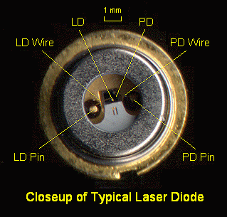

* Laser Diode - This is Infra Red (IR) emitting usually at 780 nm - near IR,
just outside the visible range of 400-700 nm. The power output is no more
than a few milliwatts though this gets reduced to .25-1.2 mW at the output
of the objective lens. A photodiode inside the laser diode case monitors
optical power directly and is used in a feedback loop to maintain laser
output at a constant and extremely stable value.
The photos below show some of the types of laser diodes you may encounter in
CD players, CDROM drives, laser printers, and bar code scanners:
- A Variety of Small Laser Diodes (CD, laser printer, bar code scanner)
- Closeup of Typical Laser Diode (from a laser printer)
- Closeup of Laser Diode from the Sony KSS361A Optical Pickup (seen 'actual
size' in the upper left corner of the group photo, above.)
