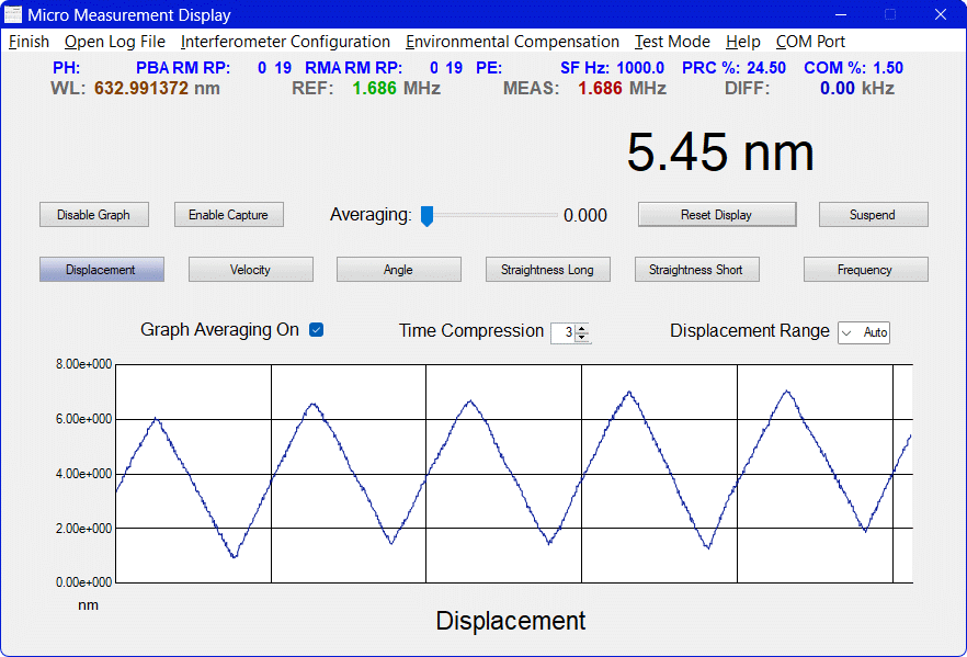

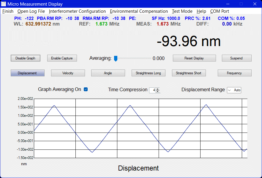

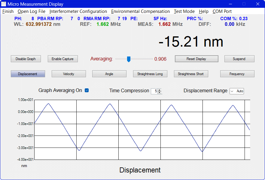

No, these displays are NOT of the electrical signal but the actual displacement measured using the interferometer and µMD2!

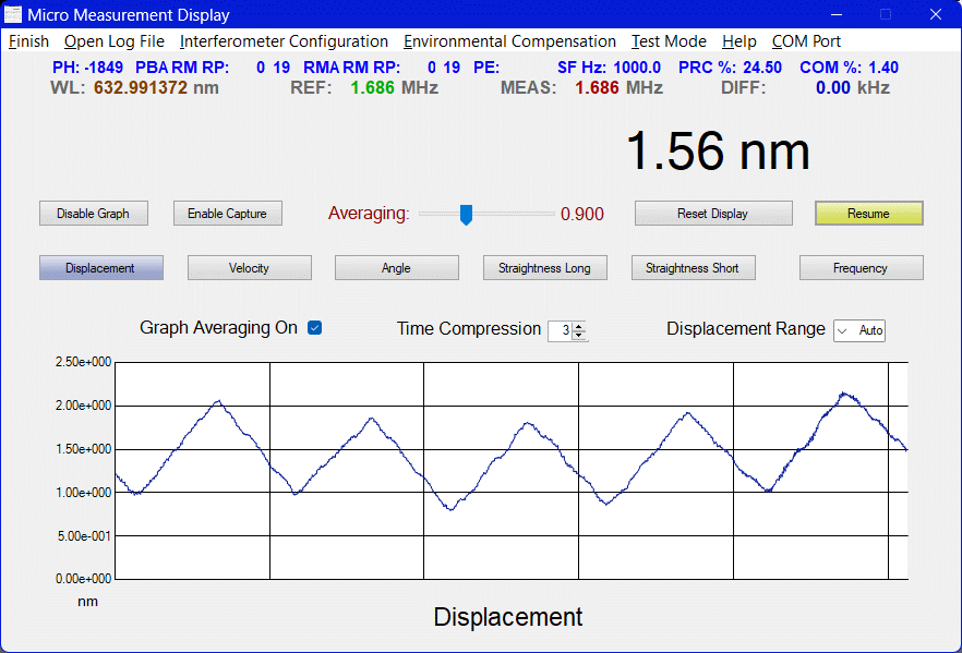

Some "wandering" up and down of the average displacement up to a few nm with a period of a few seconds is present at the highest resolutions. I had always assumed that this was due to the relative sampling of the REF and MEAS edges with respect to the 600 MHz CPU clock. The entire system is synchronous, so at some point that sampling comes into play. Similar behavior was present with µMD1 interpolation as well (though it may have been worse). However, I recently came across a scientific paper that discusses similar artifacts associated with interaction of the F1 and F2 components of the Zeeman laser itself. This should not be present with a laser that uses an AOM to create the F1/F2 components through up and down conversion of a single frequency optical carrier. But the only lasers I have using an AOM are the Zygo 7701/2s and their 20 MHz split frequency is too high to do useful interpolation with the current firmware. And they probably wouldn't do what is needed anyhow. And these effects may not even be relevant anyhow. However, swapping my modified Melles Griot 05-STP-910 for a genuine HP/Agilent/Keysight 5517 laser may be instructive. The µMD Tech Support Department was never able to locate the cause of that either, despite the billions of nanoseconds devoted to it. ;-) But there are also thermal effects and vibration. It is almost impossible to really measure these nm-scale changes without outside disturbances dominating. In fact, to record these data, a PZT (piezo-beeper element) had to be secured directly to the HSPMI. And even then any vibration like tapping the table or even walking nearby still shows up in the display.
The most precise level is implemented using Phase Interpolation. This algorithm in effect "looks" at the waveforms of REF and MEAS averaged over many cycles and computes their relative phase. It turns out that that is the simple part. What is more challenging is linking the computed phase to the integer part of the displacement (DISP) based on the difference between the REF and MEAS counters, is not trivial even if done in am FPGA or low level digital hardware, and even more so with a set of counters running independently of the firmware code execution. In essence, a change in DISP should be accompanied by a large change in Phase. For example, if DISP increments by 1, the Phase MUST decrease by close to 360 degrees so the interpolated value is continuous across the boundary. But due to the aforementioned uncertainly, that will often not take place. Without correction, the result will be spikes in the displacement up to a a wavelength in amplitude depending on the interferometer resolution.

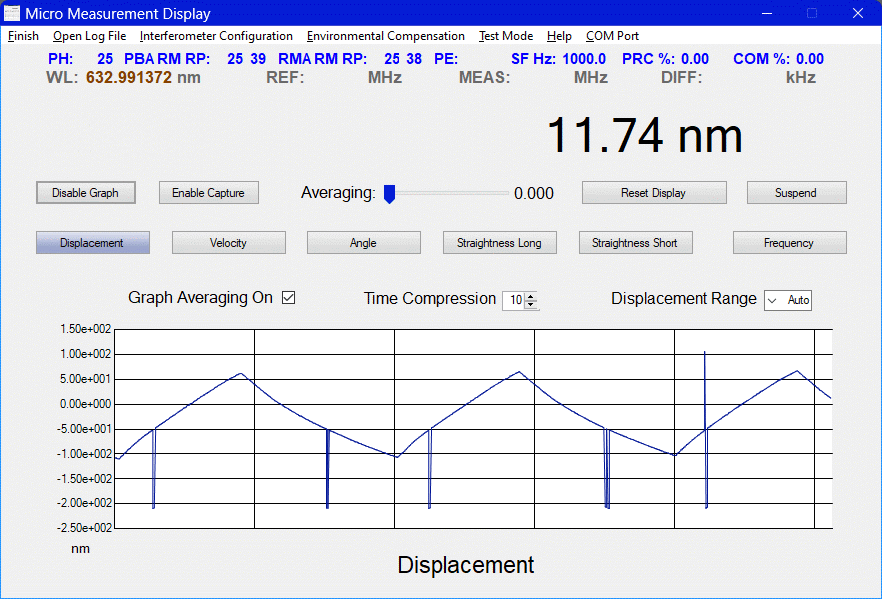

And the actual data is much more messy than this as there will usually be multiple glitches both positive and negative, but the µMD GUI plotting routine subsamples.
A state machine implemented in firmware is used to determine what happens for each sample based on whether consistent changes in displacement and phase take place. And if not, why not. The next state to be based on two conditions:
As noted, a Bogus State is an allowed transition that occurs when the alignment of a change in displacement count does not coincide with a corresponding change in the computed phase. This can occur both due to the uncertainty in digital sampling of the phase computation and counter timing using the CPU sampling clock, as well as noise on the input REF and MEAS analog signals and resulting jitter in the digital samples. Transitions into Bogus states are perfectly legal. By keeping track of the four possible Bogus States and the change in Displacement count and Phase for each sample, the appropriate Next State can be determined. This may lead to the same or another Bogus State, but must eventually transition to the Normal State. Anything else is an error condition generally due to an illegal transition caused by a slew rate too large for phase interpolation to be usable. In that case, the Phase value is zeroed out for that sample and the Phase State is forced back to the Normal State along with a delay of some number of samples to allow things to settle down.
Each state transition has an associated displacement count correction (+1, 0, -1) associated with it. In essence, the computed Phase is used as the gold standard and the displacement count is forced to agree with it for each sample.
Note that this approach only works for very slow changes in displacement - on the order of less than 0.01 mm/second. Averaging/super sampling is also applied independently of phase interpolation resulting a resolution on the order of 10 nm at any slew rate. This has proven to be remarkably robust, but as noted is only usable for slowly varying displacement in what I have dubbed the End-Point Regime or EPR.

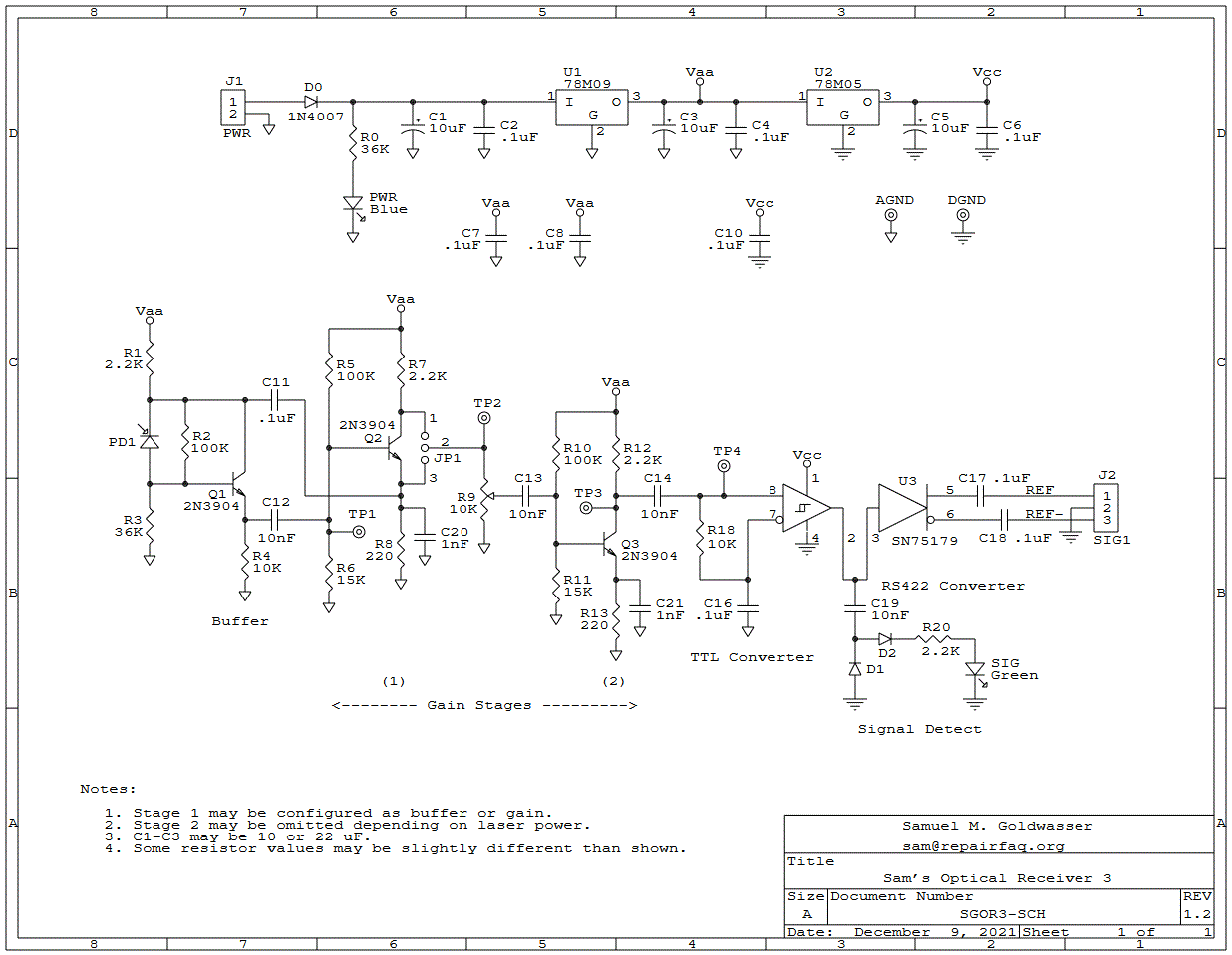

OR3 Optical Receiver:
Refer to the Optical Receiver (OR3) Assembly and Operation Manual.
