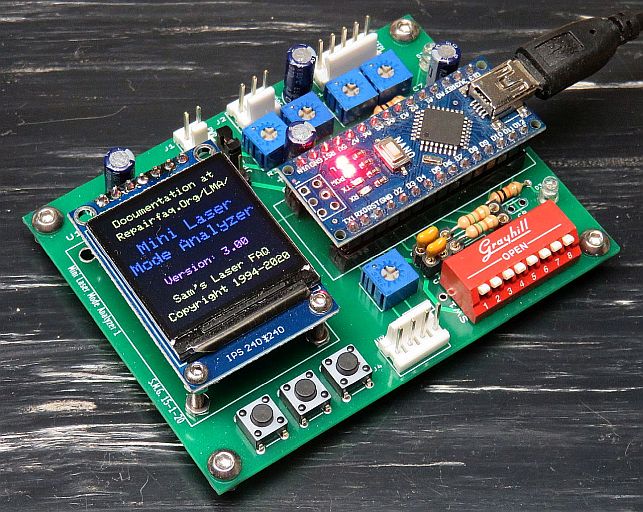

Mini Laser Mode Analyzer 1 (mLMA1) was originally intended as a proof of concept for implementing a Scanning Fabry Perot Interferometer (SFPI, also known as a laser spectrum analyzer) using any SFPI head compatible with low voltage PZT drive. But mLMA1 turned out so well that it could have practical value, especially where a compact low cost instrument is desired for basic checking of the mode behavior of lasers intended for applications like holography and interferometry. ;-) And then several other functions were added including a laser power meter, longitudinal mode display, and frequency counter. And it fully supports dual polarization inputs for all functions. Some of these capabilities do not have any known commercial counterparts. Though hopefully, creeping featurism syndrome beyond this will be largely avoided. :) At present, the hardware and firmware are mostly complete except for the addition of an antialiasinig filter for the SFPI display: If the finesse of the SFPI head is high, then peaks may be missed, or bounce up and down due to insufficient sampling. In other words, an SFPI head with low resolvance produces a nicer looking display. :) That may be remedies shortly, or at least eventually.
For use as an SFPI, mLMA1 replaces the normal ramp driver and oscilloscope by a compact almost zero-cost Arduino-based system with color LCD display. The accompanying "Mini" SFPI head constructed specifically for mLMA1 is just over 1x1x2 inches and includes the SFPI dual polarization detector as well as a beam sampler and longitudinal dual polarization detector So the entire setup could be fit in a pocket - really. :) Its entire parts cost - excluding that of the low voltage SFPI head - is under $10 using new and surplus parts, mostly from eBay. The SFPI head was built using Thorlabs 16 mm cage parts (around $100), the SFPI mirrors set I sell with my SFPI kits (~$50), and assorted odds and ends including surplus PBS cubes ($5-$10). This is designated the "Mini" SFPI head because, of course, there are also "Micro" and "Nano" versions which are even smaller. ;-)
A similar system with a higher performance processor and slightly higher resolution display would cost under $50, that may be Version 4. ;-) But the goal here really was to develop something usable as inexpensively as possible. Using a 600 MHz processor like the one in the Teensy 4.0 that would be twiddling it thumbs most of the time just seemed wasteful. :( :)
Photo of Original mLMA1-V2 Prototype running SFPI (left), More Polished Version (center), and Dual Polarization SFPI/MODE Head (right)

The system described below implements all of these using the Atmega 328 Nano 3.0 PCB and a hand-full of discrete parts. SFPI scan rate, span, and offset; scan or sample rates for alll functions, and SFPI and MODE input gain can be adjusted via the "Three Button Interface described later. Trim-pots provide coarse adjustment of input sensitivity which should cover ranges sufficient for red HeNe lasers of at least 0.5 mW, and ramp amplitude (up to 9-10 V p-p) which should be enough to scan 2 FSRs or more using the typical $1 PZT beeper element. Together, these should be acceptable for a laser with an output power of 1 to 10 mW to display its longitudinal modes in real time. But a version using a previously implemented ramp driver and photodiode preamp PCB described in the Laser FAQ section:
  • Sam's Scanning Fabry-Perot Interferometer Driver 1 (SG-SF1) would have more flexibility. It generates a ramp of up to 60 V p-p along with a sync signal for the Arduino, as well as including a variable gain photodiode preamp, more flexibility in terms of scan rates and magnification, and automagical locking of lasers based on the SFPI display.
    While this won't replace a $5,000 instrument, it is more than adequate as-is for determining the basic health of a laser such as whether it is Single Longitudinal Mode (SLM). The display above shows the actual scan of the lognitudinal modes o a 5 mW red HeNe laser.
    mLMA1 consists of 3 parts:
    1. SFPI head using low voltage PZT: Anything that will scan 2 to 3 FSRs with less than 60 V p-p should quality. (Or 10 V p-p without the optional HV driver.) The compact dual polarization SFPI head built for mLMA1 has a short radius spheical cavity with an effective FSR of approximately 2.33 GHz. A scan voltage of 5 V p-p covers more than 1 FSR. The SFPI head also includes a beam sampler and second dual polarization detector for the CHART, SCOPE, and POWER displays.
    2. Atmega 328 Nano 3.0: This Arduino-compatible board is the brains including generating the ramp signals and running the display.
    3. One inch 240x240 pixel IPS LCD display: This is a full color (5,6,5 RGB) back-lit LCD using the ST7790 and GFX libraries.
    4. Firmware: It is written in C and generates the ramp driver signal, captures the data, and implements the SFPI DSO and mode plotters, frequency counter, and handles the TBI, among others.
    5. Power: Regulated source of 5 VDC to power the Nano and optional boost converter. This can come from a USB port on PC, laptop, or USB backup battery pack (though they may shutoff if the load is too low, as it may be here, typically around 50 mA), or a 5 VDC power or regulated DC wall adapter. The boost converter, if used, runs from the 5 VDC and provides 30 to 50 VDC for PZT ramp driver transistor. I do NOT recommend using the VIN input to the Nano board - strange and bad things may happen. :(

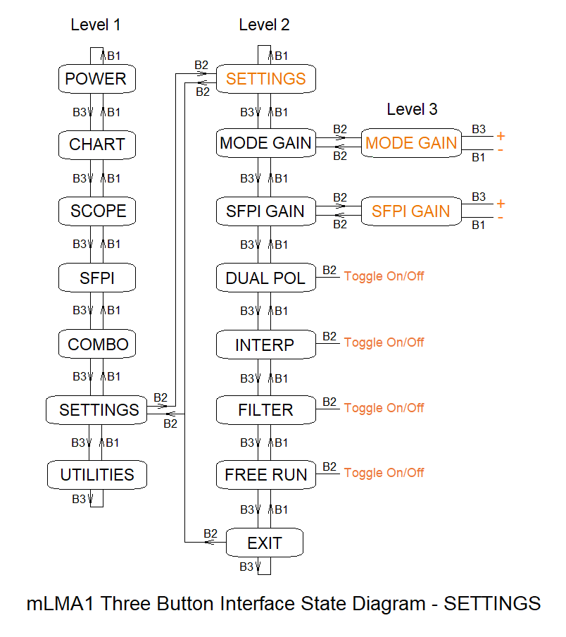

    This document provides a general descriptions of the mLMA1 hardware and firmware along with a wiring documentation, parts list, and construction guidelines.
    The following two functions apply only to the DIP switch interface:
    There are equivalent functions accessible when the TBI is active.

    The mLMA1 PCB is based almost 1:1 on the construction below, slightly larger than the optimal miniaturized format but easier to assemble and use if not stuffed into an itty-bitty case. :)
    More Permananent Prototype of mLMA1 Hardware
    The Perf. board is around 6x8 cm with sockets for the Atmega and LCD, and will have all the components in the wiring diagram EXCEPT for the DC-DC and MHV-PZT driver. Also includes the buttons for the three button interface. The PCB will be very similar.
    This photo of mLMA1 running in the COMBO function has not bee doctored or mangled in any way except to remove some dust specks. :) The design is identical to what's shown in the wiring diagram and parts list. The 5V to 3.3V conversion resistors are under the LCD.
    The complete schematics may be found as PDFs at at Mini Laser Mode Analyzer V2.0 Schematic and Mini Laser Mode Analyzer V3.0 Schematic.
    mLMA1-V2.0 PCB Layout (left) and mLMA1-V3.0 PCB Layout (right)
    The dimensions are just over 8 x 6 cm (3.2 x 2.4 inches), similar to the prototype.
    A user interface using three buttons as a replacement for the DIP switches is now essentially complete. It has much more functionality that the DIP switches including adjustment of parameters like SFPI span and offset, MODE and SFPI gains, rates, and more. And it would also add the ability to save and recall all these settings using the EEPROM on the Atmega.
    The buttons are: B1: DOWN/OFF/BACKWARD, B2: SELECT/TOGGLE, B3: UP/ON/FORWARD.
    In all cases, selections for each of the buttons are shown, replacing the banner in the top-left portion of the display while the buttons are in use (so as not to interfere with the selected function, which continues to run except in some cases while parameters are being adjusted).
    Top level: B1 and B3 cycle between POWER, CHART, SCOPE, SFPI, and COMBO functions, and SETTINGS and DEFAULTS.
    For the functions, pressing B1 switches to the highlighted function and goes to the second level.
    For SETTINGS and DEFAULTS the previous function continues to run.
    Second level: The effect of B1 (moves to the left) and B3 (moves to the right) depends on which function is active and cycles among:
    (The highlight function and EXIT are essentially equivalent at this level but EXIT is included so there is no doubt how to get out of it!) The RATE parameters are function-specific and their actual effect may differ. SPAN and OFFSET are for the SFPI sweep. KERNAL is a number from 1 to 10 that determines the width of the windowed sin(x)/x antialiasing filter kernal. A value of 0 disables the antialiasing filter. (FILTER must also be enabled under UTILITIES.)
    Except for RATE, parameters for COMBO are handled by SFPI and SCOPE. RATE for COMBO adds an additional way to slow things down further, should there be some need to do so.
    And for the others:
    B2 selects the value to adjust or toggle and goes to third level (except for the active function or EXIT (which result in the same actiion - to go back to first level), or where an option has its own action (like the toggle for dual_polarization or interpolation).
    Third level:
    B1/B3 adjusts value up/down or toggles value on/off. Using RATE as an example, the current value of the parameter will be displayed momentarily and then the button navigation display will look something like the following:
      - RATE +
    Actions take effect when the next sample or scan occurs. For the adjustments, + and - denote the effect of B1 and B3. A momentary press of B1 or B3 will cause the value to decrement or increment by 1 if within the allowable range. If at one end, either + or - will be missing and it will just stay there, as well as the current value appearing momentarily in place of the parameter name. Holding the button depressed will result in the parameter continuing to decrement or increment rapidly until the limit is reached.
    Note that these operations only occur between the samples or scans so if the RATE(s) are set to be really slow, the effects of the buttons will be a just a wee bit sluggish. And pressing and holding B1 or B3 will bring all data capture to a screeching halt. Putting it all inside an interrupt routine was considered but that resulted in other problems and my brain on already about to melt down so better to leave well enough alone. Live with it. ;-)
    For POWER, CAL may be used to adjust the sensitivity for the main POWER display ONLY to read correctly in mW. But this also is affected by both the settings of the MODE trim-pots, and the MODE GAINs.
    For the others, RATE adjusts the update rate for each function (independent). The rate adjustment for COMBO works on top of those for the SCOPE and SFPI within COMBO. The SFPI RATE control changes the spacing of the individual samples within the scan. There is also a fixed value in the firmware for the spacing between successive samples for POWER if averaging is on. It's set to be quite small but can easily be changed.
    For SETTINGS, the same values are used for all functions. In addition, MODE GAIN and SFPI GAIN do not have separate values for P and S inputs - the trim-pots should be adjusted to balance them. For SFPI, the SCAN SIZE trim-pot sets maximum width. The (firmware) SPAN adjustment has a range of 10 percent to 100 percent and OFFSET only operates within that width. In other words, if the SPAN is the full width, OFFSET has no effect; if SPAN is 50% of full width, OFFSET is able to adjust the location over ±25%, if SPAN is 10%, the range of OFFSET is ±45%. DUAL POL(arization), INTERP(olation), FILTER, and FREE RUN toggle on and off and are also common to all functions except that for POWER, CHART, SCOPE, and COMBO/SCOPE, the filter is a simple N point average while for SFPI and COMBO/SFPI, it will do antialiasing to improve the display when using high finesse interferometer heads with narrow peaks (coming soon).
    For UTILITIES, LOCK DISP freezes the display and restores it to the normal appearance while locked for photos, DUMP DATA sends the contents of the trace buffers to the host via the USB serial port (if connected), SAVE PARAM stores the current parameters in EEPROM. LOAD PARAM restores the parameters from EEPROM (also on startup), DEFAULTS restores parameters to factory defaults. :) Saved parameters include whatever can be adjusted digitally - POWER CAL, SFPI PERSISTANCE, SPAN, OFFSET, and KERNAL, all RATES, and everything in SETTINGS. SAVE PARAM, LOAD PARAM, and DEFAULTS request confirmation.
    Pressing B2 returns to second level except as noted.
    Pressing B2 from the selected function state (e.g., SFPI) or EXIT returns to top level.
    If there is no button pressing for some arbitrary and random amount of time between zero and infinity-1 attoseconds, the normal banner will return to the top of the screen. This timeout period is currently roughly 5x1018 attoseconds (between 3 and 6 seconds), but may change without notice. :-) Pressing any button will return to wherever it left off without performing any action.
    The three buttons are wired in parallel with the DIP switch inputs SW1-SW3. If those are open at startup, the three button interface will be active. If any are closed, the DIP switch will be functional as before. In that case, all adjustable parameters will use the default values or those from EEPROM if previously saved.
    Here are links to the state diagrams:
    TBI parameters
    A 16 byte chunk of memory called the "Active Control Block" (ACB) is used to specify the value or state of all the user accessible parameters. There is also a "Default Control Block" (DCB) which is loaded with, uh, default values at the start of the program but is overwritten from EEPROM if the data there is valid.
    The following table shows the parameters that can be adjusted via the TBI and their range, calculation, and default. "Raw" is what is actually stored in the ACB or DCB, and also displayed via the TBI. (Fancy formatting using floating point numbers was considered but since most of these are arbitrary anyhow, the effort and required program space was not deemed worth it.)
