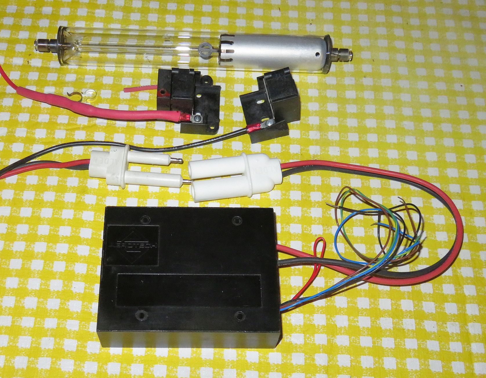

The HeNe laser tubes in these kits are typically 9 to 10 inches in length and may use either a DC-input or AC-input brick power supply. If the power supply has a female Alden high voltage connector, a short mating male Alden cable will be included. Where the diameter of the laser tube permits, a pair of plastic HeNe tube mounts will also be included.
(The style of some parts may vary slightly from what's shown in the photo.)
The following components are included:
NOTE: Most of these tubes have cathode-end output so touching that end of the tube will not result in a shocking experience. But do not touch the anode end or its wiring when powered or for a while after. It probably won't be lethal but tossing the entire rig across the room due to a reflex response is bad form and may impact your grade. ;-) More on this below.
