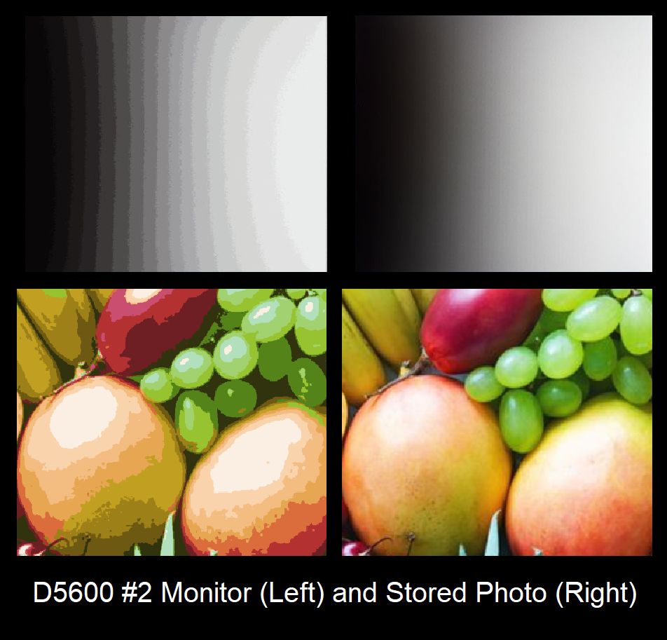

    To restore D5600 #2 to full functionality, the plan was to swap its back (including the LCD) with the one from D5600 #5.
    D5600 Back Housing Removal and LCD Flex Cable Replacement
    My intention had been to just swap the entire Back Housing along with the LCD, not to replace the LCD panel itself. But based on the more extensive disassembly required - particularly the need to remove and replace a rubber pad and grip (or at least peel them off of the heavy duty adhesive securing them) - the adage "if if ain't totally broke, don't try to totally fix it." ;-) In the case of D5600s #2 and #5, not much would be gained. So for now at least that will await a certifiably dead D5600 (but with a good screen) to cannibalize.

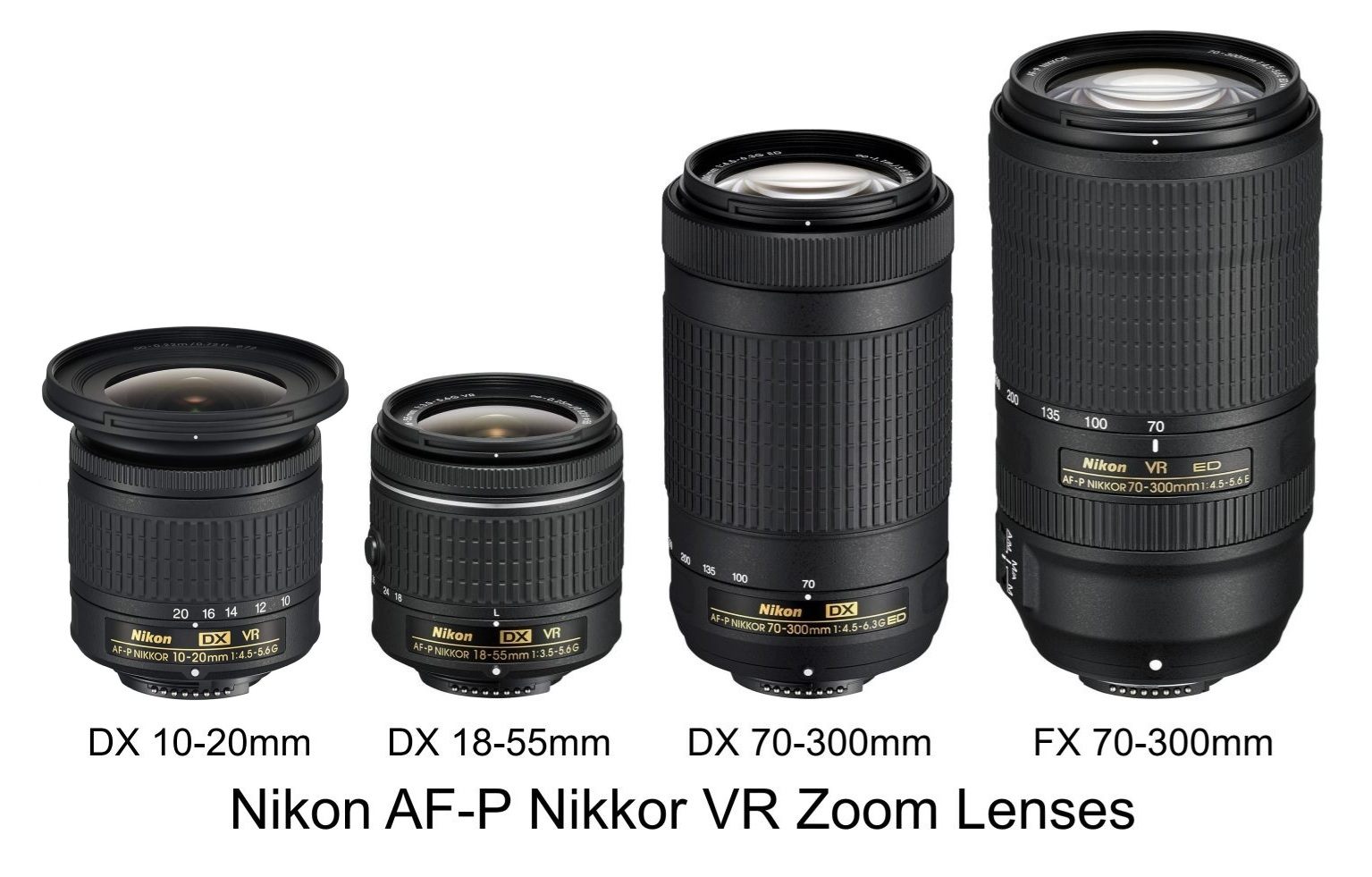

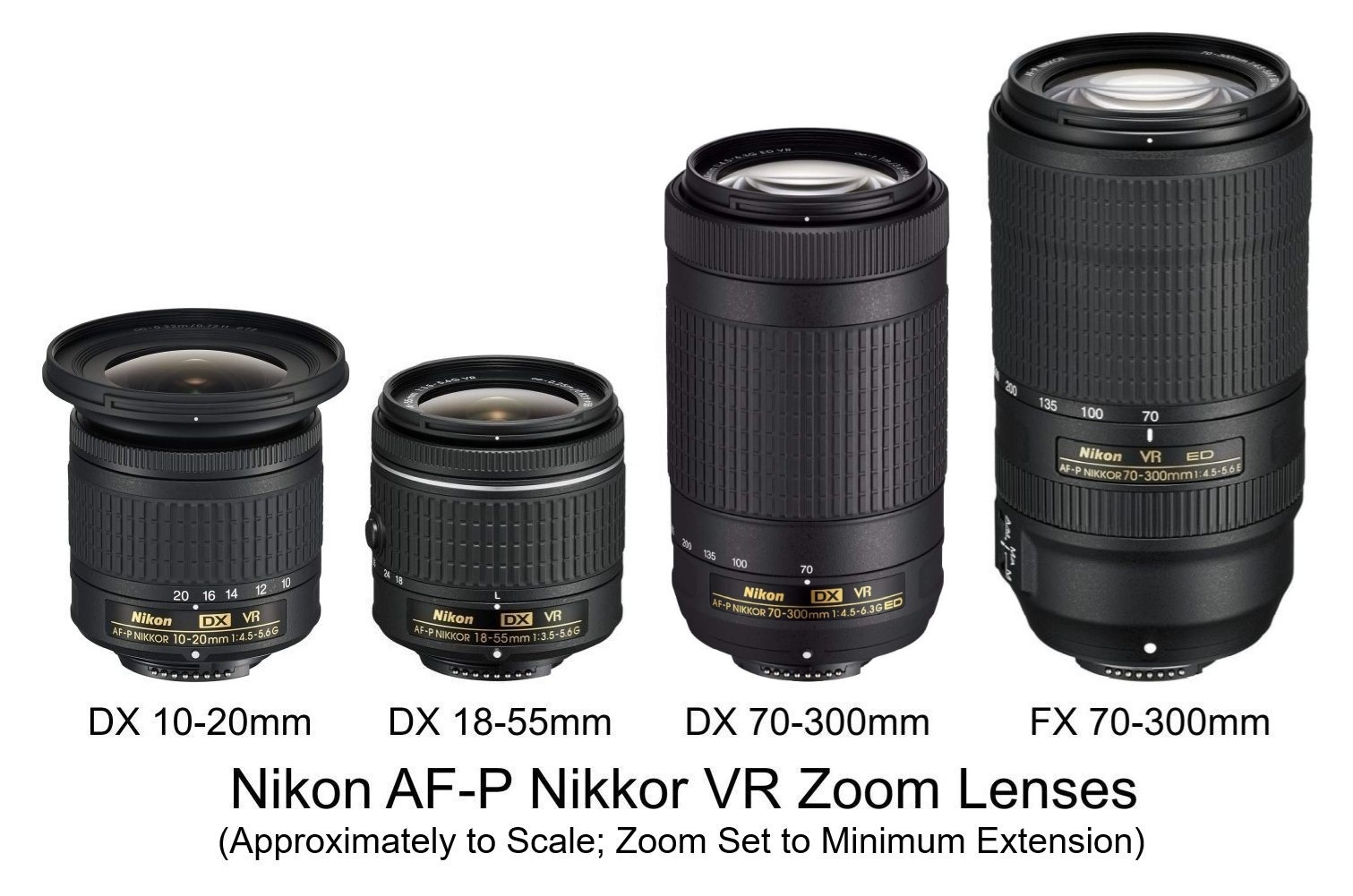

    Nikon AF-P Nikkor VR Zoom Lenses is a comparison of the 4 versions set at minimum length - thus 18 for the 10-20mm and L for the 18-55mm. The non-VR DX 18-55mm and DX 70-300mm appear identical except for the lack of the gold "VR" on the label.

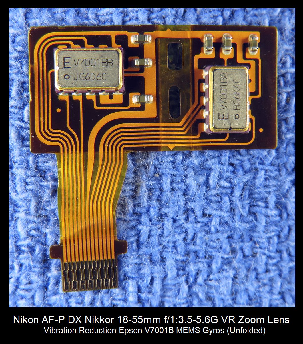

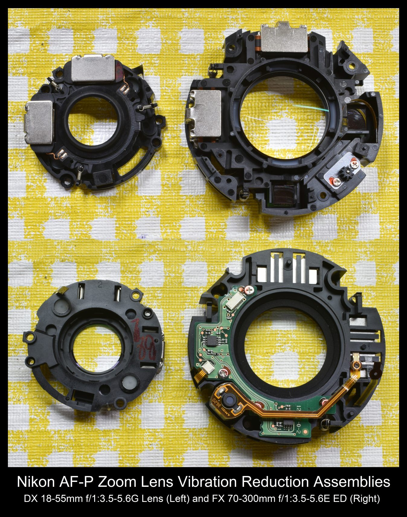

    Here is a comparison of the VR assemblies from the AF-P DX 18-55mm and AF-P FX 70-300mm lenses: Nikon AF-P Zoom Lens Vibration Reduction Assemblies. Their diameter is approximately 1.5 and 2.25 inches, respectively. Their ratio is the same as the DX:FX sensor size.
    Unfortunately, there do not appear to be on-line repair manuals for any AF-P lenses. The document dump that made repair manuals available for older lenses including most AF-Ss never took place for AF-Ps. Nikon has repair manuals of sorts on-line for some Z gear including lenses but not for AF-P lenses. "Of sorts" means they are along the same lines as the ones for the AF-S and other lenses, though some may have fancier multi-color diagrams. ;-)

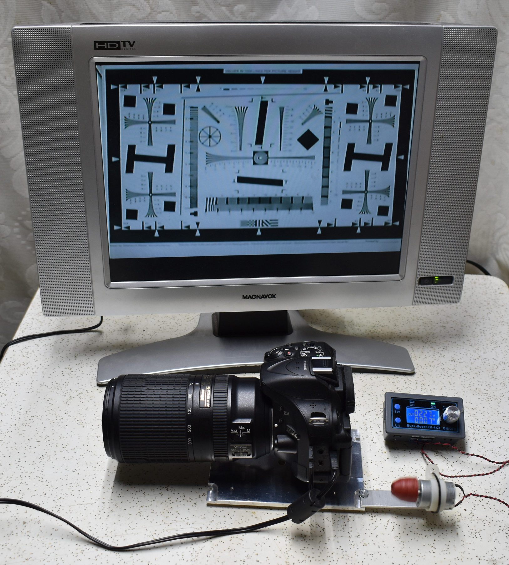

    In principle, a test setup with a camera in Live Mode aimed at a test chart feeding a video display could be used to fine tune the shim thicknesses. For the 1st Lens Cluster, this would be straightforward on lenses where it could be loosened slightly but not removed so that test shims could be inserted behind it. However, there would still be challenges depending on the video quality as the focus error for miniscule tilt will be down in the weeds. It may require making test shots with the aperture wide open and displaying them at full resolution. And your mileage may vary. ;-)

    As if that wasn't exciting enough, here is the good (VR) stuff. ;-)
    There must be some pretty fancy footwork going on in the algorithms on that CPU board to actually implement the VR. And the lens element must be maintained centered electronically when VR is on using the Hall-effect sensors for feedback. There is no restoring force so it will tend to sit at the lowest point. When VR is off, it will be more or less centered using the locking collar. The springs only keep it against the surface of the front cover.
    And you thought camera lenses were boring. ;-)

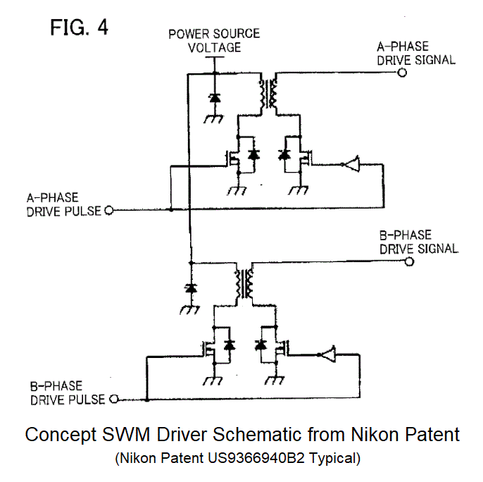

    While searching for another one to dissect, measurements of the SWM frequency provided a clue as to the design changes. A 6 turn sense coil was placed under the lens, which as before was determined to be the optimal location for a strong signal, probably in close proximity to the ferrite HV transformer(s). Rather than 77 kHz as in the original AF-S lens, the frequency for the AF-S II is around 290 kHz (!!) which was originally assumed to indicate a much smaller motor (though this turns out not to be the case, more below).
    When the focus ring is moving, the pulse width may be up to around 700 ns. But there is still a detectable very stable ~100 ns spike at the same frequency with similar amplitude for several seconds after the camera has beeped indicating that optimal focus has been achieved, not only while the focus ring is moving. So it is likely from the same source and not just pickup from the logic, perhaps a sort of dither to minimize stiction in the mechanism between focus operations.
    But it turns out that the SWM itself appears to be physically identical in both lenses. And the gear reduction is also similar. Then I thought perhaps the higher frequency was selected to be able to smaller magnetic components, but this also turns out not to be the case. So my conclusion now is that the higher frequency may have been selected primarily because it permits faster focusing or because of complaints from local bats. ;-)
    The physical size reduction of the VR II lens is thus accomplished by mostly clever packaging. ;-)

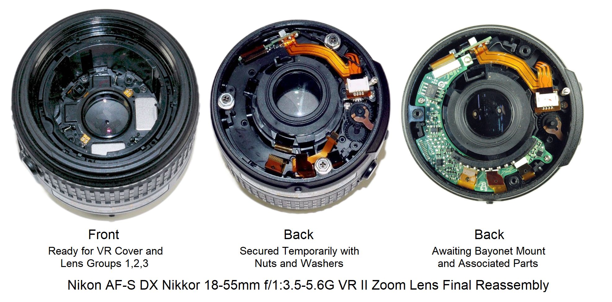

    1. Slide the Focus Assembly into the Zoom Shell and secure it with 3 screws. Slip the flex cable for the Focus Encoder and Tachometer through the slot in the between them taking care not to damage it. There is only one of the three orientations where these will mate properly.
    2. Slip this combined unit into the Zoom Barrel with the small dot on the Lens Hood Mount just beyond the 55 mark. The two pegs on the Fixed Barrel and plastic protrusion on the Zoom Shell should slip easily into the pair of tracks on the Zoom Barrel but will not go further.
    3. Gently pull the Fixed Barrel out so it extends as far back as possible.
    4. Replace the Zoom Brush using its screw.
    5. Replace the Focus Gear in the hole in the Fixed shell so that it extends and engages the rotating part of the focus assembly. If it doesn't reach, push the Fixed Barrel in very slightly.
    6. Insert the SWM Gear into the A/M fork on the Fixed Shell. The top has a ridge that will stay in the fork.
    7. Carefully position the Fixed Shell on the Zoom Barrel so the large dot lines up with the small dot on the Lens Hood Mount and just beyond the "55" on the Zoom Barrel. The Fixed Shell and Zoom Barrel should seat flush against each-other as they would be normally. (Later it will lock in place when toward "55".) Take care to avoid damage to the Zoom Brush. The 3 Bayonet Mount holes should line up with the mating holes in the Fixed Barrel and be touching or almost touching, but probably not fully seated.
    8. Place a 2-56 nut and 2-56 washer on each of the screws that attach the Fixed Shell to the Fixed Barrel. Gently thread each of these through the Fixed Shell into their mating holes on the Fixed Barrel to pull them together while attempting to turn the Zoom Barrel. Do not force anything. It should now be possible to rotate the Zoom Barrel normally to the Locked position. The nut and washer are temporary until the remaining parts of the back of the lens are replaced. If the Fixed Shell and Fixed Barrel are too far apart for the screws threads to engage, use only the washers until they can get a solid grip all around and then back them out and add the nuts. The screws should not bottom in the holes. Damage to these threads would be bad since the 3 screws secure the lens to the camera body.
      If the Zoom Barrel doesn't turn easily, use a thin piece of plastic to depress the (now hidden) pegs for lens groups 4,5,6 (middle lens cluster) just enough so they can slip into their tracks inside the Fixed Barrel while gently twisting the entire combined unit counterclockwise. Don't force anything. Didn't I say that already? ;-)
    9. It should now be possible to rotate the Zoom Barrel to the Locked position. Do NOT squeeze the Fixed Shell. Without the Bayonet Mount and associated parts being secured to the Fixed Shell, it will distort making it hard to rotate the Zoom Barrel. There are no precision roller bearings. ;-)
    10. Install the Spring Ground Contact using its 2 screws. This also serves as the zoom stop at the 55-end.
      See: Nikon AF-S DX Nikkor 18-55mm f/3.5-5.6G VR II Zoom Lens Final Reassembly. The nuts and washers substitute for the Bayonet Mount and associated parts prior to their installation. The photos show the lens in the Locked position.
    11. The Zoom Barrel should now rotate normally between Locked and 55 but no further with each part of the lens moving as it should. The screws, nuts, and washers installed above can probably be removed safely now since the Zoom Barrel will not be able to rotate past 55 where it could detach, but there is no harm in leaving them in place until final assembly.
    12. Install the Trim Ring so it seats in the six slots. The Trim Ring has 3-fold symettry so it will mate in 3 possible orientation and they are all equivalent. Secure it with the 1/4 inch gorilla-strength tape. ;-) I used Kapton electronic insulating tape but that is probably not optimal. Press the tape in place all around particularly on the 6 tabs.
    13. Slip the Rubber Grip over the front of the lens so it lines up with the Lock Button.
    14. Replace the Front Lens Cluster assembly by rotating it clockwise until it seats against the Focus Assembly. It should be snug but do not overtighten.
    15. Replace the model label. For reference, the left edge of the "D" in "DX" should line up with the dot on the Lens Hood Mount. This is really important! ;-)
    16. Attach the cable from the Camera (CPU) Contacts to the large white connector on the underside (actually the front) of PCB1 paying attention to orientation so the contact unit is oriented correctly. It presses in with no locking lever.
    17. Similarly, attach the Gyro Cable to the small connector on the underside of PCB1
    18. Install PCB1 and secure it with its 2 screws. Take care that none of the protruding flex cables get stuck under the PCB.
    19. Install each of the remaining cables. They press in place with no locking levers. Their locations and orientations should be self evident. ;-) On some, there is a small hole near the end of the cable that can be grabbed by a thin (but NOT sharp) tool to aid in insertion.
    20. Resolder the ground wire from the Spring Ground Contact to the pad on PCB1 if removed during disassembly. Make sure it is routed away from the center where it might get caught during zoom operation.
    21. Remove the 2-56 nuts and washers. DO NOT rotate the Zoom Barrel or pull on the Fixed Shell until the entire thing is secured to the Bayonet Mount.
      The right photo in Nikon AF-S DX Nikkor 18-55mm f/3.5-5.6G VR II Zoom Lens Final Reassembly shows its appearance now.

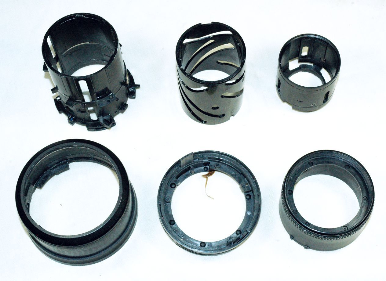

    Parts Naming
    (Some or most of these may not agree with how Nikon sees it as no internal diagrams or parts lists are available.)

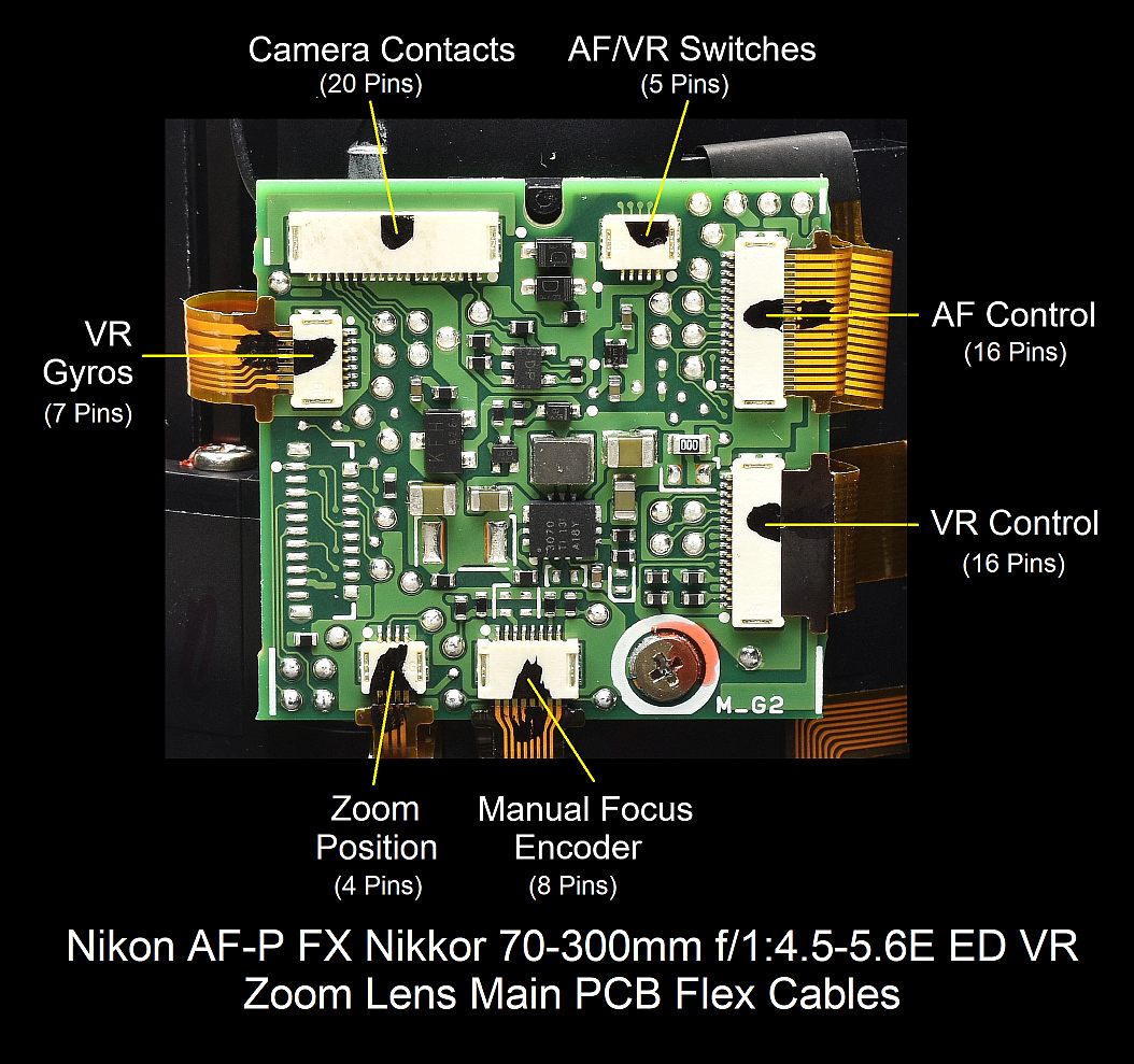

    6. Remove the two screws securing the Main PCB.
    7. Lift the Main PCB with the long ribbon cable so it detaches from the socket inside the lens. This may be easier than attempting to pull it off side-ways.
    8. Carefully flip the Main PCB over without detaching the soldered ground wire.

    Reassembly of the lens is now just the reverse of disassembly. Zoom should remain set to 55 mm. Take particular care not to stress the flex cable during the process. Or else you'll be doing this all over again. :( ;-)
    Nikon AF-P DX Nikkor 18-55mm f/3.5-5.6G VR Zoom Lens
    I have not found a repair manual or even an exploded diagram for this lens or any other AF-P lens. If anyone has one, please contact me via the Sci.Electronics.Repair FAQ Email Links Page.
    Nikon AF-P DX Nikkor 18-55mm f/3.5-5.6G VR Zoom Lens Description
    The following applies directly to the Nikon AF-P DX Nikkor 18-55mm f/3.5-5.6G VR Zoom Lens and mostly to the non-VR version as well. If fact, the only way to casually tell the difference is the lack of a "VR" on the body.
    This AF-P lens is optically very similar to the AF-S versions, above, but with one additional lens element. However, it uses the Nikon so-called "Pulse" technology (thus the "P" in AF-P) for autofocus instead of the "Silent Wave Motor" (SWM, or S in AF-S). Pulse autofocus is based on a stepper motor and does indeed appear to be quieter than silent. ;-) While SWM uses a piezo motor driven at an ultrasonic frequency (above human hearing) which in itself should be very quiet, the motor's rotating surface plate in contact with the actual PZT element, associated gear train, and other rotating parts makes detectable noise.
    So AF-P lenses return to motor technology with magnets and coils. ;-) As noted above, the "P" is supposed to stand for "Pulse", which kind of applies. They are claimed to be even quieter than AF-S lenses and that is probably true. The manufacturing cost is also much lower. ;-) And there have been comments on various forums about AF-S autofocus reliability, which is quite credible given their complexity and opportunities for contamination to get to the motor. And that they run on several hundred volts! So perhaps a little of both. Replacing the piezo motor with a stepper motor also allows the AF-P lens to be more compact since the motor itself is less bulky and the high voltage drive components and gear train are eliminated.
    However, AF-P lenses are not compatible with the D5100 or D3200 (or earlier) cameras that are happy with AF-S lenses. Others like the D5200 may need a firmware upgrade (but that is a free download). And since there is no VR switch on the AF-P lens, VR is always enabled on these cameras since there is no electrical contact in the camera body to control it. (The AF-P version has 8 contacts compared to 7 on the AF-S.) But this incompatibility is almost certainly due to a business decision for planned obsolescence. There would not appear to be any reason why an AF-P lens could not have been designed to look like an AF-S lens as far the the autofocus commands are concerned. Or at worst, with a way of selecting the mode via a switch
    The AF-P 18-55mm lens is also significantly narrower than the AF-S VR lens and very slightly narrower than the AF-S VR II lens which could be in part due to the more compact drive setup. The piezo motor has a relatively large diameter (almost 1/2 inch) and the gear train also takes up space. For smaller lenses like these, the only option is to increase its overall diameter. The stepper motor with its direct worm drive can greatly reduce the required space.

    The AF-P has 6 lens groups (unlike the AF-S that has only 4), though some may be single lens elements.
    The position of the 1st and 2nd-6th (in the same relative position) lens groups move independently depending on zoom setting. The position of the 3rd changes relative to the others depending on focus setting controlled by the stepper motor.

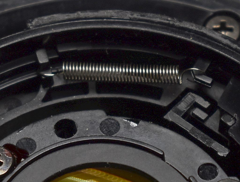

    1. Take a closeup photo of the tiny Apeture Spring that provides the restoring force for the Aperture Actuator. I doubt that replacing the spring reversed or backwards matters but a record of its original state won't hurt. Detach the spring taking care that it doesn't escape to be lost forever and doesn't get stretched or deformed. An unbent metal paper clip may come in handy here, and then to replace it below. For reference, here is a closeup: Nikkor AF-P Lens Aperture Tang Spring in Situ.

    3. Install the Aperture Spring. This is by far the trickiest of all the previous and subsequent steps except for the tinier spring that follows if it has been removed. ;( ;-) My approach is to hook it on the plastic peg that points toward the outside of the ring and then use a slightly hooked end of a small wire paper clip to pull the loop over the peg that points along the ring away from the other one. If that makes any sense! Keep a finger on the other end of the spring while doing this so if it slips, it won't go "twang" into a pile of debris on your workbench or floor or in your trashcan. Confirm smooth operation of the Aperture Actuator.
      (It may be possible and simpler to install the spring as part of Step 1 by slipping its ends on the two projections before rotating Aperture Actuator Ring into position.)

    Nikon AF-P DX Nikkor 18-55mm f/3.5-5.6G VR Zoom Lens Dissection
    There is a Web Album at Nikon AF-P DX Nikkor 18-55mm f/3.5-5.6G VR Zoom Lens Dissection Web Album. This begins with some stock photos and optical architecture and how the lens groups move with zoom. The back and front are then slowly disassembled, currently down to the point where the major sub-assemblies remain intact. Reassembly is straightforward up to this point IFF match marks were added - the major sub-assemblies have 3-fold symmetry and may appear to go back together regardless of orientation. But only 1 will result in a working lens. I also apologize for the sometimes inconsistent naming of the parts. Sorry.
    Where the parts like the Zoom Barrel are removed, match marks using latex pens in decorator colors ;-) were added to identify how they go back together. For clarity in the dissection photos, they are rather larger than needed. The same colors line up at the point where the major assemblies are removed or installed just beyond the 55mm setting, but do NOT line up when collapsed to the Locked position. With the match marks, reassembly from the "AF-P-DX-18-55mm-VR-Zoom_Core_Assemblies1" photo can be done in less than 1 minute. Without them, that can be long and frustrating since some parts can be initially installed at any 1 of 3 120 degree orientations even though many are not quite 3-fold symmetric, they may appear to fit initially but at the very least, they will get stuck as only one orientation is correct. This is actually visible with match marks in the Locked position: The 3 sets of adjacent match marks will not quite line up. So there is an offest of &plusnm; a few degrees relative to 120 degrees.
    The only part that is truly 3-fold symmetric appears to be the 1st Lens Cluster.
    Note that several samples of this lens were used for the dissection photos so the slight discrepancies in details are a known feature. Can you find them? The lighting also changed between some blocks of photos. And sometimes parts that were removed will reappear in subsequent photos. Live with it. ;-)

    Here is a montage of shots taken of a test chart at around 105 mm and f/5.6, 8, 16, and 32): Defective Nikon AF-S-DX-18-300mm-f3.5-5.6G-ED-VR #1: Zoom 105 mm Comparison. Zoom of 105 mm was selected simply because the chart filled the frame. (70 mm would be closer to the mean between 18 and 300 mm.) But it's no better anywhere else.
    Next, a HeNe laser beam was passed through the lens as on-axis from the input side aligned so that it passes centered through the stopped-down aperture. The beam has a near-perfect Gaussian profile with negligible scatter. The objective was to both look for the character of the reflections from the internal lens elements, and for any degradation of the quality of the Gaussian beam on a screen placed after the lens.
    On the good lens, there are a multitude of reflections but they are very weak as would be expected from high quality anti-reflection coated surfaces and can be totally superimposed in the reflection. On the bad lens, there also a multitude of reflections but 1 or 2 cannot be superimposed on the others. Exactly where they are coming from is unknown but is probably from an element before the aperture. The reflected spot is very small suggesting it is near the front of the lens but that can be confusing due to the combination of positive and negative lens elements. At first there was a bright off-axis spot which I got excited about. But that turned out to be a red herring: It was from the cheap non-AR-coated UV filter on that lens but not the other. The bad lens shows a bit of interference fringes on the transmitted beam while the good lens does not. These tests were done at a zoom setting of 18 mm. I'm not sure I'm determined enough to repeat them at 300 mm without a more stable fully adjustable test setup. ;-)
    So the 18-300 mm question is: Having eliminated 1st Lens Group alignment from consideration, what is the most likely part to fail from a minor traumatic event like whacking the filter ring or just from wear and tear? If the VR armature or its lens popped off the suspension or got stuck to one side, VR would not work at all. But VR works great. If any other lens group came off its tracks, there would be obvious problems with zoom or focus. Only if a lens element or elements) came unglued within their housing(s) could there be optical problems but no mechanical problems. If anyone actually reads this stuff ;-) and has a similar experience, knows the answer, or even has a wild guess, please contact me via the Sci.Electronics.Repair FAQ Email Links Page. For now, I'm not intending to go any further inside.

    PCB connectors based on dissection, below:
    From top-left clockwise:
    Or see: Nikon AF-P Nikkor 70-300mm f/1:3.5-5.6E ED VR Zoom Lens Main PCB Flex Cables.
    Errors are possible!

    Nikon AF Lens Zoom and Focus Roughness
    If you're used to the silky smooth operation of a classic Nikon lens like those for Nikon film SLRs, it will be a bitter disappointment to use a modern Nikon DSLR zoom lens. Lenses like the 50 mm f/1.4 "standard" lens or 43-86 f/3.5 zoom lens were works of art in comparison. They were mostly made of machined aluminum and well lubricated. Many samples 40+ years old still perform like new.
    Modern lenses are much more sophisticated and no one would want to go back to the fully manual older ones, but silky-smooth operation is not one of their features. And it's easy to see why. Most of the moving parts are made of plastic and a zoom lens has many of them. For example, see Major Moving Parts of Nikon AF-S DX Nikkor 18-55mm f/3.5-5.6G VR Zoom Lens. These all move when changing zoom or focus. The three cylinders at the top of the photo reside nested and rotate or slide with respect to each-other with a large surface area in direct contact. The center one is made of anodized aluminum with precisely milled slots that determine the required movement of multiple lens groups with respect to each-other when zoom is adjusted; the other cylinders are formed or molded plastic. The straight slots in the upper-left (outer) cylinder guide those moving parts that must not rotate. Pegs or rollers (without ball bearings) restrict their movement to the AND of the slots in the upper left and the other cylinders, but also add friction. Some parts reverse direction as the Zoom Barrel is turned, adding additional friction/resistance at that point. It's all rather intricate and I bet Nikon has a really nifty CAD package for zoom lens mechanical design. ;-)
    As an example of a common much larger lens, see the diagrams in Nikon AF-S DX Nikkor 18-200mm f/3.5-5.6G VR Zoom Lens showing Lens Group Positions at 18 and 200 mm. Lens Group 3 and the VR assembly move together, but those and all the others move relative to one-another and relative to the lens structure attached to the Nikon F mount.
    Even on a brand new lens, there is detectable roughness and varying resistance over some parts of the zoom range. Over time, the lens will be exposed to dust, moisture, and contamination either from normal use or from being tossed in a storage bag, it gets worse as there are no real seals. And plastic is subject to wear. The good news is that for the most part, none of this makes any real difference in picture taking performance. That is, until the thing seizes up completely or falls apart. :( ;-)
    But if the lens is dropped or whacked, parts like those pegs can get broken off or may dig into the tracks with varying degrees of damage. In minor cases, the roughness will just become worse but with enough trauma, major functions will stop working. When considering the purchase of a used lens, carefully check autofocus, manual focus, and vibration reduction, as well as for correct operation of the aperture at all zoom settings. Don't accept a lens where manual focus doesn't work reliably even with a discount (as I once did) because the seller said no one ever uses it. While that may be partially true, unreliable manual focus can be a symptom of more major problems. One thing that is often broken on used lenses though is the Lock button if there is one, used to secure the lens in a compact state for storage. The internal lip that the button engages is made of plastic and users often attempt to twist the Zoom Barrel without realizing it's locked, so that lip gets damaged and the button non longer works properly. That alone is probably not sufficient reason for rejecting a lens - but perhaps it may be leverage to negotiate a discount! While Lock may not work or work well, the end-stops for the Zoom Barrel should not be affected. But this should be confirmed as bad things may happen on some lenses if the Zoom Barrel is rotated beyond the normal range.
