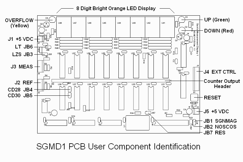

SG-MD1 is a 5.5" x 4" PCB that attaches to the REF signal from an HP/Agilent
or similar two-frequency laser, and the MEAS signal from an optical
reciever through an interferometer returned from a movable retro-reflector
(mirror or cube-corner), and provides a visual
readout of position change in increments of the wavelength of light at
632.8 nm. The intent of this system is to be used to demonstrate
the principles of precision measurement based on two-frequency laser-based
interferometry.
Photo of SG-MD1 PCB in Action

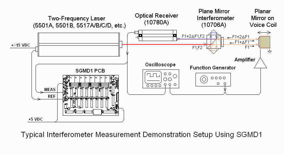

In a nutshell, the two-frequency laser sends out a pair of superimposed
beams that differ in frequency by a relatively constant amount (called
REF), one polarized horizontally and the other polarized vertically. Optics
separate the two beams sending one to a (generally) fixed reflector,
and the other to some tool or device whose position needs to be
measured precisely. Both beams then return to an optical receiver
where the difference frequency (called MEAS) is generated. With no
movement, the phase relationship between the two beams is constant and MEAS
equals REF. But if the tool or whatever moves, the frequency and thus
phase relationship between REF and MEAS will change due to doppler shift.
A phase change of 360 degrees represents a position change of 1/2
wavelength of the light from the laser, approximately 632.8 nm for
the HeNe lasers most often used. The precise wavelength is nominally
632.991372 nm with a wavelength accuracy of 0.1 ppm for the typical
HP/Agilent laser.
Using the two-frequency approach rather than a basic Michelson or
similar interferometer, among other things makes these systems
more immune to misalignment by eliminating issues of fringe counting
and direction, and fringe contrast.
In the diagram below, SG-MD1 replaces the "Signal Processing" block
and provides a means of demonstration the basic principles of
precision measurement using two-frequency laser interferomtery.
Aside from the low cost, this also allows for much more hands-on
since the schematics are available and all signals are accessible
for monitoring.
SG-MD1 is conceptionally quite simple. It consists of dual differential
line receivers for REF and MEAS, edge detection, synchronizer, 8 digit
BCD up/down counter and display, UP and DOWN monitor circuit, and control PAL.
- Dual differential line receivers: REF and MEAS are applied to
the UA9639 (U2) with the resistor networks R1-R3 and R4-R6 used to
set input levels for either single-ended or differential operation.
The output of U2 should be TTL level squarewaves (approximately) for
REF and MEAS.
- Edge detection: The cleaned-up REF and MEAS signals
may be applied to a dual D-FF 74LS74 (U3) used to divide each by 2.
The edges of the resulting waveform now represent the locations
interest. By dividing by 2, the frequency of operation of subsequent
circuits is essentially halved as well. If the D-FFs are bypassed,
the resolution is doubled (smallest increment is halved). More on
this below.
- Synchronizer: The first stage of the 8 stage 74LS164 shift
registers (U4 and U5) synchronize the REF and MEAS edges with the system
clock. The next 7 stages are used to reduce the probability of metastability
to less than 1/(age of Universe). :) The metastability isseu is the
possibility that the asynchronous edge will be sampled precisely when
it is changing, resulting in indecision in the sampled result. This
can produce a voltage in between legal TTL levels which persists for
a time much longer than the propogation delay specifications of the
flip-flop inside the shift register. This phenomenon is not generally
taught in Intro to Logic courses but can be responsible for infrequent
but catastrophic failures in logic systems. It is a fundamental
consequence of the uncertainty prinsiple and can never be eliminated
entirely. But with 7 additional shift register stages,
the chance of this bogus level making it to the subsequent logic
is minimized.
If it could be guaranteed that REF and MEAS edges would never be coincident,
the synchronizer wouldn't be needed and the up/down counter could be
driven directly. However, nearly coincident pulses to the up/down counter
would result in unpredictable behavior - counts could be dropped, extra
counts could be introduced, and the counter could even count incorrectly.
Since REF and MEAS are locally asynchronous based on the motion of the
remote retro-reflector or mirror, the relative timing of the edge is
totally arbitrary.
- 8 digit BCD up/down counter and display: U21-U28 (74HC192
BCD up/down counter with separate Up and Down clock inputs),
U31-U38 (74LS47 seven segment decoders), and U41-U48 (high brightness
orange seven segment LEDs) provide this function.
- Up and Down monitor circuit: The dual monostable (U7, 74LS123)
drives Up (green) and down (red) LEDs. The respective LED is pulsed
only when 2 Up or Down pulses occur in a row. This elminates the constant
activity that would otherwise be present.
- Control PAL: U6 is the magic sauce that drives everything else. :)
The logic inside U6 looks at the REF and MEAS edges and converts these
to Up and Down pulses to the counter and monitor LEDs. Depending on mode,
it may suppress strictly alternating Up and Down pulses to eliminate
activity in the display when the position isn't changing. Simultaneous
Up and Down pulses are always suppressed. It also
provides the proper signals to implement signed-magnitude mode in the
unsigned BCD counter including the Sign Overflow bits.

Note that some basic soldering/assembly skills will be needed to wire up
the cables to the power supplies, laser, optical receiver, and SG-MD1.
If that capability is NOT available, then consider a complete system
with SG-MD1 included instead.
In addition to the SG-MD1 PCB, the following must be provided:
- DC power supply: Either a lab supply, a linear or switchmode wall
adapter can be used, or something else that produces 5 VDC at 1 amp
or more. But it must be regulated with an allowable voltage range
under load of 4.75 to 5.25 VDC. If in doubt about the regulation,
measure the output of the candidate power supply with no load. A
regulated supply will read close to 5 VDC even with no load, but a
typical unregulated wall adapter might read 50 percent high - or more.
Note that while some lasers provide a 5 VDC output, this likely does not have
sufficient current capacity, so a separate 5 VDC supply will probably
be required.
There are two power connectors on the PCB. While either one can power
the unit alone, it is recommended that power be attached to both to best
distribute the current. Cables with suitable connectors already
attached are included with SG-MD1. Double check polarity before applying
power! The PCB is reverse polarity protected but your power supply will
see a near-short circuit if wired backwards!
- Two-frequency HeNe laser with a beat frequency between 100 kHz and 4 MHz.
The easiest laser to use would be a Hewlett Packard (HP) or Agilent 5501A/B,
5517A/B/C/D, 5518, or 5519A/B, with the standard cable for power and REF.
However, it's also possible to use an Excel laser (which should be
functionally equivalent) or even a Laboratory for Science or some
other similar laser instead. Zygo may also have a suitable laser, though
the ones I'm aware of have a beat frequency that is way too high.

- Source for REF: The HP/Agilent lasers provide this output as a differential
pair that can be attached directly to SG-MD1. But a non-polarizing
beamsplitter to sample a portion of the laser beam, with an HP/Agilent
optical receiver could also be used if the laser doesn't provide REF
internally (as when using a very weak laser). Or rather than a commercial
optical receiver, a polarizer at 45 degrees, silicon photodiode, and
resistor can be used instead to produce the electrical REF signal.
However, non-standard resistors on the REF input to SG-MD1 may be
needed to accomodate your voltage levels.
- Interferometer optics: These can be any of the configurations discussed
in the chapter: "Laser Instruments and Applications". The simplest would
be a so-called "linear interferometer" with remote retro-reflector
(cube-corner). Either a commerical (e.g., HP/Agilent 10702A/10703A)

Seven two-pin headers set up SG-MD1:
- Signed-Magnitude Select (SGNMAG, JB1): Open for Signed-Magnitude,
installed for unsigned.
- No Single Count Oscillation Suppression (NOSCOS, JB2): Installed to
disable Single Count Oscillation Suppression (SCOS). Note that having SCOS
enabled will result in 1 count hysteresis on the measurement output but
less activity on the display if the position isn't changing. SCOS is always
applied to the UP and DOWN monitor LEDs.
- Leading Zero Suppression (LZS, JB3): Installed for leading zero
suppression. (Must be installed if using Signed-Magnitude mode.)
- D30 (JB4) and D28 (JB5): 4,000,000 and 1,000,000 initial
count for RESET. Open for "1". D30 MUST be 0 in Signed-Magnitude mode.
- Lamp Test (LT, JB6): Install to force all segments on. With
reliable LED displays, the main use of LT may be to check maximum power
supply current!
- Resolution (RES, JB7): This jumper determines
whether only the rising edge (X1), or both edges (X2) of the REF and MEAS
signals are used in the position determination. Install for X2. Using X2
will produce correct results on average, but may be more sensitive to jitter
from a weak MEAS signal.
The connectors on the SG-MD1 PCB are:
- Power (J1 and J5, 2 pin, +5 VDC at 1 amp max.): As noted above,
attach the power cable provided to your regulated DC power supply.
- REF (J2, 4 pin): Pins 1 and 4 are the differential inputs;
pins 2 and 3 are ground.
- MEAS (J3, 4 pin): Pins 1 and 4 are the differential inputs;
- External Control (J4, 8 pin): This provides an external RESET
input as well as outputs several useful signals:
Pin Function Comments
1 GND
2 RESET_L External reset (low asserted)
3 GND
4 MONCLK_P Negative going pulse to monitor LED monostables
5 UP_H High during clock cycle counter is to go up.
6 DOWN_H High during clock cycle counter is to go down.
7 OVFLQ_H High if overflow in Signed-Magnitude mode.
8 NC
- Counter Output Header: This is a 40 position set of pads which
will accept a SIL header to monitor the 32 bit output of the counter
(8 digits or 7-1/2 digits plus sign). It includes several ground pins
as well. Since these signals are not buffered, it is recommended that
wiring length be minimized to minimize the chance of peculiar behavior.
Pin Function Pin Function Pin Function Pin Function
1 GND 11 GND 21 GND 31 GND
2 CQ1 12 CQ9 22 CQ17 32 CQ25
3 CQ0 13 CQ8 23 CQ16 33 CQ24
4 CQ2 14 CQ10 24 CQ18 34 CQ26
5 CQ3 15 CQ11 25 CQ19 35 CQ27
6 NC 16 NC 26 NC 36 NC
7 CQ5 17 CQ13 27 CQ21 37 CQ29
8 CQ4 18 CQ12 28 CQ20 38 CQ28
9 CQ6 19 CQ14 29 CQ22 39 CQ30
10 CQ7 20 CQ15 30 CQ23 40 CQ31
The only user control is the RESET button. :-)
The main readout is an 8 digit high brightness orange seven segment
LED display.
- In unsigned mode, the entire 8 digits (99,999,999) is available
for position measurement. This results in a totally ridiculously
high range of 30 meters with a single beam or linear interferometer.
or 15 meters with a plane mirror interferometer.
- In signed-magnitude mode, 7-1/2 digits (+/-19,999,999) are available
range of +/-6 meters with a single beam or linear interferometer.
or +/-3 meters with a plane mirror interferometer) The "-" segment
of the MSD is used as the sign.
A yellow OVERFLOW LED will be turned on should the count exceed the
allowable range of +/-1,999,999. Once overflow is detected, the display
resets to 0 and won't change until the RESET button is pushed or the
RESET_L line on J4 is asserted. However, the monitor LEDs will continue to
function.
The UP (green) and DOWN (red) monitor LEDs provide a rough indication
of measurement activity. Each of these are pulsed on by a retriggerable
monostable when an up or down pulse is generated. Note that the activity
of these LEDs is independent of the setting of the NOSCOS jumper - they
always only show activity that isn't strictly altnernating up and down.
In other words, two successive MEAS pulses without a REF pulse is required
for the UP LED to pulse, and two successive REF pulses without a MEAS pulse
is required for the DOWN LED to pulse.

A sample diagram of a configuration using a plane mirror interferometer
and voice coil poisitioner with SG-MD1 is shown in:
The function generator provides a means of moving a mirror by a very small
and well controlled amount, with its signal monitored by an oscilloscope.
This could be done in a variety of other ways, including simply a micrometer
adjustmentable linear stage.
A version using a plane mirror interferometer is shown, because that
makes more sense for attaching to a loudspeaker than a bulky cube-corner.

Power the laser and optical receiver and wait for the laser to come READY.
- Once the laser and other components are in the general position of where
they are to be located, first align the laser beam with the interferometer.
For a single beam interferometer, the laser beam should be centered
within the clear aperture. For a linear or plane mirror interferometer,
it should be offset about 1/4 inch horizontally from the center, resulting
in a return beam for F2 (without the remote retro-reflector) of about
1/2 inch. This spacing is not critical as long as both the outgoing
and return beams aren't cut off. The interferometer and laser beam
axes should be aligned.
- Align the optical receiver (or photodiode) with the return beam.
There may be a detected signal even without the remote
reflector, especially if the laser is higher power (e.g., 400 uW).
This is due to imperfect coatings and imperfect alignment. Monitor
the signal level (there is a testpoint on the HP/Agilent recievers for
this) and fine tune the interferometer alignment to minimize it.
- Set up the remote cube-corner or mirror (as determined by the
specific interferometer configuration) so that its return beam
is precisely superimposed on the return beam to the optical receiver.
At this point, there should be s strong signal. If you have an oscilloscope,
it will be at the REF frequency of the particular laser and should
appear clean with minimal jitter.
