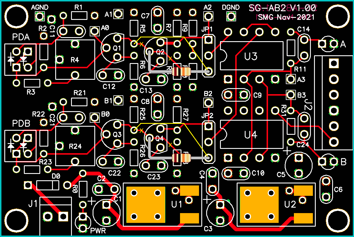

The actual SG-AB2 PCB is four layers with internal power and ground planes.
And yes, a careful examination will show that a couple parts do not match
the schematic or layout, below. Some experimentation is underway, and there
is a minor "oops". ;-) More on that later. And I was all out of red LEDs,
so the A SIG LED is orange for the photo. ;-)

The graphic below shows the general appearance of the PCB with most of the parts installed:
All components are through-hole except for the voltage regulators (U1 and U1), and except as noted in the detailed assembly procedure, should seat flush on the PCB. They shouldn't be suspended in mid-air swinging in the breeze. :) The resistors in particular like to not stay flat on the PCB unless their leads are bent at a steep angle. Most components are identified on the silk-screen and with only a few exceptions, the label won't be obscured when the part is installed.
