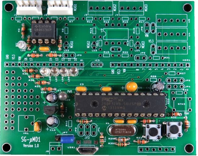

SG-µMD1 V1.0 Single Axis PCB shows the PCB populated with the parts for a single axis system without sensors. However, R34 and R35 are not needed unless programming the PIC32 from an IDE like MPLAB, and the JP7 header and the blue jumper would normally be replaced with a wire. :) The input terminating resistors for REF and MEAS1 (R1,R2,R6,R7) have not been installed since their value may depend on the specific configuration, and in many cases can be omitted entirely.

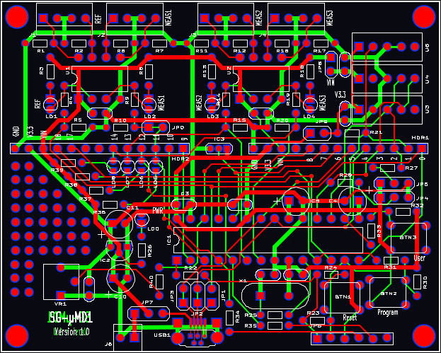

SG-µMD1 PCB Layout Version 1.0
Refer to the SG-µMD1 board layout below.
SG-µMD1 V1.0 PCB Layout Diagram (Left) and Single Axis Populated PCB (Right)
As can be seen by comparing this layout with that of the chipKIT board, most parts are in similar locations. The USB connector has moved to the bottom of the board along with its associated jumpers. The Arduino headers have moved slightly and there are now complete layout patterns for up to 3 measurement channels and locations for the environmental sensors.
For use with environmental sensors, additional components will be required that are not part of the standard SG-µMD1 kit.
The populated PCB shows all components required for a single axis system without sensors. R34 and R35 are not needed unless programming the PIC32 from an IDE like MPLAB. JP7 and the blue jumper would normally be replaced with a wire. :) The missing jumpers are either not needed or bridged by a trace on the underside of the PCB. The terminating resistors (R1,R2,R6,R7) have not been installed since their value may depend on the specific configuration.
