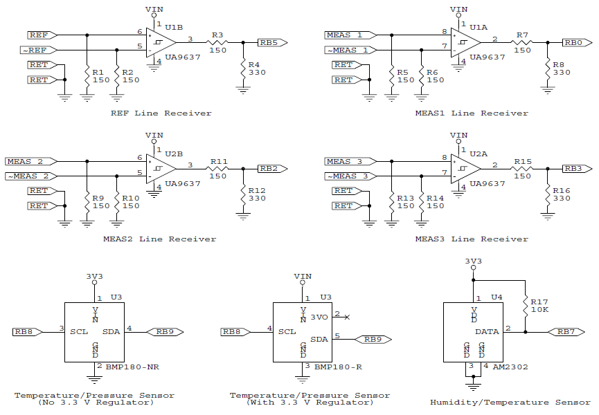

Schematic using the chipKIT DP32
Here is the schematic for µMD1 parts used with the chipKIT DP32 version along with the optional environmental sensors. Only the top circuits using U1 are required for a single channel system. (The schematic of the chipKIT DP32 board itself may be found at chipKIT DP32 Schematics (PDF).)
µMD1 Interferometer Signal Inputs and Sensors Schematic
The only jumper that should remain for a system without environmental sensors is the one for voltage select on JP7 in the lower left of the photo, above.

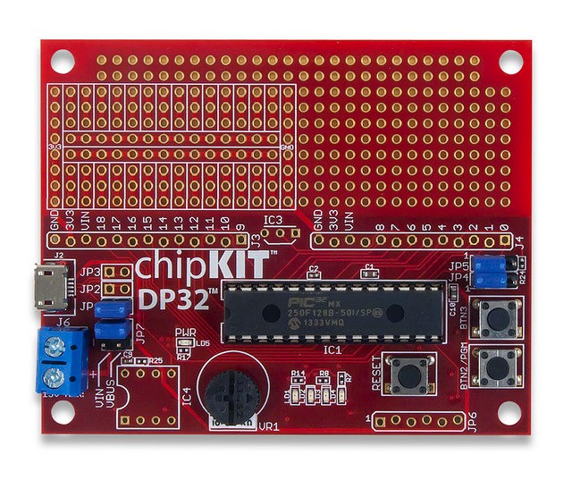

chipKIT DP32 Jumper Settings
Remove all jumpers if the chipKIT DP32 board was purchased from an electronics distributor.
chipKIT DP32 PCB Board Top View (Signal Labeling)
For a single axis system without environmental sensors, the only jumper that should remain is the one on JP7 in the lower left of the photo, above.

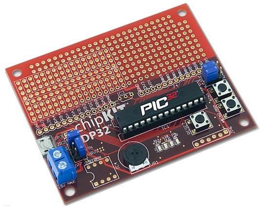

The numbers refer to standard Arduino signal "pin" designations while the RPBs refer to DP32 PORT A or B bits. The photo of the chipKIT board, below, has the Arduino designations. This is revision C and is what Digkey has been shipping. It also has the power LED, so perhaps that's an addition. :) The relevant board wiring is the same for the two versions, it's just the silkscreens that differ. But there are apparently older versions that may not be the same.
Note 1: The jumpers on JP7 are NOT in the correct position for our needs in the photo below.
Note 2: VIN MUST be +5 VDC to use the chipKit DP32 with µMD1 parts.
chipKIT DP32 PCB Board Top View (Arduino Labeling)
CAUTION: Most PIC pins are NOT 5V tolerant - they will be unhappy if a 5 V signal is connected to them directly. Thus VIN (5V) or any signal that may go higher than 3.3V should NEVER be connected to them, even for an instant. Bad things may happen. 3.3V is acceptable through a current limiting resistor (just to be doubly safe, for the micro that is). Hooking raw power to what may be a logic output (accidentally or otherwise) is never a good thing! P.S. "Unhappy" and "Bad things may happen" could mean that you'll ruin the PIC chip.

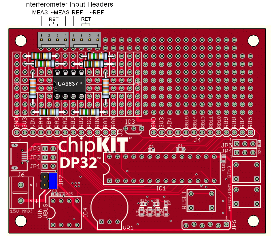

Wiring the basic system - single axis, no sensors
  1. Install the 8 pin socket in any convenient location (though a suggestion is shown below). Orient it with pins 1-4 facing the DP32. Take note of the rows of pads that are connected on the PCB as indicated by white boxes surrounding them. These can be convenient to minimize jumpers and for common wiring, but may be confusing to the uninitiated. If using them, a recommended location for the DIP is near the middle of the area with connected pads straddling the long strips for power and GND. Note that the GND, 3V3, and VIN labeling apply ONLY to the single pads of J3 and J4, not the boxed in connected pads near them!
  2. Vcc (pin 1) goes to a VIN pad.
  3. GND (pin 4) goes to a GND pad.
  4. The four 150 ohm RS422 terminating resistors go between 1IN+,1IN-,2IN+,2IN- (pins 5,6,7,8) and GND pads.
  5. REF and ~REF input pins go to 2IN+ and 2IN- (pins 6 and 5) respectively. REF Return goes to GND. See note below about the returns in the cables.
  6. MEAS and ~MEAS input pins to 1IN+ and 1IN- (pins 8 and 7) respectively. MEAS Return goes to GND. See note below about the returns in the cables.
  7. 2OUT (pin 3) goes to a 150 ohm resistor. The other end of this resistor goes to a 330 ohm resistor and its other end goes to GND. The junction of the two resistors is the REF clock signal and goes to pad RB5. This voltage divider assures that the standard TTL output of the line receiver provides a 3.3 V compatible signal.
  8. 1OUT (pin 2) goes to a 150 ohm resistor. The other end of this resistor goes to a 330 ohm resistor and its other end goes to GND. The junction of the two resistors is the MEAS clock signal and goes to pad RB0. This voltage divider assures that the standard TTL output of the line receiver provides a 3.3 V compatible signal.
The graphic below shows a suggested layout for the line receiver, the required resistors, and the jumper location. 4 pin headers are shown for REF and MEAS. Their presence and type are optional but the use of some type of connectors is recommended. This view is of the bare chipKIT PCB as it would look with no other parts present.
chipKIT DP32 PCB Board Pattern with Suggested Parts Layout
(If constructing a multiple axis system and/or one with environmental sensors, there is more below on the suggested layout.)
It is recommended that bypass capacitors (0.1 µF ceramic and 22 µF electrolytic typical) be installed between Vcc and GND of the line receiver(s) as close to the chip(s) as possible. While I have not seen problems with power supply noise, others have, though it's not clear under what conditions. But bypass caps are inexpensive insurance. :)
For those not familiar with the common resistor color code (Black/0, Blown/1, Red/2, Orange/3, Yellow/4, Green/5, Blue/6, Violet/7, Gray/8, White/9), the resistors shown above are 150 ohms (brown-green-brown or 15 with 1 zero) ohms and 330 ohms (33 with 1 zero) ohms. The gold stripe indicates 5 percent tolerance on the value but for the use here, tolerance doesn't matter. (It's possible the resistors you use will have 4 stripes where 3 of them are the value and the 4th is the multiplier, along with one for tolerance. If in doubt confirm the value with a multimeter.) The chart below is from Digikey. (If the link decays, a Web search will readily find another one.)

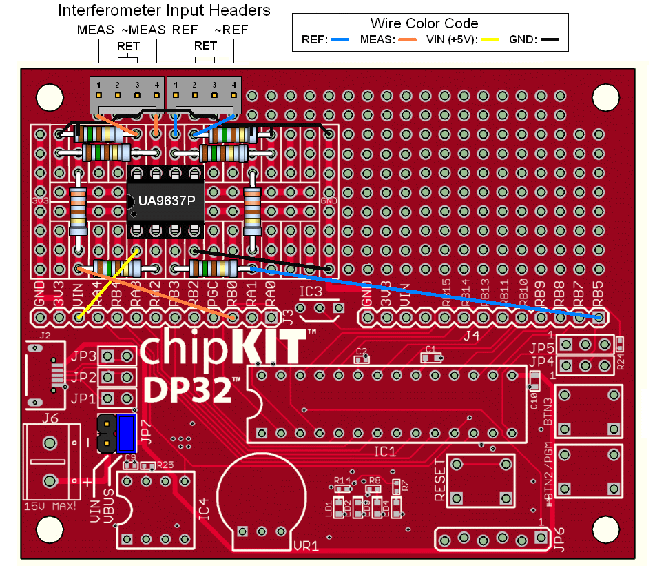

Below is the suggested wiring arrangement, color coded to differentiate REF, MEAS, VIN, and GND. It's not critical, but keeping wires short will minimize confusion. For the long runs, use thin insulated hookup wire or wirewrap wire. There are no issues of high current :) so #30 AWG is fine for all connections. The short (GND connections) can be done with bare wire. This should all be on the bottom of the board. Poke the stripped end of the wire through any convenient hole that is close to and electrically connected to the correct signal, or wrap it around the end of the resistor lead or connector pin before soldering.
chipKIT DP32 PCB Board Suggested Wiring Routing
For a 2 or 3 axis system, especially if adding environmental sensors, it may be desirable to squash this layout somewhat to make space for a second dual line receiver. This can be done easily by standing up some of the resistors. And/or use a quad line receiver chip. However, the layout below which replicates the pattern for a second RS422 line receiver will work. But note that most of the pads used by additional parts are NOT bussed so interconnecting them will have to be done by running jumper wires.
For the environmental sensors, the diagram shows headers to attach extension cables so that the sensors can be mounted close to the interferometer setup. It is also possible to mount them on the board directly in place of the headers. But generally, the sensors should be located where the relevant environmental conditions are present, though only the temperature is at all likely to differ, and possibly be affected by the (very slight) power dissipated on the board. (Unless your interferometer is in a vacuum chamber!) The signals are all low frequency so a reasonable cable length can be used without concern for shielding, crosstalk, or frequency response. But using twisted pairs is probably prudent for anything longer than a few feet. Also note the additional jumpers at JP4 and JP5.
Once the board has been wired, mounting it in such a way that the bottom can't touch anything and short out is highly recommended. Use standoffs in the four corner holes or something similar, and an insulating sheet under it.

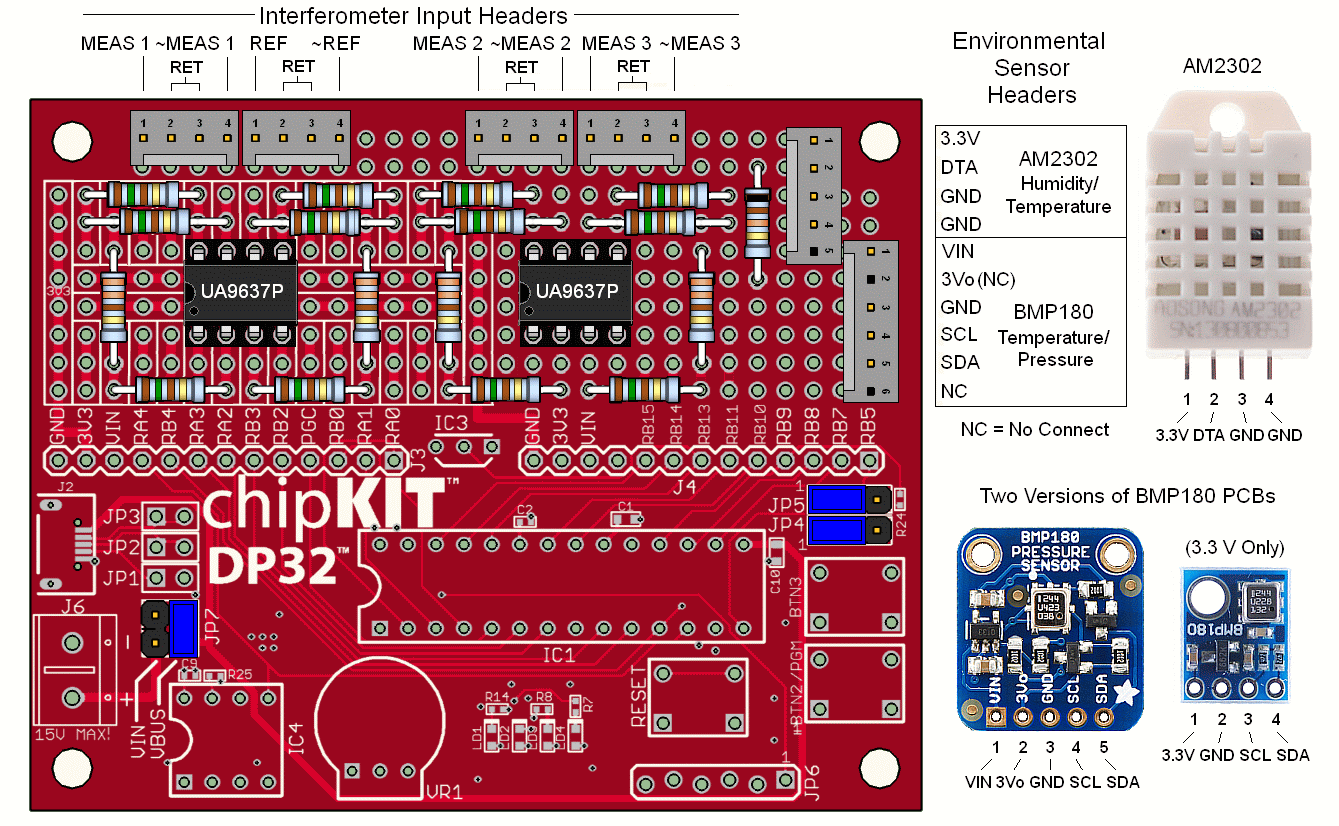

chipKIT DP32 PCB Board Pattern with Suggested Parts Layout for Multiple Axes and Environmental Sensors
If using the suggested layout, most of the pads are NOT connected together so this will need to be done with jumpers.
Wiring the BMP180 sensor
Important: There are at least two different pinouts for the 5 pin version of the BMP180 and yours may not agree with the photo, above. Adjust pin connections accordingly. In addition, VIN may be called Vcc and 3Vo may be called 3.3V. However, they are the same function.
Select a location on the chipKIT board that does NOT have connected pads. The BMP180 can be soldered directly to the board, installed in a socket, or run remotely via a cable.
  1. Identify the version of the BMP180 you have and suitable locations on the chipKIT board that do NOT have connected pads. Use the labels on the BMP180 PCB to identify the signal pins, NOT their location.
  2. GND goes to a GND pad.
  3. SDA goes to RB9.
  4. SCL goes to RB8.
  5. Install jumpers at locations JP4 and JP5 as shown in the diagram, above.
Wiring the AM2302 sensor
Select a location on the chipKIT board that does NOT have connected pads. The AM2302 can be soldered directly to the board, installed in a socket, or run remotely via a cable.
  1. 3.3V goes to a 3V3 pad.
  2. Both GND pins go to a GND pad.
  3. DTA goes to RB7.
  4. Install a 10K ohm resistor between DTA and 3.3V.
