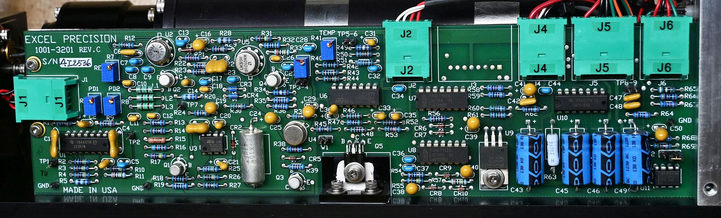

     *Excel 1001A/B/F              AZ M        20 (unspecified time)

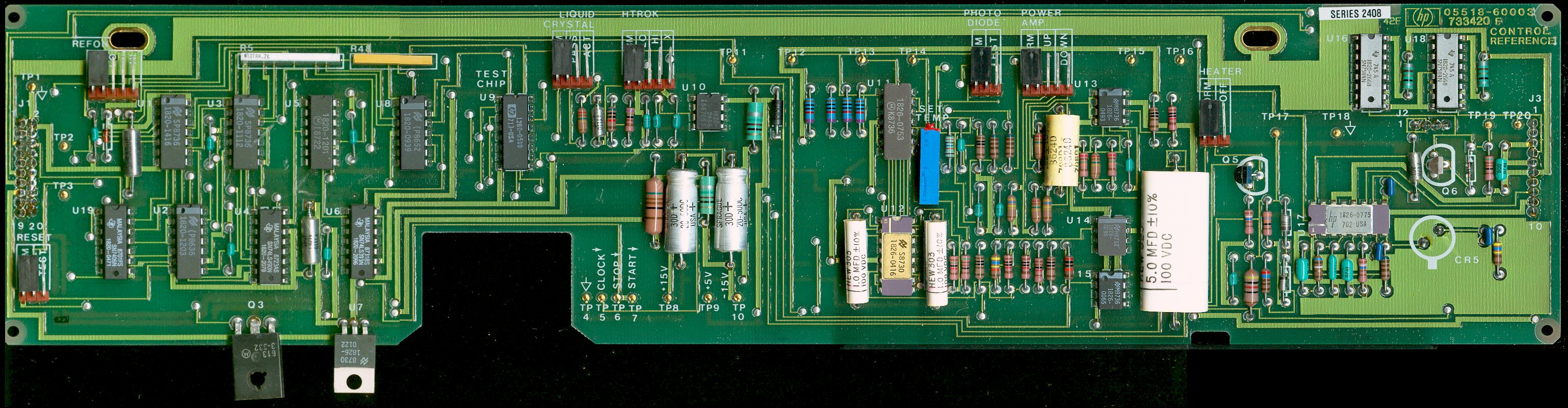

     *HP-5500A/B/C, 5501A/B        AZ M                       +/-2          +/-20

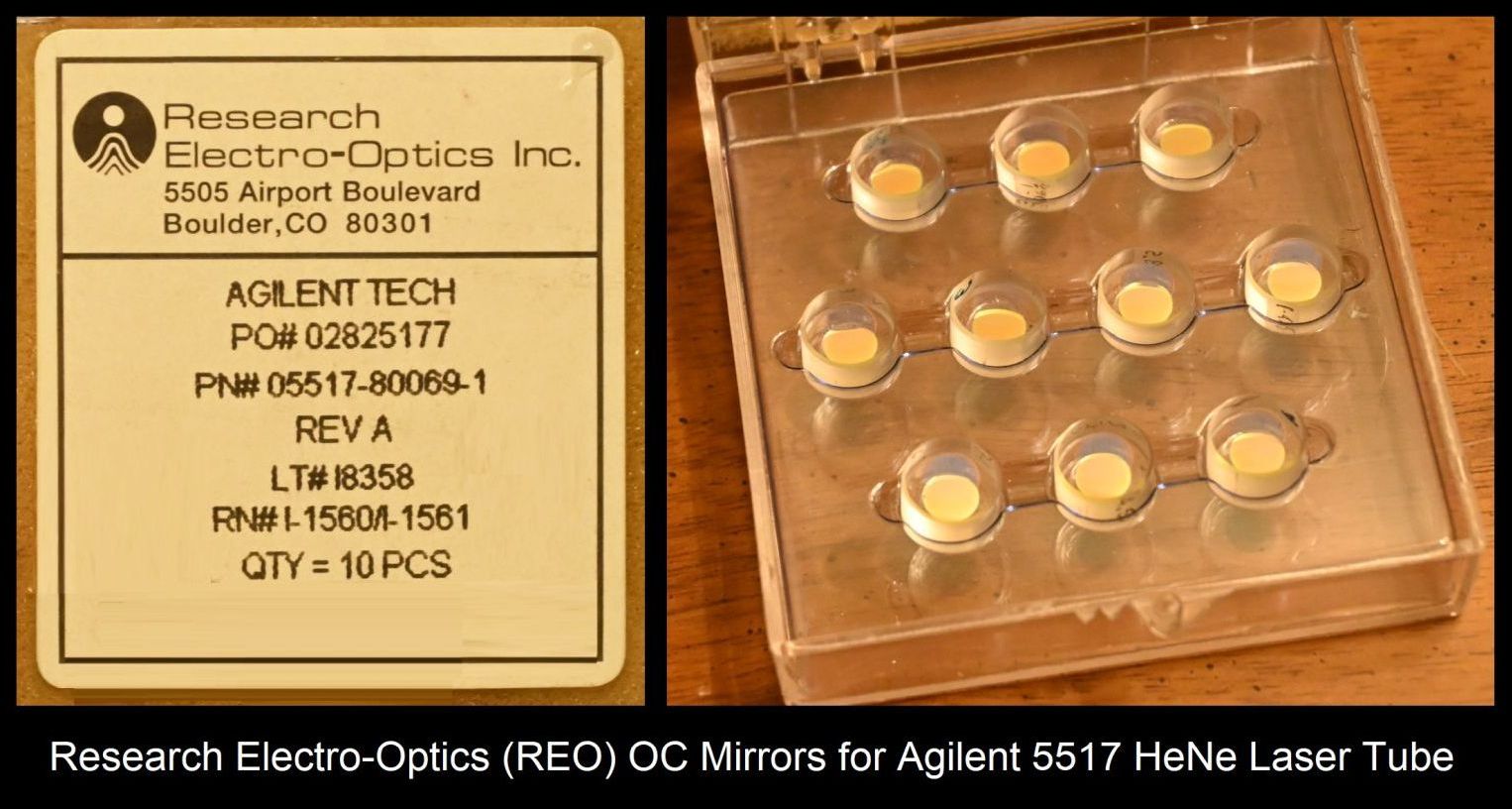

     *HP/Agilent 5517 (all)        AZ M                       +/-2          +/-20
     *HP/Agilent 5518A, 5519A/B    AZ M                       +/-2          +/-20

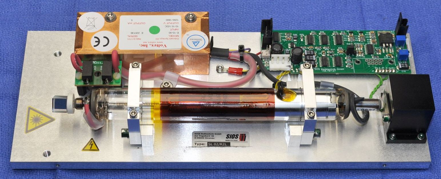

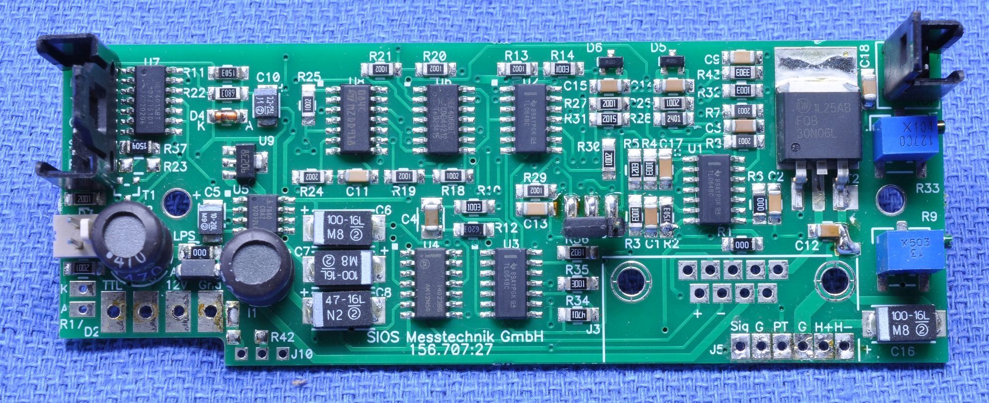

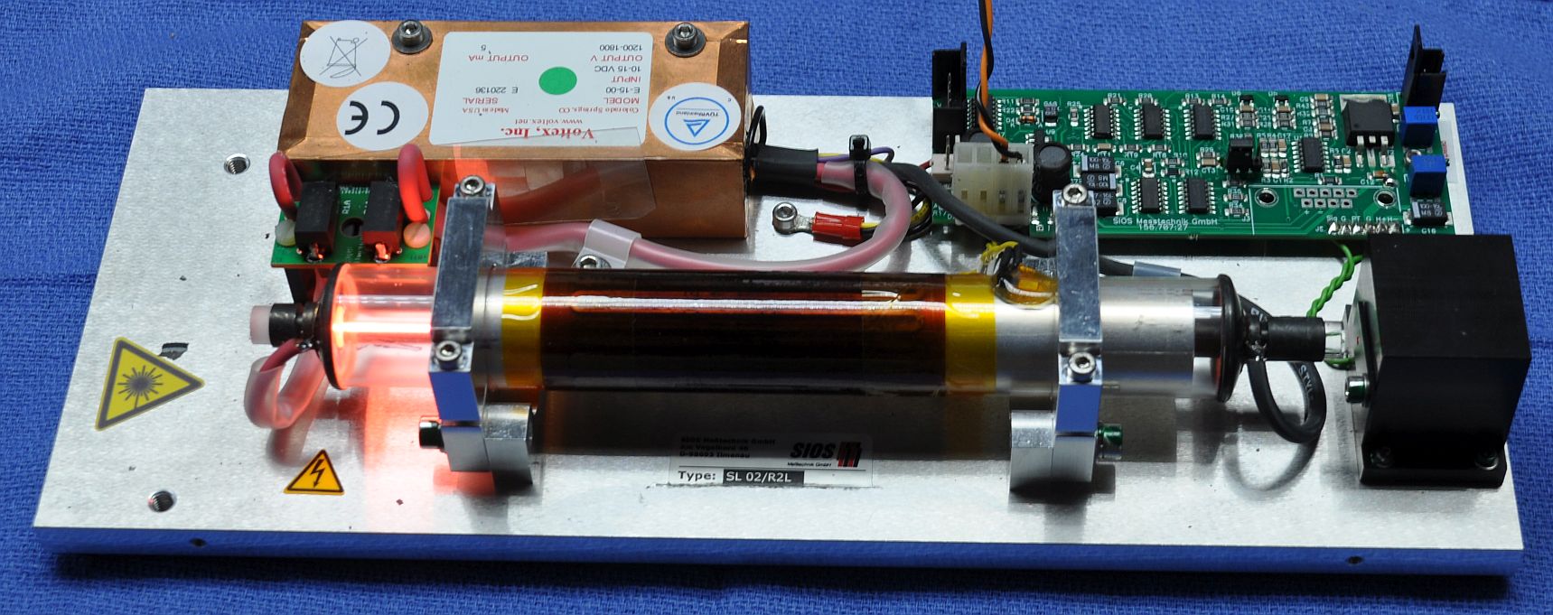

      SIOS SL 02                   DM S         +/-2   +/-10  +/-20

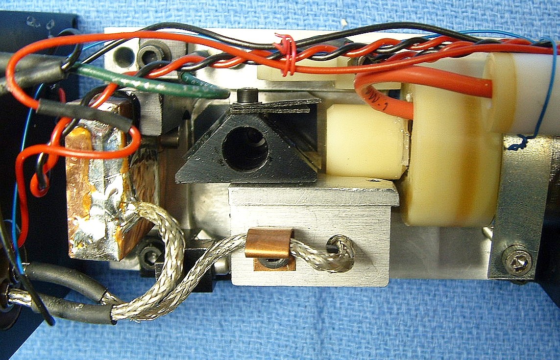

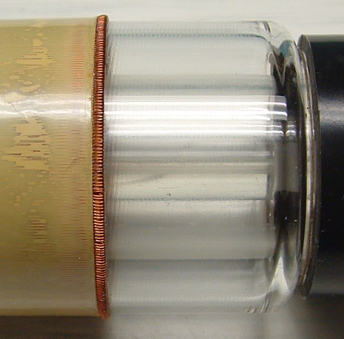

    Here are some photos:
    The coupling coil assembly on the first Syncrolase 100 of mine had disintegrated due to excessive temperature. (Actually the magnet wire and its insulation is in fine shape but the plastic form on which the coil was wound or embedded is no more and it's not even possible to determine much about it.) I've tested the induction heating winding a test coil on a tube made from insulating plastic sheet. The effect is impressive considering the simplicity of the circuitry (see the schematic below) raising the temperature of a dummy mirror mount stem by more than 1 °C per second even with a coil that is probably far from optimal.
    I do not know for sure if the cause of the destroyed coil form was due to a part failure rather than simply a result of the laser being been left on for 7 years continuously! :) The HeNe laser power supply was indeed dead, probably due to the tube being very hard to start and impossible to run for more than a few seconds regardless of power supply or ballast resistance. So it's possible that when the tube decided it was tired of doing its thing and the power supply shorted out, the controller ended up cycling on the over-temperature condition. The Melles Griot manual does warn against running without the laser on. And, electrical tests seem to indicate that the controller is working properly.
    So, the Over-Temperature (OT) adjustment might have been incorrect and too high all along. Since it's not something that affects normal behavior, it would be all too easy to neglect setting it properly! I've also been told by the former owner that this laser always ran very hot. If the tube fails - even if someone forgets to plug in its wall adapter! - the heater tends to be on and bad things can then happen if the OT setting is too high. Ask me how I found out. :( :) OK, I'll tell you. I acquired another Syncrolase with a good tube but that would not stabilize. I traced the problem to what I believe may have been a short in the temperature sensor and then adjusted it to operate at a reasonable temperature set-point. But I accidentally left the controller powered after turning off the laser and went away. When I returned (after lunch!), the entire assembly was too hot to touch and the platic coil form at is cover had melted!!! Apparently, either the OT setting was way too high (it's possible someone before me messed with it) or it isn't effective or was broken.
    Interestingly, on one of those rare occasions where I was able to get the tube to remain on long enough with a lab power supply to watch a few mode sweep cycles, it is a classic FLIPPER! I suppose that the flipperitis could have happened in its old age (it is also weak - about 0.7 mW - and with brown crud in the bore), but normally the flipper or non-flipper status of a tube doesn't change over the course of its life. I do have another Aerotech laser head that would screw right on to the controller but it too is a flipper! :( :) In fact, its behavior shown in Plot of "Flipper" Aerotech OEM1R HeNe Laser Head During First Part of Warmup and the merged version in Plot of "Flipper" Aerotech OEM1R HeNe Laser Head During First Part of Warmup (Combined) looks virtually identical to that of the Syncrolase tube (over the few mode sweep cycles I could see before the tube went out). But, even more interstingly, the flipping of the tube in the plots ceases entirely and it becomes perfectly well behaved once nearly warmed up as shown in Plot of "Flipper" Aerotech OEM1R HeNe Laser Head at Transition to Normal Behavior (Combined). Perhaps that tube was intended for a Syncrolase as it in unusual in having the required long mirror mount stem and short cutoff exhaust pipe. Perhaps it was a reject due to the flipping. Or perhaps for unknown reasons, all these tubes flip when cold. Since the Syncrolase 100 would be operating well beyond this point, there's a chance that the flipping is irrelevant and it would work just fine. In fact, that one working genuine Syncrolase tube is also a flipper until it warmed up! More on this below.
    I built a replacement coil using the wire from the first dead Syncrolase on a roll of plastic. It works, though the temperature response is faster probably because the thermocouple is not in the same location as the original. So, it locks more quickly, but also loses lock more frequently during warmup but is otherwise functional. Perhaps changing the temperature set-point would correct that. It's amazing how much variability can be tolerated with this design.
    Adjusting the temperature set-point is an interesting exercise. Ideally, it should be slightly above the equilibrium temperature of the laser head with only the laser tube powered. Set too high and the laser will run excessively hot, but there will be a fewer number of lost lock events during warmup. Set too low and it may lose lock eventually when the tube equilibrium temperature exceeds the set-point temperature.
    One way to do the adjustment might be to initially set the Temp. Gain pot (R1) fully CW (for a very low temperature) and power *only* the laser head (not the controller) for at least an hour so it reaches thermal equilibrium. Then, power up the controller and slowly turn R1 CCW to slightly beyond the point where the SYNC LED goes out. Monitoring the Temperature Amp output (A1 pin 1) will indicate how effective this is. The voltage on A1 pin 1 should remain between approximately 1.5 V and 2.75 V when the laser is locked. If it goes below about 1.5 V, the feedback loop is disabled and the heater turns on full (SYNC LED OFF). This state continues until the temperature increases to the point where A1 pin 1 exceeds about 2.75 V and the feedback loop is enabled (SYNC LED ON). Better to start out with the temperature set-point adjusted too low should the over-temperature protection fail. :( :)
    I built another temporary coil for the first laser to check it out. This coil is wound on a plastic cylinder found in a junk pile that was glued to the remains of the original coil form. The Epoxy seems to stick rather well, which is a bit surprising. I didn't have any #24 AWG magnet wire, so I used #20, which just fits 9 turns in the available space. The laser works quite well now except that the speed of heating is not quite as fast, possibly due to the coil being slightly longer and larger in diameter. However, this is probably of little consequence in the grand scheme of the Universe. :) Lowering the RF frequency improved the response, though there was no resonance.
    Finally, I built a new coil form for the third laser. It has approximately the same dimensions as the original so it behaves very well. But the plastic is too think and there is very little clearance between the form and mirror mount stem. So the genuine Syncrolase laser head won't fit because its tube is too off-center. (This must have been a result of the way it was manufactured since its beam is well centered.) But my "flipper" head fits just fine and works just fine. :)

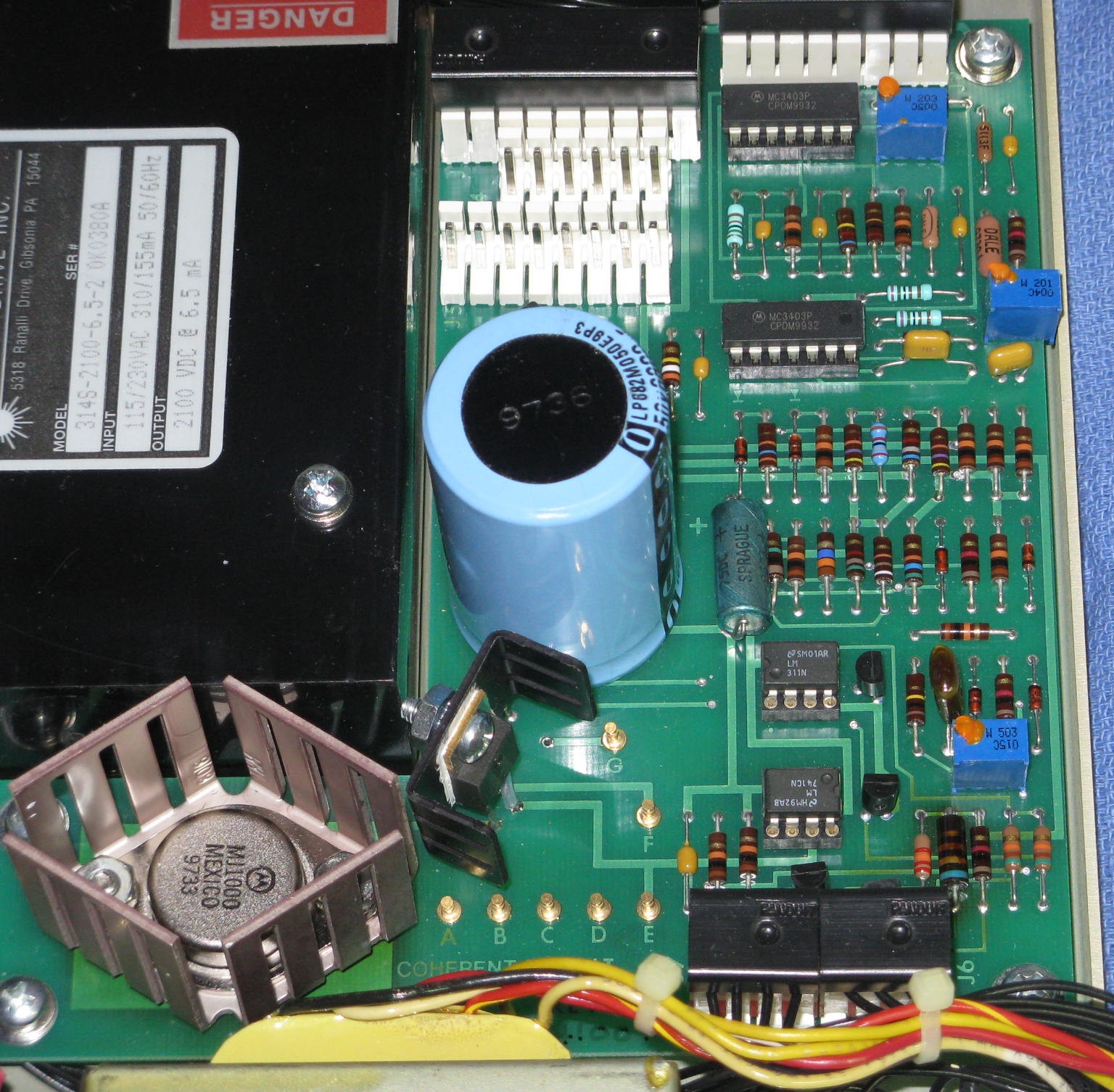

    The controller can be set up to run on various input voltages from 100 VAC to 240 VAC by changing the position of a small PCB that plugs into the AC entrance assembly, and plugging in the appropriate fuse. However, it seems that the HeNe laser power supply always runs on 115 VAC from a tap on the main power transformer so it doesn't need to be capable of 230 VAC operation, even though the one that's in there has that option - the wire for 230 VAC is not used! The output of the HeNe laser power supply is rated 2,100 V at 6.5 mA with no start delay.
    The user controls consist of one (1) power switch. There are indicators for AC power and Status. After a warmup period of 20 minutes or so for the laser head to reach operating temperature, the Status indicator will change from Wait (red) to Ready (green). Doing anything that causes lock to be lost will result in a shorter delay of a couple minutes to re-establish it.
    The internal circuitry of the controller box is relatively simple and includes a pair of LM3403 quad op-amps, a 741 op-amp, and LM311 voltage comparator, along with a TO5 power transistor on a heatsink to drive the heater.

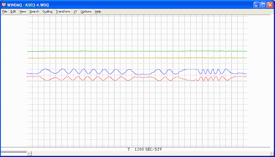

    Note that the Ready light comes on and then the laser locks in at the proper phase of the next mode cycle. So, basically the pea brain in the controller (no actual CPU of any kind!) decides that conditions are suitable and enables the feedback loop. The final "decision" is based the cycle duration being longer than some magic number (around 1 minute). :) I've also seen the ready light come on even if the laser doesn't start and when one of the previously locked heads was plugged back in after a few minutes of cooling. In the latter case, the laser was indeed locked though it might not have been able to maintain it continuously since the tube was probably no longer really warm enough.
    There are actually two feedback loops in the controller. During warmup, the heater is driven to a fixed temperature based on the resistance between pins 3 and 4 of the Control connector. Once the period of the mode cycle exceeds a fixed time (guessing somewhere around 60 seconds), the control loop based on the difference of the photodiode outputs is enabled. The same signal that switches from the temperature feedback to mode feedback turns the Wait indicator goes off and the Ready indicator on. More on this in the next section.
    Plot of Coherent Model 200 Stabilized HeNe Laser Head During Warmup and Plot of Coherent Model 200 Stabilized HeNe Laser Head Near End of Warmup show the output power variation due to mode cycling. Note how it seems to "snap" into regulation once the time is right. :) There are roughly 90 mode cycles during warmup prior to lock. The internal optics account for the large variation in output power. The HeNe laser tube itself has a normal mode sweep of only a few percent.

    Schematics of Coherent Model 200 Controller
    I have reverse engineered the very nearly complete circuit diagram for the Coherent Model 200 controller. The only parts not included in the diagram are the AC line front-end and voltage selection circuitry, the power transformer for the low voltage power supply, the Laser Drive HeNe laser power supply, and the detailed wiring of some of the internal connectors. (The only internal connector on the drawing is J2, for the cable from the PCB to the laser head Control connector on the rear panel. It is labeled J2 on the PCB copper.)
    Everything is in Schematic of Coherent Model 200 Stabilized HeNe Laser. Note that most of the part numbering is totally arbitrary as there were *no* part numbers on the PCB except for the PCB connectors (and I only have J2 in the drawing). This is a late revision with PCB artwork dated 1997, though that probably only means that there was a PCB fab run in 1997, since the artwork itself was obviously hand taped. :) I guess some important customer just had to have more of these lasers made well after they would have been considered very obsolete by Coherent. :)
    The controller has two feedback loops. The Preheat Loop, which is active while the tube is warming up, drives the heater in the laser head to a fixed temperature (set by a pot). The temperature sensor in the laser head is not a common NTC thermistor, but something that increases in value with increasing temperature. It has a resistance of around 800 to 900 ohms at room temperature, but well over 1K ohms at operating temperature. The preheat loop prevents the mode feedback loop from going active until the temperature is sufficiently high. Only after this occurs, does a timer begin to look at mode changes, and switches from the preheat loop to the mode feedback loop once their period exceeds around 60 seconds. The mode feedback loop uses the difference between the orthogonally polarized A and B modes in a simple PI control loop to drive the heater. Should the laser not stabilize as evidenced by mode changes still occurring, the preheat loop will be switched back on to try again. At least, that seems to be how it's supposed to work. However, a system with a laser tube that doesn't start (or a bad HeNe laser power supply) will likely turn on READY shortly after being powered up even though it is obviously not working correctly. Well, I guess it IS quite stable - dead with a frequency of exactly 0.0000000000 Hz and an output power of exactly 0.0000000000 mW! :)

    Excel 1001F Two-Frequency HeNe Laser Head
    The Excel 1001F is physically similar to the small 5517 lasers and the cable connector and electrical requirements are also compatible. However, the spec'd REF frequency for the 1001F is from 1.5 to 3 MHz, so it's not really equivalent to any of them. Possibly, one can request a particular REF frequency range via an option, rather than a different model laser. Or, a typical laser starts out close to 1.5 MHz and increases with use and normal power decline until 3.0 MHz is considered end-of-life. The nominal wavelength spec is also the same as that of the 5501A/B, 5517A/B, and 5518A - 632.99137 nm. If it is possible to specify a REF frequency range, then the 1001F could be compatible with the 5517B (1.9 to 2.4 MHz) or 5517C (2.4 to 3.0 MHz) except that the nominal wavelength is slightly different for the 5517C (632.991372 nm versus 632.991354 nm). But this discrepency of about 28 ppb may have simply been a change in the specifications by HP, and is of no real consequence anyhow.
    For a summary of the specifications for the 1001F laser, see the previous section.
    Several photos of the Excel 1001F laser can be found in the Laser Equipment Gallery (Version 3.00 or higher) under "Excel Precision HeNe Lasers".
    The two most interesting ones are:
    Here are some observations/comments:
    So, I need to find a dead Excel laser to go inside. :)

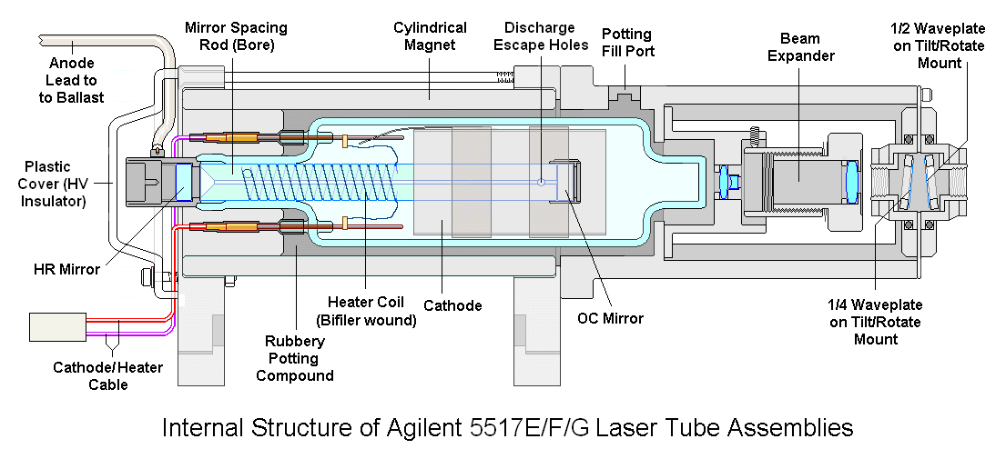

    HP/Agilent Laser Principles of Operation
    All the HP/Agilent laser heads use what is called an axial Zeeman-split HeNe laser, which produces two orthogonally polarized modes differing in frequency by between 1.5 and 4 MHz for most models. The beam is single spatial mode (TEM00) though the outer tail may be clipped by the beam expander. The two polarized modes are actually a pair of lasing lines operating on the same longitudinal mode of the laser cavity but slightly shifted due to the Zeeman effect resulting from the laser tube operating inside an axial magnetic field. However, it's not strictly accurate to think of the longitudinal mode oscillating on its own and then somehow being split into two sub-modes by the magnetic field. Rather, it is the Doppler-broadened neon gain curve itself that splits and the two halves are actually separated by 100s of Mhz. Lasing on one of these gain curves will result in right-hand circular polarization and lasing on the other will result in leff-hand circular polarization. Then, any given longitudinal mode will see some amount of gain from each of the split gain curves, and if above threshold, will lase there. This means that the location where the two Zeeman split modes are equal in amplitude is not at the peak of the neon gain curve but part way down as shown in Axial Zeeman Split HeNe Laser Mode Behavior, a simplified diagram like one probably found in a textbook. (More below.) Note that while the cavity may be long enough for more than one longitudinal mode to be present (as in the diagram), only when the a longitudinal mode is approximately centered on the Zeeman-split neon gain curve will it be able to create a Zeeman-split mode pair and beat signal in the frequency range that matters (a few MHz rather than many 100s of MHz). In addition, in geniune HP/Agilent lasers, conditions are such that when locked (READY on solid), only the one pair of Zeeman-split modes can oscillate (no "rogue" modes). Rogue modes can potentially result in problems in the interferometer.
    Waveplates at the output of the HeNe laser tube convert the left and right-hand circularly polarized Zeeman split modes to linearly polarized modes that are orthogonal and aligned with the horixontal and vertical axes of the laser. These two modes usually differ in optical frequency by between 1.5 and 4 Mhz (depending on the specific laser). (Some recent versions of the 5517 may actually go to 6 MHz or more.) The X and Y polarizations are sent down different paths in the metrology application. One is generally a reference length and the other is the distance to be measured or tracked. (It's the change in path length difference that matters so they could both move if desired.) The two beams rather than creating an interference pattern are beat together in a detector that outputs a difference (or heterodyne) signal. If the relative distance between the two beam paths changes by one half wavelength of the laser (about 632.8 nm but accurate to many significant digits!), the phase of the difference signal will change by 360 degrees. The laser also generates an electrical signal from beating the signals together internally. This constant reference is compared to the detector signal and an electronics package counts off the phase shifts and uses it to determine the distance traveled.
    A moderately powerful cylindrical permanent magnet does the Zeeman splitting resulting in a pair of circularly polarized outputs at two very slightly different frequencies. F1 is designated the lower frequency and F2 is designated the higher frequency. For the 5501A/B, F1 is vertical (perpenticular to laser base) while F2 is horizontal (parallel to laser base). For the 5517A/B/C/D, 5518A, and 5519A/B, F1 is horizontal (parallel to laser base) while F2 is vertical (perpendicular to laser base). (Exactly why HP switched orientations between the two model series is not clear as there is no benefit to one over the other and it just causes confusion.) The difference between F1 and F2 ranges from 1.5 to 4 MHz for most of the HP/Agilent lasers depending on the model (as listed above) and also the specific sample of the laser. The cavity length of the early HP lasers (5500A/B/C and 5501A) is PZT controlled using feedback based on the amplitude of the two modes. For the 5501B and all later lasers like the various 5517s, cavity length is adjusted by a heating coil wrapped around the bore inside the tube. In all cases, the feedback is used to maintain the position of the lasing lines symmetric on the Zeeman split neon gain curves as shown in Axial Zeeman Split HeNe Laser Mode Behavior. A 1/4 waveplate converts the circular polarized output to orthogonal horizontal and vertical polarized components which are used externally. F1 is reflected from the thing being measured or tested (e.g., disk drive servo writer) and F2 is reflected from a fixed reference. The difference frequencies (F1-F2) and (F1-F2)+dF1 are then analyzed to determine precise position, velocity, or whatever. This approach has lower noise, greater stability, and is therefore more accurate than the common single frequency interferometer. By using cavity length control to force the mode position to be centered, the actual optical wavelength/frequency can be set very accurately. Using the MHz range beat signals makes signal processing straightforward and is more immune to noise than the baseband optical signals.
    Interestingly, the actual beat or reference frequency (REF) does NOT need to be super stable over the long term. Rather, it is the difference between REF and the return signals that matters and that only depends on the motion of the target reflector, the optical frequency of the meausrement beam, and the speed of light. Thus, although the optical frequency needs to be known to high precision (+/-0.1 ppm for the standard lasers; +/-0.02 ppm for those calibrated to MIL STD-45662), the exact beat frequency of each laser is not precisely controlled or even precisely measured and recorded or used anywhere in the calculations. This is one reason why the listings above include only a range of values. Any given sample will operate somewhere within that range but the exact value is somewhat random depending on the specific characteristics of the tube/magnet assembly and the specific place on the neon gain curve that the lasing line is parked. In fact, REF tends to increase over the life of the laser as the gain and thus output power decline with use. As long as REF remains within the spec'd range for the specific model laser, then the system in which it is installed will work properly. What exactly a machine will do if REF goes out of range is implementation dependent, but one reason for a laser such as this to be replaced is for REF to approach or exceed the high end of the spec'd frequency range.
    While one might think that locking the difference frequency to a crystal reference would be even better - and the technique is patented - it's not clear that this would be better and might actually be worse. The difference frequency relative to the mode position can change for any number of reasons. But forcing the amplitude of the two modes to be equal as is done in the HP lasers centers the modes on the split neon gain curves, which should be very stable in terms of wavelength.
    All of the HP lasers use conventional dual polarization mode stabilization to lock the lasing lines to the split neon gain curve. However, the two signals are not from adjacent longitudinal modes as with most common laboratory stabilized HeNe lasers, but are the two Zeeman split sub-modes differing in frequency by a few MHz instead of many 100s of MHz. In fact, both are the same cavity mode but shifted slightly higher and lower than would be predicted by c/2*L. One twist on the implementation is that the 5501B and those below it on the chart use a Liquid Crystal Device (LCD) polarization rotator to alternately sample the horizontal and vertical polarized modes, and subtracting sample-and-hold to compare them in the error amp driving the heater, rather than the polarizing beamsplitter and dual photodiodes used in many other dual polarization mode stabilized lasers including the 5500C and 5501A. The LCD approach does have a sort of elegance as well as practical benefits. Since the same optical path and photodiode is used for both polarization modes, the sensitivity is identical so the mode balance should be perfect assuming the LCD polarization rotation is 90 degrees. Since the intent is to park the modes symmetrically on the split neon gain curve, this is perfect and thus requires no offset adjustment over the life of the laser as the output power of the tube declines. And, the LCD and associated electronics may in fact be cheaper than a high quality polarizing beam splitter. However, it also creates some artifacts as a result of the digital switching, resulting in small cyclical variations in optical frequency over a period of 2 or 3 seconds. These are of no consequence for most metrology applications, but do detract from the elegance of these lasers.
    In fact, the thermally tuned lasers have only one adjustment associated with stabilization, and that is for the temperature setpoint at which the controller switches from pre-heating to optical locking. The resistance change of the actual heater coil is used to sense temperature and there may apparently be variation from one tube to the next. But this is an extremely non-critical setting and won't affect accuracy, only possibly the temperature range over which the laser will remain locked. (5517s with the Newest Digital Control PCB may have no adjustments, or at least none that are obvious!)
    One oddity with respect to the thermally tuned laser tubes is the patent reference that appears on the label of all newer ones at least: "Licensed by Patlex Corporation Under Patent No, 4,704,583". The title of this patent is: "Light Amplifiers Employing Collisions to Produce a Population Inversion", filed in 1977 but not granted until November of 1987. The most curious thing is that there appears to be very little of relevance in the patent other than its association with laser action! Nothing in the patent diagrams or text has any obvious connection to the tube assembly design. In fact, the exact same text exists on other more mundane things like a Carl Zeiss-badged Siemens LGK 7634, a bog standard 2 mW random polarized HeNe laser head. I've heard that Patlex is actually a bunch of lawyers and I bet they made out or are making out quite well. :)

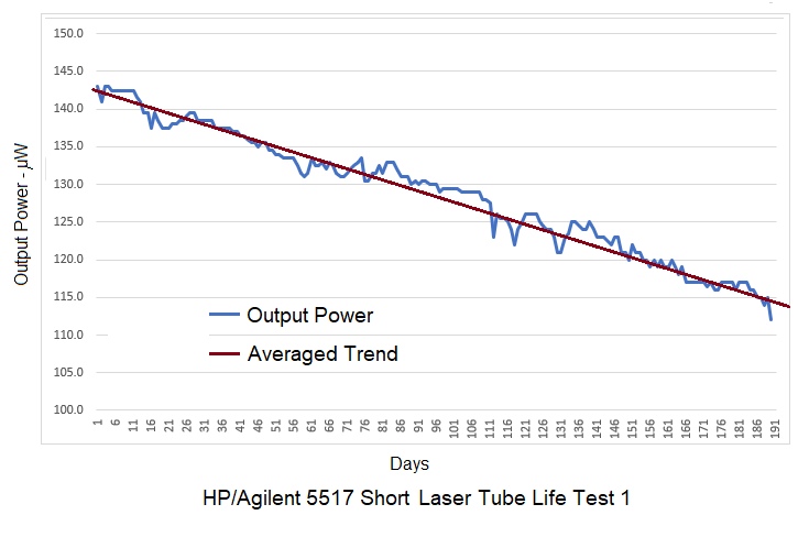

    HP/Aglilent Laser Output Power and REF Frequency versus Use
    With common HeNe lasers, output power may decline slightly with thousands of hours of use and then drop precipitously near end-of-life. However, with some, power will actually increase initially due to the tube being overfilled. And in many cases, the decline in output power is mostly due to misalignment of the mirrors that occurs after many power cycles. This is fully recoverable with realignment. There is of course, no REF frequency for such vanilla (or cherry!) flavored HeNe lasers. :)
    I do not have any full life data for HP/Agilent lasers. But in general it would appear that the trend is for output power to decline, usually accompanied by an increase in REF frequency, especially near end-of-life. But not always - and that's somewhat of a mystery. Since HP/Agilent lasers have mirrors whose alignment is permanently fixed by glass-glass contact, changes in alignment cannot be the cause for either power decline or REF frequency increase. However, the gas-fill He:Ne ratio and pressure does change with use which affecting gain. And, optics can degrade increasing cavity loss. The strength of the permanent magnetic field also affects output power and REF frequency, but if it were to change at all, it would most likely decrease, resulting in an opposite effect compared to what's in evidence here. And while there may be a very small effect from external losses in the optics due to changes in beam expander alignment and contamination over the years, it's almost always insignificant.
        Parameter       Output        REF
       (Decreases)       Power     Frequency
          Gain         Decreases   Increases
       Cavity Loss     Increases   Decreases
      Magnetic Field   Increases   Decreases
      External Loss    Increases   Unchanged
    The following table shows how the output power and REF/split frequency changes with use for recent vintage (2004-2006) Agilent 5517B lasers. Though the actual number of on-time hours is not known, these lasers were all labeled by Agilent with the original output power and REF frequency. ID #1 is believed to either be grossly mislabeled, or an unused spare, which thus has like-new performance. All the others have probably been run for thousands of hours. Several have REF frequencies that have climbed to near or beyond the upper limit for the 5517B (2.4 MHz) and were probably pulled from service for that reason. But on some others, while the output power has declined significantly, the REF frequency is unchanged or even lower than the labeled value. So, it's possible that there is indeed more than one mechanism accounting for the changes in output power and REF frequency. With gain and cavity loss being critical, each of these will degrade at different rates.
      Laser  Label PWR  Warm PWR  W-PWR/  Label REF  Warm REF  W-REF/
       ID      (µW)       (µW)    L-PWR     (MHz)     (MHz)    L-REF
        1      355        395      1.11      2.27      2.17     0.96
        2      580        525      0.91      2.29      2.39     1.04
        5      560        510      0.91      2.29      2.29     1.00
        6      607        525      0.86      2.22      2.27     1.02
        7      580        516      0.89      2.22      2.32     1.05
        9      680        530      0.78      2.20      2.47     1.12
       12      251        222      0.88      2.19      2.17     0.99
       13      560        305      0.54      2.23      2.75     1.23
       16      654        519      0.79      2.23      2.51     1.13
       17      660        574      0.87      2.24      2.35     1.05
       18      628        387      0.62      2.24      2.67     1.19
    (The missing laser IDs did not have label values for output power and/or REF Frequency.)
    Notes on the Waveplates in HP/Agilent HeNe Laser Tube Assemblies
    When two-frequency Zeeman lasers are discussed in textbooks and research papers, it is generally stated that the magnetic field splits the original mode into two modes that are left and right circularly polarized. Period. However, if this were true, a 1/4 waveplate alone would be sufficient to both convert them to orthogonal linear polarized modes and to align them with the X and Y axes of the laser as required for use in an interferometer. The reason is that a 1/4 waveplate takes a left-hand circular polarized input and produces a linear polarized output at +45° with respect to its fast axis, and takes a right-hand circular polarized input and produces a linear polarized output at -45° with respect to its fast axis. The input orientation doesn't matter. So, the 1/4 waveplate could be oriented to align the output linear polarizations without regard to the input.
    But HP lasers from day 1 (the original 5500A around 1969 even before it had an official model number) and Agilent lasers to the present have all had both 1/4 and 1/2 waveplates with the basic design unchanged over more than 40 years. Further, both waveplates are in mounts that allow the tilt of each one to be adjusted around one of its principle axes. Why? Some possibilities as to the reasons for this more complex setup are as follows:
    Real HeNe laser tubes exhibit some small random amount of birefringence both from the fine structure of the mirror coatings as well as from unavoidable geometric asymmetry in their construction. Without a magnetic field or explicit polarization control measures such as a Brewster window or plate, these tend to lock the polarization of the longitudinal modes to a fixed orientation about the tubes optical axis, and 90 degrees from it. Adjacent modes will almost always be orthogonally polarized. In a HeNe laser with an axial magnetic field such as one from HP/Agilent, this will result in the Zeeman modes being slightly (or not so slightly) elliptically polarized rather than pure circularly polarized. So, the orientation of the 1/4 waveplate will matter and only certain orientations (2 or 4) will convert these to orthogonal linearly polarized modes. But the resulting linealry polarized modes in general won't be aligned with the system's X and Y axes, so the 1/2 waveplate is then required to rotate them to match. (The magnetic field will also never be perfectly symmetric or uniform, though I don't know whether this is ever a significant factor in affecting the mode polarization.)
    The adjustable tilt allows the exact retardation of each waveplate to be altered slightly. I find it somewhat hard to believe that the reason is simply to be able to use cheapo waveplates that might not always be exactly 1/4 or 1/2 wave! However, this explanation can't be entirely discounted since the accuracy of the retardaion is critical to producing F1 and F2 modes that are purely linear and precisely orthogonally as required for the metrology applications. And, the waveplates are made from what looks like optical-grade mica whose discrete layers preclude the ability to select the exact retardation by controlling thickness. And whether mica waveplates were originally selected based on low cost or zero order or temperature stability or being very thin to avoid significantly shifting the beam when tilted or being what the designers had laying around is not known either. But there might be another reason for this "feature" - namely to further compensate for some deficiency in the modes coming out of the tube, again related to deviation from being purely circular. Or something. ;)
    Thus, there are in fact 4 degrees of freedom, though clearly the tilt has a much smaller effect than the rotation. And without a full understanding (possibly including hairy math!), it's difficult to really come up with an adjustment procedure that will work in general. That's the bad news.
    The good news is that from experience, swapping the entire waveplate assembly between HP/Agilent tubes is likely to result in acceptable performance without any adjustments other than making sure that the overall orientation is the same. Therefore, it would appear that these errors are usually small. But it does seem that it is sometimes necessary to touch up the tilt of the 1/4 waveplate in order to produce the best mode purity in addition to optimizing the waveplate orientations. Adjusting a waveplate assembly from scratch (random orientation and tilt) may be much more challenging though since it would first be necessary to match the orientations of each of the waveplates to a waveplate assembly to at least allow the laser to lock. Without a stable output, going further would be virtually impossible.
    So much for hand waving. :-) One might think that a good source for information relating to Hewlett Packard's metrology laser technology would be patents. But so far, patent searches have turned up almost nothing of relevance. If anyone has knowledge or references related to the waveplate issue or anything else of relevance, please contact me via the Sci.Electronics.Repair FAQ Email Links Page.
    The only actual waveplate fine tuning procedure to maximize the F1/F2 separation and achieve optimal orientation I've ever seen for one of the early HP-5500 lasers with built-in interferometer optics. The goal then is to minimize any return of the component that is supposed to be transmitted. It simply says something like:
    But there is no explanation as to why this procedure is the way it is. And they don't mention the tilt adjustment on the 1/2 waveplate for some reason.

    Maximizing the Life of HP/Agilent Metrology Lasers
    Although the spec'd lifetime of the special tubes used in these lasers is around 50,000 hours or slightly over 6 years, with a sticker price of something like $10,000, it still pays to do everything reasonable to maximize their usable life. (And, there is some evidence that newer lasers typically run only 3 to 4 years before going outside Agilent specifications.) Many if not most semiconductor fabs and other similar production facilities keep these lasers powered continuously regardless of whether they are actually being used. This may be based on the belief that (1) they take a long time to reach the required wavelength accuracy, (2) stuff tends to fail when powered cycled, and (3) HeNe lasers like to be run. None of these is particularly valid for these lasers. But even so, keeping them on 24/7 still may be most cost effective where minimizing any unscheduled downtime is more critical than replacement costs. However, for educational institutions and general research and development applications, there is no reason to do this. Power up the laser an hour or so before the system is needed and power it off when not needed for several hours or more. Here some comments on each issue:
    So, in short, the laser itself won't function any better if run continuously compared to being turned on at most 90 minutes before needed as long as it doesn't affect the environment in such a way as to change the calibration. (90 minutes is HP/Agilent's spec for warmup to full accuracy on an unvented laser, only 45 minutes on one with forced air cooling). And for less critical applications, simply waiting until READY comes on solid may be adequate. It should be possible to test for the overall effect by making a measurements of a known length in each axis when the laser comes READY, after 90 (or 45) minutes, and after 24 hours. If any differences found are acceptable, there is nothing to be gained by continuous operation.
    Where the laser might be used for a few hours a week, as in a diamond turning machine at a custom optics house, this should effectively extend the life of the laser to infinity.

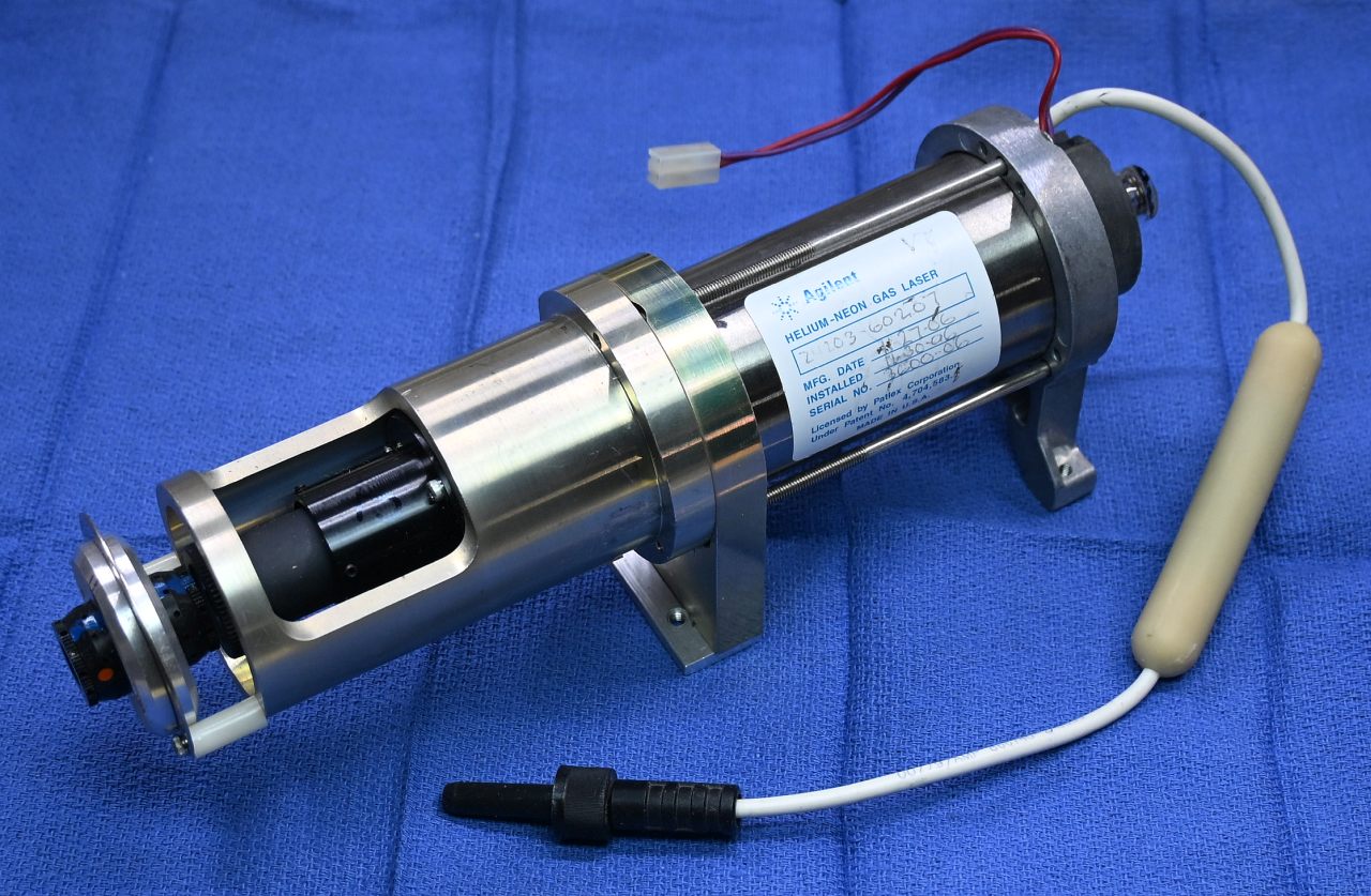

    The 5501A, 5500C, and 5500A appear to be the only models that use a special HeNe laser tube which has its cavity length fine tuned by a PieZo Transducer (PZT). (The 5501B and all successors still use a special HeNe laser tube but it has an internal heater for fine cavity length control rather than a PZT.) The OC (front) mirror and PZT with the HR (rear) mirror inside the laser tube are held in place by a spring against a spacer tube (the actual bore of the HeNe laser) made of Zerodur, a special very low thermal expansion coeffient glass/ceramic developed by the Schott Glass. In fact, longitudinal mode cycling is virtually non-existent with these lasers.
    Compared to the 5500C, the 5501A is in a much smaller lighter case with simplified optics and totally different electronics. See Interior of the HP-5501A Laser Head - Left Side and Interior of the HP-5501A Laser Head - Right Side. The HeNe laser tube dominates the interior space in both views. The high voltage piezo driver power supply brick is visible under the magnets at the center of the tube. The HeNe laser power supply brick is underneath the output end of the tube. The piezo driver electronics circuit board at the far right end of the right side view. The optical sensor circuit board is at the far left of the left side view.
    The naked tube is shown in HP-5501A Laser Tube Removed From Magnet and Output Optics Assembly. The normally enclosed part is really just a very think walled fine-ground bore inside an outer glass envelope. A spring (visible through the glass at the left) at the rear holds the PZT, HR mirror, bore, and OC mirror in place. No adjustment is possible. There are distinct multiple spots on the card because the output window is at a slight angle and not AR coated.

    Of note here is the relatively low OC reflectance of 98.5 percent. This is one of the primary parameters that determins the REF frequency. All other factors being equal, reducing the reflectance increases cavity loss which increases the REF frequency.
    Plot of Hewlett Packard Model 5517C Stabilized Laser During Warmup shows how a typical 5517 laser behaves. This is a 5517C rather than a 5517A but the locking algorithm is the same. Note that the entire warmup period from laser on to locked is only around 3.5 minutes because of the internal location of the heater for the active mode as noted above. A laser with the more common external heater could take 20 minutes or more to lock. The control algorithm is a bit more sophisticated than used on some other stabilized lasers, checking periodically for the status, and switching from "Warmup Mode" to "Optical Mode" about half way through the warmup period, at which point the READY LED starts flashing. A short while after it locks is when the READY LED comes on solid.
    Plot of Hewlett Packard Model 5517C Stabilized Laser Near End of Warmup shows the 5 mode cycles just before locking and the final transition to the locked state. The peculiar shape of these Zeeman-split modes is clearly evident in this expanded view.
    The beat frequency is shown for the last 5 cycles and after locking in both these plots. This is the actual measured frequency captured along with the vertically and horizontally polarized modes and total output power. (Showing the frequency plot earlier would be a mess.) The beat only appears for a small percentage of the mode cycles with some variation during the time it is present, peaking when the F1 and F2 amplitudes are equal, and only when F1 is falling with increasing temperature. There is no beam when F1 and F2 are equal but F2 is rising with increasing temperature. The reason for this becomes evident from the simplified diagram in Axial Zeeman Split HeNe Laser Mode Behavior, or more accurately in HP-5517 Zeeman Split HeNe Laser Mode Behavior. The second diagram has been specifically crafted based on the mode plots, above, and thus more accurately represents the actual mode behavior of the 5517. Both show 5 snapshots of most of a mode sweep cycle starting with the cavity being 1/4 wavelength too short at the top and ending with being 1/8 wavlength too long. (The case of 1/4 wavelength too long would be the same as the first, 1/4 wavelength too short). Only when the longitudinal mode is centered between the Zeeman-split neon gain curves will there be a beat. In addition, the mode amplitudes are changing rapidly as the cavity expands at those high slope locations on the gain curves. When the cavity length changes (longer or shorter) by 1/4 of the lasing wavelength of approximately 633 nm, the amplitudes are again equal, but the two separate longitudinal modes are oscillating far apart and there is no beat. Note that the red and blue plots include the F1 and F2 amplitudes, but also may have contributions from other longitudinal modes derived from the same split gain curve which thus have the same original circular polarization.
    Note that as the tube ages with use, the gain declines and the width of each gain curve that is above the lasing threshold decreases. Eventually, with a really high mileage tube, there may be no overlap at all and the beam will probably disappear for a part of the mode sweep cycle. But it is exactly at that point where the Zeeman beat would be generated, so it will also disappear entirely. Lasers are generally taken out of service long before this happens, but I recently found one whose output power was so low that this behavior was present - or absent depending on your point of view!
    Here is how the article "An Instant-On Laser for Length Measurement" by Glenn M .Burgwald and William P. Krugein describes the operation of the laser tube in the Hewlett-Parckard Journal, Aug., 1970.
    "If an axial magnetic field is applied to a laser which is free from polarization anisotropy in either the mirrors or the plasma tube, the output splits into two frequencies of left and right circular polarization. First-order theory predicts that the frequency splitting is proportional to magnetic field strength and to the ratio of line Q to cavity Q. In the new laser, magnetic field strength is adjusted for a difference frequency of about 2.0 MHz. Line center is virtually midway between the displaced lines, so proper cavity tuning can be assured by adjusting for equal intensities of the lines."
    And they show a gain curve diagram even simpler than the one above. See that article for more details.
    The reason for the peculiar shape of the mode plot is not clear. It is probably due to a combination of Zeeman modes and normal longitudinal modes. However, the gain profiles need to be asymmetric to account for it. The simpified explanation of Zeeman splitting rarely takes into account the actual profile of the magnetic field which no doubt stretches and distorted the gain profiles. So, drawing a pair of nice bell-shaped gain curves really isn't accurate. Near the ends of the tube, there will be little magnetic field and the gain curve there will not be shifted very much. In the center, the field will be maximum and the gain curves will be shifted by a large amount. Thus, the neon atoms will see a variation in magnetic field along the bore - a summation or integral of gain curves varying with frequency. This is depicted in HP-5517 Zeeman Split HeNe Laser Mode Behavior. Here, the gain curves have been modified so that the results would be roughly similar to what was in the plots, above. And HP-5517 Zeeman Split HeNe Laser Mode Behavior Versus Mode Position on Gain Curve shows one complete mode cycle along with little split gain curves.
    Note that the locked mode amplitudes are not equal and that the locked beat frequency varies a bit after locking and does not stay at its maximum value as would be expected if the stabilization was optimal. This is not a quirk of the particular laser I'm using for these experiments as I've tested dozens with similar behavior. So, they aren't as perfect as we might hope! :)
    Also note the two smaller modes on the tails of the gain curves in the diagrams. They aren't present in all of these lasers. But if they are and align with the X and Y axes, then the only effect will be to slightly decrease the MEAS or detected REF signal level with respect to laser output power. However, if the are not aligned with the X and Y axes (e.g., at 30 degrees), they will cause level changes in the envelope of the signal from the optical receiver's photodiode due to self-interference in the interferometer. This is similar to what would happen if the primary Zeeman modes were misaligned, or not pure. The consequences could be transient position errors but only during motion. The end-points would be accurate.

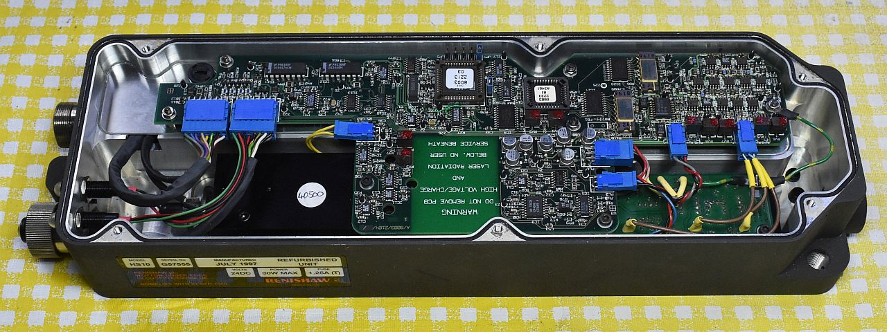

    Several views of a naked 5517E laser are shown in Agilent 5517E Laser Head With Cover Removed.
    This 5517E has the most incredibly complicated Control PCB of any HP/Agilent laser I had see before finding this laser, even compared to the newer digital Control PCB (see below). (I've since found a similar control PCB on a few other recent vintage 5517 lasers.) It includes a SHARC DSP, two Lattice FPLDs, and a lot of other digital circuitry, purpose unknown. They also seem to have gone back to PWM for the heater drive since there is no power transistor on a heatsink, as with the original analog and first digital Control PCBs. However, that collection of inductors visible in the lower left of the photo may be there to clean up the drive to the heater and remove the high frequency switching noise. Since the locking should be basically the same as for the other lasers, this level of complexity is perplexing unless this particular unit was designed to have much better stability - perhaps the "military calibrated" version. Unfortunately, the new Control PCB lacks all the familiar jumpers and the temperature set-point pot, and adds a couple of micro DIP-switches and connectors, purpose also unknown. Aside from the unknowns, everything else is obvious. :)
    Here are a pair of closeup photos of the overall laser:

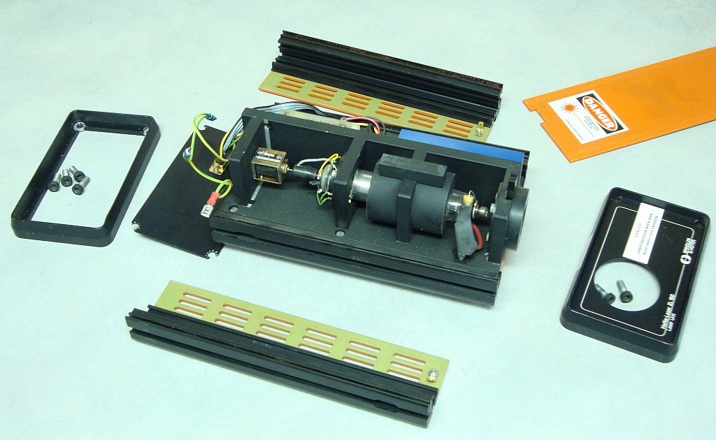

    This montage of Agilent 5517FL Laser and Components shows views of a 5517FL in various stages of disassembly. (Sorry about the photo quality - I do not have this laser.) It had a listed output power of 160 µW and REF/split frequency of 7.12 MHz. (The minimum specs are 65 µW and 7.0 MHz, respectively.) The overall construction is similar to that of the 5517E including the overhead-mounted ballast resistor, though the HeNe laser power supply brick is in a fully shielded metal box. The portion of the tube assembly housing the beam expander is longer than the one in the 5517E and the same as that of the 5517B/C/Ds, but of no significance since it doesn't affect anything beyond looks. The design and size of the tube is also similar except that it's a bit more polished with a real Agilent label! But, from the photos, it appears as though the heater resistance adapter found in my 5517E is not used, so the tube heater resistance must be higher. However, this unit had the normal (for recent Agilent lasers) Newer Digital Control PCB rather than the fancier one found in the 5517E. Another 5517FL had the fancy Newest Digital Control PCB, and indeed, no heater resistance adapter. Photos may be found in the Laser Equipment Gallery (Version 3.18 or higher) under "Hewlett Packard/Agilent HeNe Lasers".
    HP/Agilent 5517 Laser Construction
    The following also applies to the 5518A and the 5519A/B, though I rather doubt that they have equivalent digital Control PCBs like the 5517s.
    These lasers consist of the laser tube assembly, potted (brick) HeNe laser power supply, beam sampler, connector PCB, and Control PCB. mounted on a an metal chassis. Any of the parts can be replaced in under 5 minutes using common tools, with only minimal or no adjustment or alignment.
    Laser tube assembly:
    All of these consist of the actual glass HeNe laser tube potted with some sort of rubbery material inside its Zeeman magnet, beam expander, and adjustable waveplates. The heater/cathode is attached via a 2 pin plug while the anode has its own single pin high voltage connector. The HeNe laser tube ballast resistance of about 100K ohms is conformal molded into the silicone insulated HV cable. The bifilar-wound heater inside the laser tube has a typical resistance (cold) of 8 ohms on all tubes except the 5517E. When at operating temperature, the resistance is spec'd to be 1.285 times what it is when cold. For the 5517E (and possibly the F and G models as well), the resistance (cold) is around 4 ohms.
    Only 4 screws hold the tube assembly to the chassis for lasers in the small cases (all the 5517s except the 5517A, as well as the 5501B). One or two will be flat head screws which provide either a fixed axis for horizontal (pan) alignment, or self alignment (no adjustment permitted). All of these tube assemblies appear physically identical, except for the 5517E (and probably 5517F/G) which are slightly shorter. (They, of course, differ with respect to the REF/split frequency.) The larger tube assemblies found in the 5517A, 5518A, and 5519A/B mount with 3 bolts and have machined alignment pins so no adjustments are needed or possible. They, too, are physically identical except for one small area of the casting that needs to be cut away if installing a 5517A tube into a 5519A/B laser.
    HeNe laser power supply:
    Very old (perhaps roughly pre-1990) lasers used Laser Drive model 111-Adj-1 HeHe laser power supplies which had adjustable current via a pot on the laser connector PCB. At least most of them did. I did find one that had the same part number but no third wire. All later versions use VMI power supplies with a fixed current of 3.5 mA. However, the pot is still present on the connector PCB even on lasers made after 2006 (and probably to the present day), but does nothing.
    There are three versions of the VMI power supplies used in these lasers. The two older ones (VMI PS 148 and VMI PS 217) have the same HP part number of 0950-0470. The switchover came around the year 2000. The newest one (VMI PS 373) has an Agilent part number of 0950-4459 and is found on all recent lasers, at least since 2004. I know that going from the 148 to the 217 reduced the residual current ripple from over 3 percent to less than 1 percent because I measured it. I do not know what changes were made in the 373, nor what other differences there may be between these models. VMI claims it is proprietary information. Can you believe that? :) However, I have de-potted a dead model 373 and have reverse engineered its schematic. See the section: VMI 373 HeNe Laser Power Supply.
    With few exceptions, the only defective power supplies I've ever found in HP lasers were nearly all Laser Drive 111-Adj-1s. And one type of failure may result in the adjustment pot having no effect with the power supply pumping way excessive current (like 6 or 8 mA) through the tube. With luck, the ballast resistor catches fire and explodes before the tube is damaged. :( :) One exception was a VMI PS 148 that had excessive ripple, so something in its output filter had blown. But if I hadn't been checking ripple on a bunch of these power supplies, it probably would have gone unnoticed, since as long as the tube stays lit, performance of the laser probably wouldn't be affected in any significant way. However, the additional ripple would make the effective dropout current go up, so a reasonably healthy tube might start sputtering on that supply.

    Control PCB:
    Since the introduction of the 5517A laser through the early 2000s, all the Control PCBs in these lasers were based on simple TTL logic for timing and an analog feedback loop. The one in the 5517A is physically larger and not interchangeable with those in the small lasers, but is nearly identical electrically. The main functional difference is the additiona of circuitry and a connector so it can also be used in 5518A and 5519A/B lasers. There had been virtually no change in the design over 15 years or more, except that a modification to the internal REF receiver makes newer lasers require somewhat higher optical power to lock than older ones.
    There are no useful indicators on the Analog Control PCB, only two wimpy LEDs that duplicate the functions of the LASER ON and READY LEDs on the backpanel.
    But since sometime after Agilent was created, at least two versions of a Control PCB with much more complex digital circuitry appeared. These still have a substantial number of analog parts like op-amps and comparators, but FPGAs/FPLDs and/or a reasonably high performance microprocessor or DSP have replaced discrete logic. If one wants to count transistors, I bet the digital Control PCBs have 1000 times the number of transistors as the Analog Control PCB! The PCBs are also almost entirely surface mount, with parts on both sides (at least for the newest version).
    The first of these digital Control PCBs (which I call the "newer digital control PCB) is electrically and physically interchangeable with the older Analog Control PCBs. It is based on a Xilinx FPGA and should be very reliable. But a failure for any reason other than an obvious problem like a blown fuse bad DC regulator with no underlying cause would likely render it non-repairable except by Agilent or an authorized service center since it's then just a black box with no real way to easily troubleshoot. A service manual may exist but I've never seen one. And even if it did, sophisticated test equipment and a surface mount rework station would be required to have any chance at repair. However, this version has all the same jumpers and temperature set pot, so normal testing and adjustment is similar to that of the Analog Control PCB. The solution would then be to simply swap in a known good board (either version).

    Here are the three types of Control PCBs used in the 5517B/C/D/E lasers.
    (As noted, the one in the 5517A differs very slightly in form factor and has a small amount of extra circuitry for use in the 5518A and 5519A/B. As far as I know, it only comes in the original analog version.)
    The Analog Control PCB and the Newer Digital Control PCB function in a virtually identical manner, requiring about 2 minutes for the READY LED to start flashing, and another 2 minutes to come on solid. And as noted, they also have more or less the same jumpers and testpoints, as well as the temperature set-point pot. The Newer Digital Control PCB may in fact simply be essentially an emulation of the Analog Control PCB using an FPGA and more modern surface mount parts. That same large integrator capacitor is present, though the smaller sample-and-hold caps are not, or at least they aren't the same type.
    The third type of control PCB is not at all similar to the others. It has none of the same jumpers and several different testpoints, no pots, an RS232 port no doubt for setup and testing and almost certainly a digitally-maintained run-time meter, another unused connector, and a large unpopulated header. There are also a pair of micro-DIP switches - and a pushbutton, which I fianally dared to push, and as expected, seems to be master reset. :) There are many SMT parts on the back side of the PCB, including another Lattice FPLD.
    For more, on the Control PCBs and their operation, see the sections: HP/Agilent 5517 Laser Control PCBs and Locking Sequence, HP-5517E/F, and Agilent 5517 Laser RS232 Communications.
    The entire purpose of redesigning the controller more than once is somewhat perplexing. Doing it the second time with such complex digital hardware seems totally nuts, unless it was actually done for some custom high performance application, and it was simply convenient to use in late model 5517 lasers. (Given the likely relatively high cost of components including the SHARC processor and Lattice FPLDs, I find this rather hard to believe though. And it's a multilayer PCB with components on both sides, additional connectors, and other stuff.) The same very limited inputs (a pair of photodiodes sensing the modes through the relatively slow speed LCD switch and another photodiode behind a polarizer generating the REF signal) and outputs (tube heater current) are used in all 5517 lasers so it wouldn't seem to be possible to implement a significantly higher level of frequency accuracy or stabilization no matter what sort of control scheme is used. About the only thing that might be done is to actually compute the REF frequency from the REF photodiode signal and fine tune the lock position to maximize it once the basic stabilization using mode balance has been achieved. The peak of the REF frequency function may be a more accurate means of locating the Zeeman-split gain curve center. But except for NIST-level precision, the analog method is really just fine, so even if this scheme is implement, it's not clear what customers would require it. And from my observations of the REF frequency while locking, it doesn't seem to make any effort to maximize it, but stabilizes at a point much lower than the peak, with the same sort of slow variation once locked as the analog Control PCB.
    The stabilization technique used with 5517 lasers is really dirt simple: Start by heating the "mirror spacing rod" to a set-point temperature, fine tune the temperature, then switch to optical feedback which forces the two orthogonal Zeeman-split polarized modes to be equal. However, the details vary slightly depending on the specific Control PCB used in the laser.
    Locking sequence with Analog Control PCB:
    This also applies to the 5518A and 5519A/B since they all use the 5517A Analog Control PCB. It is also generally applicable to the 5501B though some details differ slightly.
    From power-on to READY takes around 4 minutes for most 5517 lasers - all those NOT using the Newest Digital Control PCB. Even on the original Analog Control PCB, a state machine based on counters, flip-flops, and gates determines the timing. This may be true of the Newer Digital Control PCB as well, except that the state machine would be inside a Xilinx FPGA. Who knows how the Newest Digital Control PCB with its SHARC CPU implements this algorithm (which tends to take much longer than 4 minutes, reason unknown)! The following is paraphrased from the 5517A manual, which assumes the Analog Control PCB implementation. (All timing is approximate as the main clock is a 555 timer on the Analog Control PCB!):
    Thus, under normal conditions, the laser will be locked and ready to make a measurement (approximately) 150 seconds after the READY LED starts flashing. Note that the only check to make sure the laser is locked is that the REF signal is present. Since this only occurs for a small percentage of the entire longitudinal mode sweep cycle, REF will not remain on for long without active feedback, so this is a reliable test. The laser will in fact continue to repeat the above sequence forever if REFON is not detected. Typically, this will occur when the output power from the laser tube has declined to below the REF detection threshold of the internal optical receiver after years of hard work. However, some marginal lasers will go through the sequence several times when powered up as the output power from the laser tube gradually increases with warmup until the amplitude of the difference frequency signal exceeds the REF detection threshold.

    Locking sequence with Newest Digital Control PCB:
    The Newest Digital Control PCB seems to go through many more gyrations during warmup than either of the others, including several times where READY flashes multiple times separated by a period of inactivity, and then finally flashing READY continuously for two minutes until it locks - the latter being similar to what the Analog Control PCB does. The entire process consistently takes much longer than the 4 minutes typical of a laser with the Analog Control PCB, up to 10 minutes or more. The behavior is not obviously different whether a weak (but functional) laser tube, or one that greatly exceeds minimun output power specs is used, though it may take slightly longer with a below-spec tube. After all this, the end result seems to be exactly the same.
    Here is a chart of the typical startup behavior for a very healthy 5517B tube installed in a (previously) 5517D laser with this newest digital Control PCB:
       Time    READY   State    Comments
       0:00             1111    Power on
       0:01             0000
       0:02.0           0001    0001-0010-0100 sequence in less than 0.5 sec.
       0:02.1           0010
       0:02.2           0100
       0:03    Flash    1100    MSB LED and READY LED flash briefly.
       0:04.0           0001    0001-0010-0100 sequence in less than 0.5 s.
       0:04.1           0010
       0:04.2           0100
       0:05    Flash    1100    MSB LED and READY LED flash briefly.
       0:06.0           0001    0001-0010-0100 sequence in less than 0.5 s.
       0:06.1           0010
       0:06.2           0100
       0:07    Flash    1100    MSB LED and READY LED flash briefly.
       0:08             0100    3x(Step 0, Step 3, Step 5) sent on RS323 port.
       0:15             0101    "LASER" sent out RS232 port.
       1:00             0110
       1:35   Flash 5   X110    1110,0000,5x(1110,0110).
       1:40             0110
       2:14             0000
       2:15   Flash 5   X110    1110,0000,5x(1110,0110).
       2:20             0110
       2:55   Flash 6   X110    1110,0000,6x(1110,0110).
       3:01             0110
       3:35   Flash 7   X110    1110,0000,7x(1110,0110).
       3:42             0110
       4:12   Flash 8   X110    1110,0000,8x(1110,0110).
       4:20             0110
       5:02   Flash 8   X110    1110,0000,8x(1110,0110).
       5:12             0110
       5:40   Flash 10  X110    1110,0000,10x(1110,0110).
       5:50             0110
       6:45   Flash 32  X110    1110,0000,32x(1110,0110).
       7:17   Flash 96  X111    96x(1111,0111).
       8:53      ON     X000    1000,0000,1000,0000,...
    The State refers to the 4 SMT LEDs above the upper left corner of the Lattice chip near the center of the PCB. The MSB is green while the three LSBs are red. All times are approximate. "Flash" is just the briefest pulse of light. "Flash n" denotes "n" flashes at a 1 Hz rate with a 50 percent duty cycle The duration for the 1110,0000 state changes in each "Flash n" sequence is relatively short (perhaps 100 ms for each of the two states). The minimum value for "n" seems to be 5, but it tends to increase as the laser warms up. (I'm not positive it's monotonically increasing though.) Once the REF frequency can be sustained by the feedback loop, it continues flashing for 32 seconds, and then switches to state 0111 for 96 seconds prior to becoming READY. Until that time, the READY LED and the MSB state bit track each other almost perfectly. But then, the MSB state bit (1000) continues to flash (but now at about a 1.2 Hz rate) while the READY LED remains on solid, And there is just a hint of the 0100 state bit flickering dimly, possibly the actual feedback loop in operation. :)
    Multiple runs from a cold start may differ slightly in the number of "Flash n" sequences and the values of n, as well as other details, but always take much more than 4 minutes (typical of the analog Control PCB). The very healthy tube will lock in 7 to 9 minutes while a weak but usable one might take 11 minutes or more. In all cases where the laser successfully locks, the last two minutes will be identical in behavior to that of the other two Control PCBs with READY flashing continuously until it stays on solid. A tube that is very weak or with no detectable beat (REF) frequency will result in only occasional very short abortive flashes, and no conclusion (at least not in 15 or 20 minutes).
    One annoying difference between this Control PCB and the others is that the signal level for REF and ~REF seems to be much lower - about 2 V p-p open circuit and less than 1 V (maybe as low as 0.5 V p-p) terminated, instead of more than 5 V p-p, and the 5508A display apparently doesn't accept this as a valid signal. So even if the laser comes READY within 10 minutes (the maximum allowed by the 5508A), it still comes up as "Laser Fail", which isn't recoverable without power cycling the 5508A (which means the laser as well if it receives DC power from the 5508A). However, my home-built SGMD1 display has no problemss. :) I wouldn't be at all surprised to learn that the signal levels are programmable - somehow.

      The first two sets of changes were implemented first. These worked fine with the locking characteristic after warmup, total time-to-lock, uncertainty in REF frequency, and slow oscillation in REF frequency appearing very similar to the behavior of an unmodified laser. This is actually a rather surprising and unexpected result, so more study will be required. :) A discrete time system has been converted into a continuous time system without doing anything to the loop parameters and there were no dramatic changes the system response. Interesting.... However, later I did confirm that actual locking to the modes occurred almost immediately after the laser entered "Optical" mode (about 100 seconds after READY starts flashing). I also confirmed that if the photodiode polarity was incorrect, it would repetitively pass through the lock point at a rapid rate but never stabilize there. I had expected it to lock to the opposite crossover point of the two modes, but apparently the slope there is so much different that it never latched on, so to speak. Or, possibly it would have locked there eventually but I did not wait long enough.
      For the record, the laser first tested with these modifications was a somewhat high mileage 5517C with a power output of around 240 µW and a REF frequency of around 3.3 MHz, the latter being outside the spec'd range for the 5517C (2.4 to 3.0 MHz). The uncertainty in REF frequency may be 200 Hz or more. The variation starts out with a period of around 16 seconds and deviation of around 0.003 MHz. Over a few hours, it slows down and finally stops (or becomes so long as to not be obvious).
      Some tests:
      • The "Power Amp" jumper was pulled off which prevents the optical signal from affecting the short term stability. The integrator is good enough that the lock-point will remain nearly constant for many seconds. Both the randomness and slow frequency variation in REF frequency were essentially unchanged. The heater driver (Power Amp) could still be acting in a peculiar way though this doesn't seem all that likely.
      • The main clock was disabled after the laser locked by grounding pin 2 of U10, the 555. This made no detectable difference in anything, indicating that these anomalies aren't an issue of either some digital signal still affecting the feedback directly or digital noise being picked up by the analog electronics. EVen though there was no detectable in behavior, modification (4) was installed just for insurance as it was easy enough.
      • A 2M ohm resistor was added in series with the Power Amp input. (The normal input is approximately 2.15M in parallel with 0.22 uF). This made no difference (not surprising given the previous result).
        Then a 220K ohm resistor placed in parallel with the 2.15M ohm resistor. This also had no detectable effect once locked. But, while the time-to-lock didn't change that much, the locking behavior was more rapid after the initial warmup.
      • A low ripple low noise linear HeNe laser power supply (modified SP-248) was substituted for the original VMI-148. This also made no significant difference.
      • An adjustable HeNe laser power supply was also installed to see if running at slightly higher current would have any effect. There may have been a very slight decrease in the randomness but nothing conclusive. At the normal current, this tube does have some amplitude ripple that disappears at higher current, so that may be related.
      • The PBS cube was mounted at a slight angle to reduce the possibility of back-reflections but this also had no obvious effect. The remaining (original) optics of the beam sampler still have perpendicular surfaces that could produce back-reflections, but these are still present when used in the normal way with the LCD and may be worse, since the LCD has several additional perpendicular reflective surfaces.
      Later, I installed the modified control PCB and beam sampler in a certifiably healthy low mileage 5517B (510 µW, 2.32 MHz). Locking was fine and both the randomness and periodic variation in REF were still present, though subtly different. The amplitude of the randomness was slightly lower - perhaps averaging 50 Hz compared to 200 Hz. The period started at about 10 seconds and the deviation was about 0.0045 MHz. However, running this laser with its original Newer Digital Control PCB resulted in essentially identical behavior. However, the deviation as well as the amplitude of the randomness also appear to be affected by exactly which longitudinal mode pair (i.e., exact temperature) at which the laser locks. A later power-on cycle resulted in a deviation of almost 0.01 MHz. Turning my offset control too far (accidentally!) resulted in the laser losing lock and then reaquiring it after the offset was turned back toward center. But the behavior had changed! The deviation in particular had dropped from 0.01 MHz to 0.004 MHz or less. Nothing else was different other than (presumably) where it locked!
      The detailed character of these artifacts remains a mystery. The randomness may in fact be a faster but lower amplitude oscillation in REF frequency superimposed on the larger slower one but it's hard to tell without actually recording it, which I'm not sure I am eager to do. :) Since other evidence suggests that there isn't a corresponding variation in optical frequency to go along with the variation in REF frequency, this peculiarity may be a fundamental characteristic of the Zeeman laser and have nothing to do with the stabilization at all. Or, they may be the result of some sort of etalon effect. The time constant of the slow down in the periodic variation in REF frequency is too long to be anything but thermal in origin. HP/Agilent laser tubes have at least 4 planar uncoated glass surfaces outside the laser cavity and these are not wedged or set at an obvious angle to minimize back-reflections. In addition, the optics of the beam expander telescope and beam sampler have several optical surfaces. Since the structures these are mounted on are all mostly temperature independent of the controlled thermal environment of the mirror spacing rod, it's possible that one or more are forming some sort of external resonator with its longitudinal modes interfering with the normal lasing process very slightly. Maybe.
      And eventually, I will have to set up the dual laser setup to check the optical frequency stability.
    The HeNe laser tube construction is nothing special, at least on the outside. Like the two mode stabilized HeNe lasers, a Spectra-Physics 088-2 or similar tube would work. But the actual tube used by LFS was apparently custom built though. Some, if not all, were filled with isotopically pure Ne20 or Ne22 to provide the narrowest linewidth and/or to select the precise line center, and possibly He3 as well. Later ones were made with a special bore support spider that eliminated the "slip-stick" behavior during warmup of some other designs.
    The waste beam from the HR-end of the tube is used for the reference beat tone. It has a polarizing filter between the tube and the photodiode and a glued-on wedge to make sure the waste beam can't reflect back into the bore. There is an AGC circuit of sorts for the photodiode so that a usable signal can be obtained as the tube ages regardless of a (reasonable) decline in tube power.
    The tube is rather elaborately suspended as can be seen in the photos. The suspension provides some degree of vibration isolation and there is even a fine thread screw (visible on the top of the laser head) to rotate the tube by a few degrees. The complex suspension was designed to minimize stress in the glass envelope and eliminate stick-slip noise due to length changes of the overall tube. It also allowed the tube to be rotated by a 100 pitch screw adjustment without twisting the tube at all. This was desirable to align the tube's birefringence axis (mode orientation) precisely with the magnetic field.
    The entire laser head is thermally regulated by a temperature controller which is the circuitry on the lone PCB inside the head. The temperature set-point can be adjusted via a pot accessible from underneath the laser head. Power resistors attached to the baseplate on which the tube and magnet assembly is mounted provide the heating and an LED on the rear panel of the laser head shows the amount of power to the heater by its intensity. The baseplate bolts to the outer aluminum case with close-fitting end-plates. Although perhaps not obvious from the photos, the wall thickness is much greater than that of most other HeNe lasers.
    There is also a rather elaborate transducer attached to the tube. While serving a similar function to the heaters on many mode stabilized lasers, the design was optimized for fast response. Power to this heater is what is controlled by the PLL responsible for locking the laser.
    The transducer consists of a dense "zig-zag" run of copper wire about 3.5 inches long Epoxied directly to the outside of the glass tube envelope. The wire is oriented (back and forth) along the long axis of the tube, *not* as a helix or coil (it is not an inductor). When a current is run through the winding the wire heats up and immediately pulls (stretches) the glass with it. The response bandwidth is something like 10 kHz since the length change between the mirrors did not have to wait for the glass to heat up. With the wire arranged along the tube axis all of its change in length was in the intended direction - unlike with a the the more common coil arrangement.
    With a simple coil, the initial change in dimension when current is applied is an increase in winding *diameter* which pulls the glass with it (expands the tube diameter) and causes an initial *shortening* of the tube. The shortening is followed by a lengthening as the heat from the transducer diffuses into the glass. This is not a good way to make a fast feedback loop. Also unlike other heater schemes generally used, with the wire directly attached to the tube glass, there is nothing in between to limit the response as with taped on thin-film heaters.
    On the anode-end of the HeNe laser tube (the front of the laser head and output) is a collar with two LEDs on it and a trim pot. Only the anode wire connects to this collar. One LED is lit when the tube is first turned on. Inside the collar is a temperature regulator for the output mirror. There is a small amount of internal reflection in the mirror that gets back into the laser cavity and this is the way it was tamed. There is a thermistor regulated heater in there that uses the laser discharge current for power. The voltage drop across the heater box will vary, but the current through it is held constant. So, the mirror temperature is regulated so that the etalon formed by its front and rear surfaces has a peak covering the neon gain curve resulting in a constant transmission without retro-reflections. For the approiximately 5 mm thick mirror - 7.5 mm optical length - the FSR is 40 GHz, compared to 1.5 GHz for the Doppler-broadened neon gain curve. So, the peak is rather broad in comparison, but keeping it centered helps long term stability.
    The rear mirror had a simple prism made of cover glass that was Epoxied onto it so that the internal reflection was removed by putting it off axis. The Epoxy was made to be thicker at one side than on the other by supporting one side of the cover glass with little tabs of tape. This method couldn't be used on the output mirror.
    When the output window is under proper thermal regulation both of the LEDs on the thermal regulator enclosure should be half lit. The upper one lit means heating and lower one lit means cooling. The pot adjusts the temperature set-point.
    And note that neither anode or cathode is at ground potential! Don't ask how I (Sam) found this out. :( :) This was apparently for noise suppression. Grounding one end of the tube will risk inserting some 60 Hz hum onto the tube current through ground loops and such. Talk about paying attention to every last detail!
    The HeNe laser tube is driven by a linear power supply with totally exposed components once the controller cover is removed. Not even a plastic shield! It is the typical voltage doubler with parasitic voltage multipler for starting. Four power transistors provide current regulation in the cathode return. While at first glance it looks similar to many other linear power supplies of the early 1980s, it was designed to put out 5 mA at 1,200 Volts with a supply ripple of about 1 mV! That gives it a SNR of around 127 dB. This was necessary in order to reduce the very small fluctuations in laser power output due to supply ripple, and their corresponding phase noise, to a minimum. This was somewhat tricky to do back then. Specifically, the current regulation control circuit has better components and additional filtering compared to common commercial HeNe laser power supplies. The PCB traces were also apparently arranged to minimize pickup of hum and noise from the nearby power transformers. A partial schematic I traced of the Model 200 HeNe laser power supply can be found in the section: Laboratory for Science Model 220 Laser Power Supply (LS-220). I still need to determine the details of the current regulation circuit (lower right in the schematic) but it's diffiult to make out because the PCB can't easily be removed from the controller case.

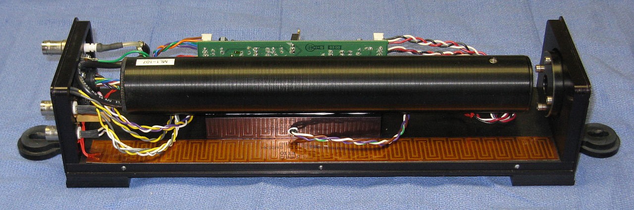

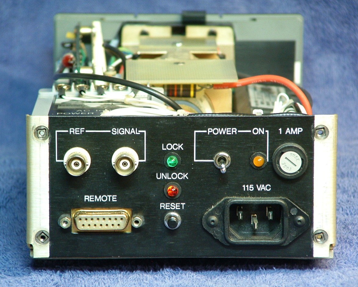

    Newport Stabilized HeNe Lasers
    Newport NL-1 Stabilized HeNe Laser
    Before Newport merged with Spectra-Physics, they were usually thought of as providing components like optics, mounts, and maybe measurement instruments, but not lasers. However, it turns out that they did offer a stabilized HeNe laser in the early 1980s when they were still called Newport Research Corporation or NRC. The NL-1 was probably the only such laser manufactured and sold by Newport. Now (2010), they offer the REO SHL but at most, may simply put their logo on it, if that.
    The Newport NL-1 is the "polished" version of the Laseangle RB-1 described above, so Newport didn't actually design it either. The primary changes compared to the RB-1 are cosmetic with much nicer construction of both the laser head and controller. However, the underlying design appears to be virtually identical. It is a dual polarization mode thermally stabilized HeNe laser with very rudimentary electronics (as if the circuitry can be more basic than those in most other similar lasers!). However, while it doesn't even have automatic switch-over from preheat to stabilized operation, there are controls to set "Servo Gain", which could be used to optimize the locking behavior. It also may be locked to either the low ("red") or high ("blue") side of the neon gain curve, along with a trim-pot accessible from the front panel to set the locking point on the neon gain curve. There are front panel outputs to monitor the two polarized mode signals from the photodiodes and something called "Null Test" which seems to be the amplified difference signal from the photodiodes, as well as a tuning input. And there is a meter to monitor the heater current so it's easy to tell if it is within the stable operating region as thermal equilibrium is reached or the ambient temperature changes.
    The laser head uses the same 8 inch long Uniphase HeNe laser tube as the RB-1, along with the same rather overly elaborate beam sampler assembly. The photodiode preamp with two ICs is now on a real PCB as opposed to a prototyping board, and the power supply filters caps are also on a PCB attached to the rear panel. There are no controls or indicators on the laser head (the interlock plug has been moved to the controller), only the cables (still 3 of them - HeNe laser tube power, heater, and feedback) permanently attached via strain reliefs. The main difference compared to the RB-1 is that the laser head cover is now in three pieces - two thin (but nicely made) side panels and a thick milled top plate! But now 12 to 20 screws need to be removed to get the entire cover off, although only 8 screws (woopie!) for a side panel. :) Of course, there's generally no need to go inside the laser head other than to get zapped on the laser tube anode voltage. :) The one adjustment in there (mode balance) shouldn't really change.
    The controller is in a 3.5 inch high 10 inch deep cabinet that could probably be rack-mounted with a suitable adapter kit. It has to win the award for the largest controller for a commercial dual polarized mode stabilized HeNe laser ever made and is about 90 percent empty space! All of the control electronics are on a PCB mounted behind the front panel, with an attached heat-sink for the heater driver transistors. A simple DC power supply is mounted on one side, the Laser Drive HeNe laser power supply brick is mounted on the other, and the power entrance assembly and 2 pin Jones socket interlock connector are on the back. The entire central area is totally empty! :) The laser head cables attach to the front panel probably only because that's where they were on the RB-1. (Although this would make sense if it were rack-mounted.) As with the RB-1, there is both an AC power switch AND keylock switch. Geez, it's not like this is a 10 kW cutting laser!
    Operation is very straightforward based on empirical evidence, as I have no user manual: Power up with the Heater Current set at an intermediate value like 0.3 A and Servo Gain controls (Coarse and Fine) set to minimum. Allow it to warmup for 10 or 15 minutes or until a full mode sweep cycle takes more than 20 or 30 seconds. (It would have been nice if they had provided mode indicators - a pair of LEDs monitoring the Passed and Blocked outputs. But a laser power would need to be used for this.) Then, turn up the Servo Gain controls to achieve a stable lock. The Fine control appears to be most important. It seems that almost any setting that isn't minimum will result in a stable lock, but if set very low, there will be an offset. So, the feedback loop probably has no "I" term. Coarse (which is a multiposition switch) only affects loop stability in some obscure way - the meter needle tends to oscillate if set too low. Or something. So, either the labeling isn't quite accurate or Coarse is broken. :) But Fine definitely does have a much more dramatic effect than its name implies! No doubt, the Servo controls could be set more optimally by monitoring the short and long term variation in the output power or optical frequency. But locking is very rapid at almost any settings, and the output then becomes rock stable, with only a very slight drift as the entire system reaches thermal equilibrium. Flipping the Red/Blue Lock switch results in a shift in lock position over a few seconds to the opposite side of the gain curve with nearly identical power. If the tube temperature is too low or too high as evidenced by the heater current being near or at zero or maximum (about 0.6 A), it's a simple matter to move it to a different lock point by turning the Servo Fine control to minimum and allowing the tube to cool or heat by a few mode sweep cycles. So, unlike most boring stabilized HeNe lasers, this one does have a few fun controls to fiddle with. :)
    The locked output power on my sample can be set between about 0.6 mW and 0.725 mW using the front panel Tuning trim-pot, though it hits 1 mW during mode sweep. The output power is almost the same for the "Red" and "Blue" lock points. (These probably only differ due to non-ideal components.) There is also a trim-pot in the laser head to adjust the mode balance between the "Passed" and "Blocked" photodiode signals. I do not know what the specs are, but the performance of this laser could be close to the new values. An 8 inch laser tube may not have a rated output power much higher than 1 mW, and the beam sampler inside the laser head diverts 100 percent of the horizontally polarized (blocked) mode and about 10 percent of the vertically polarized (passed) mode to the feedback photodiodes.
    Here are photos of the laser head and controller:
    Many more photos of an NL-1 laser head and controller can be found in the Laser Equipment Gallery, (Version 3.13 or higher) under "Newport HeNe Lasers".
