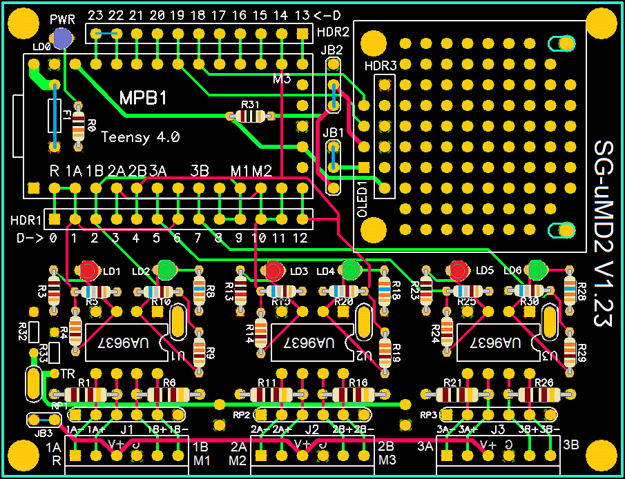

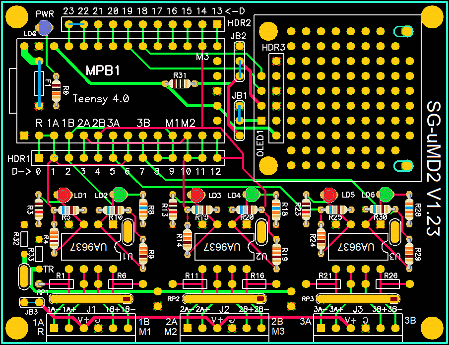

SG-µMD2 PCB Layout Version 1.23
Refer to the SG-µMD2 board layout below. Clicking on these will bring up higher resolution versions in a single separate tab or window depending on your browser settings:
SG-µMD2 V1.23 PCB Layout Diagrams with 100 & 150 Ohm Terminators (Left), Minimal Single Axis V1.00 PCB, and Three Axis Populated V1.00 PCB with OLED Display (Right)
(JB1 and JB2 Jumpered on Layout Diagrams for OLED GND on the Left and VCC on the Right)
(All kits going forward will have red and green LEDs for the A and B signals; the original prototype was all boring green. Please pay attention to the values for the current limiting resistors as they differ by more than an order of magnitude for the red and green LEDs to equalize their perceived brightness. Where the signal LEDs are all green, the R3,R8,R13,R18,R23,R28 will be 10K ohms.)
In addition to the resistor color codes and component references, the layout diagram also shows the signal locations for homodyne and heterodyne signals on the Teensy.
The populated PCB shows all components required for a three axis system with the OLED display. The terminating resistors (near the screw terminal blocks) have not been installed since their value may depend on the specific configuration, and sometimes can be left out. Five pin headers may be substituted for the screw terminal blocks if desired. The signal LEDs shown are all green in the photo, sorry. :) (These show the V1.00 PCB and I'm lazy go updated versions will not be forthcoming.)

Step-by-Step "Heathkit™-style" Assembly Instructions for SG-µMD2 PCB Version 1.23
The parts list below assumes populating the SG-µMD2 for 3 homodyne axes with the OLED display. So for a single axis system, some parts in this list may not be present and/or there is no need to install those associated with channels 2 and 3 and/or for the OLED. Note that a 3-axis heterodyne system requires the same peripheral parts as a 2-axis homodyne system.
IMPORTANT: The color of the OLED display (if present) may be yellow/blue (yellow for first two lines of text with blue for the remaining 6 lines), all blue, or all white. In addition and more importantly, they may differ slightly in their pinout and mounting hole type/location as follows (viewed with the pins at the top):
There may be other variations. The kits will generally have the Type 1 yellow/blue OLEDs.
    Core Parts:
    Peripheral Parts (1-Axis):
    OLED Parts:
    For a two or three axis homodyne system, the Peripheral Parts quantities will be multiplied by 2 or 3, respectively; for a three-axis heterodyne system, the Peripheral Parts quantities will be multiplied by 2. And the OLED parts will not be present, uh, for a system without the OLED. :)
    The "Optional" parts identified below can be omitted if that feature is not being implemented. The LEDs especially are not really that useful and with the default current limiting resistors, annoying bright. So you may want to at least experiment with higher values of resistors to tame them.
    IMPORTANT: LEDs are really fragile with respect to soldering and tend to die open easily. Make sure the leads are not stressed when heat is applied - the LED should be able to jiggle slightly in the holes - and keep the iron on them for as little time as possible.
  2. ( ) Install F1 (1 amp fuse) or jumper. This will normally just be a jumper. But where the PCB is feeding +5 VDC power to an external encoder or the like, a fuse should be used (normally not included in the kits).
  3. ( ) Install R0 (10K ohms) under where the Teensy socket will go.
  4. ( ) Install R31 (10 ohms) under where the Teensy socket will go.
  5. ( ) If there is a large DIP socket, it is for for MPB1, the Teensy 4.0, and may need to be trimmed to 28 positions. Rather than the DIP socket, there may a 40 pin deep socket strip requiring cutting and trimming, or a pair of 14 pin deep socket strips that my just require smoothing at the ends.. If cutting is required, DO NOT attempt to slice it between pin positions - sacrifice one position and then file the ends smooth.
  6. ( ) Carefully insert the socket or strips into the PCB confirming no bent pins. For the socket, rather than flipping a coin :), orient it so the large cutout faces the USB to the left. Then solder two corners and confirm it seats flat, then solder the other pins. Inspect for solder bridges and unsoldered pins. For the stips, take care that they are straight up and flush with the PCB before soldering. Then solder the end pins, check that it seats properly, then solder ALL the other pins. DO NOT attempt to plug in the Teensy until ALL pins are soldered.
  7. ( ) Install the 8 pin sockets for U1 (single axis) and U2,U3 (three axes). Note orientation - the cutout goes to the right as viewed in the layout diagram. Solder and inspect for solder bridges and unsoldered pins.
  8. ( ) Install C1 (0.1 µF, single axis) and C2,C3 (three axes). C1,C2,C3 are the oval outlines to the right of U1,U2,U3 respectively.
  9. ( ) Install R4,R9 (330 ohms, single axis) and R14,R19,R24,R29 (three axes).
  10. ( ) Install R5,R10 (680 ohms, single axis) and R15,R20,R25,R30 (three axes).
  11. ( ) Install LD0 (3 mm blue LED). The anode is the longer lead and goes to the right as viewed in the layout diagram. The flat is the cathode and goes to the left. Cut the leads about 1/10" from the body if the LED can't be inserted to sit flush on the PCB. Take care not to overheat or stress the leads on the LED when soldering. Be as quick as possible.
  12. ( ) Optional signal LEDs:
  13. ( ) Install J1 (screw terminal block, single axis) and J2,J3 (three axes). Make sure the entrance holes for the wires face away from the PCB! Solder the center pin and confirm they are flat on the PCB, then solder the others. Check for solder bridges and unsoldered pins.
    6 pin headers may substituted for the screw terminal blocks if desired.
  14. ( ) Carefully inspect for unsoldered pins, solder bridges and other blemishes. Correct as needed. THIS IS ESSENTIAL! It would be bad form to blow the brain due to an errant blob of solder. :(
  15. ( ) Test the Teensy before doing anything to it. If it fails this test, contact me before proceeding.
    Unplug the USB cable.
  16. ( ) Assemble the Teensy 4.0 PCB to the pin or socket strips. There will either be a pair of 14 pin female-male socket strips precut or the male to male pin strip that needs cutting. These steps are needed ONLY if the Teensy does not already have pins soldered.
    Solder a single pin near the center and confirm it seats flush, then solder the rest. To assist in alignment, the strips can be inserted in the 28 pin socket taking care not to push any of the individual pins out of position.
  17. ( ) Test the Teensy as above before plugging it into the SG-µMD2 PCB to confirm the soldering hasn't done anything bad. Then unplug the USB cable.
  18. ( ) Carefully plug the Teensy into the 28 pin socket. The USB socket faces off the left side of the PCB as shown in the layout diagram. Make sure all pins are seated and none are hanging off the socket. CAUTION: Make sure all the pins line up with their entry points in the socket to avoid squashing the leaf sprint contacts.
  19. ( ) Reattach the USB cable. The power LED should come on immediately and after a second or so, the Teensy LED should start flashing as before. Unplug the USB cable.
  20. ( ) Plug a UA9637 or UA9639 IC into the U1 position. The dot or cutout should face to the right - these ICs are upside-down compared to the Teensy part labeling as shown in the layout diagram. Confirm that no pins are bent over.
  21. ( ) Reattach the USB cable. The power LED and possibly one or both LEDs near U1 (if installed) should come on immediately and after a few seconds, the Teensy LED should start flashing as before.
  22. ( ) (Optional) Here is the nifty bit. ;-) Moisten a finger (doesn't matter which one) and touch the pins on J1. With some practice, it will be possible to make the LEDs near U1 to go on and off as the input to the line receivers cause them to toggle. While the behavior is not really predictable, just the fact that they change indicates the the line receiver is working. Since the UA9637 has some hysteresis, it latches but the slight charge from your electric personality is enough to toggle it. CAUTION: Don't get carried away, these parts can be damaged by static discharges. So, no cat's fur and plastic rods, please. :( ;-) (This will not be possible if the terminating resistors are installed, thus holding off on them for now.)
    If you're wondering how the OLED in the photo, above, can be displaying such large numbers with nothing attached to the inputs, it was done this way except the board was plugged in a USB charger, not a USB port. That must have a lot of ripple relative to my moistened finger, enough to easily trigger the UA9637 even with its hysteresis.
  23. ( ) Start the µMD GUI and select the COM port used to upload the firmware. The graph should start scrolling. But now, if you do the moistened finger thing, it should be possible to get the displacement to change for Axis 1. Once confirmed, unplug the USB cable.
  24. ( ) Repeat the previous 3 steps for axes 2 and 3 (U2/J2 and U3/J3) if installed.
  25. ( ) Optional OLED:
  26. ( ) (Optional) Termination. There are 3 options, see description, above and below. Where the driver is DC-coupled (using an IC direct, normally used with commercial homodyne systems), the 100 ohm termination which is between the two outputs should be satisfactory. Where it is AC-coupled (capacitor or transformer, normally with heterodyne systems), the 150 ohm termination to GND should be used. If in doubt or for the combined homodyne and heterodyne kits, install a suitable socket. (Not included.) So, only one of the following may be required:
    If in doubt, cut the female-male socket strip into pieces and solder them in so alternative termination schemes can be tried without requiring unsoldering.
  27. ( ) (Optional) External power. Pin 3 of J1,J2,J3 is for +5 VDC power to external hardware line encoders. Since it comes from USB, the current is limited to the capacity of the USB port minus what is used by the hardware on the PCB. Pin 3 on J1,J2,J3 is connected to JB3-2 located at the lower left of the PCB. JB3-1 is +5. Install a jumper or fuse between JB3-1 and JB3-2.
Note: If normal (not high brightness) LEDs are installed in unused axis locations, there may be slight "ghost" glow from them even when they should be off due to leakage from +5V through to the the +3.3V of the Teensy pin. If you're a purist and that bothers you (or just don't want to be distracted), add a 1K ohm resistor between +5V (pin 1 of the UA9637/9) and the LED cathode (pins 2 and/or 3).
Congratulations, you're all set to go. Order that construction crane in need of a controller with free shipping on eBay. ;-)
