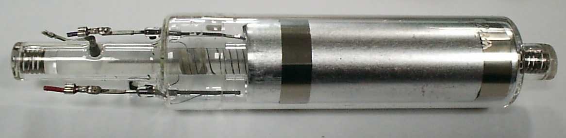

Here are two view of the tube itself:
View 09 - Overall view of strange HeNe tube.
View 10 - End-view showing piezo electrode terminal.

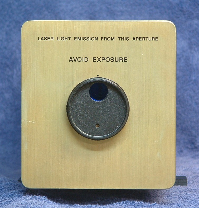

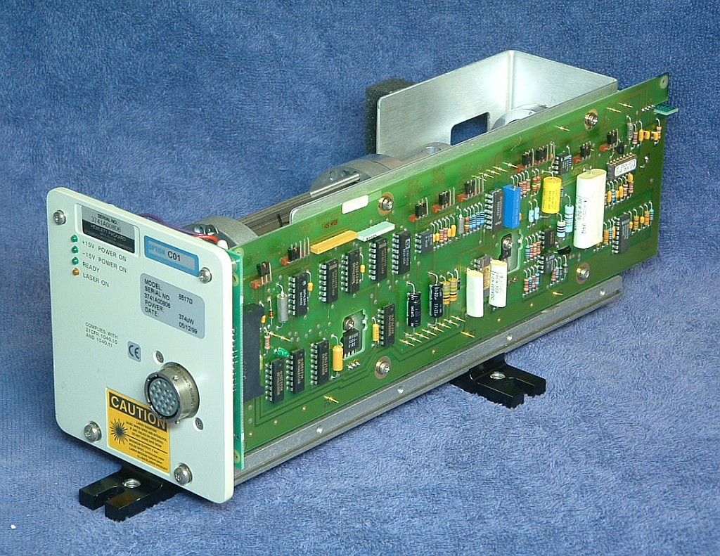

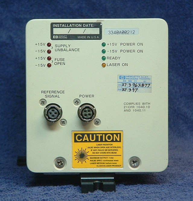

Hewlett Packard 5517D Helium-Neon Laser Head (Gallery)
The 5517D has the highest REF/split frequency and thus highest performance
of any of the "standard" HP/Agilent lasers. But the onlydifference
compared to the 5517B and 5517C is the Zeeman HeNe laser tube assebmly;
everything else is identical. Thus, except for the tube part number and
labels on the case and tube assembly, these photos apply to the HP-5517B
and HP-5517C as well. And the tube assembly only differs internally.
Its appearance is identical (except for part number) for the 5517B/C/D
lasers.
View 01 - Left front view.
View 02 - Front plate view.
View 03 - Right back view.
View 04 - Back plate view.
View 05 - Left front interior view.
View 06 - Left side interior view showing Zeeman HeNe laser tube
assembly.
View 07 - Back right interior view.
View 08 - Right side interior view showing the Type I Control PCB.

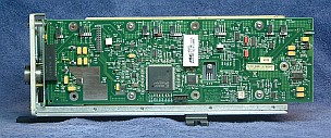

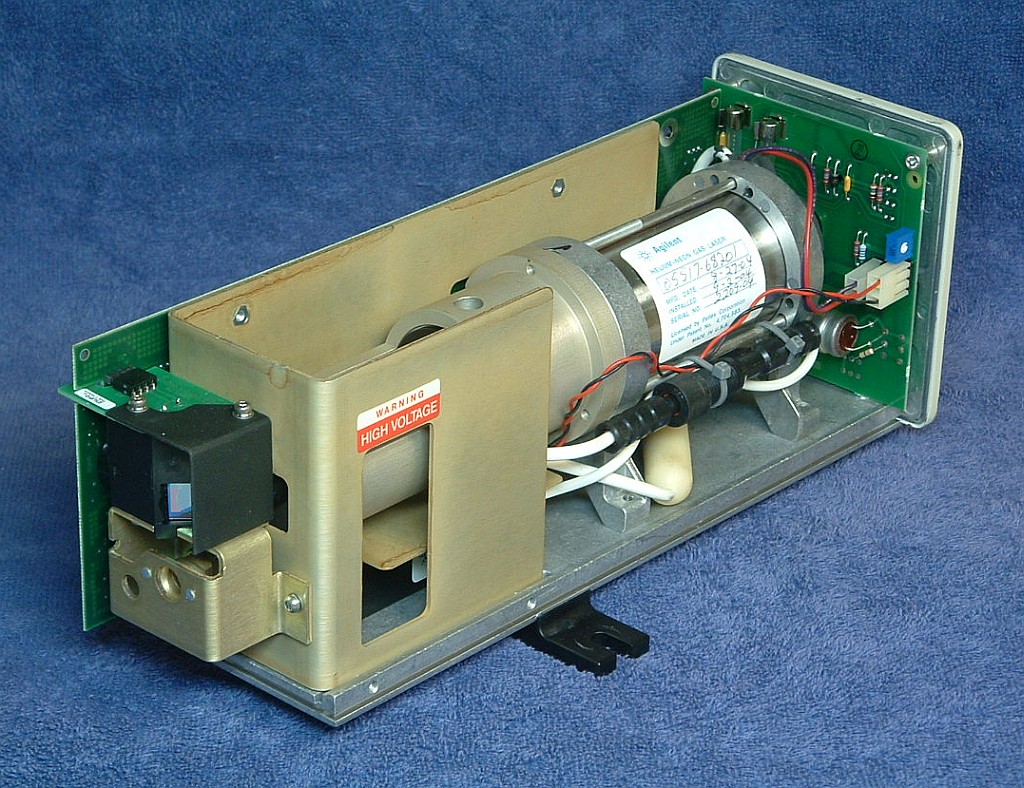

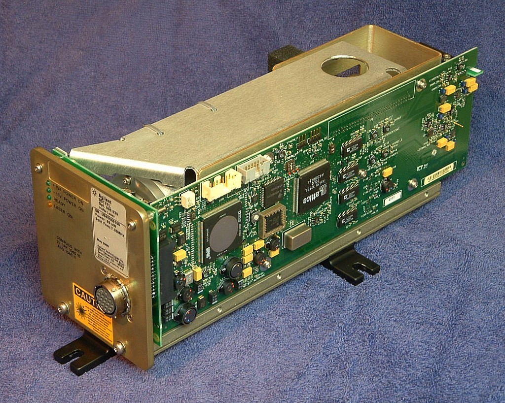

Agilent 5517B Helium-Neon Laser Head (Gallery)
The Agilent 5517B is typical of all the Agilent 5517 lasers made after
2002 or 2003. These include the 5517B, 5517C, and 5517D. They require
external interferometer optics and an optical receiver for each axis.
These have the Type II Control PCB. The cover shown is the flimsy
sheet-metal shroud used on Agilent lasers, but they are otherwise identical
to the end-user slightly more spiffy covers found on older HP lasers.
Those with an "L" (e.g., 5517DL) have a vented cover (shroud) but are
otherwise identical.

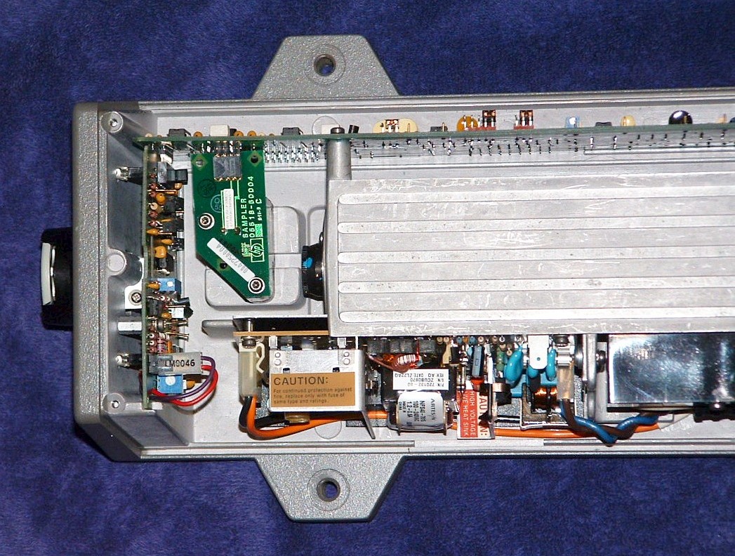

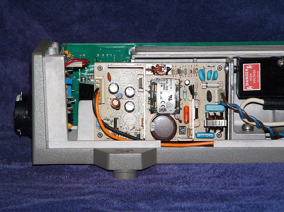

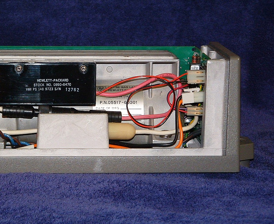

assembly.

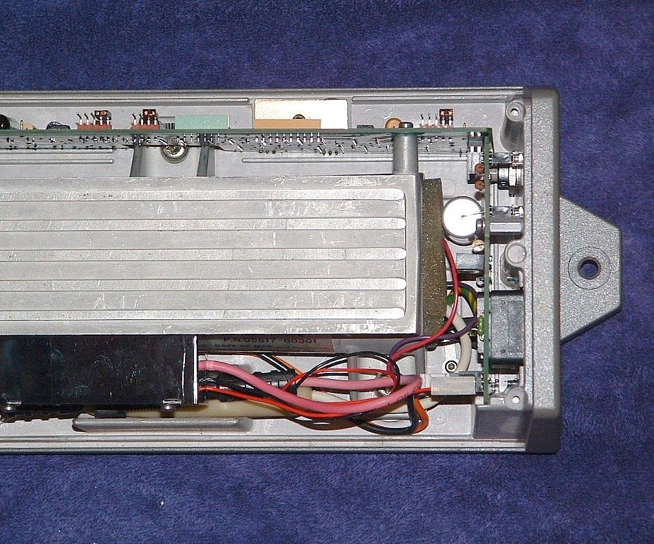

View 07 - Right back interior view.

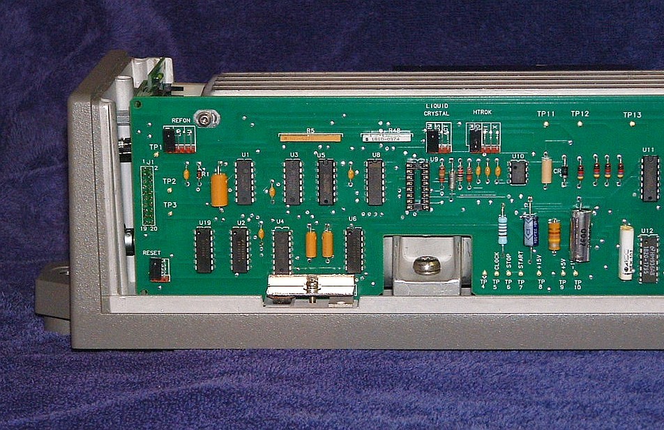

View 08 - Right side interior view showing Type II Control PCB.
