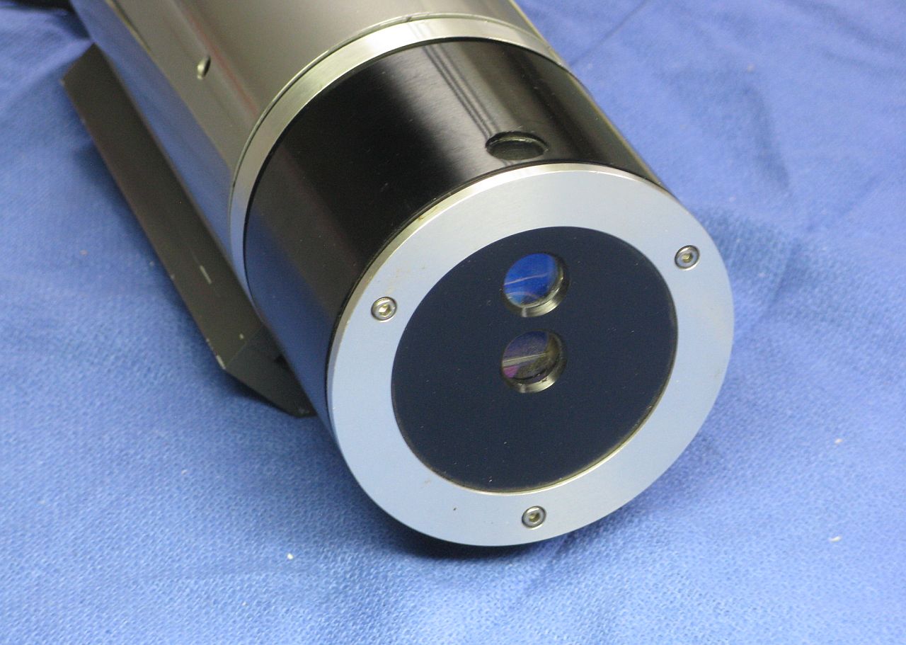

- Perkin Elmer 5800 Stabilized HeNe Interferometer Laser Head (Gallery)
This consists of a stabilized HeNe laser combined with interferometer optics
and an optical receiver for displacement measurement using homodyne
interferometry.
View 01 - Perkin Elmer 5800 interferometer laser left front.
View 02 - Perkin Elmer 5800 interferometer laser front view.
