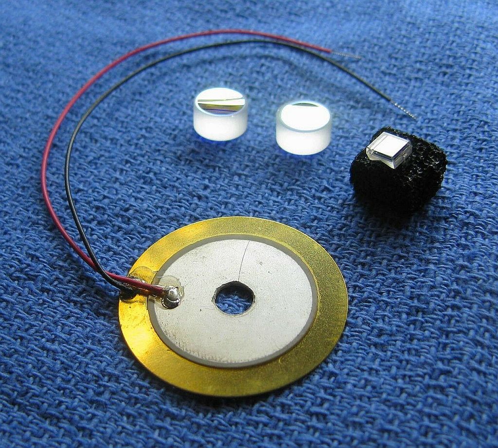

The typical parts are shown below:
The kit includes the following:

A resonant cavity needs to be constructed that can be adjusted precisely so the mirror are spaced exactly by their RoC while maintaining parallelism with their centers on the same axis. One of the mirrors must be mounted on the PZT while the other will be attached to a plate. With care, both mirrors can be on fixed mounts (one being the PZT). For easier setup, attaching one of the mirrors to an adjustable mount (in pan and tilt) may make alignment easier, but for this short cavity it really isn't required.
The diagram below shows just one example of a suitable design using Home-Depot hardware and scrap parts. This is actually more complex than needed with everything adjustable. With a short spherical mirror SFPI like this, careful assembly without any user adjustments except to be able to set the cavity spacing precisely will suffice - alignment of the overall SFPI with respect to the laser will be work just fine, thank you. :) The other extreme is to use Newport or Thorlabs optical breadboard components. But if you can afford those, you may not need to be messing around with this kit! But see the Deluxe SFPI kit!
A pair of mounts for 1 inch optics would be best. Use an adapter (available from Thorlabs) to install one of the mirrors in its mount. Attach this to a linear slide on a baseplate with a micrometer adjustment. Glue the other mirror to the PZT center using 3 dabs of 5 Minute Epoxy. DO NOT USE SUPERGLUE!!!!! Once the adhesive has cured, attach the PZT to the other mirror mount so it contacts only around its perimeter (to allow the center to move). Use an insulating pad and fasteners if it is to electrically float. Attach this mount to the baseplate with a spacer (if needed) so the centers of both mounts are precisely in-line.
Note that the "older mirrors" were ground with some "wedge". A shim should be placed behind the mirror at the low side to compensate. A piece of an Avery™ sticky label works well. ;-)

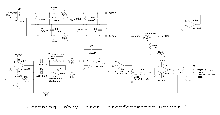

  2. Connect the PZT to your ramp generator. If driven at a kHz or so at 10 or 20 V p-p, a tone should be audible from the PZT confirming that it's working.

  6. Drive the PZT with a 10 to 20 V p-p ramp (or triangle) at 50 to 100 Hz.
