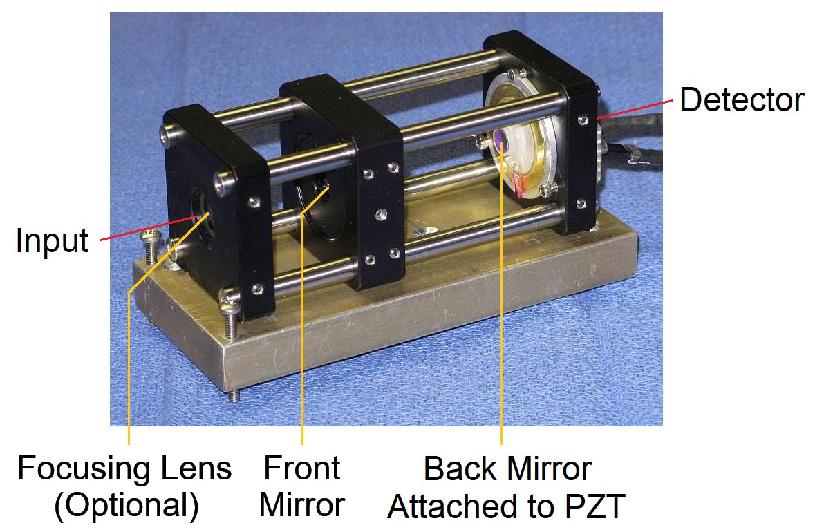

PZT and back mirror
Prepare the aluminum spacer ring and attach the PZT disk to it. (Using the ring isn't essential but will make mounting to the Thorlabs plate slightly easier and provide a path for the PZT leads inside the plate to exit out back.)
Using a narrow file, create a notch wide and deep enough on one surface of the mounting ring for the PZT leads to pass through between the ring and mounting plate.
Use 5 Minute Epoxy to attach the PZT disk to the aluminum spacer ring around its perimeter. The active (coated) side of the PZT disk should be facing up.
The back cavity mirror must be glued to the PZT.
Gently clean the active (top surface) of the PZT disk with alcohol before attaching anything to it.
Center the mirror on the PZT disk. While holding it in position with the flat side of a toothpick across the top or (less desirable) a clean cotton swab, apply the tiniest amount 5 minute Epoxy in 3 locations around its perimeter. Just enough to secure it. Once the Epoxy sets up, additional adhesive can be added to increase the strength, but there really isn't much stress on this thing and too much adhesive may restrict the motion of the PZT. Double check that the mirror hasn't shifted position and adjust as needed before the Epoxy sets up.
Set this assembly aside covered so the mirror doesn't collect dust or fingerprints.
Front mirror
The front cavity mirror is installed in the SM1AD8 adapter. Remove one of the retaining rings. Slip one of the cavity mirrors in, coated face first. Something compliant between the back of the mirror and second ring is required to (1) prevent crunching of the mirror (which is bad form) and (2) to assure that the front face seats square. A rubber O-ring is ideal, but a piece of thin wire insulation (without the wire) can be curled up to fit. Screw the second retaining ring in so it is just snug. Don't overtighten. Be particularly careful not to touch the coated surface and not to ding either surface while tightening the ring. (Tighten from the AR-coated side - damage to it is less of a disaster!)
Remove one retaining ring (if present) from the CP02T/CP33T cage plate and adjust the other one so it is just flush with the front of the CP02T.
Screw the SM1AD8 adapter in until it is 1 or 2 turns away from the retaining ring.

Completed SFPI on Three-Screw Adjustable Base (not included)
The focusing mirror is barely visible inside the hole in the cage plate on the left. The front mirror is inside the cage plate in the center. The PZT with back mirror is on the right. In the photo, the edge of the PZT is is glued to an aluminum ring, which is secured with screws to the cable plate on the right. However, just gluing the PZT around the edge to the cage plate is acceptable as long it is carefully centered AND only attached around its perimeter; the center with mirror must be free to move back and forth, if only by a few microns.
