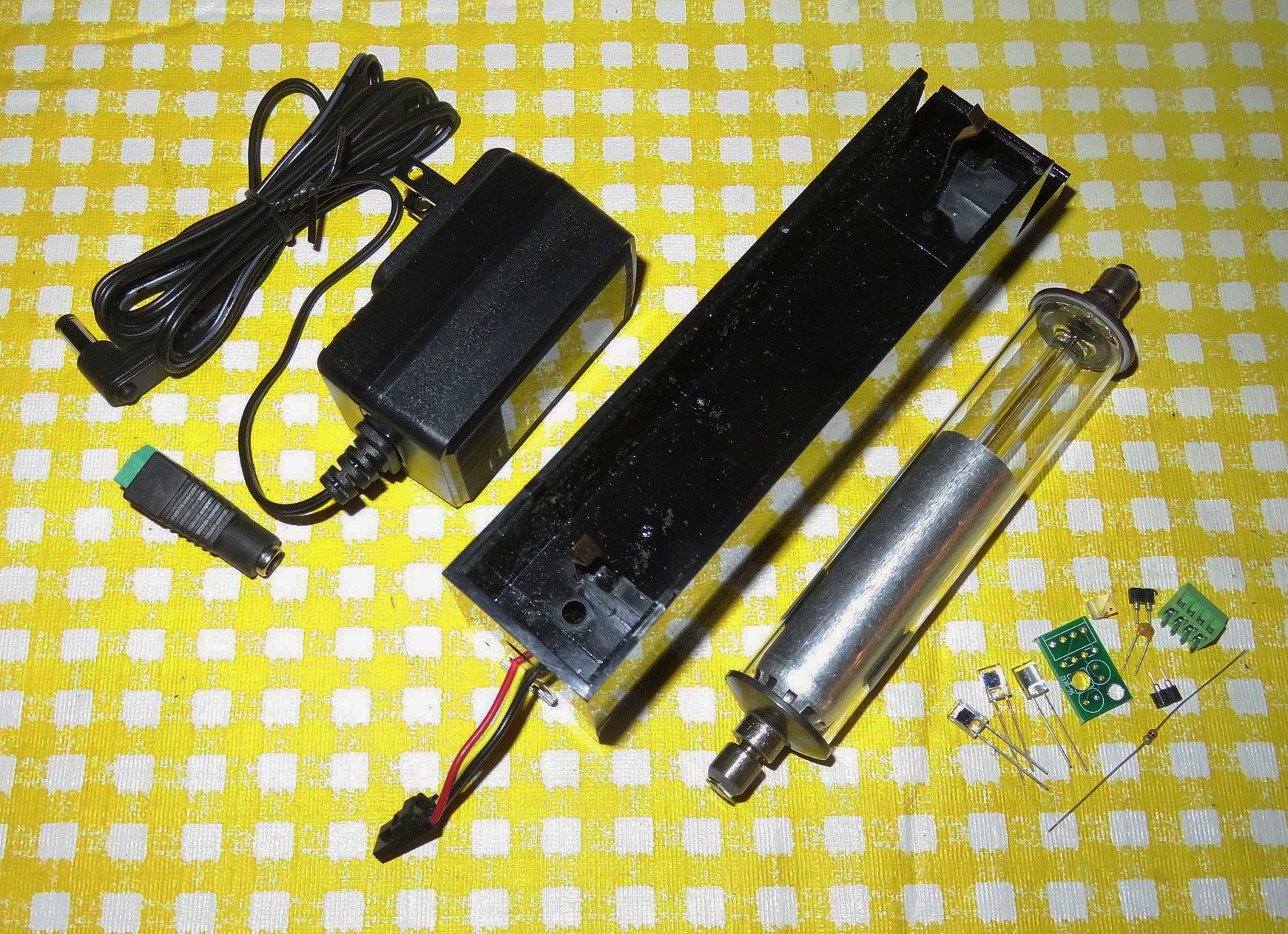

These are the major components included in both the Arduino and non-Arduino versions of this kit:
The Arduino version adds the following:
What you will need to provide:

Power and wiring:
The kits will either come with a barrel connector already attached to the power supply DC wires, or separately. Red is +12 VDC; black is Ground (12 V return), and yellow is Enable when tied to the Ground. For the stabilized laser, black and yellow should be securely tied together (tightly twisted or soldered) and connected to Ground.
Pay particular attention to the tube to determine the anode and cathode ends, and where the output beam comes from. For most of the tubes, the output is from the anode-end. The high voltage output of the is on the tube clip at the end of the housing AWAY from the DC input leads. It must go to the anode-end of the tube. The anode is the glass-end of the tube; the cathode is the aluminum can-end. The tube may start and appear to run normally with reverse polarity but will likely be damaged quickly. The housings were intended for anode-end output tubes so there wasn't even an exit aperture at the other end of the tube. But for the Compact stabilized kits, a hole will probably have been already drilled at the cathode-end of the housing in case it is desired to use waste beam sampling for feedback.

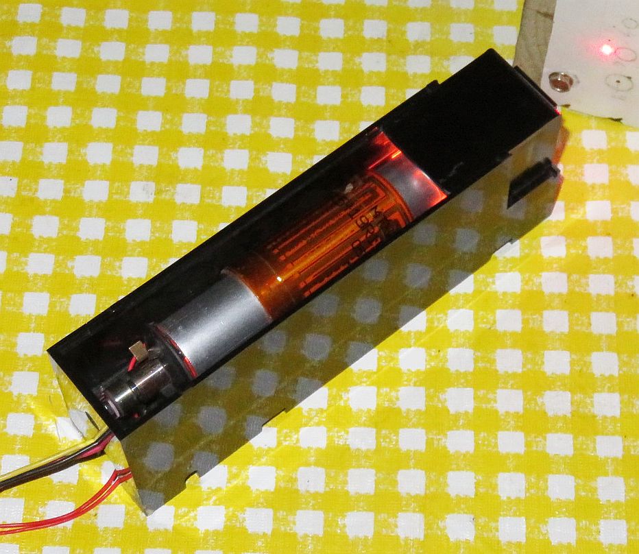

Install the heater:
For the ~1 inch diameter tubes, the 2x3" heater should be wrapped around so it covers most or all of the circumference. (The 3 inch dimension goes around it.) The Kapton heater has an adhesive backing. Peel off the backing paper and stick the heater on centered between the two end-caps. For convenience (this is sort of arbitrary) orient it with the wire connection point on the opposite side from the tip-off (metal tube sticking out of the end-bell at cathode-end of tube where the air was removed and the HeNe gas was added). Press it firmly in place over its entire surface but avoid stressing the leads where they are glued to the heater. A couple strips of Kapton tape may be useful to make sure it doesn't come loose.
Note that during operation, the heater and tube will get quite toasty since it has to run well above ambient temperature for the stabilization to be effective. And it needs to be hot enough that the normal temperature rise from the HeNe bore discharge alone doesn't come close.
But take precautions that this doesn't get out of hand. Running the heater at 12 V continuously can potentially result in a meltdown - of the plastic housing at least! One way to avoid this would be to cut away the plastic side panels between the rear end-cap of the tube and the cover in the front using a high speed cut-off wheel (e.g., Dremel™), coping saw, or similar tool. Or even simpler: Drill a series of large (e.g., 1/2 inch) holes in each side of the case. Of course, remove the tube first. ;-)

Thread the 2 red wires from the heater through the hole at the bottom-rear of the housing routed so they pass on the plastic-side of the mounting clip. Then slip the tube into the mounting clips as far back as possible and with the tip-off UP so that the end-bell against the clip. It should fit easily. And just to reiterate, the tip-off should be at the end of the housing with the DC input wires! ;-)
