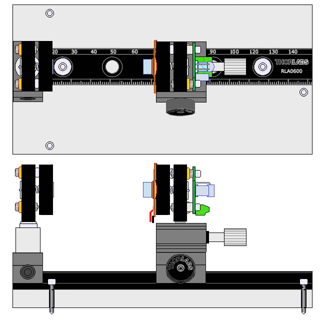

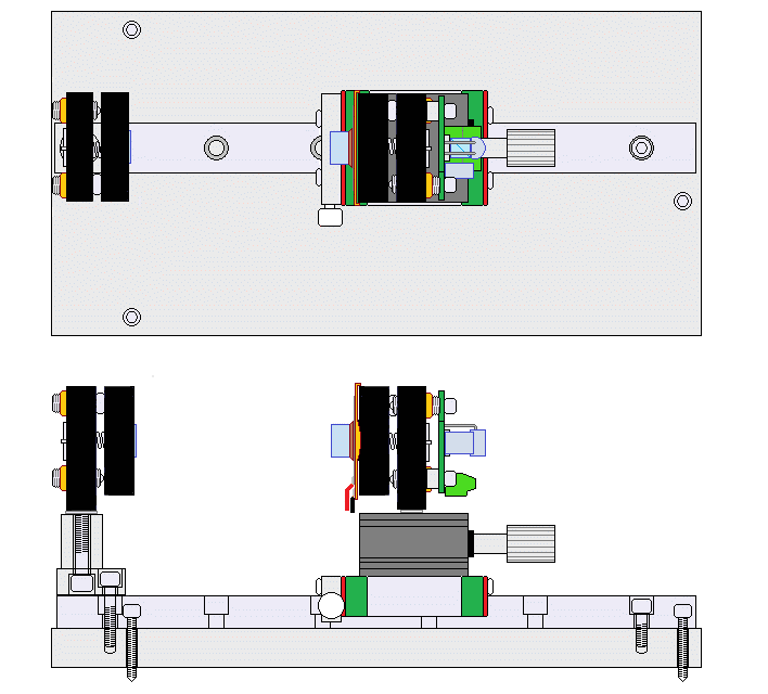

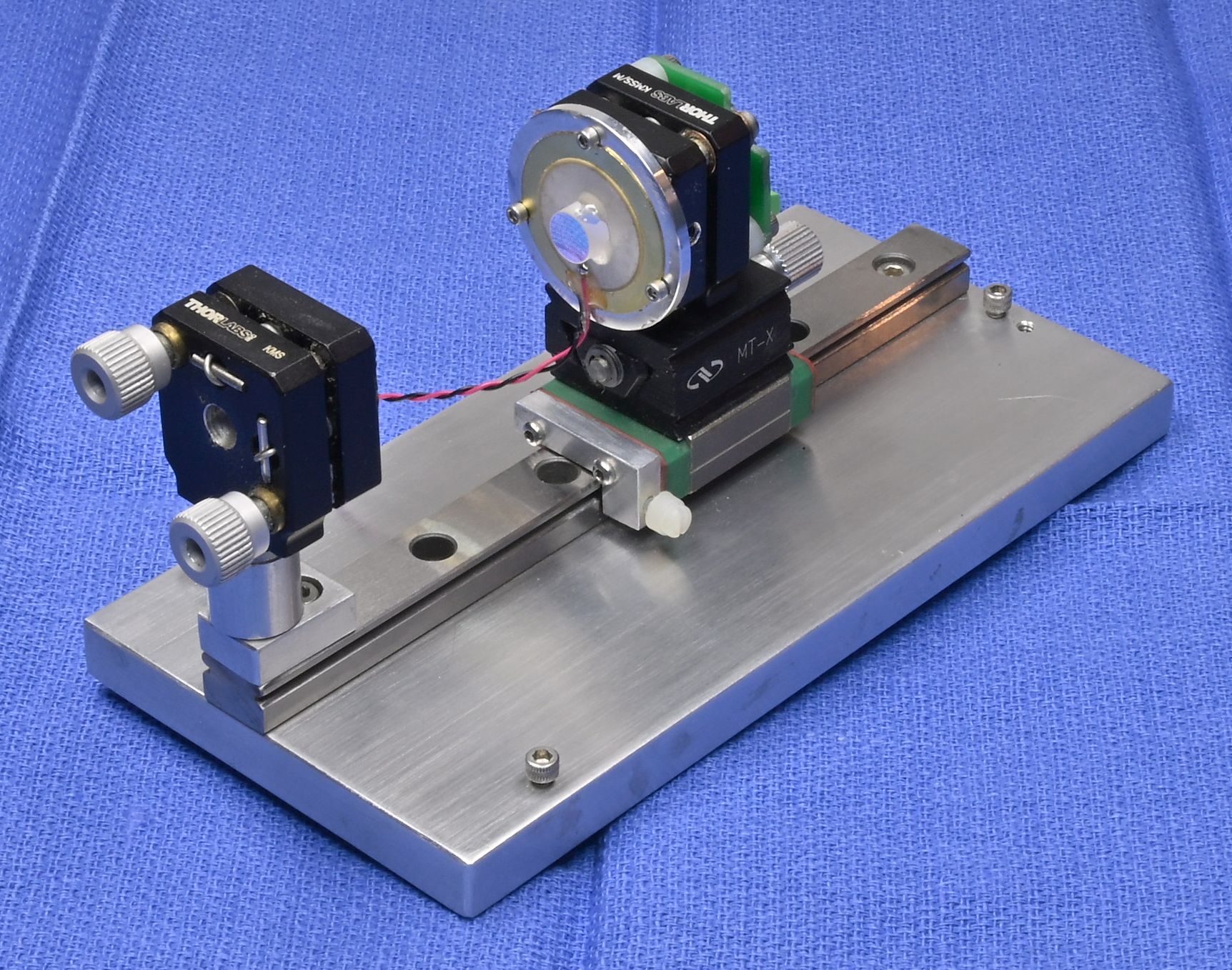

Semi-X-ray drawings of the top and side views of the Selectable FSR SFPI along with a photo of the version using a ball bearing rail are shown below.
      Selectable FSR SFPI using Thorlabs Rail
Selectable FSR SFPI using Thorlabs Rail (Left Diagram) and Ball Bearing Rail (Right Diagram and Photo)
The rails allow one of the mirrors to be positioned from the mirrors nearly touching to over more than 3.5 inches (8.89 cm), which is the spherical spacing and the largest one that is stable. The carrier may be locked in position so that fine adjustments can be performed using the micropositioner. The kinematic mirror mounts enable the alignment to be fine tuned.
The Thorlabs version is simpler to construct requiring no custom parts other than the baseplate, Everything is held together with screws. But gross movement of the rear mirror may not be very smooth or precise. Since the translation stage will make up for any position error, as a practical matter this may only be significant only if constantly fiddling with the N or k parameters. ;-)
The MGN12 ball bearing rail version allows for very smooth movement but is more complex to assemble and locking is not as secure as with the Thorlabs RC1 carrier. Everything is held together with screws except for the joint between the linear slide and MGN15 carriage, which may use 5 minute Epoxy. I was not able to drill a mounting hole in the steel carriage block. :( Take care that the translation stage is perfectly parallel to the carriage block as that will impact alignment as the spacing is changed. An adapter plate could be fabricated if desired with four countersunk holes for the carriage block and a central 8-32 tapped hole for the translation stage. But that would increase the height of the front mirror.
For both versions, the mounting of the PZT can be done using adhesive or screws into (added) tapped holes in the rear mirror mount. But a spacer of some sort (which sold be an unused one inch threaded lock ring or even a length of bare wire) should be placed between them so that the center part with the mirror is free to move, even if that is imperceptible.
