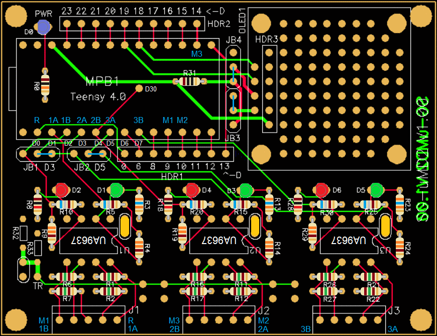

SG-µMD2 PCB Layout Version 1.0
Refer to the SG-µMD2 board layout below. Clicking on these will bring up higher resolution versions in a single separate tab or window depending on your browser settings:
SG-µMD2 V1.0 PCB Layout Diagrams for V1.0 and V1.2 Schematics (Left) and Minimal Single Axis PCB and Three Axis Populated PCB with OLED Display (Right)
(JB1 and JB2 Jumpered for Homodyne Mode; JB3 and JB4 Jumpered for OLED GND on the Left and VCC on the Right)
(All kits going forward will have red and green LEDs for the A and B signals; the original prototype was all boring green. Please pay attention to the values for the current limiting resistors as they differ by more than an order of magnitude for the red and green LEDs to equalize their perceived brightness. Where the signal LEDs are all green, the R3,R8,R13,R18,R23,R28 will be 10K ohms.)
In addition to the resistor color codes and component references, the layout diagram also shows the signal locations for homodyne and heterodyne on the Teensy. Sorry about the silkscreen component references being missing on the actual PCB; this will have to do.

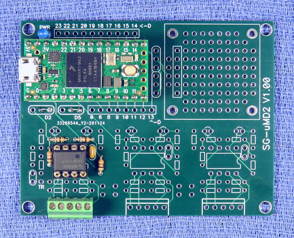

The populated PCB shows all components required for a three axis system with the OLED display. The terminating resistors (near the screw terminal blocks) have not been installed since their value may depend on the specific configuration, and can often be left out. Five pin headers may be substituted for the screw terminal blocks if desired. The signal LEDs shown are all green in the photo, sorry. :)

  16. ( ) Assemble the Teensy 4.0 PCB to the pin or socket strips. There will either be a pair of 14 pin female-male socket strips precut or the male to male pin strip that needs cutting:
    • Female to male socket strips: The male pins slip through the Teensy PCB holes from the top so the female sockets are accessible when Teensy is plugged into the large socket on the SG-µMD2 PCB.
    • Male to male pin strip: The short pins slip through the Teensy PCB from the bottom. (This is what's shown in the photo of the completed SG-µMD2 PCB, above.)
    Solder a single pin near the center and confirm it seats flush, then solder the rest. To assist in alignment, the strips can be inserted in the 28 pin socket taking care not to push any of the individual pins out of position.
  17. ( ) Test the Teensy as above before plugging it into the SG-µMD2 PCB to confirm the soldering hasn't done anything bad. Then unplug the USB cable.
  18. ( ) Carefully plug the Teensy into the 28 pin socket. The USB socket faces off the left side of the PCB as shown in the layout diagram. Make sure all pins are seated and none are hanging off the socket. CAUTION: Make sure all the pins line up with their entry points in the socket to avoid squashing the leaf sprint contacts.
  19. ( ) Reattach the USB cable. The power LED should come on immediately and after a second or so, the Teensy LED should start flashing as before. Unplug the USB cable.
  20. ( ) Plug a UA9637 or UA9639 IC into the U1 position. The dot or cutout should face to the right - these ICs are upside-down compared to the Teensy part labeling as shown in the layout diagram.
  21. ( ) Reattach the USB cable. The power LED and possibly one or both LEDs near U1 (if installed) should come on immediately and after a few seconds, the Teensy LED should start flashing as before.

    R6     Resistor  150 ohm, 1/8 W   IN2 termination
    R7     Resistor  150 ohm, 1/8 W   ~IN2 termination
    R8+    Resistor  10K ohm, 1/8 W   1B/MEAS1 LED current limiting
    R9     Resistor  330 ohm, 1/8 W   1B/MEAS1 5V->3.3 V level shift
    R10    Resistor  680 ohm, 1/8 W   1B/MEAS1 5V->3.3 V level shift
    R11*   Resistor  150 ohm, 1/8 W   IN3 termination
    R12*   Resistor  150 ohm, 1/8 W   ~IN3 termination
    R13*+  Resistor  10K ohm, 1/8 W   2A/MEAS2 LED current limiting
    R14*   Resistor  330 ohm, 1/8 W   2A/MEAS2 5V->3.3 V level shift
    R15*   Resistor  680 ohm, 1/8 W   2A/MEAS2 5V->3.3 V level shift
    R16*   Resistor  150 ohm, 1/8 W   IN4 termination
    R17*   Resistor  150 ohm, 1/8 W   ~IN4 termination
    R18*+  Resistor  10K ohm, 1/8 W   2B/MEAS3 LED current limiting
    R19*   Resistor  330 ohm, 1/8 W   2B/MEAS3 5V->3.3 V level shift
    R20*   Resistor  680 ohm, 1/8 W   2B/MEAS3 5V->3.3 V level shift
    R21*   Resistor  150 ohm, 1/8 W   IN5 termination
    R22*   Resistor  150 ohm, 1/8 W   ~IN5 termination
    R23*+  Resistor  10K ohm, 1/8 W   3A LED current limiting
    R24*   Resistor  330 ohm, 1/8 W   3A 5V->3.3 V level shift
    R25*   Resistor  680 ohm, 1/8 W   3A 5V->3.3 V level shift
    R26*   Resistor  150 ohm, 1/8 W   IN6 termination
    R27*   Resistor  150 ohm, 1/8 W   ~IN6 termination
    R28*+  Resistor  10K ohm, 1/8 W   3B LED current limiting
    R29*   Resistor  330 ohm, 1/8 W   3B 5V->3.3 V level shift
    R30*   Resistor  680 ohm, 1/8 W   3B 5V->3.3 V level shift
    R31    Resistor  10 ohm, 1/8 W    V3.3 protect
  SKT28    Socket    28 pin, 600 mil  Socket for Teensy 4.0
   SKT8    Socket    8 pin, 300 mil   Socket for IN1/2/REF/MEAS1 line receiver
   SKT8*   Socket    8 pin, 300 mil   Socket for IN3/4/MEAS2/3 line receiver
   SKT8*   Socket    8 pin, 300 mil   Socket for IN5/6 line receiver
  SKT40+   Socket    40 pin, SIP      Socket strip for HDR1,HDR2,JP6
    U1     IC       UA9637 or UA9639  REF/MEAS1 line receiver
    U2*    IC       UA9637 or UA9639  MEAS2/MEAS3 line receiver
    U3*    IC       UA9637 or UA9639  MEAS2/MEAS3 line receiver
"*" denotes parts that can be omitted for a sigle axis system. "+" denotes parts that are not required for µMD2.
