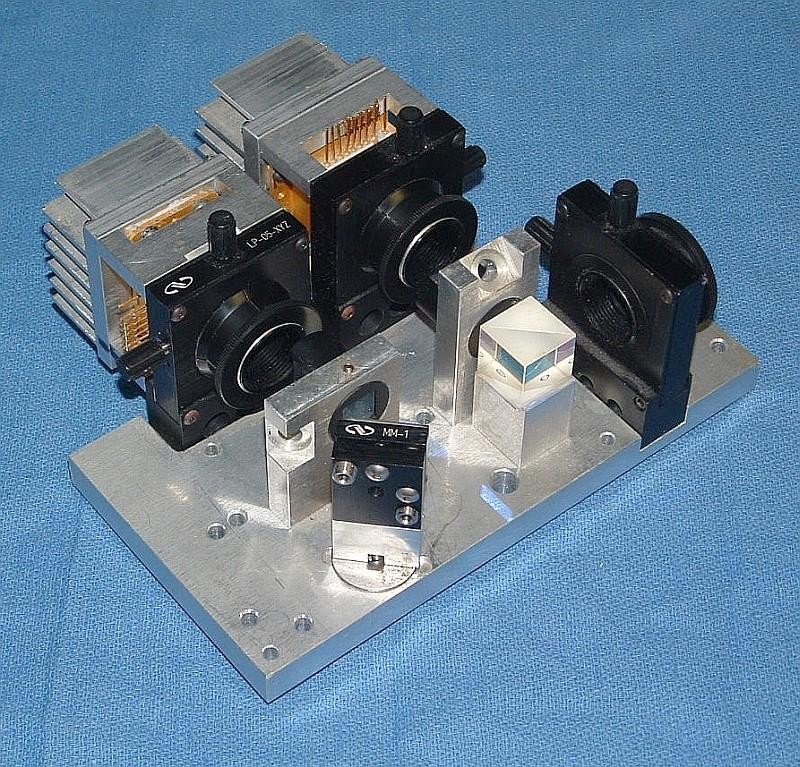

    Some Photos of Home-Built DPSS Lasers
    OK, not all these are actually home-built but are of the general design that could be constructed using available components and modest machining skills.

    I have bought a Lightwave Electronics diode pumped Nd:YAG head, that I hope to be able to double to 532 nm, and build or buy a PSU and chiller for. I want to use it for light show purposes, both beam shows and graphics.
    The first thing will probably be getting a PSU or driver for the diodes. So if anyone has a driver, capable of doing 25 A, at a reasonable price, I would be very interested.
    Also, I would need to find out where to put the KTP crystal, and which optics to change to be able to do 532 nm. I think I am going to pull out the AOM, as I really won't be needing it (it can only dim the beam down to 3 W according to the manual). There is also some strange very magnetic box, that I would like to have identified.
    So if anyone have some input, that would help me, please post it to alt.lasers! I will try to update the page with the new information, that I get, and the changes that I make to the laser, and take more pictures of the things that are talked about.
    I am hoping to make this kind of an on-line project, since I do not have near all the knowledge to complete this project, so I could use some help from you guys, who know this stuff. :-)
    (From: Bob.)
    These are nice lasers. For starters, this laser is actually capable of getting maybe 20 W of 1,064 nm at full power. Lightwave derated the diodes a lot to make sure they last a long time.
    The funky magnetic box you mentioned is a Faraday isolator to keep any back reflections from working their way to the laser. You won't need it if you are going to double it to green.
    However, note that despite the organization of the cavity optics, this is not a ring laser. The HR is optic #1 and the OC is optic #4 in Simon's photos. The Faraday isolator is simply to protect against back-reflections from being coupled back into the cavity. This laser is also not Q-switched - the AOM is there just to provide optical blanking. Lightwave's current laser is Q-switched but not this guy.
    I don't know if you noticed, but the way these lasers are put together is rather tricky. There are steel plates bolted to the baseplate. Then an optic is glued into place after the laser has been aligned just the same way the big boys like Coherent and Spectra-Physics do it. Unless you want to leave adjustable mounts in this laser, you are going to have to invest in a Newport type table or breadboard, along with some optics mounts and magnetic bases.
    (From: Simon.)
    My idea was maybe to glue other optics on the steel plates (which are actually aluminum) and then file the holes in the plates bigger, so the plates can be moved a few millimeters, before the screw is tightened. That way I could do the alignment, in at least the two axis, by moving the plates.
    (From: Bob.)
    Two axis alignment really isn't going to cut it unfortunately, you would really need something to align in 3 axes.

    Is this necessary? Why not have adjustable mounts in the laser itself?
    It would be no problem to drill more holes in the baseplate to mount more holders. I have access to precision machinery, that can do this without getting metal filings everywhere.
    (From: Bob.)
    If you have adjustable mounts then you will have to open this sucker up from time-to-time for alignment. Adjustable mounts ALWAYS drift. This laser should ONLY be opened in a clean-room environment, so it would be a pain in the you-know-where to do alignment in the field.
    Machining without debris landing in unfortunate places is easier said than done. Just be very careful of the optic surfaces. One flying chunk of metal can destroy the end face of a rod or diode bar.
    (From: Simon.)
    I don't want to open it up in the field, unless something has gone very wrong. It has to be glued in then.
    I understand about the risk of flying debris. But I can drill it at very low rpm and have a shield around the drill to prevent shrapnel from going anywhere. That kind of stuff I am qualified in. :-)
    As far as degrees of freedom goes, I guess placing a small washer or something under one of the screws, won't be the solution. :( What about just gluing the new optics on the front of the old optics? The old optics are aligned, and their fronts are perfectly flat, so placing something up against it, should also make this aligned? But on the other hand, there probably don't need to be much glue on one side of the optic to make it unaligned anyway.

    But I think I need a bit of a crash course on aligning laser optics. How do you do it? You cant touch the optics without contaminating them. And you can't just fire up the laser to see where its hitting without risking your vision. And you can't see 1,064 nm anyway. Maybe you can feel it. :-)) There must be some trick, I don't know??
    (From: Bob.)
    For alignment, you will really need an IR viewer. You can pick them up on eBay for around $500.
    I suppose a video camera or camcorder with the IR filter removed might be an adequate substitute.

    Laser Pump Diode Beam Correction
    The simplest, if not least costly way to double the pump power is to obtain a higher power pump diode. However, this normally means that the emitting area (stripe width) also increases so that all other factors being equal, the spot or mode size in the laser crystal also increases.
    One way to double the pump power without increasing the spot size is to optically combine two similar pump diodes. Since these types of edge-emitting laser diodes are polarized, a pair of them can be combining using a polarizing beam splitter producing a result that is very nearly double the output power of a single diode, but is non-polarized.
    Combining optics consists of:
    1. Fast axis correction (optional, cylindrical microlens).
    2. Beam collimation (spherical positive lens).
    3. Slow axis correction (anamorphic prism pair)
    4. Turning mirror or other means for aligning the two beams.
    5. Polarizing beam-splitter used as beam combiner (PBS cube).
    6. Focusing lens(es) if required.
    Items 2, 4, and 6 will need to either be adjustable using precision mounts, or be glued in place once positioned properly. The optics and beam-splitter must be coated for the desired wavelength.
    A typical setup for beam combining is shown in Optical Assembly for Combining of Laser Diodes. A pair of packaged laser diodes like the SDL/Uniphase 2372-P1 (2 W, 808 nm) are mounted at right angles to each-other (barely visible attached to the heat-sinks). These typically have built-in TECs and temperature sensors, as well as monitor photodiodes. They usually do not have fast axis correction, so coupling efficiency may be slightly reduced. The Newport LP-05-XYZ mounts provide for X, Y, and Z translation to precisely position the collimating lenses. The anamorphic prism pairs for slow axis correction are in the fixed mounts and have a place to install photodiodes for monitoring optical power externally, via the slight reflection from the first prism. A turning mirror on the Newport MM1 adjustable mount permits the two beams to be aligned into the polarizing beam-splitter cube. The third Newport LP-05-XYZ holds a focusing lens and is used to precisely direct the output beam and position it's waist optimally inside the laser crystal.
    This is the sort of arrangement that is often used in the lab for experiments with DPSS lasers and noted in research papers with the terse description: "The outputs of two laser diodes were combined....". :) It may also be used (perhaps without the final focusing lens) for laser light shows and other applications where more power is better.
