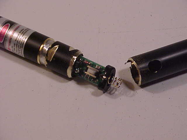

I already owned one green laser pointer. I bought a 2nd one specificly to take apart. I knew that there was a risk but I have been doing this for years (taking things apart that were not supposed to be) and have become very good at it. I don't care what anybody says, there ARE user serviceable parts inside. :)
The entire dissection process was accomplished with the use of a file and Dremel tool!
Then I thought why not share this information with other people and Sam's Laser FAQ came to mind. The pointer that was dissected had been returned twice due to (1) poor beam quality (2) low output. (Green lasers are just like any cheap laser pointer - no two are alike. If you want a good one you need to buy 10 and select the best from that.) It's hard to show the thin film coatings that were not of total coverage on the crystals but I speculate that the Nd:YVO4 was surplus from other purposes and used for these pointers.
I like to SEE how things work and how they are manufactured and EVERYTHING that I own, have owned, and will own, is destined to be opened and looked over. It looks like a lot of money to risk but to me it was worth it and best of all, as you will see, there was no damage to the critical components (though the case might have seen better days). I will be on the hunt for a higher power 808 nm laser diode to see if I can get more out of these components.
