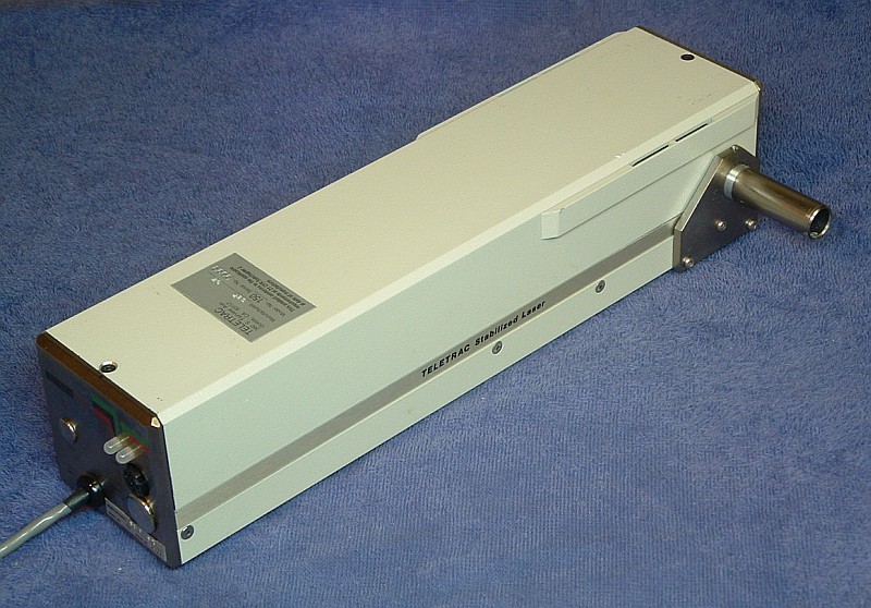

  View 01 - Left front view.
  View 02 - Front plate.  It is blank because beam exits from right side.
  View 03 - Right back view.  Note beam exit tube.

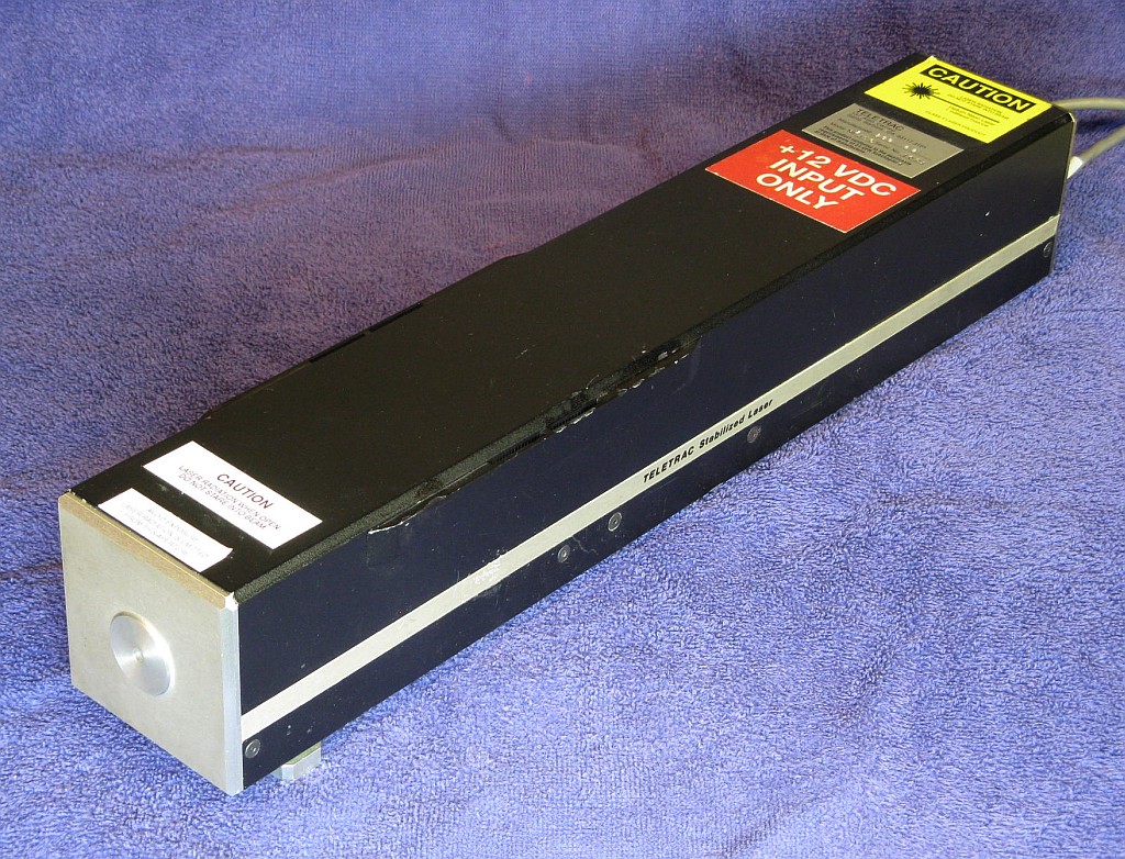

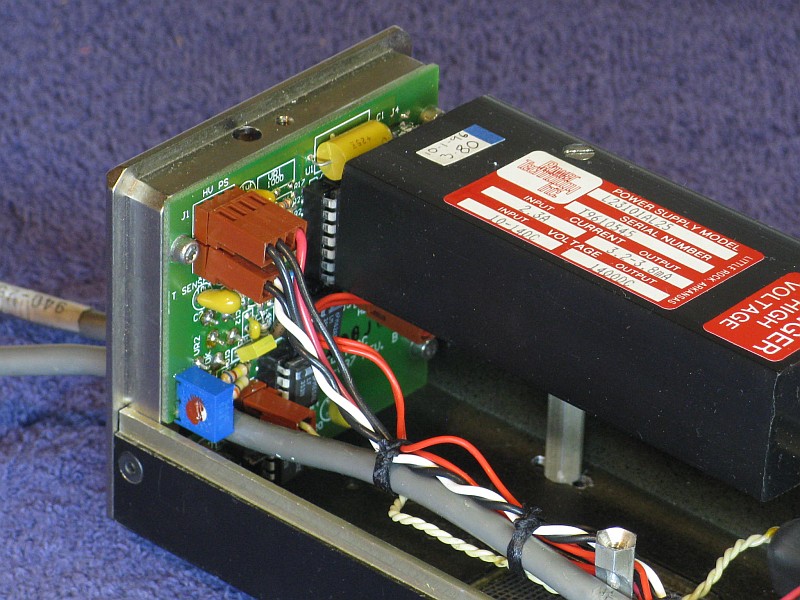

  View 09 - Control PCB (attached to back plate), HeNe laser power supply
  brick, and PZT fan (visible beneath brick).

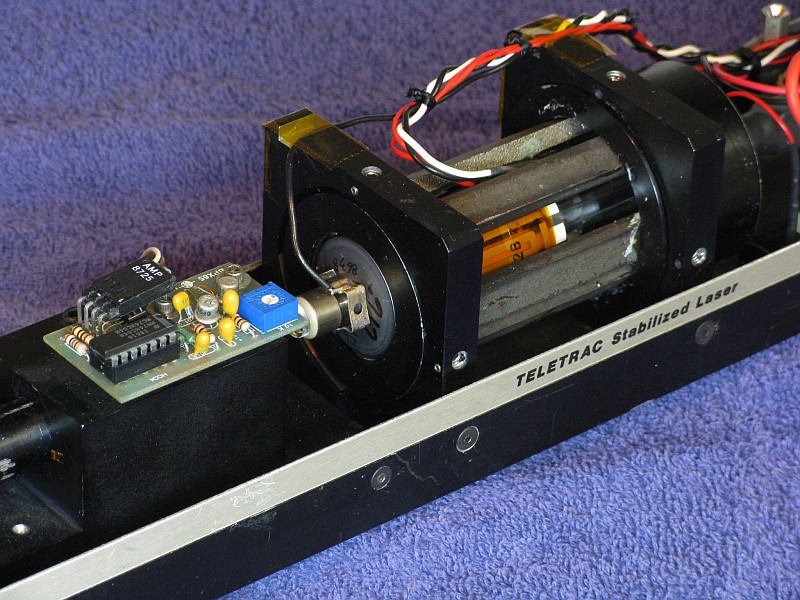

  View 10 - Closeup of tube assembly showing temperature sensor with
  third leg unconnected.  One of the heater lamps can be seen in the
  foreground.  The HeNe laser tube is from JDS Uniphase.
  View 11 - Closeup of optical receiver PCB and optics assembly.

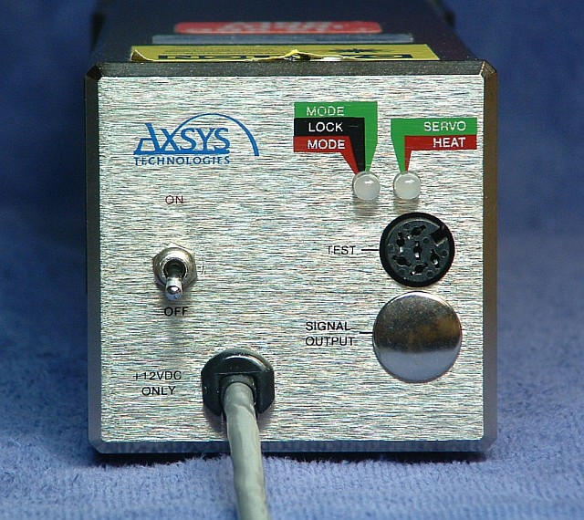

  View 04 - Back plate.  The cable is for 12 VDC power;
  The DIN connector is for monitoring status.  The left LED
  shows the mode sweep (red or green) and will be off when
  the laser is locked.  The right LED is red during preheat
  and green when locked.
