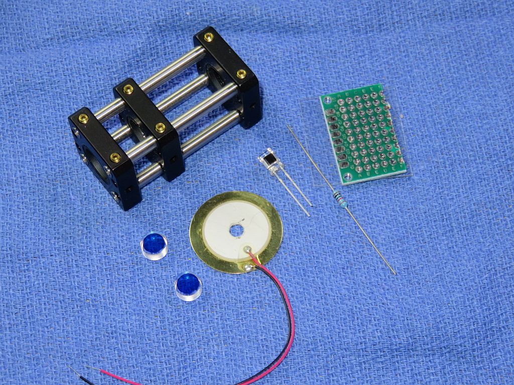

The frame for the Deluxe Mini, mirrors, PZT, and photodiode, along with a completed head using these parts is shown below. The head includes a dual polarization detector for the SFPI at the rear as well as a beam sampler and dual polarization mode detector between the focusing lens and front mirror for mLMA1. (See: Mini Laser Mode Analyzer (mLMA1).
In addition to the cage frames, the kits include:
Deluxe SFPI additional parts:

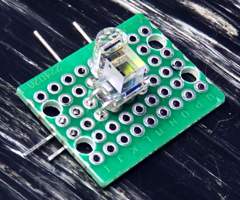

The photos below show two types of dual polarization detector assemblies using Perf. Board (not the PCB).. The one on the left is typical of what is described above and would be installed behind the rear mirror for the SFPI including mounting holes for attaching to the rear cage plate. The beam comes in from the top (in the photo) and is split between the PD sitting beside the PBS cube and the one beneath it. Since the stack of the PD and PBS cube is thicker than a PD alone, spacers will need to be placed between the Perf. board and cage plate.
The one on the right would be used for the mode display of mLMA1, so its input is at right angles to what is required for the SFPI. A non-polarizing beam sampler is required to direct a portion of the beam into the PBS cube. Note that a simple glass plate is not very good for this if aligned with one of the principle axes as would be typical because it is highly anisotropic with respect to polarization - typically 4:1. If oriented at 45 degrees to the principle axes along with the PBS, this issue would be eliminated.
In both cases, the PBS cube can be attached to the the PDs with high quality clear Epoxy or UV-cure optical cement on its faces, or using tiny drops of 5 minute Epoxy on its edges. DO NOT use SuperGlue™ (Cyanoacrylate)!!!

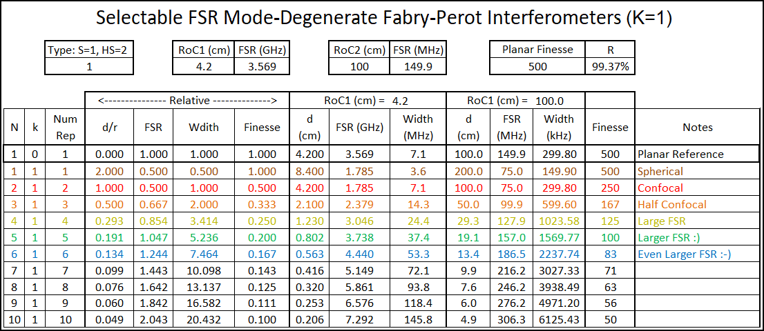

    For most applications, short SFPIs like this are set up in the confocal configuration where the mirror spacing is set equal to the RoC. This results in the Free Spectral Range (FSR, optical frequency span over which the display repeats) being equal to c/4L (c is the speed of light; L is the spacing) or approximately 1.78 GHz for the 4.2 cm RoC mirrors. This is called "mode degenerate" because any higher order spatial modes that are excited in the SFPI cavity (which is virtually unavoidable) fall on top of the fundamental TEM00 mode peaks and do not interfere with the display. Thus alignment with respect to the input beam is greatly simplified.
    However, for all but the Mini-SFPI, the frame is too short to use the confocal spacing. But there are many other discrete mirror spacings for spherical SFPIs that are also mode-degenerate. Several shorter ones are listed in the table below:
    As can be seen, as the value of n increases, the mirror spacing decreases, the FSR increases and the finesses decreases. Thus, where resolution is important, keeping n low subject to the maximum available space will be desirable.
    Two that are of interest are for these shorter SFPIs are:
    But note that even though the Planar and Spherical spacings look like they should be excellent, achieving decent performance may be extremely challenging. The Spherical spacing requires precise mode matching of the input to have a decent finesse and is too long anyhow. The spacing for Planar mirrors only affects the FSR, but alignment is super-critical and when perfectly aligned, almost the entire power of the laser beam gets reflected directly back into the laser aperture, which may destabilize it and can even damage some lasers. Thus, N needs to be 2 or higher.

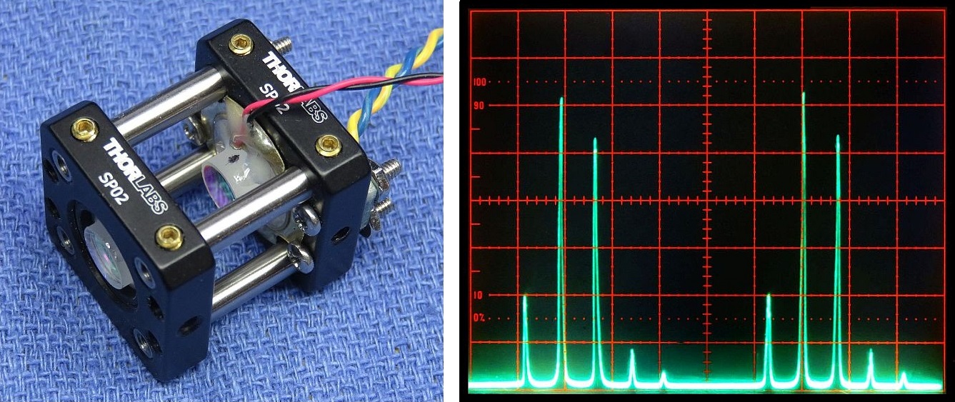

    Of the four Deluxe SFPIs discussed here, only the "Short" one can use the confocal spacing with barely enough space for the optional focusing lens. The others will require mirror spacings using higher values of n that are smaller. (There are also longer spacings that may be useful, but not here.)
    Coarse spacing adjustment can be done by sliding the cage plate on which the front mirror is mounted on the rods close to the calculated location and locking it in position. Fine tuning will then be done "live" as described below.
    Specific Cases:

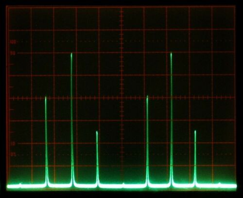

    The mode display was made by this SFPI with a Wavetek function generator and Tektronix analog scope and is of the same laser as for the confocal SFPI. While the resolution isn't as high (the peaks are wider), it is still more than adequate to display the modes of any size HeNe laser.
