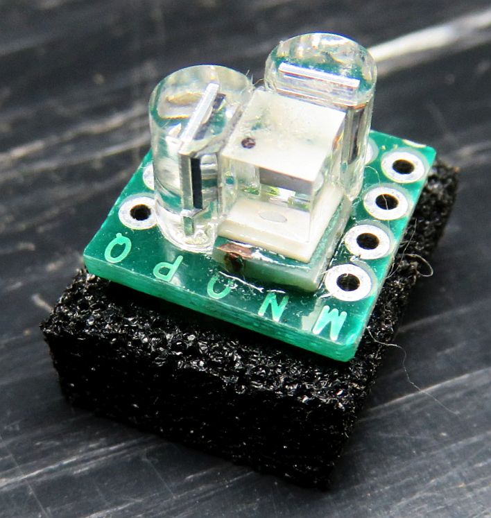

Constructing the beat detector:
PD
+5 to 9 VDC o-----------|<|---------+--------o Output
C A |
R1 \ Scope or
/ Counter
Return o-----------------------+--------o Ground
The suggested value for R1 is 2.7K which is a compromise between largest amplitude and frequency response. Feel free to experiment with higher or lower values.

Testing the photodiodes response to laser light:
The following assumes that the QWP has been installed to conver the circular polarization to linear polarization and the resultin polarization axes are known.
To test the response of the silicon PhotoDiodes (PDs) included in these kits, a simple test circuit using a few resistors, a 5 VDC power supply (or USB charger cube), and DMM can be constructed before connecting the stabilization controller. To determine the polarity of the PDs, use the DMM on the "Diode Test" range across the pins: The voltage drop will be between 0.5 and 0.6 V if the red probe is connected to the anode. The polarity is usually opposite for a VOM but they are only found in museums these days. ;-)
Wire up a test circuit as follows:
V1
R Protect PD1 | R Load 1
+5 VDC o----/\/\----+-----|<|---+---/\/\-----+
| V2 |
| o |
| PD2 | R Load 2 |
+-----|<|---o---/\/\-----+
GND/RET o-------------------------------------+
CAUTION: If the PDs are at the anode-endo of the tube, take care to keep the setup at a safe distance as they won't like being zapped by the high voltage. Nor will you. :( :)
