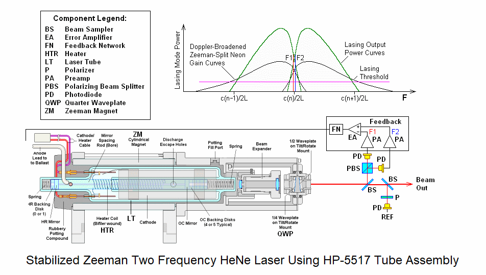

Organization of two-frequency Zeeman-split HeNe Laser:
The diagram below shows a system similar to what may be constructed using parts in this kit and readily available materials and electronics.
Many variations are possible. The Arduino implements the electronics inside the box. The REF Signal monitor is shown using the waste beam but could also be in the main beam (the polarizer would then need to be at 45 degrees). However, that would require an additional beam sampler plate (included if needed) which would decrease the output power slightly. The diagram above shows the so-called "Long" tube. The "Short" tube construction is shown below:
The main practical difference is that there is no waste beam from the Short tube so beam samplers must be used for both REF and feedback.

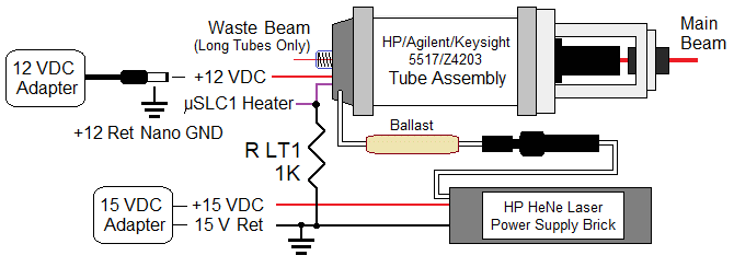

Power and wiring:
The use of the HP 5517 tube assembly simplifies the wiring and makes shocking experiences less likely since the high voltage is safely enclosed with proper connectors.

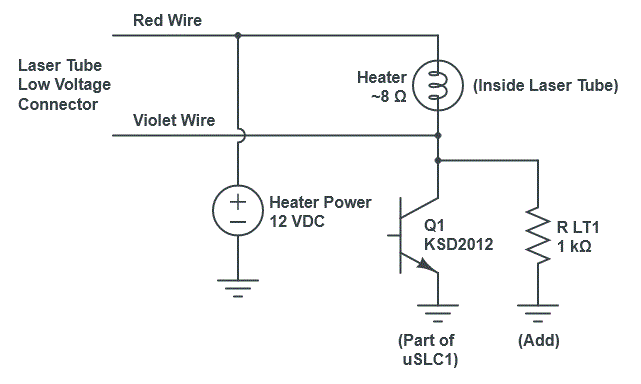

IMPORTANT: Since the tube current passes through the red/violet wires, it is critical that it has a place to go. Thus the resistor "R LT1" is essential to provide a path bypassing the heater drive transistor (Q1) on the µSLC1 PCB. Without a bypass, the tube current will attempt to go through the transistor when it is off and may blow it and possibly other stuff as well. The value is not critical - anything from 100 to 2K ohms should be acceptable. But is should be soldered directly across the tranistor so it can't come loose.
Test the tube and wiring by powering ONLY the 15 VDC adapter. The tube should light between instantly to after a few seconds. Some tubes may take longer and shining a flashlight on the back of the tube may help some reluctant tubes to start. ;-)
There should be an orange glow inside the tube (most visible at the back) and a red laser beam out the front. It should not flicker, sputter, or go on and off. If it does, which connections and confirm that the correct adapter is being used and the voltage to the brick is between 14 and 16 VDC.
