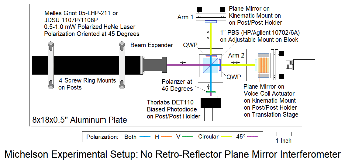

    Classic Michelson Interferometer
    All of the measurements performed by these systems are based on variations of the Michelson interferometer, invented over 100 years ago by Albert Michelson. This is one of the simplest interferometer configurations but also one of the most widely used. The textbook version is shown below:
    In short, a light beam is split into two parts which are bounced off of a pair of reflectors and recombined at a detector. Any change in the relative path lengths of the two "arms" formed by the reflectors results in a phase shift between the waves in the two beams resulting in constructive or destructive interference, which can be measured and converted to displacement (change in position) down to nanometer precision. All other types of measurements made by these systems are based on opto-mechanical configurations designed such that changes in the measured variable are detectable by what is in essense a Michelson interferometer.
    Where the Path Length Difference (PLD) between the two arms is small, the requirements for the laser are not very stringent. In fact, for very small PLDs, an LED or even a totally incoherent source like an incandescent lamp may be substituted for the laser. However, to be useful for the PLDs necessary for most applications (millimeters to 10s of meters), the light source must be a laser. And not just any laser, but one that has a narrow "linewidth". While the popular concept of a laser is of a light source that is monochromatic (single color or wavelength), in reality most lasers do not even come close. It takes careful design and implementation to achieve that. For these metrology applications the laser should ideally produce an output that is a single optical frequency with a linewidth approaching zero. In practice, it isn't that narrow but can result in a linewidth of much less than 1 MHz, resulting in a usable PLD of 100s of meters. This is usually a low power stabilized HeNe laser. However, for PLDs of a few inches, a common (much less expensive) unstabilized HeNe laser will be adequate. Within this range, all the modes will be sufficiently correlated and the fringe contrast/signal amplitude will be acceptable.

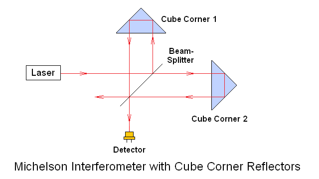

    Cube Corner Retroreflectors
    The simple Michelson interferometer setup can be used in a metrology system, but it has severe limitations which make it impractical for most applications. Alignment is extremely critical. Even the slightest deviation from perfect alignment will result in a reduction or loss of signal. Yet when perfectly aligned, one half of the optical power from the laser reflects directly back into the laser - which may destabilize it resulting in erratic fluctuations of its output in amplitude, optical phase, optical frequency, and polarization.

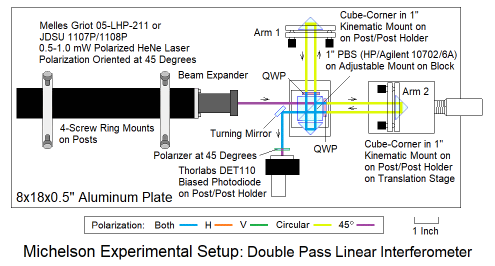

    Near the end of this manual is an experimental setup similar to the original Michelson Interferometer configuration adapted for the PBSC. So you can see these various issues for yourself.

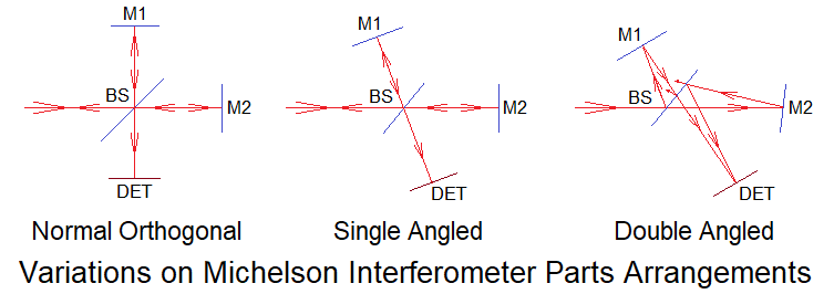

    The diagrams below show some variations on the angles of the Beam-Splitter (BS) and Mirrors (M1, M2).
    The first one is essentially the same as the diagram, above. The "Single Angled" one does nothing to prevent back-reflections. And while the "Double Angled" version does eliminate back-reflections, the two beams are angled at the detector which means their relative phase will vary across the detector. That is undesirable for our experiments in at least two ways: First, it will mean that the detector won't see a clean fringe signal. In fact there may be little or no signal depending on how the fringes average across its face. Second, alignment will change as either mirror is moved making testing with respect to PLD very tricky. But can you suggest an application where it may be useful?
    The first enhancement of the Michelson interferometer is to add a means of separating the outgoing and return beams so that there is vitrually no optical power returned to the laser. The simplest way to do this is to replace the mirrors with Retro-Reflectors (RRs), typically cube-corner (trihedral) prisms, which have the property of returning the beam directly back parallel with the outgoing beam, but which may have an offset. In this way, virtually none of the reflected light ends up back at the laser. The use of the RRs also greatly reduces the sensitivity to alignment as any change in their angle is converted to a small change in the distance between the outgoing and return beams, but they remain parallel.
    All of the practical interferometer configurations include at least one cube corner retro-reflector.

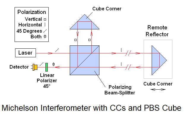

    Polarizing Beam-Splitter
    The second enhancement is to use a Polarizing Beam-Splitter Cube (PBSC) in place of the 45 degree partially reflecting mirror. While a plate beam-splitter could be used, the PBSC is much more common.
    The beams reflected to the two arms of the interferometer then have orthogonal polarization which effectively makes them independent until they are combined at the detectors.
    The result is then one of the most widely used configurations - the Linear Interferometer (LI), which was the first one used by HP in their original 5500A laser interferometer displacement measuring system. (As an aside, I do NOT know where that name "Linear Interferometer" comes from except perhaps that the inital configuration was in-line with the laser and thus "linear".) In practice, Arm 1 is used as the reference and is made as short as possible with the Cube Corner (CC) attached directly to the PBS cube. Both arms can move where differential measurements are required.
    With the use of the PBS, the maximum amount of the laser optical power is available - virtually nothing exits out the unused side of the beam-splitter as it would in the original Michelson setup, above. However, at least half the power is lost in the detection scheme that is typically used so it would end up being similar. In principle, this wasted power can be diverted to a second detector. Their difference will then have twice the amplitude and the signal-to-noise ratio will nearly double (but opposite phase). This is rarely, if ever, done though. But for the more complex interferometer configurations described later as well as for use with two frequency lasers, the use of the PBS is essential to avoid incurring very large losses, or for the schemes to work at all.

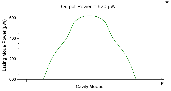

    However, since the laser used in these experimental setups are not single frequency, the PLD between Arm 1 and Arm 2 should be minimized for the initial setup. The effects of larger PFDs may be explored once "first signal" is achieved. Alternatively, a single mode laser can be built. Much more on all this below.

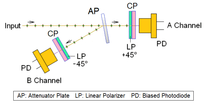

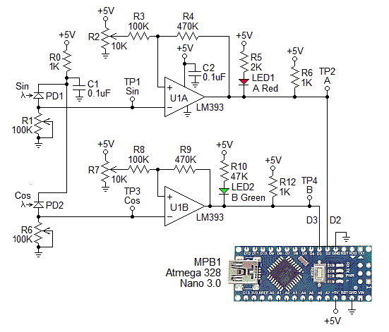

    Dual Channel Detectors
    These only use the custom detector. It would be silly, space consuming - and expensive - to require two DET110s! So, for two channels, all parts except for the power source and protection resistor are replicated:
           R-Protect    PD1      Yellow
       +-----/\/\----+--|<|---<<-----------------------+----------o Scope Channel 1
       |             |  PD2      Blue                  |
       |             +--|<|---<<---------------------------+------o Scope Channel 2
       |                                       R-Load1 \   \ R-Load2
       |                                DC Power       \   \
       |                          Red    +| |-   Black |   |
       +-----------------------<<---------||||---------+---+-------o Scope Ground
       |<--- SBB or QDx PCB --->|<----- Scope / Power Wiring ------>
    PD Pins: Facing Front of PD with Legs Down: Anode on left, Cathode on right.
    R-Protect: 250-1K ohms typical. R-Load: 10K-1M ohms typical.
    What is done with the light before it hits the photodiodes is the interesting part, which will be described where relevant. ;-)

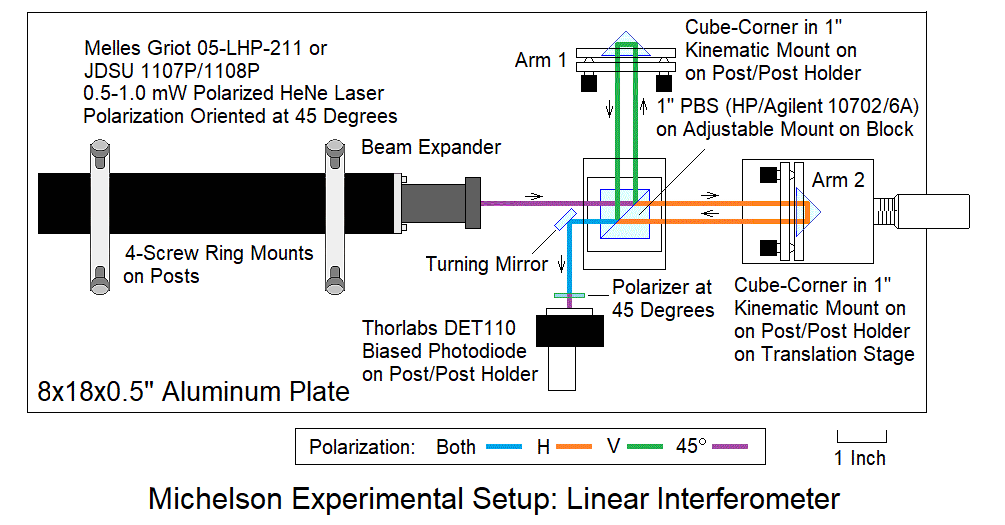

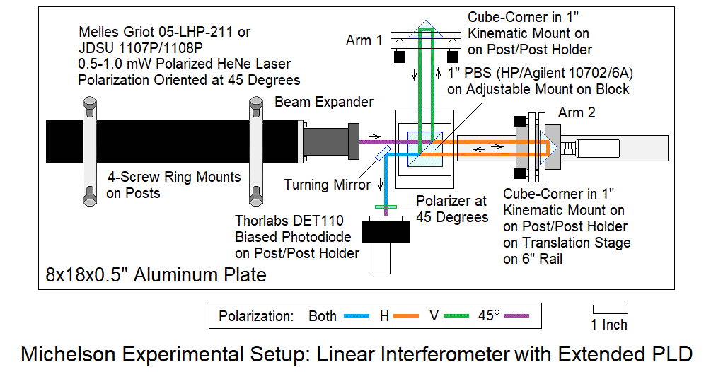

    Although HP called the combination of the PBSC and reference CC attached to it, the "Linear Interferometer", the term "LI" here will refer to the entire setup. And to enable the PLD to be set to zero, the CC normally attached directly to the PBSC will be mounted a few inches away.
    Linear Interferometer Setup

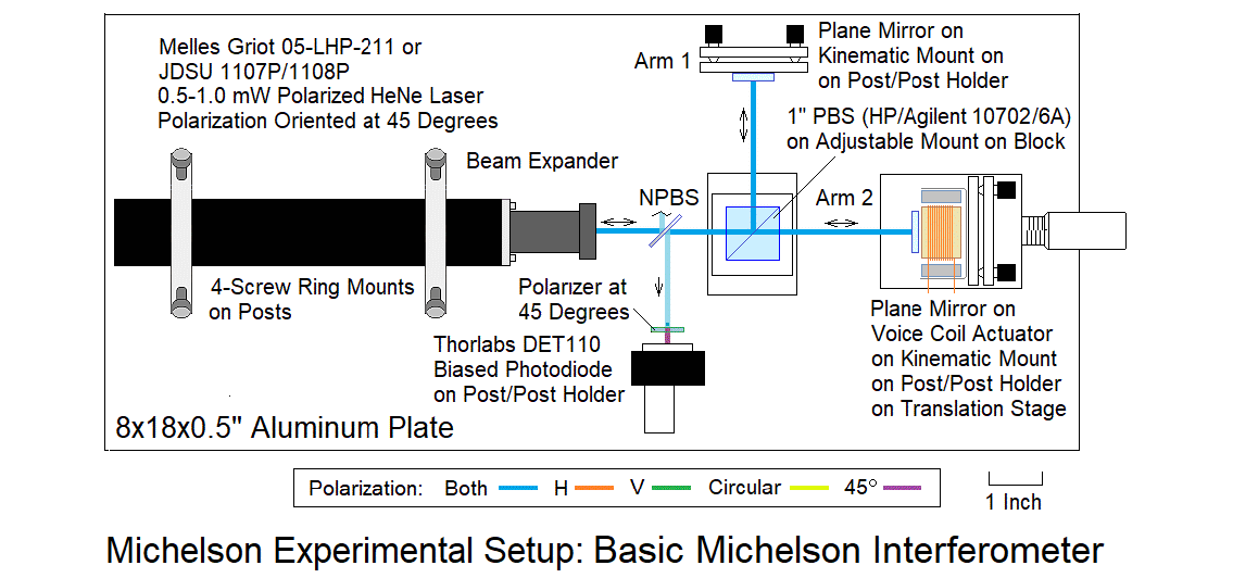

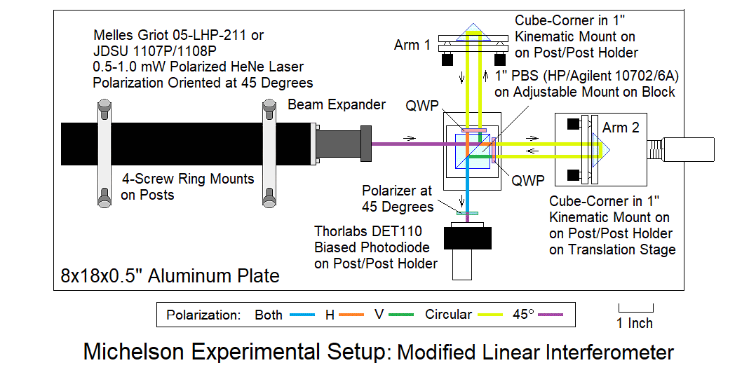

    The diagram below shows the general arrangement of the laser, beam splitter, cube corners, and detector used for all the interferometer configurations.
    The other configurations will have a few additional or substitute parts and small variations in the horizonatal position of the laser and placement of the detector but are otherwise similar. Therefore the LI setup will be described in more detail.

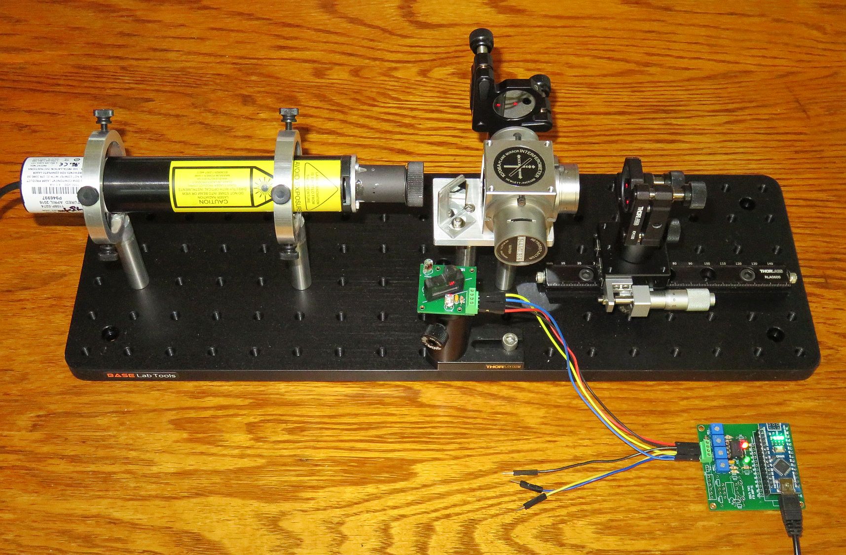

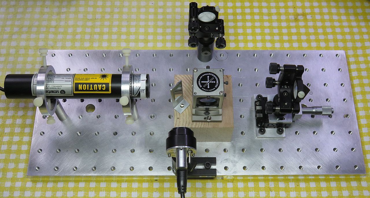

    The photo below shows the actual setup used for initial testing. There are minor variations in the actual kits depending on version and whether they are the "Basic" or "Deluxe" versions. These will be noted below. Where the total path length and PLD is small, no beam expander is needed for the laser, which may result in a larger signal since the entire beam hits the detector.
    MIPM Linear Interferometer Assembly with Thorlabs Detector

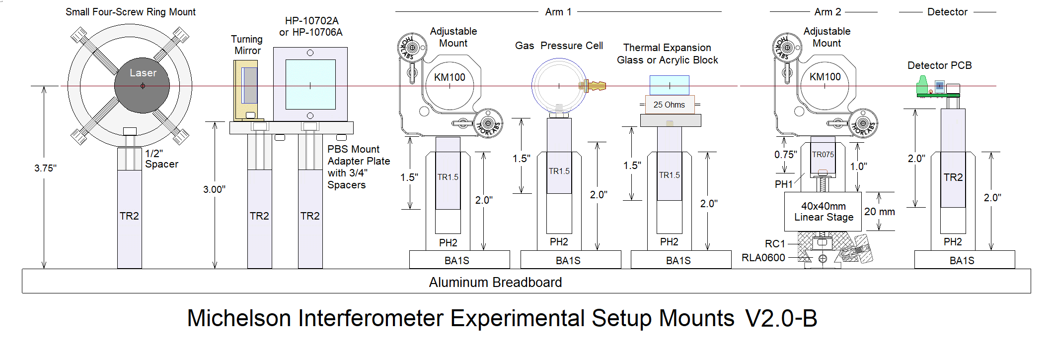

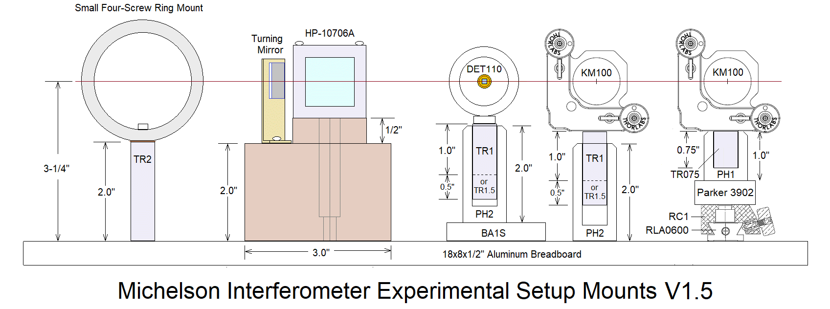

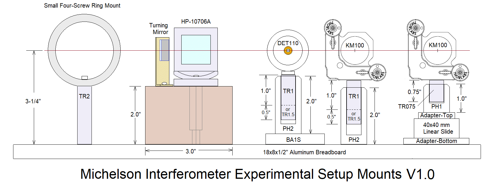

    Setting the Heights
    The following diagram shows the relationships of the various mounts for setting the heights during assembly. The specific heights used aren't critical but 3-1/4 inches places the laser in the center of the rings vertically:
    Original Version 1.0 (Left) and Version 1.5 using Block with Pedestal and Arm 2 on Rail (Right)
    Clicking on this diagram will open a high resolution version in the other window or tab. The heights of any retro-reflectors in the setup will be what really determines the beam height. For most configurations, the critical RR will be the one installed on the PBSC since its height is not adjustable. So everything will be aligned to that.

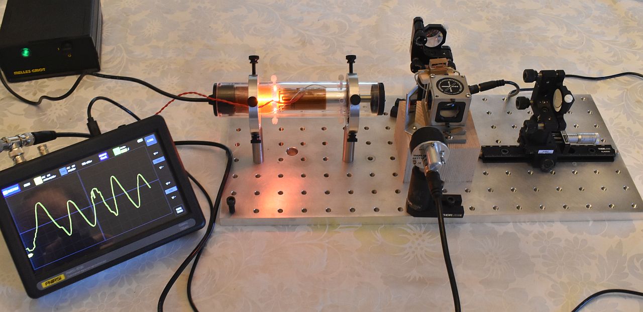

    Assembly and Alignment of the Linear Interferometer
    The following procedure may be used to install each of the parts and then get to the point of "first signal" using the oscilloscope. The procedure for the other interferometers will be virtually identical in most respects, but may be trickier depending on the type.
    It is assumed that nothing has been mounted, but depending on the previous use, some of these steps have already been completed.
    Parts attached with fasterners should be snug but don't overtighten.
    It is also assumed that the laser is linearly polarized. Slight changes are required if it is random polarized.
    There are minor differences in the assembly procedure depending on the version of the kit (V1.0 or V1.5); specifically the mounting of the PBS and whether Arm 2 uses a rail. These will be address below. The use of a detector other than the Thorlabs DET110 or equivalent will be dealt with separately. There will be a separate procedure for V2.0 (coming soon).

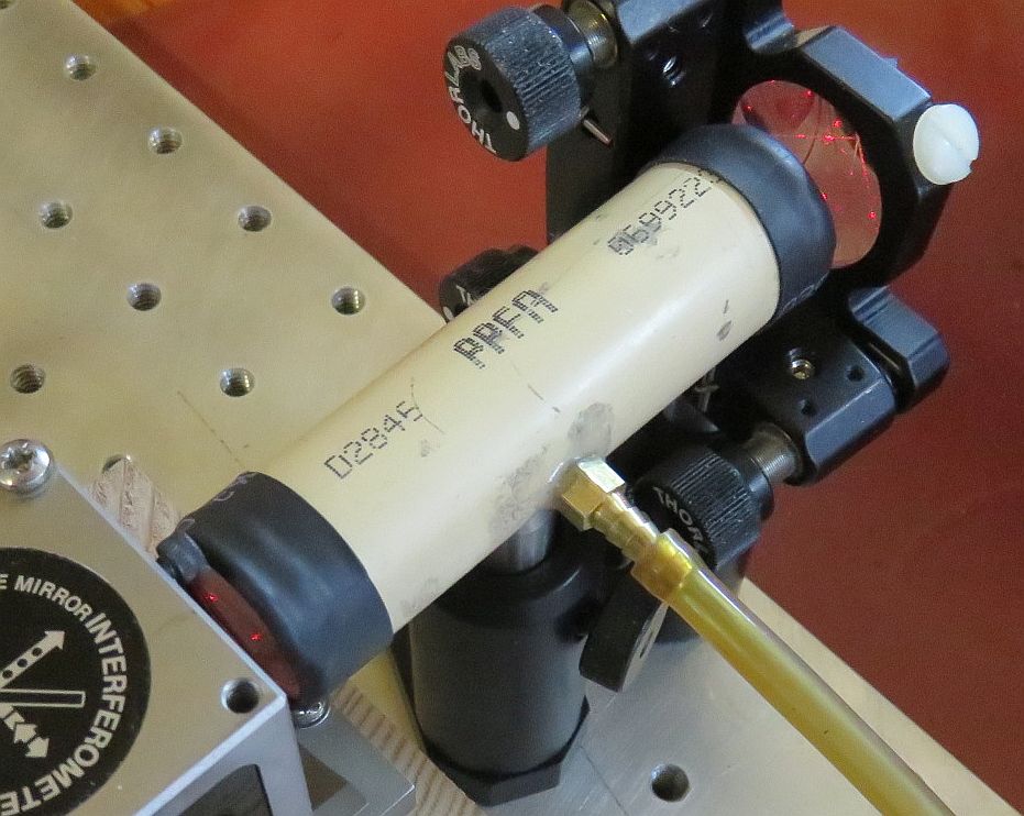

    1. Laser mount posts: Attach two 2 inch posts to the breadboard using 1/4-20 set screws.
      If the laser head has a beam expander, or it is anticipated that one will be added later, it is recommended that the posts be mounts 1 hole to the left of where the are in the photo.
      Note: To assure that there are ample threads engaged in both parts here and in subsequent steps with set-screws, the set-screw should be installed approximately half-way into the baseplate or mounting plate and then a thin tool or even the edge of a metal plate or stiff cardboard can be used to keep the set-screw from turning as the post or post holder is threaded onto it before tightening.
    2. Laser mount rings: Secure to the top of the posts with 8-32 cap head screws.

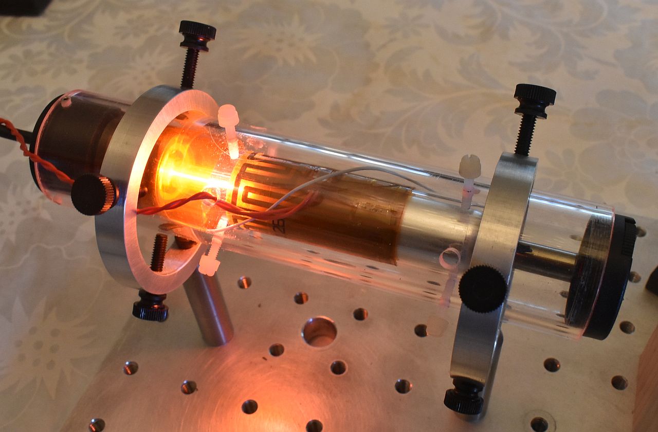

    3. Laser head: These steps secure and align the laser head cylinder.
      • Install the Nylon thumbscrews in the ring mounts if not already present. If there are two different lengths of thumbscrews (e.g., 1 and 1-1/4 inch), the longer ones should be in the front side of the rings.
      • Slip the laser head into the rings. Initially set it to approximately centered. Then shift it 1/4 inch toward the back of the baseplate.
      • Plug the big white male "Alden" connector of the laser head into the female Alden connector of the power supply. Make sure it is seated fully, usually against the shoulder with no part of the prongs sticking out.
        • If the power supply is "lab style" - a chessy plastic box with keylock switch and power indicator, then it plugs into the AC line. An IEC type line cord will be included if in the USA; you will have to provide the approriate like cord if elsewhere. If there is a voltage switch on the back of the supply, confirm that it is set corretly for your location. If set wrong, the power supply may be damaged.
        • If the power supply is a bare "brick", it requires 12, 15, or 24 VDC from a matching wall adapter that should be included. Confirm that the voltage ratings match. There may be more than one wall adapter in the kit that appears similar. Check the labels! Using the wrong one may damage the brick and/or wall adapter. The wiring is probably already done via a barrel to screw terminal adapter, but confirm that the wires are secure and attached to the correct terminals. Positive is red and negative is black. If there is a yellow wire, it should be attached to the black wire and thus negative as well.
      • Power up the laser by turning the keylock switch or plugging in the wall adapter. It may take a few seconds to light. DO NOT stare into the beam with your remaining good eye. :-)
      • Confirm that the laser is polarized: The model number should be 1107P, 1108P, or 05-LHP-211. There should be an alignment mark near the front of the laser. If not or just to confirm, rotate a LP or LP/CP in front of the laser. If the laser is polarized, there will be orientations where virtually no light gets through at all times. Add an alignment mark if there is none. (If it is random polarized, this orientation will swap by 90 degrees over a few seconds as the laser warms up. More on this below in the section on linear versus randon polarized lasers.) DO NOT assume the yellow arrow of the safety sticker (if present) identifies the polarization orientation. Check it!
      • Orient the laser head so the polarization axis is at +45 degrees (counterclockwise) from vertical when viewed from the front. What differences will there be if it is at -45 degrees?
      • Using the thumbscrews, adjust the position so that the beam is at a height of exactly 3-1/4 inches (centered vertically in the rings) and perfectly horizontal, and 1/4 inch toward the back of the setup. DO NOT overtighten the thumbscrews - just enough so the laser head won't rotate on its own.
        Doing this accurately is critical to the ease with which the subsequent alignnment can be performed since not all mounts have sufficient degrees of freedom to accomodate an arbitrary beam location and direction. Fabricating an "alignment plate" out of carboard may be useful. This would have a hole at the optimal height offest 1/4" toward one side from a mark at the bottom.
    4. V1.0 or V1.5 with wood block (plain or with pedestral): Secure the wood block using a 1 inch 1/4-20 cap-head screw. The location should have the laser beam passing over it 1/4 inch back of center with the wider part to the left. Carefully align it parallel to the X-Y axis before tighening the screw. It won't be accessible once the PBSC is installed.

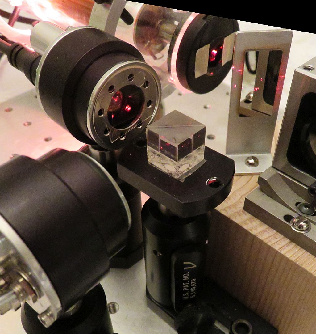

    5. One inch Polarizing Beam Splitter Cube (PBSC) in stainless steel frame: This will probably be labeled 10702A or 10706A.
      • Remove any optics that may be attached to the PBSC. They will not be required for the LI. Store them wrapped in soft paper towels, bubble wrap, etc., to protect the optical surfaces.
      • There are two variations on the PBSC mounting depending on the design of the wood block:
        1. V1.0 with simple rectangular block: The PBSC may be attached to an HP 10711A mount or a 1/2" adapter plate. If not, locate the 10711A or adapter plate and secure the PBSC to it with four 4-40 1-3/4" caphead screws so the side with the beam path diagram is visible and the "In" arrow points to the right facing the long dimension of the mount.
          Attach the mounted PBSC to the wood block using two 3/4" wood screws. Center them in the slots with the PBSC aligned with the X-Y axes. The diagonal of the PBSC should be facing front-left to back-right with the "In" arrow pointing left-to-right. If it cannot be mounted this way, rotate the PBSC 90 degrees on its mount.
        2. V1.5 with wood block with pedestal: The PBSC should be attached with four #4 2 inch wood screws. The diagonal of the PBSC should be facing front-left to back-right with the "In" arrow pointing left-to-right.
      • The laser beam should pass through the PBSC centered vertically and 1/4 inch toward the back. It should be at the same location relative to the breadboard at the far end. If not, fine tune alignment. :) Getting this dialed in will greatly simplifiy alignment later.
      • Turning mirror: Use tape or a *tiny* bit of adhesive to attach the turning mirror to the right angle "Turning Mirror Bracket" centered vertically with respect to the PBSC and flush with the right edge. Attach the bracket to the Wood Block with a single 3/4 inch #5 wood screw in the pilot hole already drilled. If the bracket has an elongated hole, center the screw for now.
    6. Arm 1: These steps assemble the components of Arm 1.
      • Attach a 2 inch post holder to the baseplate using a 1/4-20 set-screw.
      • KM100 or similar mirror mount: Secure to a 2 inch post with an 8-32 3/8 inch cap-head screw. Slip the post into the Arm 1 post holder and hand tighten the its thumbscrew. Adjust the two alignment knobs so that the mounting plate is parallel to the base in both directions. If the adjustments are too tight, check that any locking screws are not tightened. Else, total removal, cleaning, and lubricating with a tiny amount of light grease or machine oil will be required.
      • Cube Corner (CC) trihedral prism: Install a CC in the KM100 with its apex facing out and oriented so that a flat is at the top or bottom. It should be secured with either a soft-tipped set-screw or Nylon wide-head screw. DO NOT overtighten - it should be snug enough not to fall out (these are fragile!) but not so tight as to smash the CC! Note that the CCs mount backwards from what might be expected so that their edge can be secured securely. :) They thus face through the mount.
      • Adjust the height and orientation of the adjustable mount so that the return beam hits the PBSC at the same height as the incident beam, and offset approximately 1/4 inch to the left of center. The spacing between the centers of the two beams should then be approximately 1/2 inch.
      • Place a piece of paper where the detector would be for the beam from the turning mirror. Adjust the orientation and height of the mirror mount so there is a bright return beam there from Arm 1.
    7. Arm 2: These steps assemble the components of Arm 2.

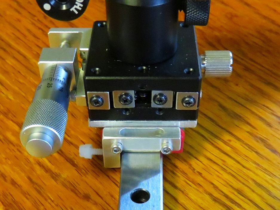

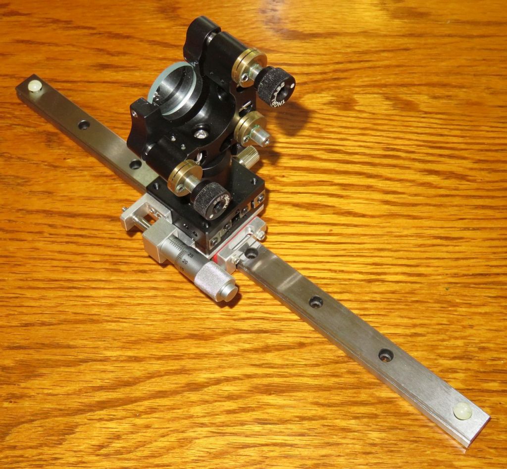

      The first part of the procedure differs slightly for the original version with the linear stage and adapter plates, and the upgraded version with the six inch Thorlabe rail:
      Orignal version with linear stage and adapter plates:
      • Attach a 1 inch post holder to the linear stage top adapter plate using a short 1/4-20 set-screw. The set-screw must not protrude through the plate.
      • Attach the plate with post holder to the linear stage via the slots with two M3x8mm cap head screws.
      • Attach the linear stage to the bottom adapter plate using four 4-40 1/4 inch screws. It will be necessary to push or adjust the moving part of the linear stage to access the corner holes.
      • Secure the bottom adapter plate to the baseplate, lining it up with a set of holes such that the PLD between the CCs in the two arms can be adjusted to be zero using the micrometer. Two 1/2 inch 1/4-20 cap-screws are required at diagonal corners, four may be used if desired.
      • Adjust the micrometer so the distance to the center of the PBS cube is the same ±0.1 inch (2.5 mm) for Arms 1 and 2 for a PLD near 0.

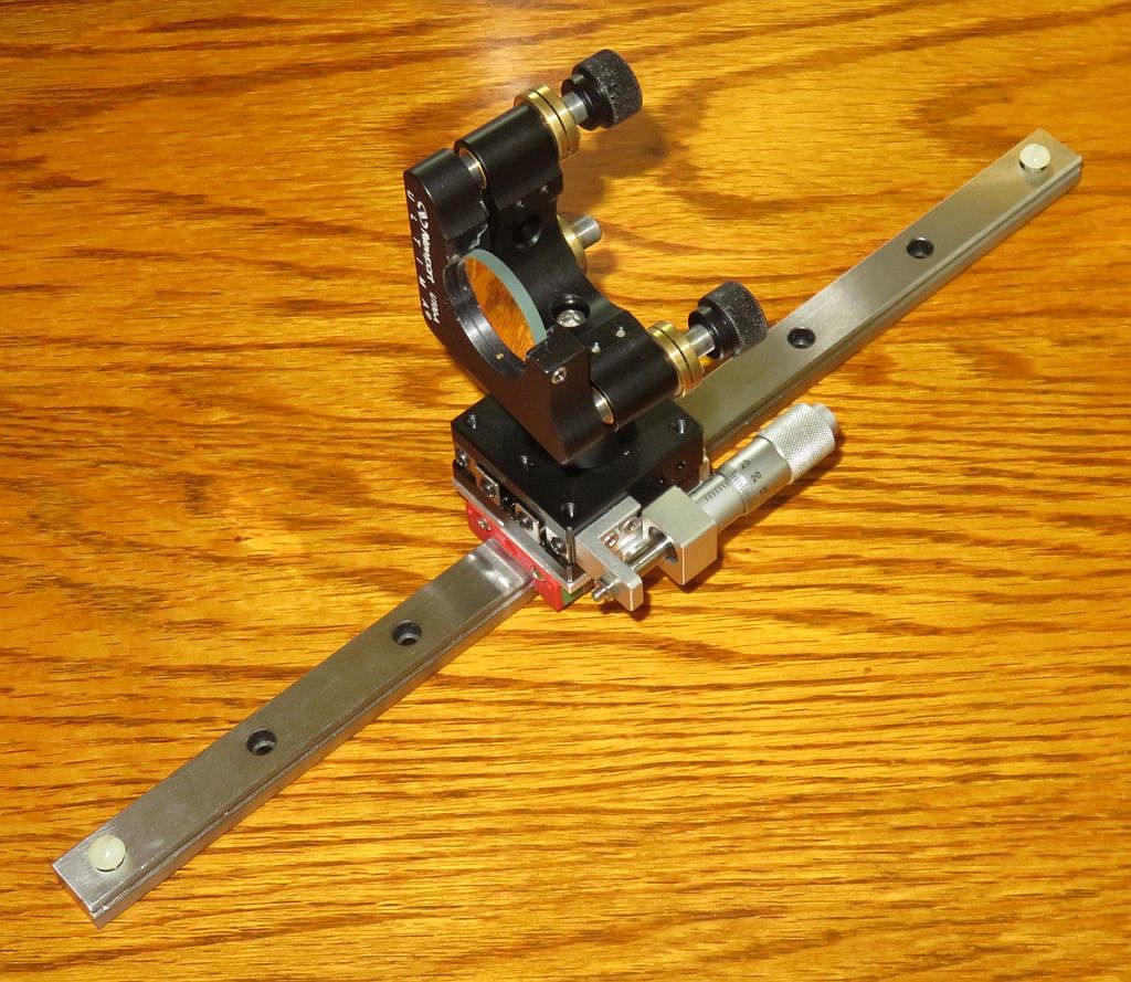

      Version with rail:
      • Attach a 1 inch post holder to the Parker linear stage with a 4-40 3/8" flat head or Philips head screw through the hole in the bottom of the post holder. The heads of either type screw should be large enough not to pass through the 1/4-20 hole in the post holder. If it does, a washer will need to be added.
        CAUTION: Make sure the tip of the screw does NOT contact the fixed part of the linear stage. If it does, an addition washer may need to be added. Or the screw can be shortened slightly with a metal file or grinding wheel.
      • Attach the Parker linear stage to the Thorlabs RC1 rail carrier with a 4-40 3/8" or 1/2" cap head screw slipped through the base of the linear stage secured with a large #4 washer or standard #5 or #6 washer and nut.
      • Add stops at both ends using a 8-32 3/8" cap head screw and #10 washer positioned as high as possible.
      • Secure the rail to the baseplate / breadboard with 1/4x20 3/8" cap head screws in the end holes.
      • Install the RC1 carrier with Parker stage and post holder onto the rail.
      • Adjust the micrometer so the stage is approximately in the center of its travel range.
      • Position the RC1 carrier so the distance to the center of the PBS cube is the same ±0.1 inch (~±2.5 mm) for Arms 1 and 2 for a PLD near 0.
      • After confirming that the post holder and RC1 fit the stage without issues, a *small* amount of 5 minute Epoxy may be added between them to reduce the chance them loosening while adjusting the alignment.

      • As a quick test, place a linear polarizer (LP or LP/CP with the non-adhesive facing the beam) with the polarization axis at 45 degrees in the combined return beam. If the alignment is close, very slight rotation of the linear stage micrometer should result in the intensity varying dramatically. Further fine tuning of the alignment may be required to maximize the variation and uniformaty of the fring pattern. The optimal alignment will be where it goes almost totally dark to light. Of course, much more more can be done using these simple observations including effects of alignment, expansion using a lens, display using a Webcam, etc.
    8. Set up the oscilloscope: (If using a USB scope, this assumes that the required software and device drivers have already been installed on your PC or MAC.) For input, use one of the scope probes on the 1X setting (there is a slide switch on its body).
    9. Single Channel Detector: These steps assemble the components of the fringe detector using the Thorlabs DET110 or home-built equivalent.
      • Attach a BA1S Holddown to a 2 inch post holder with a 1/4-20 3/8 inch cap-head screw.
      • Install a 2 inch post into the post holder with the small (8-32) tapped hole at the top with the lock screw just snug.
      • Clamp the assembly down loosely with a 1/4-20 1/2 inch cap head screw.
        • Thorlabs DET110 (or equivalent) detector: Attach a BNC cable to the DET110 and the other end with BNC "T" and screw terminal adapter to Channel 1 of the scope. Jumper wires may be convenient between the scope probe and screw terminals.
        • Custom detector: Install a photodiode, 1K ohm resistor, and male-male jumper wires to the solderless breadboard based on the circuit in the section: Single Channel Detectors.
      • install a 10K ohm resistor for R-Load. 10K is probably an acceptable value but depending on laser power and alignment, a higher (most likely) or lower resistance may be desirable.
      • Tape or place a piece of LP or LP/CP to the front of the sensor with its polarizaiton axis at 45 degrees (edges at 0/90 degrees). If using the CP, remove the protective film from both sides and the sticky side can be stuck directly to the DET100 or PD.
      • Flip the toggle switch on the DET110 to On (up) or apply power to the home-built detector.
    10. Adjust the position of the detector so that the combined return beams are centered on the active area of the sensor.
    11. If alignment is close, the amplitude of the signal on the scope should vary dramatically as the micrometer is rotated by the smallest amount. The wavelengths of light are TINY! Each full cycle is 1/2 wavelength or around 316.5 nm. The micrometer moves the stage by 0.5 mm per full rotation, or around 1,389 nm/degree.
    12. The amplitude can be maximized using the knobs on the KM100s or other adjustable mounts. The signal amplitude may vary slightly (up to ~20 percent) in a periodic cycle over a time scale of seconds to minutes in addition to it probably increasing slightly as the laser warms up. The time scale will depend on how long the HeNe has been on. Why? There can be several causes.
      And for those new to interferometers, the optimal alignment will also be where the signal instability is maximized. ;-) Almost ANYTHING will affect it from touching the apparatus or table on which it is on, to just walking across the floor. The wavelength of light is really really small. ;-) To put this in some perspective, a full cycle of the signal with the Linear Interfemeter is a change in PLD of 316.4 µm (1/2 wavelength of 632.8 nm or 1/3,160th of a mm). That's about 1/158th the diameter of an average human hair (~50 µm) or 1/22th the diameter of a human red blood cell (7 µm). Street traffic will be detectable, as will drafts from the A/C, changes in temperature, and siesmic events. Some of these effects can be further explored using parts in these kits.
    13. Now you're set to explore all sorts of exciting aspects of interferometry. ;-)

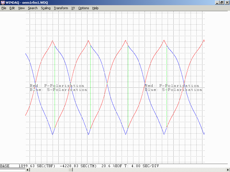

    Observing the Effects of PLD on Fringe Contrast

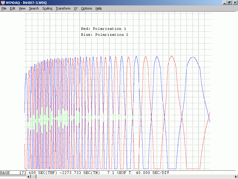

    The tests above were done with the PLD near 0. What happens otherwise? If the laser were Single Longidudinal Mode (SLM), the PLD would not matter up to a very large number in the 100s of meters or more. However, the laser used in the has 1 or 2 modes depending on its cavity length, which changes due to thermal expansion during warmup as the modes sweep through the neon gain curve. (There is much more on this in the section: Linear polarized versus random polarized laser.)
    For the first of the following tests, the laser must be linearly polarized with its polarization axis (indicated by the alignment line near the front) oriented at 45 degrees. If your laser is random polarized, it should be oriented so the two outer lines near the front are aligned horizontally and vertically. A CP should be mounted in the beam with its LP side facing the laser and its polarization axis at 45 degrees. If the CP is stuck to a microscope cover slip, this means the LP (shiny) side of the sandwich is facing the laser and the cover slip is out. *Gently* tape it in place, cover slips are fragile.
    For all these tests, it will be better to shut off the laser for a few minutes before starting. Then when it is turned on, the mode sweep due to cavity expansion will be fastest.
    1. Check behavior with the PLD set as close to 0 as possible by measurements of the distance from the PBSC to the CCs in each arm. ±1 mm will be acceptable. Monitor the behavior of the detected signal over time by twiddling the micrometer periodically over a few minutes. Note any significant change in signal amplitude. A change of 10 or 15 percent can be attributable to the normal variation in total power during mode sweep and warmup, but anything more will be due to the interferometer.
    The cavity length of the laser tube is around 137.6 mm or 5.417 inches. One half of this is 68.8 mm or 2.7085 inches.
    1. Change the location of the mirror in Arm 2 so the PLD is within ±1 mm of one half the cavity length by relocating the stage and/or adjusting its position using the micrometer. Now observe the fringe signal again and describe what you see over the course of a few minutes. (Turn off the laser again and allow it to cool for a few minutes as above.)
    2. Try intermediate locations for the Arm 2 mirror.
    3. If the Arm 1 adjustable mount is positioned as close as possible to the PBS cube (using a BA1S holddown instead of direct attechment to the breadboard if necessary) it will be possible to achieve a PLD of at least the tube cavity length. See how the signal amplitude there compares with the one with a PLD of 0. If it's noticeably lower, why might that be? There are several factors involved.
    Now explain the behevior in each case. And what is special about a PLD of zero and one half the cavity length?
    If your laser is random polarized, it is possible to perform the following additional tests with the CP removed from the front of the laser:
    1. Repeat the above tests with the laser oriented so the outer lines are aligned with the horizontal and vertical axes.
    2. Repeat with the lines on the laser oriented at ±45 degrees.
    Explain your results with respect to the longitudinal mode behavior.
    What would happen if the PLD could be extended to more than the cavity length of the laser?
    All of these tests can also be done with the other interferometer configurations. Predict how the results would change, if at all.

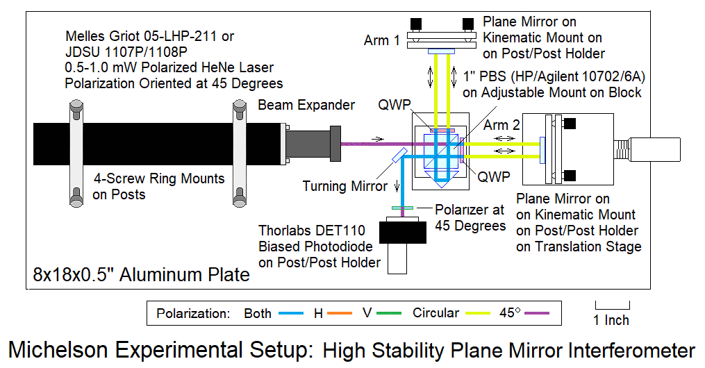

    The basic Plane Mirror Interferometer (PMI) as its name implies uses a plane mirror instead of a cube corner for the remote reflector. It has a double pass architecture which halves the distance for a full fringe cycle at the detector for a movement of the reflector in Arm 2 (called the "measurement arm"). However, it is not desirable to use a PMI here because it is double-pass only for Arm 2 but single pass for Arm 1. Thus while the PLD can be set to zero, the spacings or lengths of the two arms (as well as the change in displacement) are not the same, which at the very least is confusing. (More on this in the section on the PMI.)
    Normally, the Arm 1 mirror would be mounted along with the QWP on the PBSC as the reference since absolute PLD doesn't matter with the single frequency or two frequency lasers used in metrology applications. But as with the LI, we need the PLD to be close to zero or ohter specific value for experiments using a multi-longitudinal mode laser. (The "other specific value" would normally be a small integer multiple of the laser's internal cavity length. Why?)
    High Stability Plane Mirror Interferometer Setup
    Assuming the LI was already built, not many changes/additions are required:
    1. Install the HP retro-reflector (10703A) on the PBSC face closest to the detector. The orientation should be such that the beam doesn't hit an apex. This usually means the serial number (if present) runs up and down.
    2. Install QWPs (HPO 10722A or unmarked) on the faces toward the Arms. Their orientation does not matter as long as the screw slots are used.
    3. Replace the unmounted cube corner retro-reflectors with circular 1" planar mirrors. The mirror mounts can be rotated 180 degrees to make them easier to adjust.

    Gas Cell Compensator
    This may be the niftiest experiment and demonstrates the sensitivity of the interferometer to changes in the index of refraction of air.
    It may be done using any of the interferometer configurations, though the sensitivity will depend on which one is used.
    The concept is that an increase in air pressure will change its index of refraction, and while this is totally invisible to the human eye, the interferometer should be able to easily detect it as a shift in the fringe signal. In fact many fringe cycles even for a space of a couple inches. With some simple calculations, it is possible to corelate the pressure reading on the gauge with the phase change of the fringe signal. If it's sealed well enough, even warming the gas cell by holding it tightly should result in a detectable fringe shift. However, doing that without introducing vibrations that totally swamp any change due to the expansion would be a challenge.
    The Gas Cell Compensator (GCC) consists of a ~2 inch length of 1" inch OD Acrylic tube, a pair of planar windows sealed to the ends, the pressure bulb and gauge for a blood pressure cuff (sphygmomanometer), and some simple plumbing. It can mount on a Thorlabs post and post holder using a BA1S hold-down.
    GCC Assembly:
    The Acrylic tube will already be cut to length and drilled and tapped for the 10/32 hose barb and 8-32 set-screw to attach it to a Thorlabs post. The ends will have been ground to be close enough for government work. :) They don't need to be perfectly perpendicular to the tube or parallel to each-other. Nor do they need be polished - the rough cut surface is better for gluing. Only that they can seal to the windows.
    The windows are 1-1/8 inch in diameter and made of either glass or Acrylic. The Acrylic will have paper protective brown paper on both sides.
    1. If there is more than one hose barb with threads, one of them may have the threads shortened so as not to protrude inside the Acrylic cylinder. Partially thread it into its 10-32 hole. Mix the tiniest amount of 5 minute Epoxy and apply it to the exposed threads. Then rotate it clockwise until fully seated. Wipe off any excess Epoxy and allow time to cure.
    2. Apply a small amount of the remaining Epoxy to the threads of a 8-32 1/2" set-screw. Intstall it in the 8-32 tapped hole so that no more 3/8" is exposed. Apply some more Epoxy at the threads where they meet the tube. (Since this one is vertical and can't interfere with the beams, some portion of it protruding inside the Acrylic tube is OK. Add an 8-32 nut as shown in the diagram for added strength with the Epoxy joining the nut to the cylinder.
    3. Clean one window end one end of the 2" tube with alcohol if available. Soap and water is also acceptable. DO NOT use anything stronger. Make sure it is completely dry and dust-free by shining a bright light through it before proceeding. Repeat as needed.
    4. Carefully place the tube on top of the cleaned window. Put a weight on top of it or use some other means to prevent it from moving accidentally.
    5. Prepare a small amount of 5 minute Epoxy and apply the tiniest bead all around the outside of the joint between the 2" tube and window.
      Avoid getting any Epoxy inside the tube, especially on the windows, as much of their area may need to be unobstructed depending on the type of interferometer and/or whether the laser has a beam expander.
      If it gets messed up before curing, the Epoxy can be careully wiped off and then the glass and/or Acrylic can be cleaned with alcohol (but nothing stronger!). After curing, a single edge razor blade can be used to remove Epoxy, then cleaned with alcohol. Take care to avoid scratching the window(s).
    6. Repeat the previous three steps for the other end. A cotton swab can still be used to clean the previously attached window if necessary. It's especially important that the inner surfaces of both windows be clean as they will be inaccessible once the second window is installed.
    7. Wait an hour or so before proceeding to allow the Epoxy to fully cure.
    8. Connect the hose barb on the tube with the pressure gauge and bulb using the rubber tubing. Test to confirm the connections are reasonably gas-tight and correct if necessary. For this experiment, a small leak may be preferred as it will allow for a controlled pressure decline which can be used to correlate with the fringe signal.
    The photo on the left shows the prototype using a 3/4" OD PVC tube installed in Arm 1 of the interferometer. The ends are covered with pieces of heat shrink to hide the ugly cut microscope slide windows. Yours will be (1) shorter, (2) made of 1" OD clear Acrylic (Plexiglas) instead of PVC, (3) use circular windows, and (4) hopefully nicer looking when completed. ;-)
    The photo on the right shows the complete setup (with the extended PLD rail option) and a scope trace with showing the GCC loosing presure some of its pressure over 20 seconds or so.
    Closeup of GCC Assembly using a Piece of PVC Pipe (left), Overall Setup Showing the Fringe Signal as the Pressure Declines
    Note: If doing this using one of the plane mirror interferometers, the Arm 1 mirror mount may need to face away from the PBSC (with the mirror installed backwards) as with the CCs in the LI to provide enough clearance for the GCC. Then adjust the Arm 2 mirror position so the PLD is 0.
    The blood pressure gauge reads up to 300 mm/Hg (almost 6 psi), but there should be no need to go anywhere near the extreme hypertension region for these tests! :) 100 mm/Hg will be more than enough.
    The gas cell can be mounted in either arm of the interferometer, though using Arm 1 is probably better as it has nothing else. It can be positioned so that either one or both beams (where present) pass through it. (How will this change the calculations?) Avoid aligning the gas cell so that the windows are perfectly perpendicular to the beam paths - angle it slightly so the reflections from the surfaces of the windows do not coincide with the main beams.
    The Arm 1 and Arm 2 path lengths should be set as close to equal as possible for these experiments taking into consideration the increase in optical path length due to the 1 mm glass microscope slide windows. How much does this affect the total path length?
    Fine tune the alignment of the interferometer to maximize signal amplitude. Close the bleeder valve and slowly pump up the bulb while watching the scope display and pressure gauge. The index of refraction, n, will be approximately equal to 1 + P * k. By measuring the number of cycles and partial cycles as the pressure is changed, it is possible to calculate k. Check it against a value found in a search. Why might it not be the same? Knowing k, an arbitrary pressure can be measured with the interferometer.
    Based on the NIST Refractive Index of Air Calculator using Ciddor Equation, the index of refraction of air at 1 atm (760 mm/Hg), 20°C, and 50%RH, is 1.000271372. As an example, at a pressure above 1 atm of 100 mm/Hg, it is 1.00030715. What is the value of "k"? Over the 3 inches (76.2 mm) inside the GCC, the change in path length is approximately 2.73 µm or 4.31 full wavelengths at 633 nm. You can complete the calculations. ;-) Perform the test with 100 mm/Hg and your favorite interferometer configuration. Explain your results. What are the possible sources of error? Hint: What effect will reflections from the parallel surfaces of the windows have on transmission?

    If you have successfully constructed any of the interferometers, it will have been obvious that avoiding generating a varying fringe signal due to vibrations is a challenge even if the entire setup is on a stone countertop. :) But what about actually enhancing this effect? The mirror on the loudspeaker does that to some extent. However, by mounting one of the reflectors (cube corner or mirror) remotely, it will be possible to easily detect someone walking across the room or a truck going down the street a block away. Or an earthquake.
    For these experiments where one of the arms is of considerable length, the beam expander will need to be mounted on the laser. Without it, the beam would expand too much to be useful. Also, for the unstabilized HeNe laser, rather than making the PLD zero, it will need to be a multiple of the laser tube cavity length, around 137.6 mm or 5.417 inches for the JDSU 1107/P or 1108/P. But don't get carried away putting the reflector 25 meters away. Remote alignment will be a large challenge at the very least. And with every additional increment of the tube cavity length, the signal will degrade. (Measuring this may in itself be an interesting exercise.) Start with perhaps 0.5 meter plus or minus whatever is needed for the PLD to be 0 mod(137.6 mm). The optimal distance may best be found by maximizing the fringe amplitude.
    The remote reflector should preferably be mounted on a separate structure, not the same table as the rest of the setup. Another table or wall, for example. Or even suspended by springs or wires. Either arm can be extended but using Arm 2 with the linear stage may be simpler for mounting to a slab of wood or aluminum.

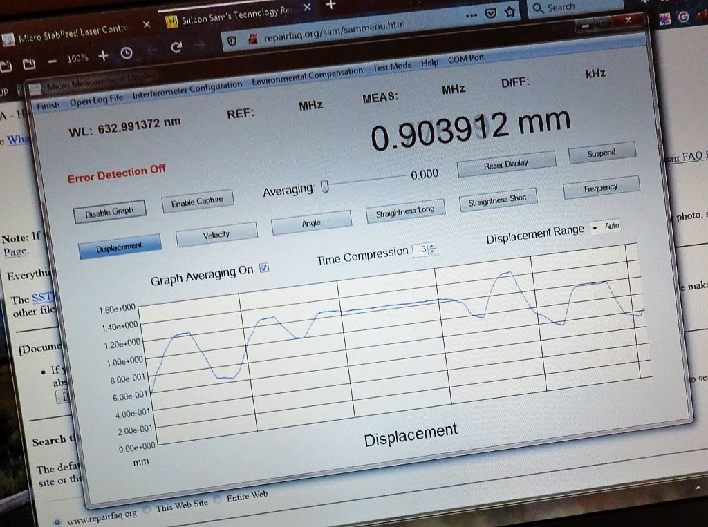

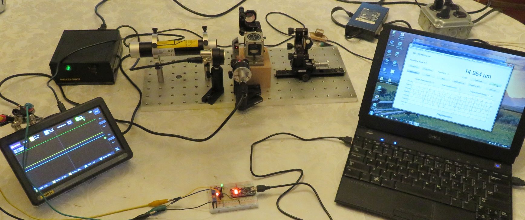

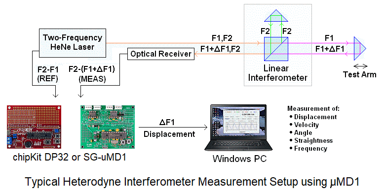

    A displacement measuring system would be ideal. Using µMD0, it would be possible to record data and (with some simple formatting in Excel) then display it like a seismograph. But just watching the fringe signal on the scope should provide some valuable insight into what's going on. Not only vibrations, but temperature changes and even air convection should be detectable.
    Variations on the basic interferometers can be used to sense tilt (angle), lateral movement (straightness), deviation from right angle (squareness), and others. See Optics for Interferometers Using Two-Frequency Lasers. The same optics can be used with single frequency lasers.

    Other Interferometer Configurations
    There are some other variations on the Michelson interferometer that may be put together using parts in this kit, starting with the original form of the Michelson Interferometer.
    Original Michelson Interferometer (BMI)
    This is identical to the original except that it uses the polarized laser and PBS cube as the beam-splitter. But note that the PBS passes and reflects the X (parallel to the baseplate) and Y (orthogonal to the baseplate) polarized components and they retrace their steps on the return journey. Thus a Non-Polarizing Beam-Splitter (NPBS) must be inserted to pick off both of them before passing through the linear polarizer at 45 degrees to combine them for the detector. The NPBS can be the variable Attenuator Plate (AP) that is part of the quadrature decoder, but mounting it and determination of the optimal attenuation is left as an exercise for the student.

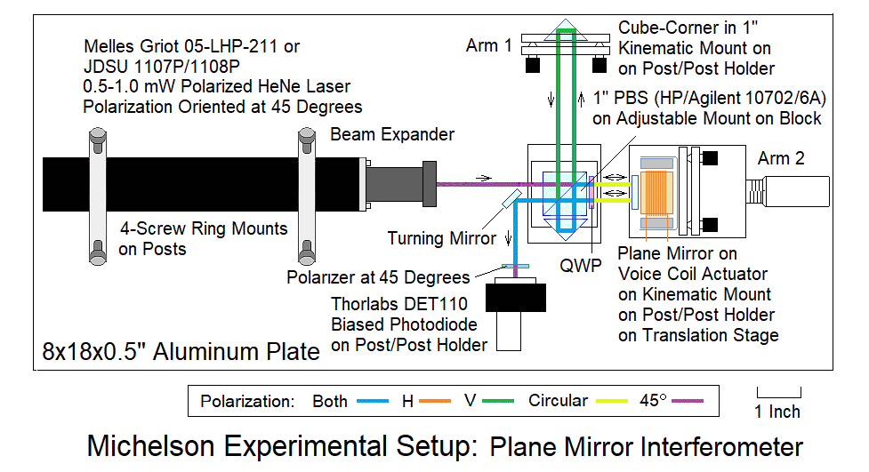

    The PMI is probably the most common of the interferometers that use a planar mirror.

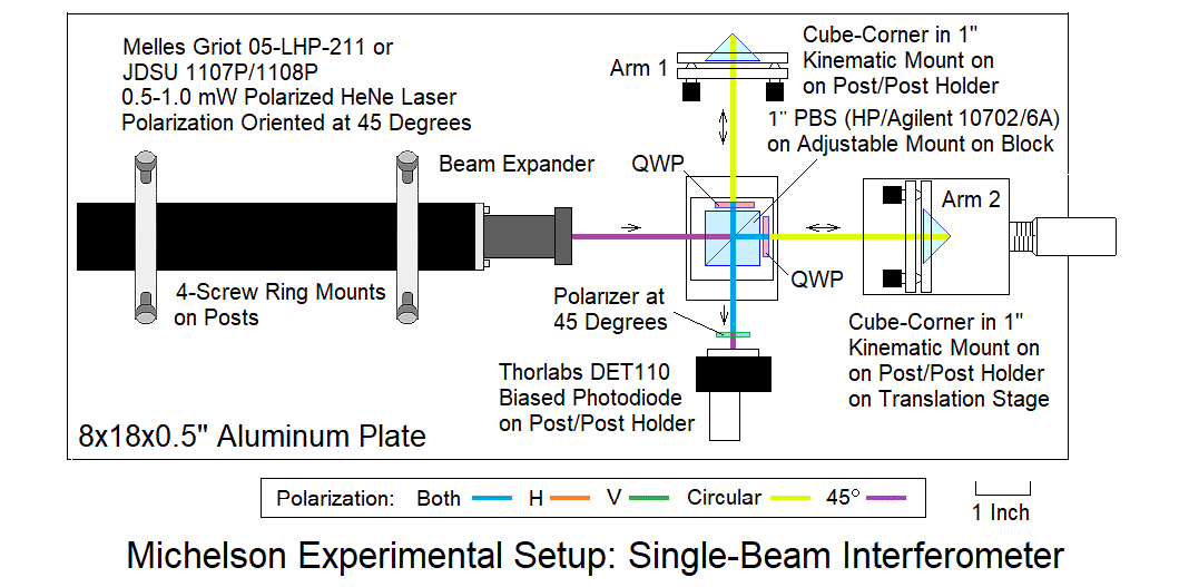

    Single Beam Interferometer (SBI)
    Modified Linear Interferometer (MLI)
    The MLI adds a pair of QWPs to direct the beam to the detector out the side of the PBSC and is achitecturally similar to the SBI but with offset beam paths that have two additional advantages: (1) retro-reflections back to the laser are reduced further and (2) the beams don't hit the apex or edges of the cube corner trihedral prisms. However, only under very specific cercumstances would the additional cost of the QWPs likely be justified.
    Double Pass Linear Interferometer (DPLI)
    The remote reflector is a cube corner which is better for long distances yet it has double the resolution of the normal LI, the same as the PMI.

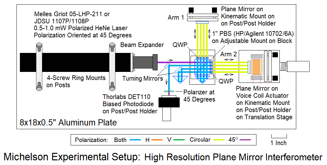

    High Resolution Plane Mirror Interferometer (HRPMI)
    This doubles the resolution over the PMI or HSPMI. The HRPMI is also high stability because the two beam paths have the same length through the optics, and a PLD of 0 if the distance in Arm 1 and Arm 2 are the matched. This will be much more complext to align and may require additional parts and determination. ;-)
    The HRPMI is essentially an HSPMI in which instead of the return beam going to the detector, it is reflected back into the interferometer, but offset in position by an additional cube corner, so it traverses all of the optics a second time. So instead of 2 passes, it becomes 4 passes. In principle, this could be extended to 6 or more passes using a similar approach, but as you will undoubtedly see if you're crazy enough to attempt to implement the HRPMI, that will be tough enough to align.
    The HRPMI setup requires some additional optics (another turning mirror and adjustable mount for an unmounted cube corner). The only way to really test it without a measurement display would be with one of the methods of fine tuning path length - loudspeaker, PZT, air pressure, tmperature, etc. The micrometer stage will simply not have fine enough control to reliably detect a difference between X1 or X4. Thus the setup is shown with the loudspeaker.

    Dual Polarization Detector using LPs at ±45 Degrees
    This uses the same CP as the quad decoder but for these experiments, the QWP portion is totally irrelevant and the QWP (sticky) side goes toward the photodiodes for both.
    It should be pretty obvious what is going to happen, but seeing it is not quite the same as theory. ;-)

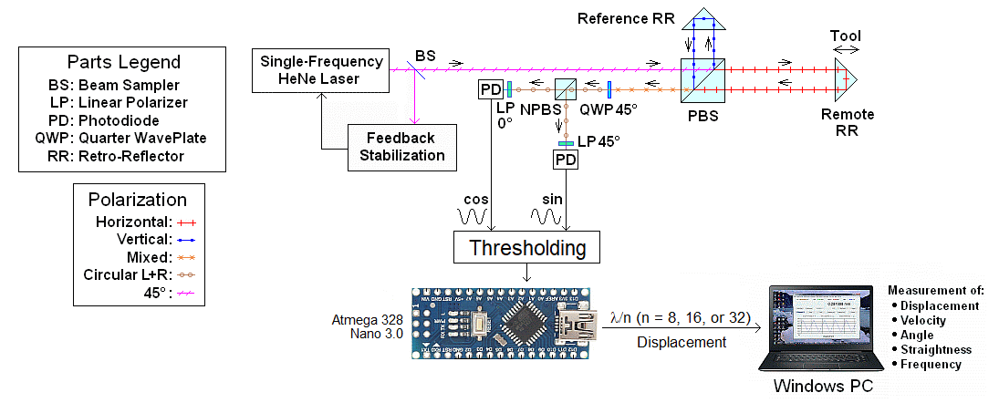

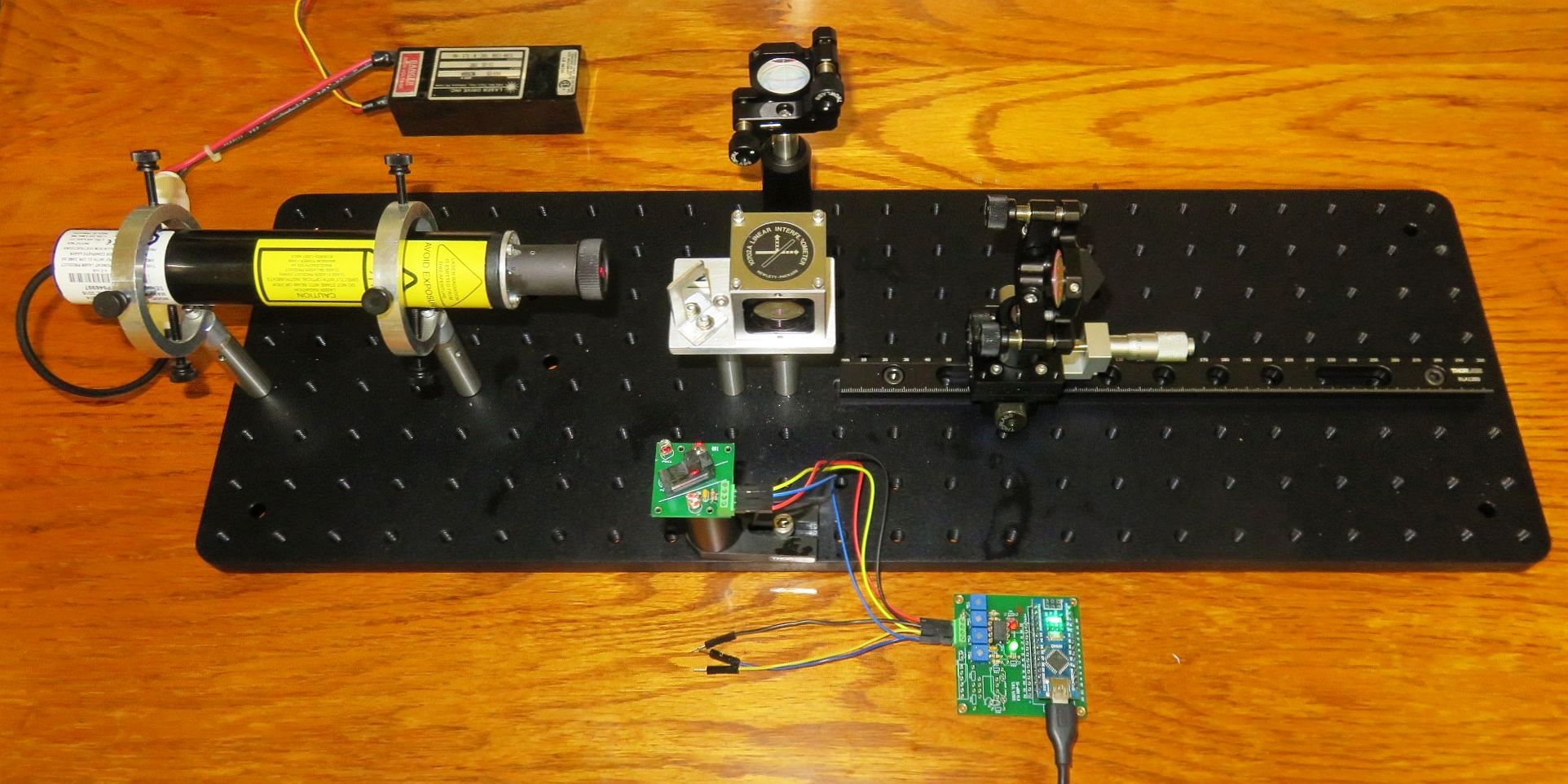

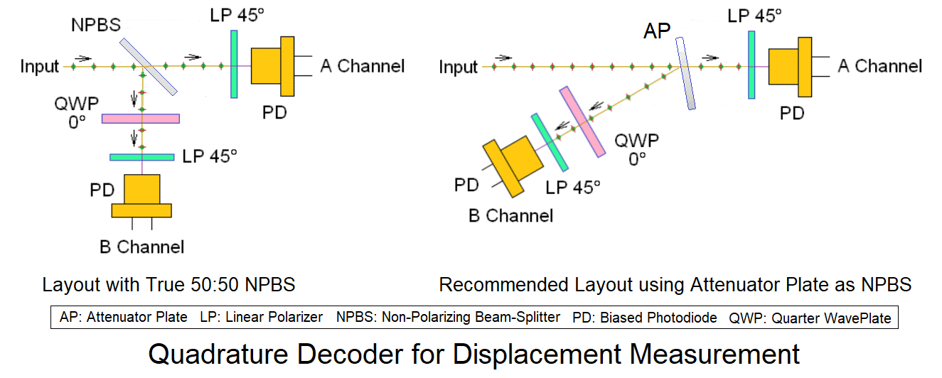

    Quadrature Detector

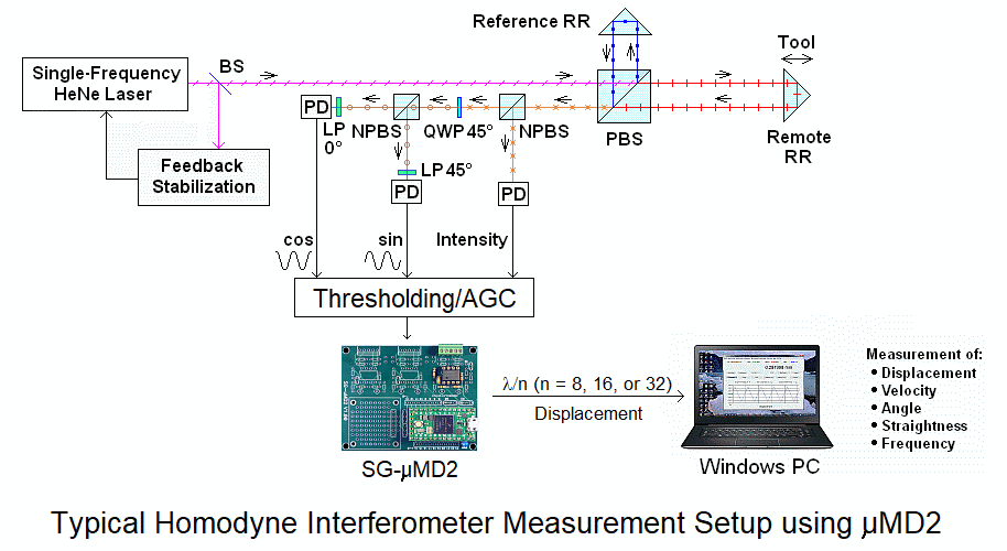

    The basic detector using a single photodiode like the DET110 can generate a signal corresponding to light and dark fringes, but cannot provide direction information, essential for using an interferometer in metrology applications. The Quad-Sin-Cos decoder provides a pair of outputs that are 90 degrees offset from each-other in position, similar to the outputs of a rotary or linear encoder:
    This show a rotary optical encoder which uses a pair of LEDs and photodiodes physically offset by 90 degrees to generate Quad-Sin-Cos analog signals which are then thresholded to yield Quad-A-B digital signals. The specific type of sequence is called a "Gray" code (not based on color but attibutable to someone named Frank Gray) and has the property that any possible allowable change in value is a change in only a single bit. This eliminates the ambiguity with sensors using the normal binary order where two bits can change at not quite the same time.
    An interferometer with angled paths for the two interfering beams produces fringes similar to the pattern of an optical encoder so a quad detector could be built with offset photodiodes. However, more commonly, the 90 degree phase shift is done optically using a single combined beam as shown below. If thresholded and converted to digital form, the result would be a Quad-A-B format.
    This shows variations on one of several common implementations for a Quad-Sin-Cos decoder that provides Sine and Cosine outputs for use in a displacement measuring system. This is among the simplest. In most instances, the photodiodes would be reverse biased to provide a linear response. It may be possible to get away without that for initial testing but it will probably be needed if doing anything useful with the outputs. In addition, a third "Intensity" channel is almost always included to accommodate variations in detected power due to the laser aging, changes in alignment, and contamination over time. The Intensity channel can be implemented electronically or optically with a non-polarizing beam-splitter at the input and additional photodiode.
    The output signals from these will be close to sinusoidal with a relative phase close to plus or minus 90 degrees depending on the. direction of motion of the remote reflector or ring laser gyro.
    The purpose of the angled arrangement is to minimize the difference between the amplitudes of the two polarizations. Otherwise, with 45 degrees being close to the Brewster angle (around 57 degrees), one will be much larger than the other. Even so-called 50:50 beam-splitters may be subject to this, so using the angled arrangement for either one may be beneficial. The parts for the version using the Attenuator Plate (AP) are what are in the kit, which simplifies construction. Using the AP also permits the relative amplitudes of the Channel A and B signals to be balanced without electronic adjustments.
    Quadrature Detector using Variable Attenuator Plate and Circular Polarizer Sheets. Optical Layout, Parts), Constructed on Solderless Breadboard, Protoboard, and PCB Assembly
    Before constructing the prototype or PCB versions, it was dedirable to to conclusively prove that the simple Type 3 scheme with CPs for the polarization optics actually worked as advertised, so a prototype version was installed on the Michelson Interferometer test-bed:
    In the interest of expediency, it cheats and used an NPBS rather than a plate beam-splitter or variable attenuator, two Thorlabs DET110s rather than bare photodiodes, but the QWP+LP for Channel B is a piece of CP (as in the diagram on the right, above) stuck to a microscope cover slip that is glued to a platter clamping ring from an ancient defunct harddrive. Got that? :)

    1. Set up the HeNe laser so that there is a linearly polarized beam. Orient the polarization to be at 45 degrees or preferably, the output of the interferometer as well.
    2. Mount the AP at an angle as close to normal to the incident beam as is convenient to still be able to locate the Channel B CP and PD in the reflected beam. The rational for this is to minimize the effect of the angled plate on the polarization of the reflected and transmitted beams. Why? If you're into fancy 3-D-printed mounts, it can be arranged to use the screw/spring combination to adjust it's position, and thus attenuation (or transmission and reflection). But that certainly is not required and the screw and spring can be relegated to your junk drawer. ;-)
    3. Mount one PD to intercept the transmitted beam. (This will be designated Channel A or 1.) Trim the leads if necessary so that in conjunction with adjusting the height of the platform, the beam can be approximately centered vertically in the AP.
    4. Adjust the position of the AP so that the transmitted and reflected beam intensities are approximately equal. This will be near or at the higher-density end of the AP. If perfect balance is not possible, the remaining adjustment will need to be done with the Gain trim-pots (substituting for the fixed resistors, or later when the interface circuit is built).
    5. Install the second PD (Channel B or 2) to intercept the reflected beam. Note that the AP glass is slightly tilted so it may be necessary to trim the PD's leads or bend them over so its height will be correct.
    6. The PDs should be reverse biased with 5 to 15 VDC (+ to cathode, the right leg facing front). A load resistor of approximately 100K ohms should result in a decent signal amplitude for a ~1 mW laser. If too high or too low using only the laser, no need to change until using the actual interferometer output. To accomodate lower power lasers and/or losses in the interferometer optics, 1M ohm trim-pots are included in the kits for this purpose. The typical wiring is shown below.

    In the photo, above, one piece of CP sheet is stuck directly to the channel 1. PD. The other piece of CP sheet is simply propped in front of the channel 2 PD with the sticky side facing out. Long term, that side should be protected with some 5 Minute Epoxy or a microscope cover slip. The AP is just sitting on the SB. Dabs of 5 Minute Epoxy, wire loops, or other means can be used to secure them more permanently. If using wire loops, take care not to short out anything that shouldn't be connected. ;)
    1. Cut a pair of 0.5x0.5cm or larger pieces of the CP sheet aligned with the original edges.
    2. Carefully remove the protective film from both sides of the cut pieces. One side is simply bare plastic; the other side has a sticky adhesive.
    3. The adhesive-side of the CP is the QWP with its optical axis at 0/90 degrees (aligned) with the edges; the other side is the LP with its axis at 45 degrees. This can be confirmed by testing with a linearly polarized laser or a random polarized laser with a separate linear polarizer in front of it:
      • When the CP's LP-side faces the laser, rotating it will result in the transmitted intensity going very close to 0.
      • With the CP-side facing the laser, there will be little or no change in intensity.
    4. Channel A: Attach the adhesive side of one of the pieces of CP directly to the front of the Channel A PD making sure to keep it aligned with the horizontal and vertical axes. This will result in its LP-side facing the AP oriented so the polarization axis is at 45 degrees (edges aligned with the X and Y axes). The result should be a strong signal as the micrometer stage is moved or whatever is convenient to change the PLD.
    5. Channel B: Attach the other piece of CP in the reflected beam so that its QWP-side faces the AP and is oriented at 0/90 degrees (edges also aligned with the X and Y axes). This is best done by using a drop of 5 Minute Epoxy to stick it directly to the Channel B PD, but if large enough, it can just be placed in front of the PD with a wire loop or something similar to stabilize it. Just make sure that the wire loop doesn't short out something important. ;) The result should be a strong signal as the micrometer stage is moved or whatever is convenient to change the PLD. Once correct behavior is confirmed, coat the adhesive-side with a thin layer of 5 Minute Epoxy to prevent it from attracting contamination like dirt and dust, or stick it to a microscope cover slip.
    6. Fine tune interferometer alignment to maximize signal amplitude and adjust the values of the PD load resistors so that the signal amplitudes are between 3 and 5 V p-p.
    7. Observe the Channel A and B signals on the oscillscope. They should be in quadrature (or very close). This means the phase shift between them should flip from +90 to -90 degrees depending on the direction of motion as in the photos, above.

    Another approach to displacement measurement uses heterodyne interferometers, which are based on lasers producing a beam with two orthogonally components at slightly different optical frequencies (typically between 1 MHz and 20 MHz). Rather than measuring the amplitudes of sin and cos signals from a Quad detector, these systems measure the phase difference between a "REF" signal direct from the laser and a "MEAS" signal that is the Dopplar-shifted return from the "Tool" - the part that moves. The vast majority of systems in use in the Universe today are heterodyne. This has been confirmed by at least one totally non-scientific study counting the number of surplus SF and TF lasers that show up on eBay. ;-) The heterodyne approach has several advantages including signal processing being in the AC domain, superior immunity to noise, and not as sensitive to misalignment or contamination of optics
    Most of the interferometer optics for homodyne and heterodyne systems are identical and in fact, the PBSC, housed CCs, and QWPs in this kit are actually intended for heterodyne systems.
    Where a random polarized laser tubes meets certain requirements (which turn out to be present in many of the HeNe laser tubes that used to be used in 100s of thousands of supermarket checkout barcode scanners), applying an axial magnetic field will result in the normal single longitudinal mode splitting into two components that are left and right circular polarized, which are converted to orthogonal linear polarization with a QWP. Stabilization is then similar to that of SF laser, above, and a kit is also available. Since the SF and TF lasers are very similar, it may be possible to use the same tube and controller.
    However, the detector also needs to change and it becomes more complex. Rather than a pair of photodiodes as in the Quad detector, two optical receivers must be used. These convert the difference frequency to an electrical signal. There is one for the difference frequency direct from the laser called "REF" and another for the return beam through the interferometer call "MEAS". The difference in their phase is what the measurement electronics utilizes to complete displacement. The optical receiver for REF can be relatively simple since it monitors the output of the laser directly which doesn't vary much. But the one ofr MEAS is usually more elaborate with automatic gain control built-in so that it can accomodate changes in signal amplitude and be able to deal with the output of the laser being split n-ways for multiple axes.

    Finally, the output from an interferometer using a single frequency or two frequency laser may be processed to yield displacement information in digital form.
    In their simplest form, the measurement electronics for a homodyne system is just a quadrature decoder circuit driving an up-down counter; for the heterodyne system it is a pair of accumulators and a subtractor. In practice, they are considerably more complex, in part to provide sub-wavelength interpolation and extend the range down to nm resolution. And yes, kits are available for these as well.
    However, a basic implementation for demonstration purposes can be done with a $3 microprocessor board and a few inexpensive parts as shown below:
    Typical Homodyne Interferometer Measurement Setup using µMD0
    Where the path length difference is limited to be less than a few cm, a multi-longitudinal mode (not strictly single frequency) laser like the one in these kits may be used.
    The trim-pots on the left are the load resistors for the quadrature detector. The 100K value should be satisfactory to resultin a signal of a few volts p-p using a laser with an output power of around 1 mW and no beam expander. (The expanded beam may slightly exceeds the dimensions of the photodiodes so the sensitivity will be reduced.) For a lower power laser or a laser with a beam expander, larger values may be required. Or for finer control, fixed resistors can be added in series with the trim-pots. The trim-pots on the right adjust the comparator threshold for the Sin and Cos signals from the Quad decoder, with the feedback resistors providing some hysteresis. The Atmega 328P Nano 3.0 board runs firmware that is compatible with the µMD GUI. Of course, no high tech system would be complete without indicator lights :), so LEDs can be added to monitor the A and B inputs.
    The minimal implementation is shown below along with a shot of the laptop screen while twiddling the linear stage micrometer:
    µMD0 and Interface (left), µMD GUI Display while changing Displacemet (right)
    A schematic with slightly more detail like pin numbers may be found at: µMD0 Sin-Cos Analog and RS422 Digital Interfaces.
    Simple PCBs for the quad detector and interface will be available, but should not be required for a student project. ;-)
    And the complete Michelson interferometer setup interfaced to µMD0 below:
    Overall Setup showing Interferometer, Scope, µMD0 with Interface, and µMD GUI Display

    V1.5 uses a Thorlabs rail and carrier with the Parker linear stage shown in the lower right. The only other change (which is independent of this) is to add a pedestal to the Wood Block which eliminate the HP mount for the PBS cube since it served no purpose and added cost.
    Future versions of this kit will probably include a rail as the default, though the exact details may differ.
    The Alternative Rail Project:
    Using the Thorlabs RLA rail with RC carrier is dirt simple since it is designed for use with optical components and that is what V2.0 will use initially. But One issue with these is that the carrier and rail are both aluminum and with metal-metal contact, it doesn't really move silky smooth. A low tech solution of some was might improve the situation, but as an alternative, a ball bearing linear rail is being considered. It will use an MGN15C carriage block with either a 150 or 300 mm rail. The Far East versions of these should have adequate precision for what is required here. A prototype using a 300 mm rail is shown below:
    Prototype of Arm 2 using MGN15C Ball Bearing Linear Rail: Front View (left), Back View (center), Closeup of Locking Bracket (Right)
    It has a Newport U100A adjustable mount with a planar mirror and Thorlabs knobs :) on a generic micrometer stage. The end holes of the 300 mm rail line up nearly perfectly with breadboard holes. Those in the 150 mm rail do not align, so a 6-32 tapped hole must be added to the breadboard for one end. Screws in the end holes poking up will serve as the end-stops as a default. Adding a stop to the ends of the rail or on the breadboard would achieve almost an additional inch of travel though. They could just be a small plate glued there. The locking bracket can be installed at either end of the carriage which may be convenient depending on whether the micrometer is end or side adjusted. The thumbscrew can be set for any level of resistance, always with silky-smooth movement. ;-) A steel machinists' scale glued to the breadboard will work at least as well as the graduations on the Thorlabs rail. The hand-rubbed urethaned oak plank is not included. ;-) Stay tuned.
    For either the Thorlabs or MGN15C, all but the very slowest movement will overwhelm the simple quad-A-B interface to µMD0 and it will lose count. So they are intended for convenience in coarsely locating the Arm 2 reflector. But if a proper transimpedance preamp is added, tracking should be maintained over the full range with careful enough alignment.
    Transparent Laser Enclosure with Heater
    Modified laser head cylinders may be available made of transparent aluminum (a.k.a., acrylic or Plexiglas). While there isn't a huge amount of action that would be visible, it would add a cheery glow to the setup. And at the same time (and more importantly), a thin-film heater can be added to the laser tube to control cavity length. The photo on the left is a closeup of the laser while the one on the right is the rail setup with Thermal Expandsion experiment using the glowing laser.
    HeNe Laser Tube in Transparent Acrylic Cylinder with Heater (left), Scope Display of Fringe Signal while Heating Glass Block in Arm 1 (right)
    (Click on images for high resolution versions.)
    Something like this would be used to house the single frequency or two frequency lasers described above. The heater would also be useful to accelerate mode sweep for experiments dealing with the interferometer response particularly for random polarized lasers.

    Mode Sweep of Short Random Polarized HeNe Laser
    Mode Amplitude Plots of Well Behaved Short Random Polarized HeNe Laser
    Mode Amplitude of Short Random Polarized "Flipper" HeNe Laser
    For an academic challenge, a random polarized flipper is probably the most interesting type of tube to study. But a good understanding of what's going on is necessary to not to go insane attempting to decipher the behavior.
    The next most interesting tube would be one that is random polarized and well behaved. One or two of the kits put together to date includes that type of laser. A random polarized flipper can be provided in place of or in addition to the linear polarized or random polarized well behaved tube if interested. :-)
    Adjusting the Micrometer Stage
    The Generic or Parker linear stages should move silky-smooth both with the micrometer and if simply pushed up and back. But if there is any roughness - or if the fit appears to be loose, the bearings may be fine tuned without disassembly via recessed setscrews on the side of the moving part of the stage.
    A 1/16" hex driver may be used to tighten or loosen them the smallest amount which should not be more than 1/10th of a turn.
    The micrometer can be lubricated with light grease if it seems rough or tight. The ball bearings for the state itself should not need lubrication unless serious dust or other contamination has gotten into the tracks.

    1. V2.0 uses an aluminum plate on Thorlab posts rather than a wood block for the PBS and turning mirror mount. Both are very stable, but the plate affair is more in keeping with optical setups and doesn't contribute to the demise of trees. ;-)
    2. A custom detector made from discrete parts replaces the Thorlabs DET110. The performance for the purposes of these kits is identical. And it facilitates adding a second channel for the quad-sin-cos decoder or X/Y detector and also simplifies the wiring with a terminal block and/or jumper wires instead of requiring BNC cables and clip leads. Both a solderless breadboard and assembled PCB version will be included.
    3. The adjustable mounts will be either Thorlabs KM100s or Newport U100s. For the purposes of these kits, they are functionally equivalent and the Thorlabs are smaller and sleeker. ;-) The U100s are more precise (and a lot pricier if bought new!), though these versions lack knobs, requiring the use of a 5/64" ball driver, which may be less convenient. But never fear, appropriate Thorlabs knobs will be included in the kit.
    4. The QWPS and mounted CC in the Deluxe and Deluxe+ versions may be custom parts rather than from HP/Agilent. They will be functionally equivalent without issues of availability.
    5. The generic stage will be used, though the Parker 3902 may be an option. The generic stage is equally good for positioning here, possibly even more stable due to its wider track spacing.
    6. Both will have either a Thorlabs or MGN15 rail.
    The only things here now are more comprehensive mounting height diagrams, and photos of the two versions.
    The first is the Basic version with the 6x18" the breadboard, new interferometer mount with Linear Interferometer, linear stage on 6 inch rail, and quad detector PCB attached to the SG-µMD0 PCB:
    The next one is the Deluxe version configured for the High Stability Plane Mirror Interferometer.
    The next is the Deluxe+ "Stretch" version on the 8x24" breadboard with linear stage on 12 inch rail. The laser includes a beam expander but it is otherwise configured the same way.

    The 8x18" optical breadboard for V1.0 and V1.5 is custom with the dimensions selected to be convenient for the projects while being able to easily ship Worldwide. If machining it, fewer than half the standard holes are enough based on all reasonable mounting locations, but that's only worth it if you're paying by the hole. ;-) Several sizes of commercial breadboards would also be suitable, though no supplier found so far has the 8x18" size now used.
    Most other standard opto-mechanical parts are from Thorlabs. The major difference between V1.0/1.5 and V2.0-A/B is in the length of some of the posts.
