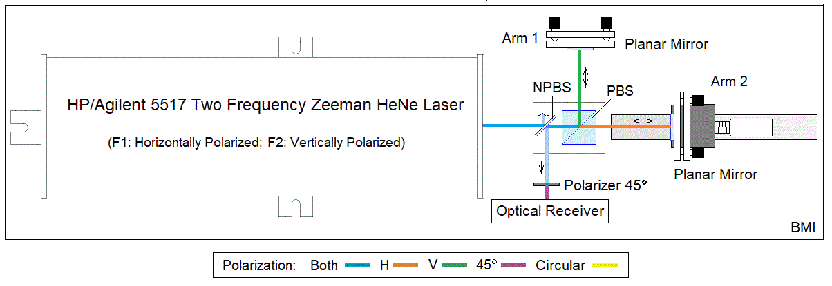

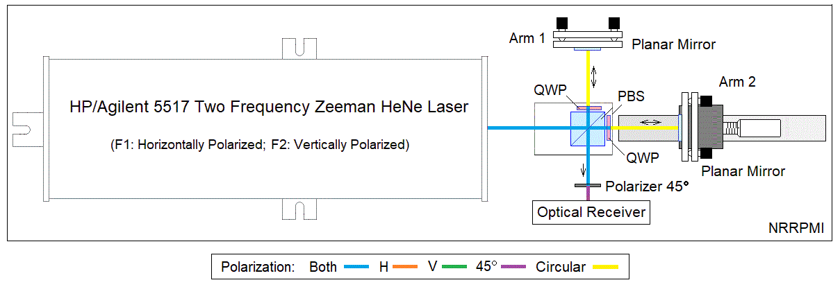

    The Michelson interferometer is one of the earliest and simplest to be developed, but also likely the most widely used configuration in a variety of applications including metrology (precision measurement). The type found in most introductory textbooks use single frequency or unstabilized lasers in what are known as "homodyne" interferometers. They are the subject of the companion document: Sam's Educational Michelson Homodyne Interferometer Project Manual V2.1 This version uses a special two frequency laser to implement the "heterodyne" interferometer, which are more likely to be found in high performance commercial applications like semiconductor wafer foundaries.
    An experimental setup is presented which allows for several types of interferometers to be easily implemented without requiring any special tools or test equipment. The behavior of various interferometer configurations will be explored as well as the use of the interferometer for sensing and extensions to actual measurements like displacement (change in position) down to nm precision. The set of parts may be easily duplicated and/or modified for specific interests.

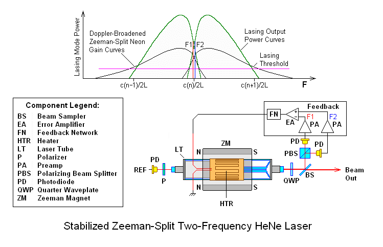

    Homodyne interferometers employ a laser which nominally produces a single optical frequency ("laser line") while heterodyne interferometers employ a laser that generates two closely spaced optical frequencies. They each have their advantages and drawbacks. Much more on this below. The default laser used in these kits is some version of a 5517 from HP (Hewlett Packard), Agilent, or Keysight. They are all virtually the same with name changes due to corporate changes. However, there is also an advanced option to construct the two frequency laser from basic components. This is discussed briefly later in this document with links to more detailed information.

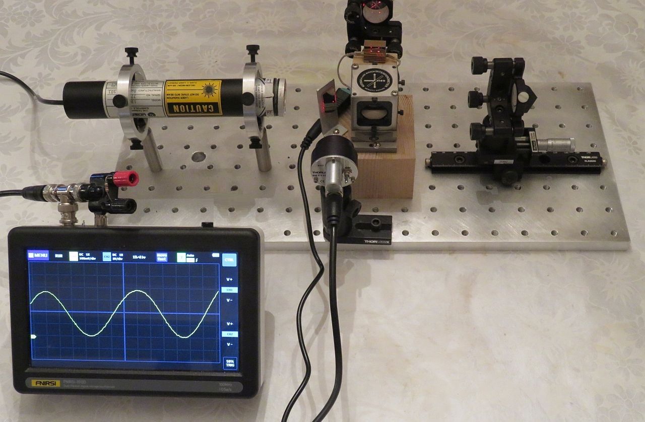

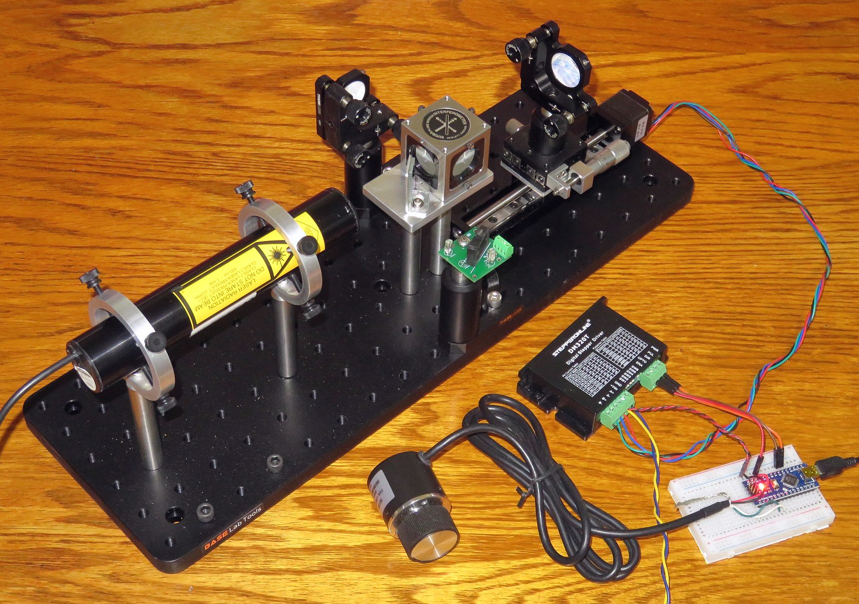

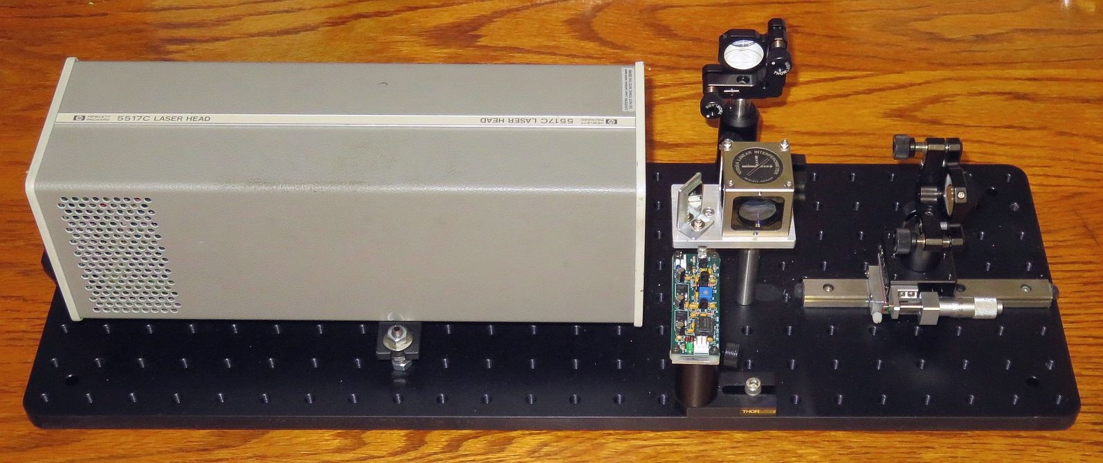

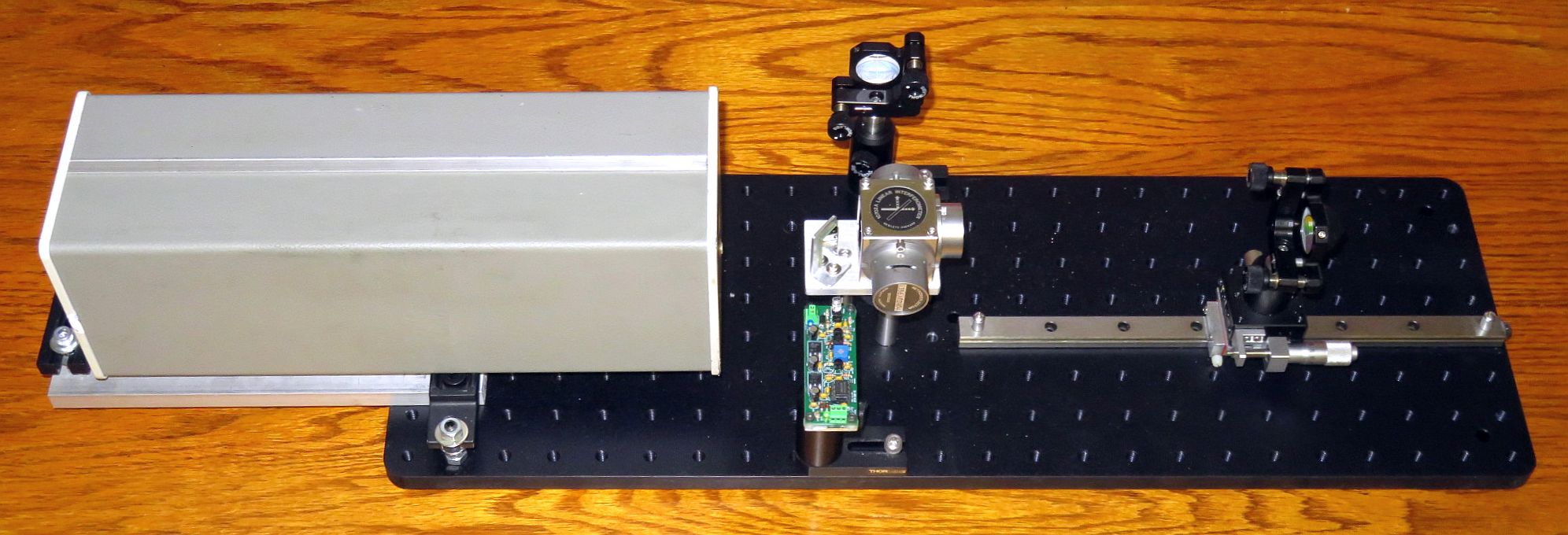

    The photo below shows two typical configations of the Compact and Extended Heterodyne setups.
    Typical Compact and Extended Heterodyne Setups with Ball Bearing Rails and OR3
    While interferometers are employed in a wide array of applications, the general emphasis for these experiments relate to the use of interferometery in metrology - precision measuremens of physical characteristics like displacement, velocity, angle, straightness, and more. Therefore unlike numerous interferometer experiments that may be found via a Web search, the emphasis here is on the signals that the setup provides, not so much on the interference patterns. With the homodyne interferometers using a non-two frequency laser (stabilized or otherwise), nothing precludes the observation of these. However, with a two frequency laser, the fringes aren't stationary and would have a bandwidth extending to MHz. So, unless you've opted for the high performance eyeball upgrade, that's out of the question. :( :-)
    The experimental setups will enable various interferometer configuration to be easily implemented and then tested with one arm being on a micrometer linear stage and/or with some other device or material that can vary the path length precisely.

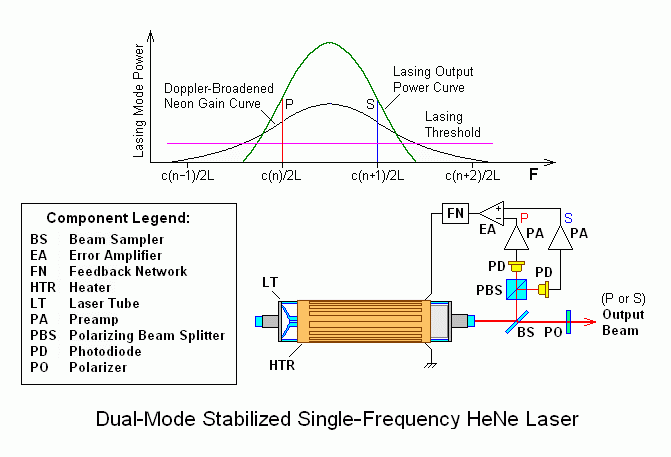

    The light source is a Class II 633 nm Helium-Neon laser (HeNe for short) with an output power typically between 0.25 and 0.5 mW. Unlike the common HeNe laser, it produces two optical frequencies ("lasing lines") separated by a value called the "split frequency", and are implemented using a technique called "Zeeman Splitting". In essense, an axial magnetic field applied to the laser tube causes it to produce a pair of lasing lines (rather than a single one), typically 10s of kHz to several MHz apart. The "Z" used in various filenames and links throughout this manual is an artifact of the Zeeman laser that is used. ;-)

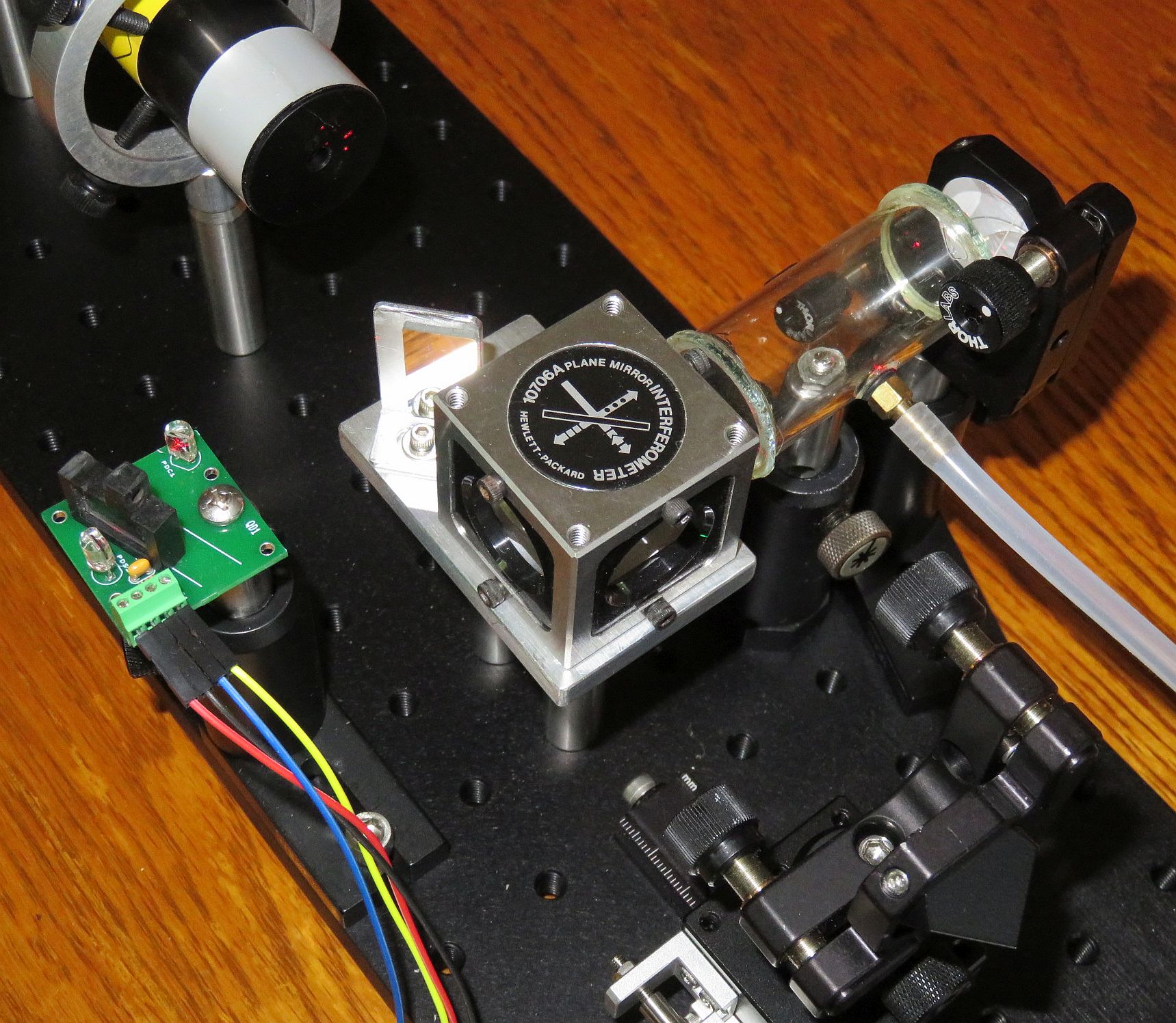

    A very simple custom PCB is included to implement a similar circuit for initial testing with an oscilloscope. It is called BPD1 but the PCB may be unmarked or labeled something else. The bias supply can be +15 VDC from the laser power supply, 12 V from the power pack used for various experiments, or a 9 V battery. The load should be 2-3K ohms.

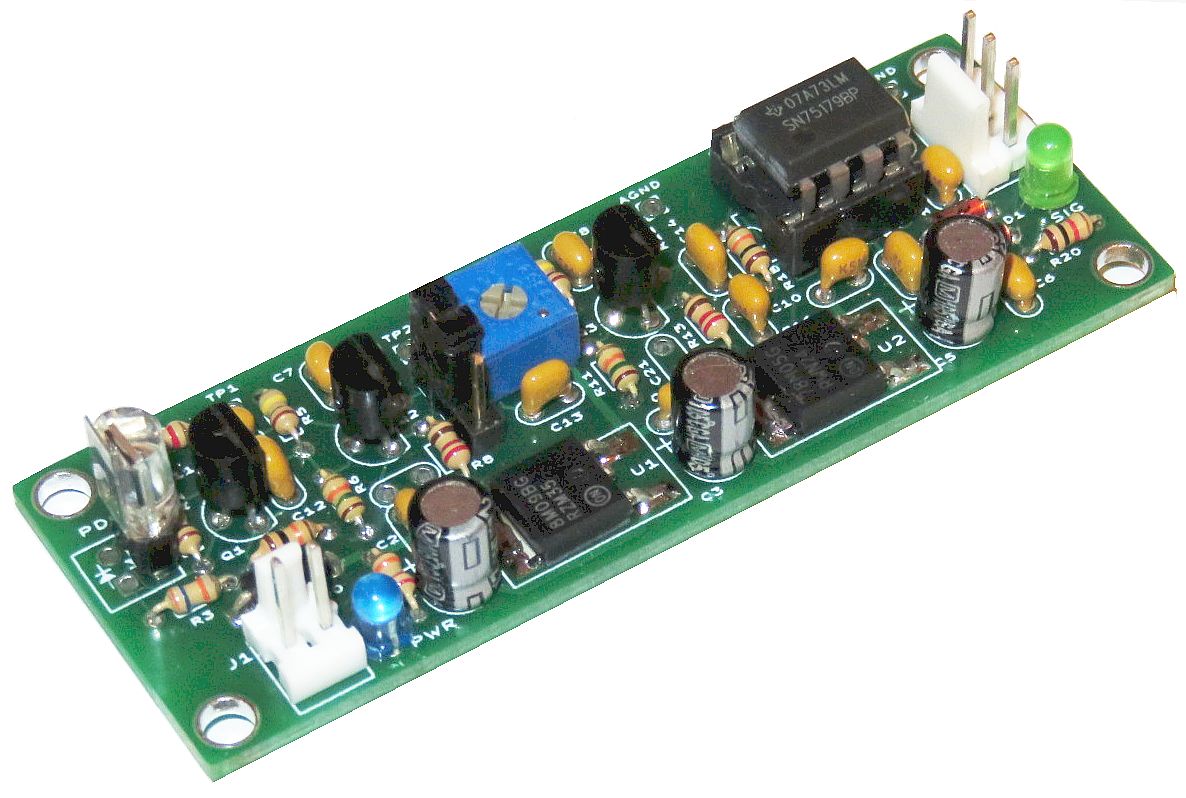

    Optical Receiver (OR3)
    An optical receiver (which may be abbreviated as simply "OR") when used in the context of heterodyne interferometry is the component which converts a laser beam consisting of a pair of orthogonally-polarized components at slightly different optical frequencies to an electrical signal at their difference frequency. (ORs can also be used with any optical input having an AC component such as an amplitude modulated beam.) Traditionally, commercial 10780 ORs from HP/Agilent/Keysight (or less commonly, 1031s from Excel) have been included with the "DIY Interferometer Displacement Measurement System Kits". However, not building the ORs has always been considered as sort of cheating since nearly everything is, well, DIY. And the commercial ORs are becoming harder and more expensive to come by. ;-) In addition, they require 15 VDC and may not work properly with the 12 VDC used in other parts of the kits, necessitating the addition of a voltage boost converter. And there is that unobtanium 4-pin BNC connector which means wiring is somewhat of a kludge.
    OR3 is on a 1" by 2.75" PCB and remedies most of these deficiencies. The optical input is a beam up to ~3 mm in diameter (using the default photodiode) with an optical power from <10 µW to >1 mW. While OR3 as tested doesn't have the frequency response of the commercial ORs, its >3 MHz bandwidth is more than adequate for systems using the kit lasers. And it is expected that the bandwidth limit can be extended with trivial changes to only a few part values. This is left as an exercise for the student. ;-)
    Where optical power low and electrical noise pickup becomes an issue (or for simply for convenience and aesthetics), a case with a copper foil liner or wrap for shielding could easily be fabricated for this using that lonely 3-D printer eagerly awaiting something to 3-D print. ;-)
    The actual SG-OR3 PCB is four layers with internal power and ground planes. This does appear to have better sensitivity without stray noise pickup than a two layer PCB with the same component placement but no planes. The gain can be set at the half way point and still be quiet with no signal without shielding. And the sensitivity there is better than 2 µW at 3 MHz. The populated SG-OR3 PCB is shown below. It may look HUGE in your Web browser. Don't be fooled. ;-)
    Typical Populated OR3 V1.02 PCBs - with Headers and Screw Terminal Blocks

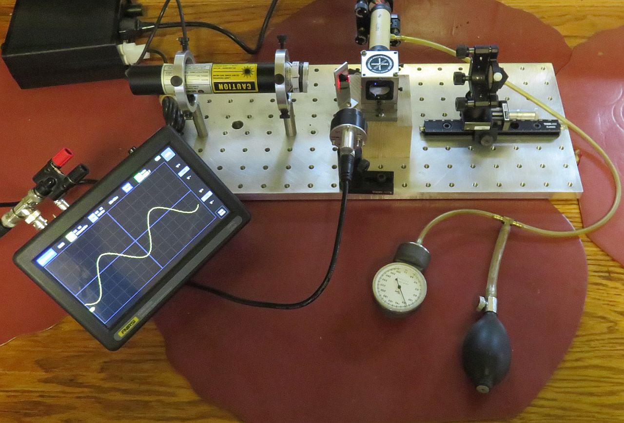

    REF (F2, vertical) and MEAS (F1+ΔF1, horizontal) are passed through a linear polarizer at 45 degrees to a back-biased photodiode. The optical receivers provided with this kit add circuitry to boost the signal and then convert to the RS422 signal format required by µMD2. See Optical Receiver 3 (OR3) - Assembly and Operation Manual. These are provided in kit form with Heathkit™-style assembly instructions so construction is not overly painful. ;-)
    More information on OR3 including complete "Heathkit™-style" assembly instructions may be found at Optical Receiver 3 (OR3) Assembly and Operation Manual.
    Using the Oscilloscope
    For "first signal" with the interferometer, an oscilloscope will permit the actual phase difference due to the MEAS signal from the changing PLD of Arm 1 and Arm 2 and the REF signal to be compared side-by-side (or more likely, one above the other).
    (Even though REF and MEAS are differential pairs - each pair being similar but with polarity - we will usually refer to them simply as REF and MEAS except as noted.)
      BPD1 Pin     Function
         1      GND
         2      +Bias Voltage
         3      PD 1 Anode
         4      PD 2 Anode
    PD1 is probably the one to use. The other one is intended to be used where a beam-splitter separates the polarized components. As with the Thorlabs DET110, a load resistor is required so the photodiode current can develop a voltage to be viewed with the scope. At the frequencies that MEAS will have, a value of a few K ohms is suitable.
                     2   R Protect      PD1              3
     + Bias Voltage o-------/\/\---+-----|<|------+-------o Scope Channel 2
                          1K ohms  |              |
                          typical  |              /
                                  _|_ C Bypass    \ R-Load
                                  --- 0.1 µF      / 2-3 K ohms typical
                     1             |              |      1
     - Power Ground o--------------+--------------o-------o Scope Channel 2 Ground
    The signal will be a fairly decent sinewave at the REF frequency with an amplitude proportional to optical power and R-Load.
    However, the MEAS electrical signal will only be present when the F1 and F2 polarized components are both present and combined using a linear polarizer at 45 degrees. This will be true directly from the laser but the signal from the interferometer, correct alignment will be required.
    With REF and MEAS displayed on the scope and synced to REF, any change in PLD will show up as a change in the horizontal position (phase) of MEAS. With the interferometer aligned, gently touching the breadboard or even just walking across the floor will probably be easily detectable.

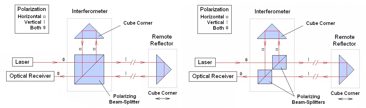

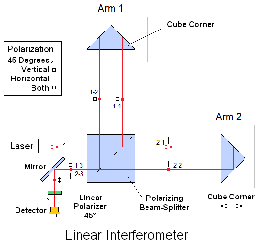

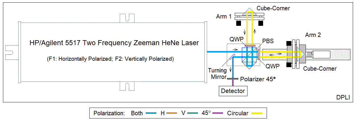

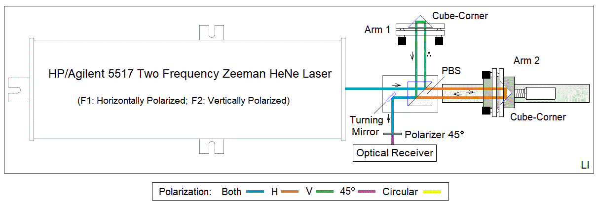

    Linear Interferometer

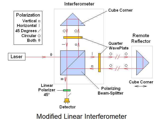

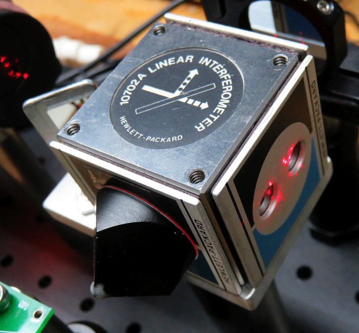

    Although HP called the combination of the PBSC and reference CC attached to it, the "Linear Interferometer", the term "LI" here will refer to the entire setup. And to enable the PLD to be set to zero, the CC normally attached directly to the PBSC will be mounted a few inches away (though with the stabilized two frequency laser, the requirement for limited PLD is no longer relevant).
    Linear Interferometer Setup

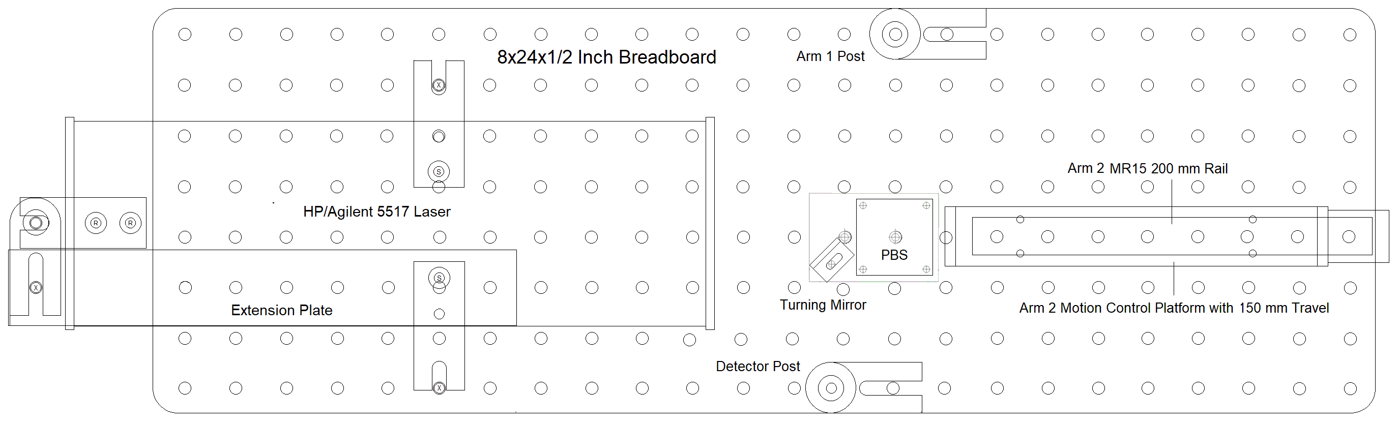

    The diagram below shows the general arrangement of the laser, beam splitter, cube corners, and optical receiver.
    Linear Interferometer Diagram and Suggested Compact Version Breadboard Layout
    The other configurations will have a few additional or substitute parts and small variations in the horizonatal position of the laser and placement of the optical receiver but are otherwise similar. Therefore only the LI setup will be described in more detail.

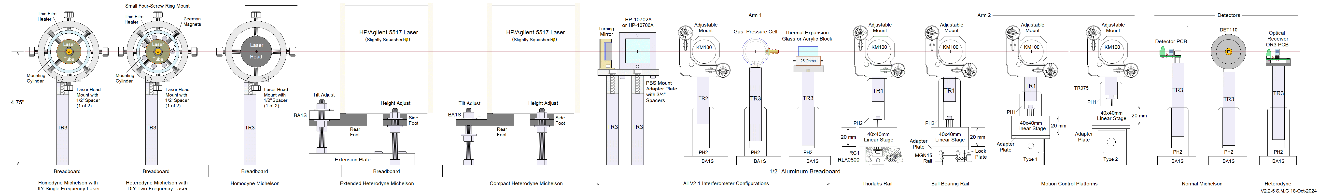

    The following diagram shows the relationships of the various mounts for setting the heights during assembly. This diagram applies to all V2.1 setups. 4-3/4" places the laser in the center of the PBS vertically:
    Required Optical Components and their Suggested Heights.
    The only difference between the Compact, Mid-Size, and Extended versions is mounting of the back of the laser. For the Compact version, the stud is attached the breadboard; for the others, the stud is attached to the xtension Plate.
    If there is no desire to include any of the motion control options, the height of everything can be reduced by around 1".
    The heights of any Retro-Reflectors (RRs) in the setup will be what most affect the beam height. This is true of the Linear Interferometer (LI). Where there is an RR attached to the PBS cube like the Plane Mirror Interferometer (PMI), the alignment of the laser will need to be used. However, there is a wide tolerance and enough degrees of freedom so in the end, it should not really be much of a problem to set it up.
    Here is an annotated photo of a typical setup configured for the DPLI:
    Compact Version of Heterodyne Interferometer with Major Parts Labeled
    Assembly and Alignment of the Linear Interferometer

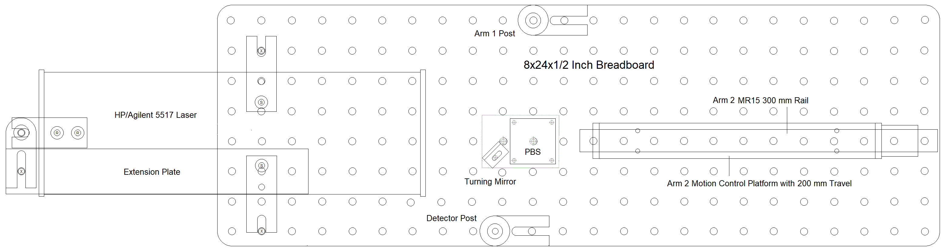

    The following procedure may be used to install each of the parts and then get to the point of "first signal" using the oscilloscope. The procedure for the other interferometers will be virtually identical in most respects, but may be trickier depending on the type.

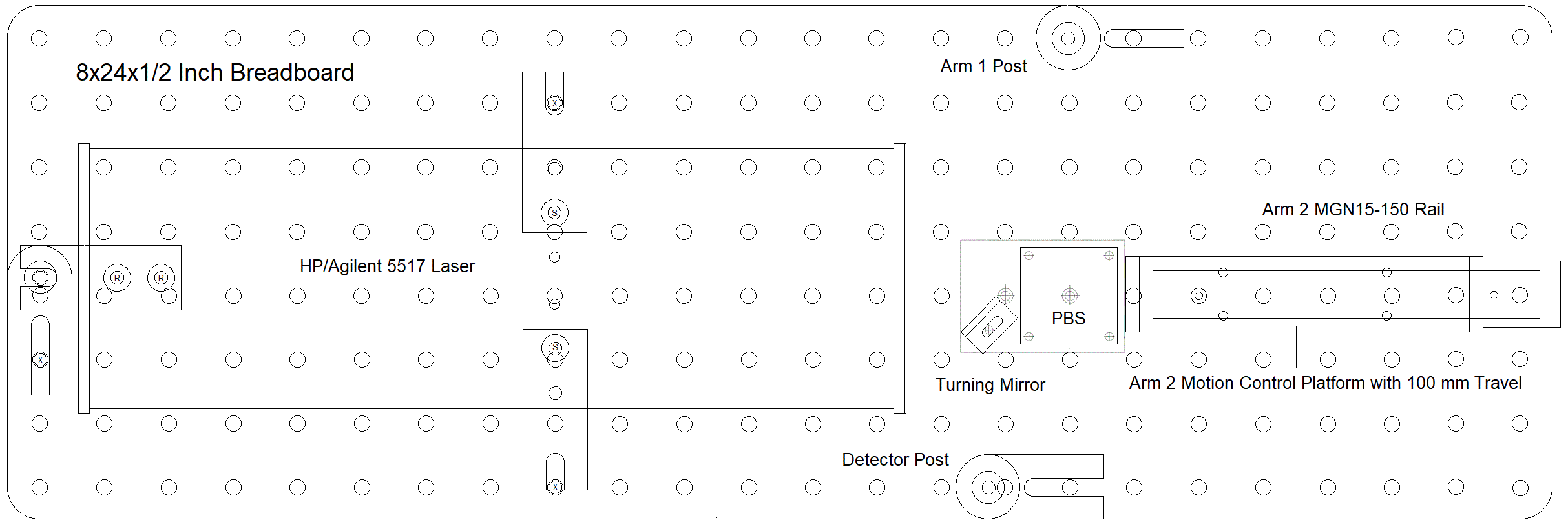

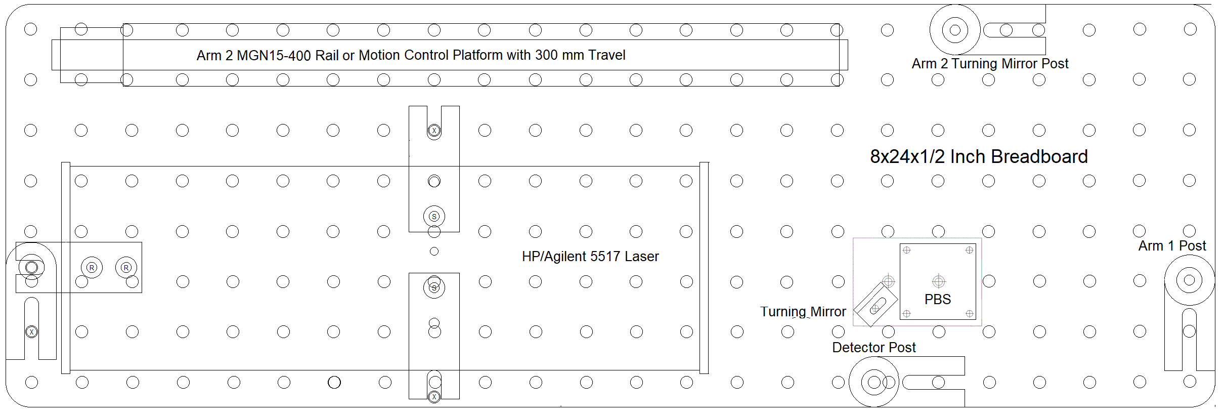

    Please refer to the appropriate layout diagrams below.
    Linear Interferometer Breadboard Layouts for the Compact Version (left), Mid-Size Version (center-Left), Extended Version (center-right), and with Long Rail or MCP (right)
    An noted above, the only real difference between first these setups is in the mounting of the laser and the length of the ball bearing rail (or motion control platform). The Compact Version is most easily transported while the Extended Version provides the maximum range of movement of the Arm 2 reflector. The Mid-Size Version represents a nice compromise.
    The one on the right supports an extra length 400 mm ball bearing rail or 300 mm motion control platform. Assembly is basically similar but detailed instructions are not provided, sorry. ;-) And it may be necessary to trim one of the BA1Ss used to mount the laser to provide clearance for the mount on the rail.

    9. Laser alignment: For the Linear Interferometer (and most others), the beam needs to be offset 1/4" toward the far side of the breadboard at a height of 4-1/4 inches.
      Doing this accurately is critical to the ease with which the subsequent alignment can be performed since not all mounts have sufficient degrees of freedom to accomodate an arbitrary beam location and direction. Fabricating an "alignment aid" out of carboard may be useful. This would have a hole at the optimal height offest 1/4" toward one side from a mark at the bottom.
    10. Interferometer assembly: This consists of the Polarizing Beam-splitter cube, mounting plate, 2x 3" posts. 2x 1/2" 1/4-20 setscrews, 2x 1/4" spacers, 2x 8-32 x 1/2" cap-head screws.
      1. Attach a pair of 3" posts to the breadboard with 1/4-20 x 1/2" setscrews in the locations shown above. Thread the setscrews about half-way into the breadboard. Then with something thin pressing on their sides to prevent them from turning, thread the posts onto the setscrews until they contact the breadboard. Use a thin rod (e.g., hex wrench) through the hole in the post to tighten them.
      2. Attach the "PBS Mount Adapter Plate" to the posts with a pair of 8-32 x 1" or 1-1/8" cap-head screws with 3/4" spacers between the plate and post. The screw on the right should be made fairly tight as it won't be accessible once the PBSC is installed.
      3. Remove any optics that may be attached to the PBSC. They will not be required for the LI. Store them wrapped in soft paper towels, bubble wrap, etc., to protect the optical surfaces.
      4. Place the PBSC on the PBS Mount Adapter Plate so that the diagnonal marking is front-left to back-right with the "In" arrow pointing left-to-right.
      5. Use four 4-40 x 1-3/4" cap-head screws to secure the PBSC to the plate from the top if the adapter plate holes are tapped or four 6-32 x 1/2" cap-head screws from the bottom if they not tapped.
      The laser beam should pass through the PBSC centered vertically and 1/4 inch toward the back. It should be at the same location relative to the breadboard at the far end. If not, fine tune alignment. :) Getting this dialed in via the nuts on the studs will greatly simplifiy alignment later.
    11. Turning mirror: Use tape or a *tiny* bit of adhesive to attach the turning mirror to the right angle "Turning Mirror Bracket" centered vertically with respect to the PBSC and flush with the right edge. Attach the bracket to the PBS Mount Adapter Plate with a 3/8" 4-40 cap-head screw and #4 washer. Center the screw in the elongated hole for now.
    12. Arm 2: These steps assemble the components of Arm 2. Arm 2 is assembled first because the lateral position of the CC cannot be adjusted relative to the laser.
      1. Thorlabs rail, ball bearing rail, or motion control platform: This assumes an initial installation, not swap.
        • Thorlabs rail (Homodyne only):
          1. Attach the Thorlabs RLA0600 6 inch rail (Basic and Deluxe) or Thorlabs RLA1200 12 inch rail (Deluxe+ version) to the breadboard. The recommended location is shown in the diagram above.
          2. Add 8-32 screws and #10 washers to the ends of the rail to act as stops.
          3. Attach the linear stage to the RC1 carrier using a 4-40 cap-head screw and washer.
          4. Install the stage/carrier assembly onto the RLA rail.
        • Ball bearing rail (Heterodyne or combined):
          1. Attach the MGN15-150mm rail with MGN15C carriage to the breadboard. Try to avoid removing the carriage from the rail as it is then easy for some ball bearings to attempt to escape. :( ;-) Since the holes in the MGN15-150mm rail do not line up with breadboard holes, it is attached to the breadboard with either a pair of 6-32 cap-head screws installed in special tapped holes, or one of these along with a 6-32 screw with nut and lockwasher through a 1/4-20 hole. The recommended location is shown in the diagram above.
          2. Attach the linear stage adapter plate to the MGN15C carrier using four M3-6mm flat-head screws. Tighten these securely as they won't be accessible after the other parts are installed.
          3. Attach the linear stage to the MGN15 adapter plate using four 4-40 1/4 inch cap-head screws at the corners.
          4. Add stops at both ends of the rail using the rubber bumpers (150 mm rail) or screws, spacers, and nuts (300 mm rail) provided. ;-)
        • Motion Control Platforms: These instructions will differ slightly depending on whether the MCP is Type 1 or TYpe 2, and on the length.
          1. If purchased at the same time as the interferometer, holes will already have been drilled in the breadboard for the stepper motor rig, with the motor on the right. These locations will enable the maximum usable travel. Else holes wlil need to be added.
            Secure the platform on the breadboard using four 4-40 1/2" cap-head screws if the holes are tapped, or 4-40 3/4" screws and nuts if not. Take care to assure that it is aligned.
          2. Attach the linear stage adapter plate to the platform using four M3-6 flat-head screws. To maximize travel, the plate should extend to the left (toward the PBS).
          3. Attach the linear stage to the linear stage adapter plate using four 4-40 1/4 inch cap-head screws at the corners.
          For more on setting up and using the MCP, see the section: Motion Control Platform
      2. Refer to the "Suggested Heights" diagram and attach a 2" post holder (rail or slide) or 1" post holder (MCPs) to the linear stage with an M3-12mm cap-head screws and #4 washer through the hole in the bottom of the post holder. Orient it so the knob on the post holder is easily accessible. Center the screw as best as possible and tighten it securely. Note: The hole may be tapped 4-40, in which case the screw should be 4-40 1/2".
        CAUTION: Make sure the tip of the screw does NOT contact the fixed part of the linear stage. If it does, an addition washer may need to be added. Or the screw can be shortened slightly with a metal file or grinding wheel.
      3. Adjust the micrometer so the stage is approximately in the center of its travel range.
      4. KM100 or similar mirror mount: Secure to a 1" post (rail or slide or MCP Type 1) or 3/4" post (MCP Type 2) with an 8-32 3/8" cap-head screw. Slip the post into the Arm 2 post holder and hand tighten its thumbscrew. Adjust the two alignment knobs so that the mounting plate is parallel to the base in both directions. If the adjustments are too tight, check that any locking screws are not tightened. Else, total removal, cleaning, and lubricating with a tiny amount of light grease or machine oil will be required.
      5. Cube Corner (CC) trihedral prism: Install the CC in the KM100 with its apex facing out and oriented to that a flat is at the top or bottom. (This reduces the chance of the beams hitting an edge of the prism.) It should be secured with either a soft-tipped set-screw or Nylon wide-head screw. DO NOT overtighten - it should be snug enough not to fall out (these are fragile!) but not so tight as to smash the CC! Note that the CCs mount backwards from what might be expected so that their edge can be secured properly. It's flat surface is facing through the mount.
      6. Set the knobs of the adjustable mount so its fixed and moving plates are approximately parallel and orthogonal to the beam axis as in the diagrams.
      7. The horizontal and vertical position (not orientation) of the CC relative to the incident beam adjusts the corresponding coarse position of the return beam.
        • Since the adjustable mount on Arm 2 and thus its CC cannot be moved laterally relative to the laser, the laser alignment should be double checked and fine tuned via its mounts if necessary so the incident beam is offset 1/4" toward the back of the setup from the center of the CC and aligned with the holes, and thus the return beam will be offset 1/4" toward the front of the setup and parallel to the incident beam.
        • The vertical position of the CC is adjusted by loosening the post holder's thumb-screw and should be set so the incident and return beams are at the same height.
      8. Place a piece of paper where the detector would be for the beam from the turning mirror. Fine tune the orientation and height of the mirror mount so there is a bright return beam there from Arm 2.
  • Arm 1: These steps assemble the components of Arm 1. It may be desirable to block the return beam from Arm 2 until the initial Arm 1 adjustments have been done.
    1. Attach a 2" post holder to a BA1S holddown with a 1/4-20 3/8" cap-head screw. Orient it so the thumbscrew (knob) is accessible.
    2. Attach this assembly to the baseplate using a 1/4-20 1/2" cap-head-screw.
    3. KM100 or similar mirror mount: Secure to a 2" post with an 8-32 3/8" cap-head screw. Slip the post into the Arm 1 post holder and hand tighten its thumbscrew. Adjust the two alignment knobs so that the mounting plate is parallel to the backplate in both directions. If the adjustments are hard to turn, check that any locking screws are not tightened. Else, total removal, cleaning, and lubricating with a tiny amount of light grease or machine oil will be required.
    4. Cube Corner (CC) trihedral prism: Install a CC in the mount with its apex facing out and oriented so that a flat is at the top or bottom. This is to orient the prism so that the beams do not hit an edge. It should be secured with either a soft-tipped set-screw or Nylon wide-head screw. DO NOT overtighten - it should be snug enough not to fall out (these are fragile!) but not so tight as to smash the CC! Note that the CCs mount backwards from what might be expected so that their edge can be secured securely. :) They thus face through the mount.
    5. Start with the knobs of the adjustable mount set so its fixed and moving plates are approximately parallel and orthogonal to the beam axis as in the diagrams. The BA1S can be moved to adjust the coarse horizontal position of the return beam. The post holder's thumb-screw may be loosened to move the adjustable mount up or down to adjust coarse vertical position of the return beam. The return beam should hit the PBSC at the same height as the incident beam, and offset 1/4" to the left of center. The spacing between the centers of the incident and returns beams should then be 1/2".
    6. Using your piece of paper with the Arm 2 return beam unblocked, there should now be two spots reflected from the turning mirror corresponding to the returns from Arms 1 and 2. (Unless, that is, you're very lucky and they are already superimposed perfectly!)
    7. Adjust the position and orientation of the CCs to superimpose the return beams from Arm 1 and Arm 2. This can be fine tuned with the adjustable mount knobs initially by eye. Then later once the oscilloscope is set up, it can be further optimized by maximizing signal amplitude from the detector.
  • Set up the oscilloscope: (If using a USB scope, this assumes that the required software and device drivers have already been installed on your PC or MAC.) For input, use one of the scope probes on the 1X setting (there is a slide switch on its body).
    Connect the REF signal to channel 1 using one of the REF wires from the laser head and GND. Set the scope to trigger on channel 1. With the laser powered and READY, there should be a stable ugly squarewave displayed at the REF frequency (between 1.5 and 2.0 MHz).
  • Detector mount:
    1. Attach a BA1S Holddown to a 2" post holder with a 1/4-20 3/8" cap-head screw.
    2. Install a 2" post into the post holder with the small (8-32) tapped hole at the top with the lock screw just snug.
    3. Clamp the assembly down loosely with a 1/4-20 1/2" cap-head screw.
  • Biased photodiode on solderless breadboard:
    1. Install a photodiode, 1K ohm resistor, and male-male jumper wires to the solderless breadboard based on the circuit in the section: Biased Phoatodiode (BPD1), or use the BPD1 PCB.
    2. install a 2.2K ohm resistor for R-Load. If you don't have one or something close in your private stock ;-) one can be borrowed from the SG-OR3 parts for now.
    3. Tape or place a piece of LP or LP/CP to the front of the sensor with its polarizaiton axis at 45 degrees (edges at 0/90 degrees). If using the CP, remove the protective film from both sides and the sticky side can be stuck directly to the face of the PD.
    4. Apply bias power to the home-built detector from the +15 VDC laser power supply, the 12 VDC adapter, or a 9 V battery.
  • Adjust the position of the detector so that the combined return beams are centered on the active area of the sensor.
  • Connect BPD1 and GND (across the load resistor) to scope channel 2.
  • If alignment is close, there should be a strong signal for MEAS on channel 2 at the REF frequency whose horizontal position varies dramatically with the slightest change in PLD or just touching the breadboard or anything on it! Even without going anywhere near the setup, there will still likely be instability due imperceptible vibrations possibly due to a bus 2 blocks away. ;-) The wavelengths of light are TINY! Each full cycle is 1/2 wavelength or around 316.5 nm. The micrometer moves the stage by 0.5 mm per full rotation, or around 1,389 nm/degree.
    (Even if one beam is blocked, there could still be a weak signal due to imperfect optical coatings and such resulting in cross-talk between REF and MEAS. But it will be stable and locked to REF. That's the tip-off that the interferometer is not working.)
    If the scope is triggered on channel 2 and the Arm 2 cube corner is moved rapidly back and forth on the rail, the MEAS frequency should change - increasing if the PLD is decreasing and decreasing if the PLD is increasing. If it doesn't change, alignment is not correct or an optic is installed incorrectly.
  • The amplitude of the AC part of MEAS can be maximized using the knobs on the Arm 1 and Arm 2 adjustable mounts. The signal amplitude may vary slightly over time as the laser continues to warm up. The time scale will depend on how long the HeNe has been on. Why? There can be several causes.
    And for those new to interferometers, to reiterate, the optimal alignment will also be where the signal instability is maximized. ;-) Almost ANYTHING will affect it from touching the apparatus or table on which it is on, to just walking across the floor. The wavelength of light is really really small. ;-) To put this in some perspective, a full cycle of the signal with the Linear Interfemeter is a change in PLD of 316.4 µm (1/2 wavelength of 632.8 nm or 1/3160th of a mm). That's about 1/158th the diameter of an average human hair (~50 µm) or 1/22th the diameter of a human red blood cell (7 µm). Street traffic will be detectable, as will drafts from the A/C, changes in temperature, and siesmic events. Some of these effects can be further explored using parts in these kits.
  • Now you're set to explore all sorts of exciting aspects of heterodyne interferometry. ;-)

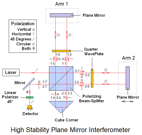

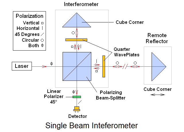

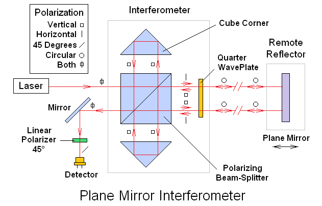

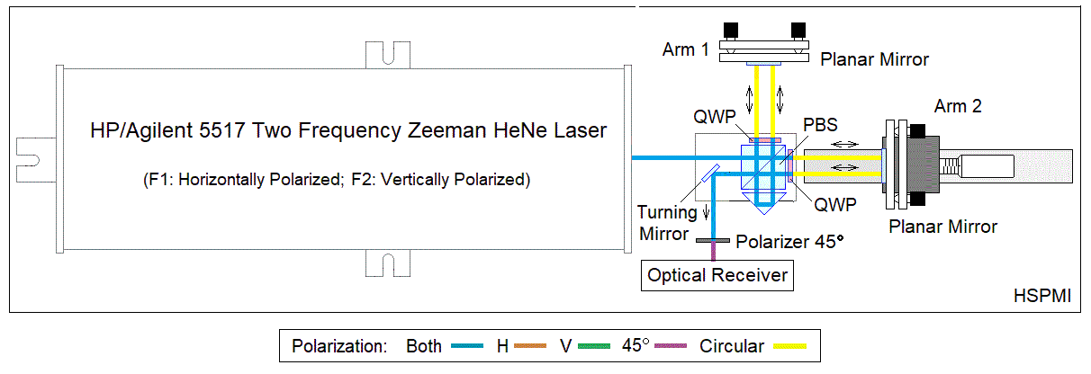

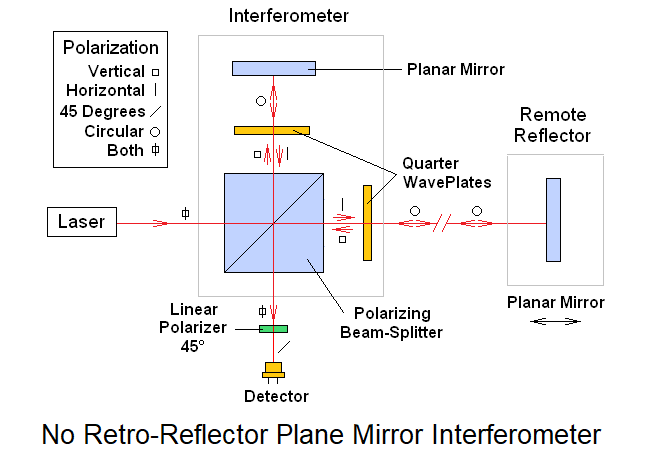

    The basic Plane Mirror Interferometer (PMI) as its name implies uses a plane mirror instead of a cube corner for the remote reflector. It has a double pass architecture which halves the distance for a full fringe cycle at the detector for a movement of the reflector in Arm 2 (called the "measurement arm"). However, if NOT using a stabilized laser (single or two frequency) it is not desirable to use a PMI here because it is double-pass only for Arm 2 but single pass for Arm 1. Thus while the PLD can be set to zero, the spacings or lengths of the two arms (as well as the change in displacement) are not the same, which at the very least is confusing. (More on this in the section on the PMI.)
    For use with a single frequency laser for homodyne or two frequency laser for heterodyne, the unequal path lengths is of little consequence. However, if building only a single type of plane mirror interferometer, it might as well be the HSPMI.
    Normally, the Arm 1 mirror would be mounted along with the QWP on the PBSC as the reference since absolute PLD doesn't matter with the single frequency or two frequency lasers. For this setup, it's more convenient to mount the Arm 1 QWP on the laser and the associated mirror separate.
    The only real difference in the assembly procedure is the addition of the\ QWPs and substitution of the planar mirrors for the cube corners. Alignment will be similar though the effects of beam height and offset will change subtly. But what fun would it be if nothing was different? ;-)

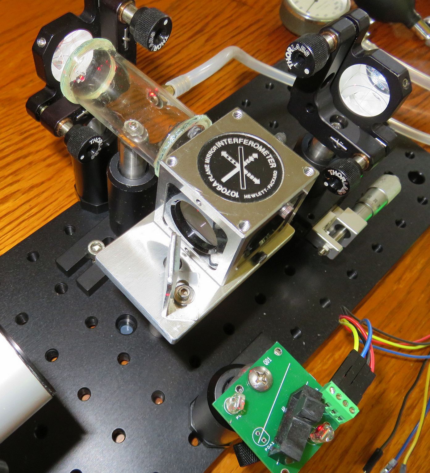

    High Stability Plane Mirror Interferometer Setup
    Assuming the LI was already built, not many changes/additions are required:
    1. Install the HP retro-reflector (10703A) on the PBSC face closest to the detector. The orientation should be such that the beam doesn't hit an apex. This usually means the serial number (if present) runs up and down.
    2. Install QWPs (HP 10722A or unmarked) on the faces toward the Arms. Their orientation does not matter as long as the screw slots are used.
    3. Replace the unmounted cube corner retro-reflectors with circular 1" planar mirrors. The mirror mounts can be rotated 180 degrees to make them easier to adjust.

    All setups after V1.0 come with either a Thorlabs rail (RLA0600 or RLA1200), or a ball bearing rail (MGN15-150mm or MGN15-300mm). The latter is standard with V2.1. The rails allow for coarse positioning of Arm 2 to adjust the PLD. The advantage of the ball bearing rail is smoother movement so that the alignment is not lost and thus the measurement readouts (µMD0 or µMD2) can track without error.
    Micrometer Linear Stage
    All setups come standard with a precision micrometer linear stage that mounts on the rail carrier or carriage. Three types have been used: a Parker 3902 (English) or 3902M (Metric), a generic stage with the knob on the end, and a generic stage with the knob on the side (both Metric). All types have a range of around 1/2 inch or 12.7 mm. The generic stage with the knob on the side is the default type with V2.1. The knob on the side is preferred in part because it won't interfere with the Motion Control Platform's motor housing.
    The micrometer stages permit µm-scale displacement to be manually set, though as a practical matter doing *anything* at that resolution manually is a challenge. And even just touching the knob introduces a displacement shift and vibrations which are easily detectable and jitter in the fringe display or measured displacement.
    This is currently an option but may be included standard in the future.

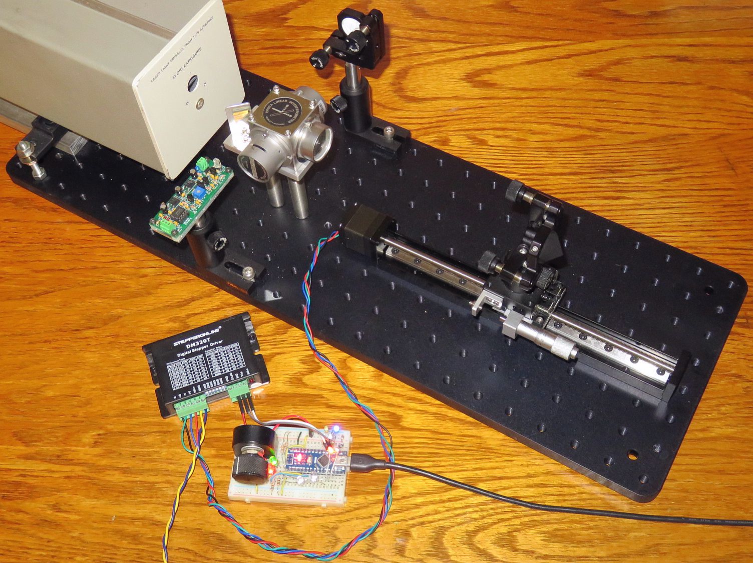

    It would replace the Thorlabs or ball bearing rail and carrier with a stepper motor-driven platform and an Arduino-compatible board to drive it. Among other things, this will enable the characterization of non-linearity, backlash and displacement scaling error. These are critical parameters in CNC machine calibration. In addition, controlling Arm 2 motion electronically should introduce far lower vibration than actually touching the micrometer knob.
    However, these are not super precision rigs. Their selection was based on the small size to fit the interferometer setup - and cost. So they may have significant free-play, backlash, and other errors. But that's exactly the sort of thing that experiments can aim to characterize. The main issue is that they use a lead screw (not a ball screw) into a threaded brass block. And aside from a setup like that being inherently imprecise, the machining is sometimes, well, not so great as well. :(
    (Doing something similar using a servo motor rather than stepper motor is possible and theoretically superior, but likely much more expensive and complex.)
    The basic components are:
    The setup below was used for the initial implementation and is similar to what will be included in the kit, (currently an option). This rail with a travel of 200 mm would fit easily fully on the "Extended" version of the interferometer. In fact, rails with a 250 mm travel would also fit and they may be available in the future. For the shorter setups, a rail with a travel of 100 mm would be used. Putting the motor on the left enables a micrometer stage with the knob on the end to be used without hitting the motor housing, which is at a greater height than the platform. However, to minimize the PLD for the homodyne setups, the motor should be on the right using a micrometer stage with side-mounted knob. For Heterodyne, the absolute PLD doesn't make any difference so there's no real need for the reflector to be able to move as close as possible to the interferometer.
    Holes will need to be drilled or drilled and tapped on the breadboard to mate with the Metric hole spacing of the rail. BA-type hold-down clamps or even industrial strength double sticky tape would also work, if a bit clunky.
    To mount the micrometer stage on the stepper platform, an adapter plate is needed unless one is willing to simply use glue. It's the same one used with the ball bearing rail, so that can be transferred if available. 5-Minute Epoxy would be satisfactory, and could be removed if necessary. (If installed on a V2.0 setup, the optical centerline increases by 1/2 inch so some parts change, mostly Thorlabs posts and spacers.)
    The Atmega 328P Nano runs the firmware in the link, below. This is for testing only or if all that's desired is a manually-controlled motorized stage. ;-) It has no error checking so twiddling the knob faster than the motor can move so it just whines is very easy, and there are no limit switches so the flaform can smack into the end plates. But as can be seen, there are many extraneous useless LEDs. ;-) The DM320T controller is set for 400 pulses/mm and the lowest motor current of 0.3 A. Higher current will increase the maximum speed to some extent, but don't go above a sustained current of more than 0.6 A. CAUTION: I you decide to play with a rig like this, make sure the DC to the DM320T is clean and comes on quickly. Else the DM320T may get into a funky state which among other things can send lots of current through the motor, as well as not respond to drive pulses. At least, that's what appeared to have happened on more than one occasion when ramping up the input voltage manually. A 12 VDC wall adapter solved that. I don't know if the red Fault LED on the DM320T being off is sufficient to guarantee correct operation.
    Test of 200 mm Travel MCP (left), on Extended Heterodyne Setup (Left-Center), Test of 100 mm Travel MCP (Right-Center), and on Basic Homodyne Setup (Right)
    The photos show samples of the 100 and 200 mm travel MCPs along with typical installation on the optical breadboards. The electronic Solderless BreadBoard (SBB) with the Nano driving the 200 mm versions is my original rig for testing the quad decoder sketch; the one with the 100 mm versions is all that's needed and is what will be included in the kit. Feel free to add decorative LEDs. ;-) And yes, if you look closely, the tip of the micrometer is not touching the bracket in one of the pics. That's because the stage can be locked in place and wasn't unlocked for the photo. ;-)
    The hardware is the easy part and a mock-up has been constructed as shown above. For V2.1, the motion control platform can be substituted for either the Thorlabs or ball bearing rail with virtually no changes to anything else. But for V2.0, it will not quite be a drop-in as the heights have increased by 1/2 inch. So some opto-mechanical components will need to change - mostly Thorlabs posts and spacers, but there would be negligible additional cost involved.
    The software to make this educational and useful is the challenge.
    An Arduino sketch for an initial version that simply enables the platform to move based on Quad-A-B encoder signals - NOT from the interferometer! - can be found at:
    The SG-µMD0, SG-µMD1, or SG-µMD2 PCBs can have firmware added for motor control in addition to their other duties. Or another microcomputer could be used.
    Suggestions for actual challenging applications (and coding volunteers) are welcome. :( :-)
    Mechanical installation
    1. Motion control platform: If purchased at the same time as the interferometer, holes will already have been drilled in the breadboard for the stepper motor rig, with the motor on the right. These locations will enable the maximum usable travel.
      Secure the platform on the breadboard using four 6-32 1/2" cap-head screws if the holes are tapped, or 6-32 3/4" screws and nuts if not. Take care to assure that it is aligned.
    2. Adapter plate and stage: These are the same as used for the ball bearing rail. If transferring them, first remove the stage and then the flat head M3 screws securing it to the ball bearing rail carriage Reinstall in the opposite order on the MCP using the appropriate set of holes. To maximize range, have the plate extend on the side away from where the knob is located.
    Electrical installation

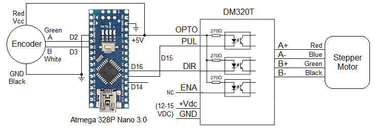

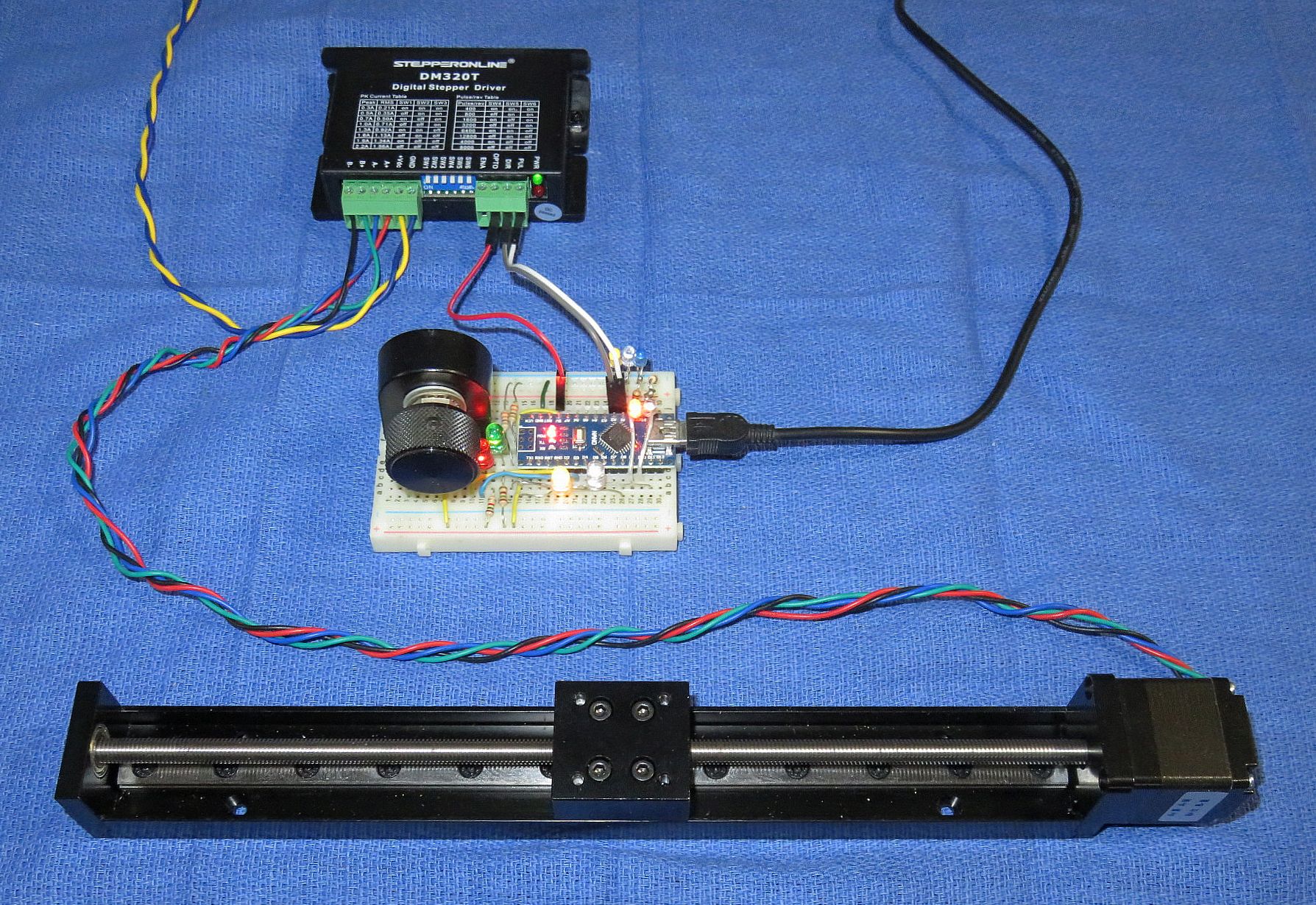

    Please refer to the connection diagram below.
      Typical Connection Diagram for Motion Control Platform Testing
      (To reverse direction, do only ONE of the following: Swap A and B, Mov DIR from D16 to D14, swap A+ and A-, swap B+ and B-.)
    1. Motor wiring: These may vary. Two schemes are known:
      1. Red/blue, green/black.
      2. Yellow/blue, red/green.
      There could be others, so confirm with a multimeter. The coil resistance should be no more than a few ohms. Connect them to the A+/A- and B+/B- terminals of the DM320T. As a practical matter, it doesn't much matter which motor winding goes to A or B, or even the polarity as long as they aren't cross-connected (which should not damage anything but the motor won't move). Direction of motion is reversed by swapping any single pair of wires going to a specific winding. The DM320T connector blocks may be removed by grasping them and pulling straight ou if that is more convenient to secure the connections.
    2. DM320T power: 12 to 15 VDC is recommended. For the homodyne systems, a 12 VDC power pack is included for this purpose. For the heterodyne system, DM320T power can come from the +15 VDC power supply for the laser.
    3. Control signals: These are opto-isolated logic level signals. OPTO should be connected to +5 VDC from the Nano. DIR(ection) and PUL(se) can be driven from a Nano digital output as in the sample sketch. ENA(ble) defaults to active if left open. PUL triggers the motor to move on the negative edge of the electrical signal (logical rising edge).
    4. DM320T DIP switches: For the NEMA11 stepper motor, set "PK Current" to 0.3 A. If there are problems with vibration, go to 0.5 A but not more. A higher current will simply cause the motor to get hotter even at idle. Initially set the "Pulse/rev" to 400 (which is the coarsest resolution). Rotating the encoder will result in fairly fast movement of the platform. For these settings, all the switches should be ON (down). You can play with the Pulse/rev settings later. ;-)
    5. Arduino wiring: Carefully plug the Nano into the solderless breadboard with its USB connector at one end. Power can come from a USB port or USB charger cube, 5 VDC to 5V, or a 7-12 VDC power supply to VIN and GND. (A USB backup battery pack is not recommended as these may shut down after a few seconds due to insuffient current.) If using VIN, adding a zener diode, three-terminal regulator (e.g., 7808), or some other means to drop the voltage to between 7 and 8 V is recommended to reduce the power dissipation in the Nano's on-board regulator. For example, if using 12 VDC for the DM320T, a 1N4732 (4.7 V) will drop the input voltage to around 7.3 V. 5V from the Nano then powers the encoder and OPTO for the DM320T.
      Here are the required connections. Referring to the sample sketch, there are other pins that may be used to monitor up/down pulses and PWM signals to drive various flavored LEDs for your own amusement. ;-)
        Arduino Pin   Nano Pin   Name   Function
             D2           5       A     Encoder input
             D3           6       B     Encoder input
            D14          19      DIR-R  Direction reverse to DM320T*
            D15          20      Pul    Motor drive pulse (low) to DM320T
            D16          21      DIR-F  Direction forward to DM320T*
            GND          29      GND    Ground/common for optical encoder+
             5V          27      +5V    +5 VDC for DM320T OPTO and optical encoder
            VIN          30      VIN    +7 to +12 VDC input power (optional)
      * Only one of the Direction signals should go to the DM320T. They are complements of one-another. So if the platform moves the wrong way, use the other one.
      + Since the control signals to the DM320T are opto-isolated, the DM320T GND does not need to connect to the Arduino or encoder GND.
    6. Encoder wiring: The typical wire colors/functions are:
         Color   Function
          Red    Vcc (+5 to +24 VDC)
         Black   GND/Common
         Green   Output A (open collector)
         White   Output B (open collector)
      Double check with the labeling on the encoder. Tin the wire ends or solder them to #24 AWG solid wire to insert into the SBB. The required pullup resistors are provided by the Nano so no other components are required.
      The encoder can also be used to drive µMD0 or µMD2 with Homodyne firmware. For that, pullups will need to be added to the A and B signals and a reference voltage will be required on the A- and B- inputs at about 1/2 the signal swing.
    When power is applied to the DM320T, the green LED should come on but NOT the red one. If it does, check connections and that power is clean and being applied quickly (not ramping up). The motor should not get more than slightly warm even after being on for a while at the 0.3 or 0.5 A current setting. The motor may make a hissing noise when stationary due to the DM320T's drive. I assume it is some sort of dither to overcome stiction (or something). It is not known yet how much the resulting vibrations will be seen by the interferometer. That may be an interesting thing to quantify. Ears and interferometers are very sensitive. ;-)
    The typical rotary encoder included in the kits has a resolution of 400-600 cycles per 360 degree rotation. So turning the shaft should get the platform moving at a reasonable clip and it is easily possible to exceed the pulse rate where the motor responds. In that case, the motor will stall and whine with the platform remaining stationary. This is a mechanical limitation, not the Nano firmware. The lead screw has a small pitch (1 mm) which is desirable to maximize resolution for interferometer testing. But it also means the motor has to exert itself to produce fast movement. At the DP320T's coarsest Pulse/rev setting, the maximum platform speed is about 1 cm/second corresponding to 6,000 steps/second, or an encoder rotation rate of 2.5 revs/second. (6,000 steps/second / (600 cycles/rev * 4 pulses/cycle). If the DM320T DIP switch Pulse/rev setting is increased, the rate of movement will decrease proportionally and the maximum (input) pulse rate before the motor stalls will increase proportionally. Mounting a massive knob or wheel (not included) on the encoder would enable the friction and imbalance of the shaft to be measured by the interferometer. ;-)

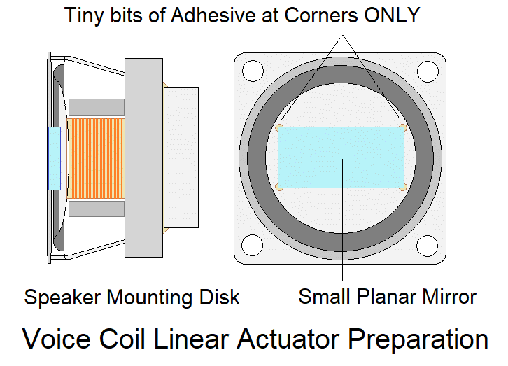

    Voice Coil Linear Actuator
    A loudspeaker consists of a coil of fine wire ("voice coil") on a cardboard form suspended within the field of a strong magnet in such a way that it can only move along its axis. This is attached to the speaker cone. Applying a voltage to the voice coil moves the cone in or out depending on polarity.
    The mini loudspeaker 4 ohm woofer can move its cone a couple of mm with 1.5 V at 0.375 A. But for these tests, it only needs to move a few µm.
    One of the interferometer configurations using planar mirrors must be used for this since it's not practical to attach a cube corner to the loudspeaker. The HSPMI is recommended.
    To use it:
    1. The 1" diameter 1/4" thick "Speaker Mounting Disk" should be glued to the back of the loudspeaker with Epoxy. This will permit it to be installed in a KM100 mount just like a 1" diameter mirror.
    2. One of the small mirrors should be attached to the front of the loudspeaker with the tiniest of tiny dots of Epoxy at the corners. as shown below. Position it to be as parallel as possible to the loudspeaker frame.
    For seeing how its movement will affect the interferometer, the loudspeaker can be driven with a 1.5 V battery (not included) and series resistor. Even with a fairly high resistor value like 10K ohms, the mirror will move decent amount, probably much more than one fringe cycle. Or it can be driven through a resistor via the 10K ohm potentiometer and 10K ohm series resistor from a 9 V battery or 12 VDC power supply. One of these should be included in the kits.
           + o--------+
         Battery      /     10K
        or Power  10K \<---/\/\---> +
          Supply      /
                      \       Loudspeaker
           - o--------+-----------> -
    Calculate the sensitivity of movement in nm with respect to loudspeaker voice coil current.
    DO NOT connect the loudspeaker directly to the 12 VDC power supply or 9 V battery as they both may be damaged or destroyed. No more than 1.5 V should ever be applied to the speaker. This can be done using a series resistor between it and the power supply or battery or with the potentiometer and series resistor as shown above. Only a very small current will be needed to move the mirror enough to be readily detected and it won't be visible by eye.
    An electronic function generator with simple buffer amplifier and current limiting resistor can also be used to drive the loudspeaker over a larger range as long as the voltage to the loudspeaker doesn't exceed around 1.5 V. With a triangle wave and µMD0, it should be possible to demonstrate the linearity (or non-linearity) of the loudspeaker cone with respect to voltage.
    The loudspeaker will also be sensitive as a microphone so monitoring the detector output on the scope should result in a fairly sensitive response to voice and music, though the frequency response will be terrible due to the large mass of the mirror. Input that to the line input of a stereo system and listen to it on headphones. Why? The quality will be terrible but it will demonstrate possibly the most complex way of going from acoustic sound to electronic sound. ;-)

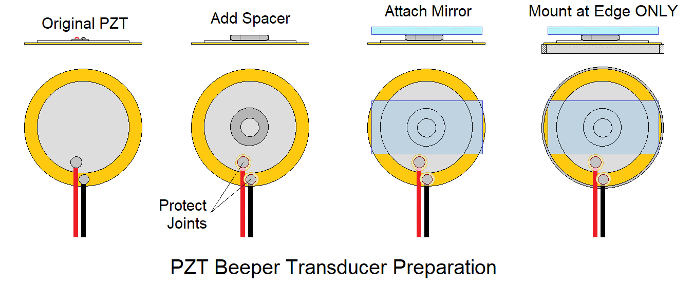

    Piezo Transducer
    A PieZo Transducer (PZT) can be used to move a mirror where only a small displacement is required. (The acronym PZT is actually based on the active material which deforms as a function of voltage, an inorganic compound of Lead (Pb), Zirconium (Zr), Titanium (Ti), and oxygen). Look it up. But our abbreviation is easier to remember. ;-)
    The PZT beeper element in the kit is 27 mm in diameter with an active area of around 20 mm in diameter. It is what's called a "drum head" PZT because the surface moves in and out at its center when a voltage is applied. It can move a few hundred nm with 15 V at essentially no current - it has some capacitance but an infinite resistance, which for slow movement is all that matters. Up to around 100 V can be safely applied to move several µm.
    As with the loudspeaker, one of the interferometer configurations using planar mirrors must be used for this since it's not practical to attach a cube corner to the PZT. The HSPMI is recommended.
    1. A small platform should be fashioned from a washer or something similar so that one of the small mirrors can be glued to the center ONLY of the PZT. This is necessary because a large mounting area may impede its movement.
    2. The PZT can be attached to a 1 inch ID ring (like the lock ring from a Thorlabs 1 inch diameter threaded mount) with 3 or 4 tiny dabs of Epoxy, or can be mounted directly on one of the KM100s in a similar way, or even taped in place. Take care attaching the wires as the solder connections are fragile. Putting a small amount of Epoxy over them (but only in their vicinity so as not to impede movement) is recommended.
    3. A 9 V battery or the 12 VDC power supply can be used along with the 10K ohm potentiometer to vary its voltage:
             + o--------+
           Battery      /     10K
          or Power  10K \<---/\/\/\---> +
            Supply      /
                        \              PZT
             - o--------+-------------> -
      (The 10K ohm series resistor is not required for the PZT but using it makes the circuit identical and safe for the speaker.)
    Calculate the sensitivity of mirror movement in nm with respect to PZT voltage.
    As with the speaker, an electronic function generator can be used to drive the PZT. With a typical output voltage swing of 20 V peak-peak, the change in position will be several wavelengths. By using a triangle wave and µMD0, it should be possible to observe how good the linearity of movement of the PZT is with respect to voltage, though there will be fewer full cycles compared to the speaker.
    Or it can driven from the loudspeaker output of an audio amplifier through a step-up transformer.
    The PZT may be sensitive enough to act as a microphone as well.
    Gas Cell Compensator
    This may be the niftiest experiment and demonstrates the sensitivity of the interferometer to changes in the index of refraction of air.
    It may be done using any of the interferometer configurations, though the sensitivity will depend on which one is used.
    The concept is that an increase in air pressure will change its index of refraction, and while this is totally invisible to the human eye, the interferometer should be able to easily detect it as a shift in the fringe signal. In fact many fringe cycles even for a space of a couple inches. With some simple calculations, it is possible to corelate the pressure reading on the gauge with the phase change of the fringe signal. If it's sealed well enough, even warming the gas cell by holding it tightly should result in a detectable fringe shift. However, doing that without introducing vibrations that totally swamp any change due to the expansion would be a challenge.

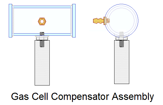

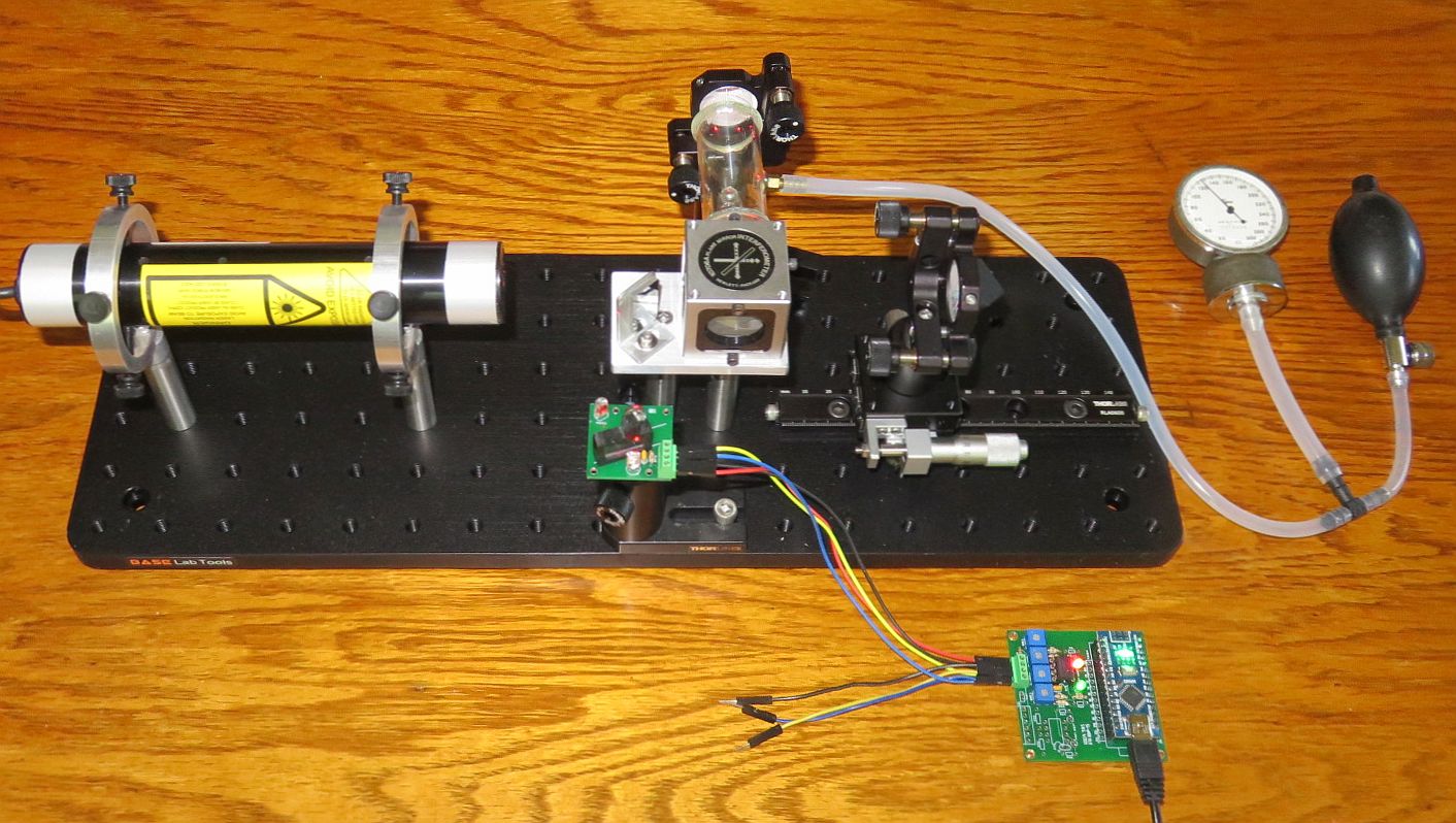

    The Gas Cell Compensator (GCC) consists of a ~2" length of 1" OD Acrylic tube, a pair of planar windows sealed to the ends, the pressure bulb and gauge for a blood pressure cuff (sphygmomanometer), and some simple plumbing. It can mount on a Thorlabs post and post holder using a BA1S hold-down.
    GCC Assembly:
    The Acrylic tube will already be cut to length and drilled and tapped for the 10/32 hose barb and 8-32 set-screw to attach it to a Thorlabs post. The ends will have been ground to be close enough for government work. :) They don't need to be perfectly perpendicular to the tube or parallel to each-other. Nor do they need be polished - the rough cut surface is better for gluing. Only that they can seal to the windows.
    The windows are 1-1/8" in diameter and made of either glass or Acrylic. The Acrylic will have paper protective brown paper on both sides.
    1. If there is more than one hose barb with threads, one of them may have the threads shortened so as not to protrude inside the Acrylic cylinder. Partially thread it into its 10-32 hole. Mix the tiniest amount of 5 minute Epoxy and apply it to the exposed threads. Then rotate it clockwise until fully seated. Wipe off any excess Epoxy and allow time to cure.
    2. Apply a small amount of the remaining Epoxy to the threads of a 8-32 1/2" set-screw. Intstall it in the 8-32 tapped hole so that no more 3/8" is exposed. Apply some more Epoxy at the threads where they meet the tube. (Since this one is vertical and can't interfere with the beams, some portion of it protruding inside the Acrylic tube is OK. Add an 8-32 nut as shown in the diagram for added strength with the Epoxy joining the nut to the cylinder.
    3. Clean one window end one end of the 2" tube with alcohol if available. Soap and water is also acceptable. DO NOT use anything stronger. Make sure it is completely dry and dust-free by shining a bright light through it before proceeding. Repeat as needed.
    4. Carefully place the tube on top of the cleaned window. Put a weight on top of it or use some other means to prevent it from moving accidentally.
    5. Prepare a small amount of 5 minute Epoxy and apply the tiniest bead all around the outside of the joint between the 2" tube and window.
      Avoid getting any Epoxy inside the tube, especially on the windows, as much of their area may need to be unobstructed depending on the type of interferometer and/or whether the laser has a beam expander.
      If it gets messed up before curing, the Epoxy can be careully wiped off and then the glass and/or Acrylic can be cleaned with alcohol (but nothing stronger!). After curing, a single edge razor blade can be used to remove Epoxy, then cleaned with alcohol. Take care to avoid scratching the window(s).
    6. Repeat the previous three steps for the other end. A cotton swab can still be used to clean the previously attached window if necessary. It's especially important that the inner surfaces of both windows be clean as they will be inaccessible once the second window is installed.
    7. Wait an hour or so before proceeding to allow the Epoxy to fully cure.
    8. Connect the hose barb on the tube with the pressure gauge and bulb using the rubber tubing. Test to confirm the connections are reasonably gas-tight and correct if necessary. For this experiment, a small leak may be preferred as it will allow for a controlled pressure decline which can be used to correlate with the fringe signal.
    The photos show the Basic homodyne version with the GCC installed in Arm 1 of the interferometer. The mirror mount post holder is moved further out to make room for it. The arrengement is identical for the heterodyne setups except for the substitution of the laser and optical receiver.
    For more details on the setup to view the signal, refer to the section: Monitoring the PLD.
    This photo shows the complete setup with the prototype of the GCC and a scope trace of the photodetector out showing the GCC loosing presure some of its pressure over 20 seconds or so.
    Closeup of GCC Assembly using a Piece of PVC Pipe (left), Overall Setup Showing the Fringe Signal as the Pressure Declines
    Note: If doing this using one of the plane mirror interferometers, the Arm 1 mirror mount may need to face away from the PBSC (with the mirror installed backwards) as with the CCs in the LI to provide enough clearance for the GCC. Then adjust the Arm 2 mirror position so the PLD is 0.
    The blood pressure gauge reads up to 300 mm/Hg (almost 6 psi), but there should be no need to go anywhere near the extreme hypertension region for these tests! :) 100 mm/Hg will be more than enough.
    The gas cell can be mounted in either arm of the interferometer, though using Arm 1 is probably better as it has nothing else. It can be positioned so that either one or both beams (where present) pass through it. (How will this change the calculations?) Avoid aligning the gas cell so that the windows are perfectly perpendicular to the beam paths - angle it slightly so the reflections from the surfaces of the windows do not coincide with the main beams.
    The Arm 1 and Arm 2 path lengths do not need to be the same so that at least is simpler than for the homodyne setup with unstabilized laser.
    Fine tune the alignment of the interferometer to maximize signal amplitude. Close the bleeder valve and slowly pump up the bulb while watching the scope display and pressure gauge. The index of refraction, n, will be approximately equal to 1 + P * k. By measuring the number of cycles and partial cycles as the pressure is changed, it is possible to calculate k. Check it against a value found in a search. Why might it not be the same? Knowing k, an arbitrary pressure can be measured with the interferometer.
    Based on the NIST Refractive Index of Air Calculator using Ciddor Equation, the index of refraction of air at 1 atm (760 mm/Hg), 20°C, and 50%RH, is 1.000271372. As an example, at a pressure above 1 atm of 100 mm/Hg, it is 1.00030715. What is the value of "k"? Over the 3 inches (76.2 mm) inside the GCC, the change in path length is approximately 2.73 µm or 4.31 full wavelengths at 633 nm. You can complete the calculations. ;-) Perform the test with 100 mm/Hg and your favorite interferometer configuration. Explain your results. What are the possible sources of error? Hint: What effect will reflections from the parallel surfaces of the windows have on transmission?

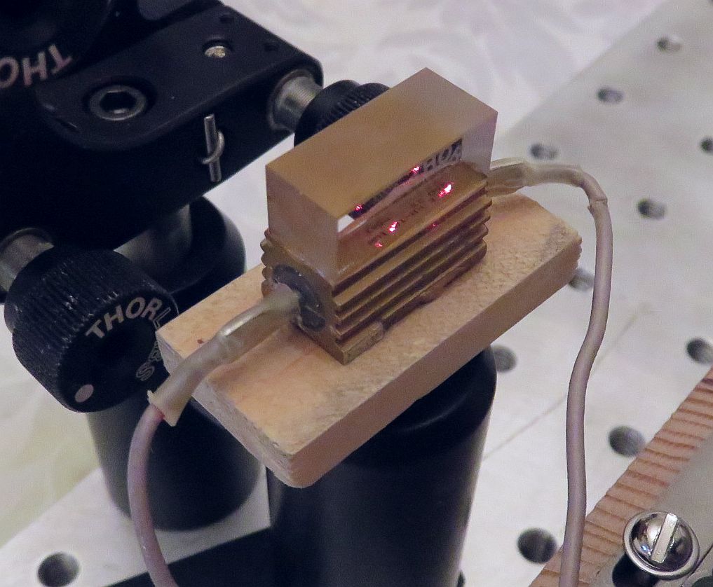

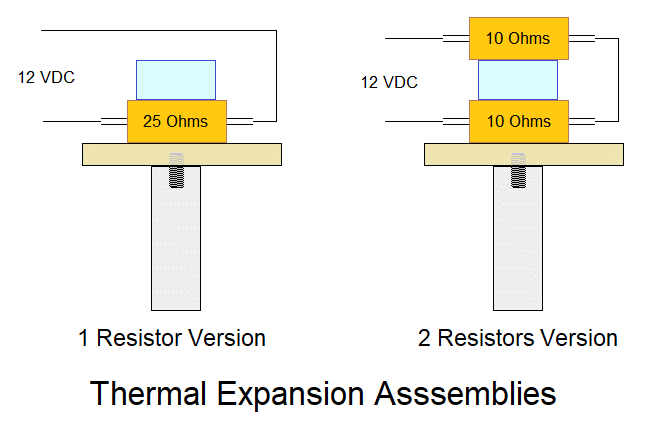

    Thermal Assembly Assembly:
    1. Thread the ~1x1-1/4x1/4" block with 8-32 stud into a Thorlabs post and install it in a post holder attached to the breadboard for convenience in mounting the other parts.
    2. Use a drop of Epoxy to secure the 25 ohm 5 watt resistor to the block using one of its flat faces. Wait at least 15 minutes for the Epoxy to cure.
    3. Use a drop of Epoxy to secure a long frosted surface of the compensator plate to the top (labeled side) of the power resistor. Wait at least 15 minutes for the Epoxy to cure.
    4. This assembly can then be installed in Arm 1 of the interferometer using a Thorlabs 1.5" post, post holder, and BA1S Holddown. Angle the broad polished faces of the compensator plate very slightly to avoid back-reflections into the beam paths.
    The 12 VDC power pack is used to do the heating. DO NOT use a 9 V battery, it won't last very long. The power into the resistor(s) is 12*12/R - 5.76 watts for the 25 ohm resistor.
    The Coefficient of Thermal Expansion (CTE) for optical glass is around 8x10-6/°C. (It varies slightly depending on the specific type, which is not known for the compensator block.) That means a 1 °C change in temperature will result in its length changing by 8 ppm (parts per million or 0.000008 x its length). Assume that the index of refraction of optical glass, ng, is approximately 1.5. (Again not precisely known .) Calculate the expected number of full cycles from the detector for a 10 °C change in block temperature. Don't forget that it's the net change in PLD that matters.
    Monitor the signal using your choice of method as the block heats or cools and use the results above to estimate the temperature of the glass block based on its length. Without actually knowing the temperature of the block throughout its volume, and knowing it actual CTE and ng. it is not possible to be precise. That's OK.
    The effect will not be as dramatic as with the GCC, above, but with care, should be easily detectable.
    CAUTION: Do NOT leave the resistors plugged into the power pack continuously for too long as bad things may happen.
    What else may be impacting the PLD change besides the block itself? For example, is there any detectable response to the heating if the block is rotated and/or offset so it just misses both beams?

    Original Michelson Interferometer (BMI)
    This is identical to the original except that it uses the polarized laser and PBS cube as the beam-splitter. But note that the PBS passes and reflects the X (parallel to the baseplate) and Y (orthogonal to the baseplate) polarized components and they retrace their steps on the return journey. Thus a Non-Polarizing Beam-Splitter (NPBS) must be inserted to pick off both of them before passing through the linear polarizer at 45 degrees to combine them for the detector. The NPBS can be the variable Attenuator Plate (AP) that is part of the quadrature decoder, but mounting it and determination of the optimal attenuation is left as an exercise for the student.
    No Retro-Reflector Plane Mirror Interferometer (NRRPMI)
    The PMI is probably the most common of the interferometers that use a planar mirror.
    Single Beam Interferometer (SBI)

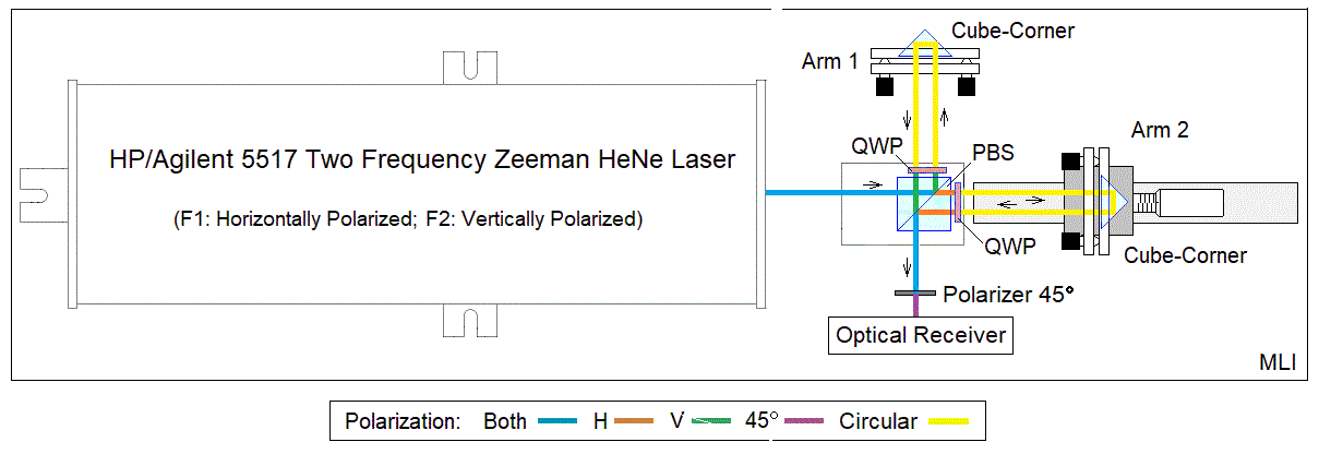

    Modified Linear Interferometer (MLI)
    The MLI adds a pair of QWPs to direct the beam to the detector out the side of the PBSC and is achitecturally similar to the SBI but with offset beam paths that have two additional advantages: (1) retro-reflections back to the laser are reduced further and (2) the beams don't hit the apex or edges of the cube corner trihedral prisms. However, only under very specific cercumstances would the additional cost of the QWPs likely be justified.

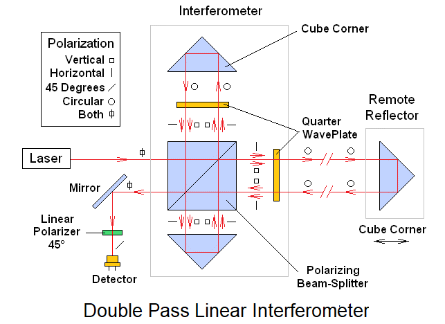

    Double Pass Linear Interferometer (DPLI)
    The remote reflector is a cube corner which is better for long distances yet it has double the resolution of the normal LI, the same as the PMI.
    High Resolution Plane Mirror Interferometer (HRPMI)
    This doubles the resolution over the PMI or HSPMI. The HRPMI is also high stability because the two beam paths have the same length through the optics, and a PLD of 0 if the distance in Arm 1 and Arm 2 are the matched. This will be much more complex to align and will require a few additional parts and a lot of determination. ;-)
    The HRPMI is essentially an HSPMI in which instead of the return beam going to the detector, it is reflected back into the interferometer, but offset in position by an additional cube corner and traverses all of the optics a second time. So instead of 2 passes, it becomes 4 passes, and the losses will more than double reducing the signal level significantly. In principle, this could be extended to 6 or more passes using a similar approach, but as you will undoubtedly see if you're crazy enough to attempt to implement the HRPMI, it's already tough enough to align.
    The HRPMI setup requires some additional optics (another turning mirror and adjustable mount for an unmounted cube corner). The laser may also need to be positioned further to the left to make space. The only way to really test it without a measurement display would be with one of the methods of fine tuning path length - loudspeaker, PZT, air pressure, tmperature, etc. The micrometer stage will simply not have fine enough control to reliably detect a difference between X1 or X4. Thus the setup is shown with the loudspeaker.

    For interferometers requiring QWPs like the PMI and HSPMI, HP 10722As may show up on eBay at reasonable prices. As an alternative, I have a limited number of 1/2" optical grade mica QwPs which have been tested to work well. These are very fragile so they would need to be attached directly to the PBSs with index-matching cement (5 minute Epoxy may also be suitable), to a plate with holes for the beams, or to plastic or metal washers. Two of these would be required to substitute for each 10722A.
    As partial confirmation, a test was done replacing the CC and 10722As of the HSPMI (but using a 10702A PBS since I don't yet have a generic 1" PBBS). The CC and QWPs were glued to HP alignment plates that attach to the PBSC with magnetic strips as can be seen below:
    HSPMI using 10702A PBSC with a Generic CC and Generic QWPs
    It does work. However, as expected, the signal amplitude is down by more than 65%. This is probably mostly due to the 16 traversals of the uncoated surfaces of the QWPs, followed by 4 traversals of the uncoated surfaces of the CC and 6 reflections from their internal silver-coated surfaces. But there are likely also contributions from not quite accurate 45 degree QWP orientation and less than perfect QWP 90 degree retardation. But the QWPs are mostly responsible for the decrease in signal level, so AR-coated QWPs would help a lot. It's *only* 8 passes but through 16 surfaces.
    The HSPMI is the most complex of the common interferometers; The LI is trivial in comparison with only a single CC. While tests have not been performed with a generic CC attached to the PBSC in an LI, it is expected that the only effect would be a reduction in signal amplitude of around 9 percent due to the slightly lower efficiency of the generic CC of around 0.86 compared to 0.90 for each pass compared to one from HP.

    DIY Two Frequency Zeeman HeNe Frequency Laser
    This diagram shows the most common implementation of a two frequency HeNe laser, which is based on Zeeman splitting.
    Where a random polarized HeNe laser tube meets certain requirements, applying an axial magnetic field will result in the normal single longitudinal mode splitting into two components that are left and right circular polarized, which are converted to orthogonal linear polarization with a QWP. It turns out that many of the HeNe laser tubes that used to be used in 100s of thousands of supermarket checkout barcode scanners satisfy these requirements, and the laser tube found in a $10,000 metrology laser is essentially the same. ;-) Stabilization is then similar to that of SF laser, above, and a kit is also available. Since the SF and TF lasers are very similar, it may be possible to use the same tube and controller. But while a homodyne interferometer can work using an unstabilized laser with restrictions on PLD, a two frequency Zeeman HeNe must be stabilized because the beat frequency actually appears for only a portion of mode sweep. So it must be locked to the center of that range.
    Kits are available to construct stabilized Zeeman HeNe lasers that would perform well for use with the interferometer. They include a bare HeNe laser tube, power supply, heater, magnets, optional parts to construct an Arduino-based controller, and more. So if you really want to be able to claim that this was built from parts closer to stone tools and bear skins than HP/Agilent lasers, see the manual at: Stabilized Zeeman HeNe Laser Kit 1 with or without Arduino.

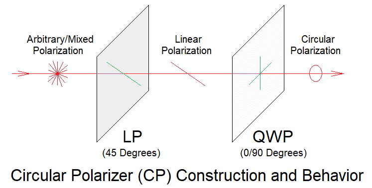

    Three types of optics that affect the polarization are used in various parts of the interferometer:
    Some specific applications:
    And as a point of interest CPs are used in front of LCD displays to increase their contrast under ambient illumination: With the LP side toward the viewer, ambient light will pass through it and the QWP, and be reflected by the display itself. But when CP light is reflected, the "handedness" flips and the result is linear polarization at 90 degrees to what it was originally, and thus blocked by the LP. That is part of the reason your smart phone screen looks dark when nothing is displayed on it.
    However, while circular polarizers intended for use with cameras are constructed as shown above, the "polarizing films" sold for smart phones and the like may or may not be true CPs. Some are just linear polarizers or linear polarizers coated with a weak neutral density filter. And it's not clear how one can select the proper type since the sellers are typically clueless. The only actual CPs consistent with the above diagram I've found so far were listed as something like: "New Backlit Screen Modify Part Polarizing film For GBA GBC GBA SP N_ES". Those listed as "LCD Polarizer Film Polarization film Polarized Light Film For ip.ccHHH" may also be CPs but with (1) the adhesive and non-adhesive sides swapped and (2) the axes of the LP and QWP rotated 45 degrees. They may also have a weak ND filter. Sometime a faint colored line can be seen which is at the orientation of the LP or 90 degrees from it. But that doesn't help with whether there is a QWP, though sometimes there are also a series of small circles, presumably to indicate CP, though they tend to be on the opposite side from the QWP. Those listed specifically for iPhones were of the simple LP type (usually with a faint line at 90 degrees to the LP axis parallel to the short side). Interestingly though, the protective film that normally gets discarded is birefringent and may even be a QWP. Which of course makes little sense. :( :) Confused yet? I sure am. :( :)
    This same scheme is also used in what is sometimes called a "poor man's optical isolator", whose purpose is to minimize back-reflections from an optical setup into the laser, which may destabilize it or worse. The combination of a linear polarizer (or PBSC) and QWP acts as a "diode" for polarized light. It's called "poor man's" because it is much less expensive than a Faraday isolator, and adequate for many purposes. But for it to work well, any reflective surfaces in the optical setup must not mess with the polarizaton.
    The piece of CP provided in these kits is intended for such an application. It can be cut into smaller pieces since they only need to be slightly larger than the beam, which even if expanded is only ~4 mm. As noted shown in the diagram above, the optical axes of the QWP are at 0 degrees with respect to the edges of the CP and the axis of the LP is at 45 degrees.

    Adjusting the Motion Control Platform
    Since the two types of MCPs used here are not exactly super high precision $20,000 parts :), they may suffer from a couple of maladies that can usually be largely corrected with minimal effort. One of these is detectable axial free play, which means that there will be a dead zone if an attempt is made to move the platform by a small amount. Free play is easily detected - the platform itself will move by a small amount if gently pushed back and forth. This may occur after awhile or even when new due to less than stellar quality control. Another issue is uneven torque required to rotate the screw to move the platform depending on where the platform is on the lead screw. It is usually possible to largely remedy both of these with small adjustments of the end-plates and the angle of the platform on the moving carriage. The following applies to both the small and large MCPs, but excessive axial free play is more likely to be an issue with the small ones:
    1. Move the platform to the motor-end of the rail by rotating the lead screw manually or with power applied temporarily to the DM320T controller using the Arduino MCP test sketch and encoder. If the lead screw appears to bind there and is more difficult to rotate or the platform gets stuck, loosen the two screws securing the motor and adjust the lateral position of the motor so that the rotation requires the least torque.
    2. Move the platform to the far end of the rail in a similar manner and repeat by adjusting the lateral position of the bearing end-plate.
    3. Move the platform to approximately the center of travel.
    4. Loosen the 4 screws securing the platform to the carriage and then set them so they are just snug.
    5. Gently twist the platform while testing the axial free play and set it so the free play is just barely detectable. Tighten the 4 screws and confirm that it hasn't changed. If the free play is set to exactly zero, then the the lead screw may be too tight. This is basically compensating for imprecise machine work in cutting the threads.
    6. Run the platform fron end-to-end using a low current setting of the DM320T (e.g., 0.3 or 0.5 A) to confirm it doesn't bind anywhere.
    7. Repeat all these steps as necessary to optimize.
    It still won't be a $20,000 rig but should be quite acceptable.
