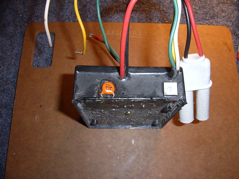

    I've recently come across a defective Melles Griot (made by Laser Drive) 05-LPM-370 power supply brick that was on its way to exploding with a noticeable bulge in the top surface. This was scary as that implied some significant pressure inside. It was being powered by a Variac (5 A fuse) into a stack of resistors (about 500K) and a 5 mW tube in an attempt to make it maintain a stable discharge (the tube was flashing). I don't know if a proper fuse would have blown though. :(
    An old Aerotech brick (unmarked, but one of the large long ones that typically run 10+ mW lasers) also may have developed a bulge while running a laser head that should have been compatible. While the bulge wasn't that severe, was only modestly warm to the touch, and *might* have been there all along, that's not normal and I didn't wait to find out if the thing would explode. :)

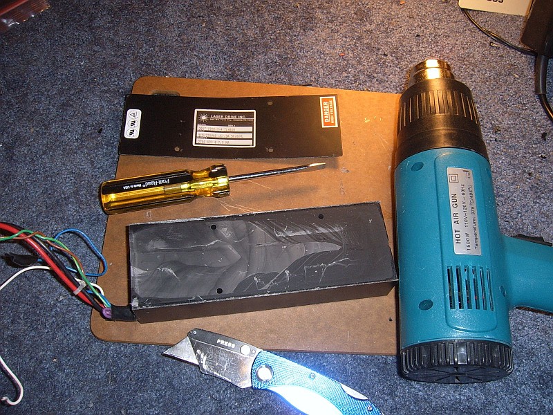

    I had a very nice Laser Drive 380T that failed in this manner when it was turned on with the output accidentally shorted. A 1 inch chunk of potting material flew off as a result of two unidentified parts vaporizing inside. They may have been fusable or other resistors in series with the output of the voltage doubler at the front-end. I doubt that a fuse would have saved the power supply, but it might have prevented the blast.

    (From: James Sweet.)
    While generally considered to be completely un-repairable, I've found that it is possible to repair and even completely reverse engineer epoxy potted bricks using common tools and no nasty chemicals. To get started I would suggest having the following items on hand: Heat gun (the sort thing used to shrink heatshrink tubing, strip paint, thaw pipes, etc.), utility knife or box cutter, various flat blade screwdrivers, multimeter, soldering equipment, and the patience and curiosity of a cat. Other tools that are nice but not absolutely required include a set of dental picks, a putty knife, hot air pencil as used for surface mount rework, fine point permanent marker, magnifying lamp, bench vise, etc.
    Getting to the bottom of the PCB:
    The first step is to identify where the PCB is located. Usually the label is on the top but this is not always the case Look at the end of the brick where the wires exit. Normally the PCB will be on the long edge opposite of the wires. If the wires exit near the center look for a current adjust pot which will usually be mounted directly on the PCB. Failing that you will just have to start excavating carefully and see what you find, the PCB will be only a few mm from the surface of the epoxy as shown in Edge of HeNe Laser Power Supply Brick Showing Location of PCB and Components.
    There are three basic types of casings that I've encountered so far. The first is a molded plastic box where the PCB has been stuffed down in it and Epoxy resin poured in, filling the box up to the top. With these you will have to cut around the perimeter of the area you wish to expose. Once you have cut all the way around it, apply heat to soften the bond peel away the plastic layer. The result is shown in Bottom panel of HeNe Laser Power Supply Brick Removed. Take care not to use too much heat as many plastics will release stinky and probably toxic chemicals.
    Others have a molded top shell with a panel glued over the bottom after resin has been poured over the PCB. You may have to cut around the perimeter of this to separate the glue, then the panel can be removed to expose the Epoxy. Some will peel off fairly easily, others are very well attached and may require heat. I've found that a stiff putty knife with a sharp edge works well to separate these, starting from the edge where the wires exit.
    Lastly, my favorite type uses a separate panel made of thin glass Epoxy laminate similar to that used to make PCBs which are formed into a box around the PCB and filled with resin. These are nice because with some care the panels can be peeled away and glued back on after completing the repair, leaving a cosmetically nice result with little or no sign that it has been repaired. Apply heat and start to separate with a utility knife. Once it starts to come off, a putty knife can be used to finish the job. Don't get too carried away or you will break the panel and don't use *too* much heat or it will deform.
    Once the Epoxy is exposed comes the fun part. Apply heat to a small section, holding the heat gun an inch or so away for several seconds. Don't be afraid to use plenty of heat, but if it starts to smoke, stop! Quickly before the Epoxy cools, dig in gently with a screwdriver taking care not to gouge the PCB and damage traces. Once it starts to separate it's usually pretty easy to work the screwdriver under it and peel it up in sections. See Start of Removal of Potting Compound from Under PCB in HeNe Laser Power Supply Brick. If it starts to harden, apply heat for a few seconds and it will soften up again. You may wish to expose the entire PCB, but if you have a good idea of where the problem is located this may not be necessary. A complete Epoxy-ectomy is shown in Complete Removal of Potting Compound from Under PCB in HeNe Laser Power Supply Brick.
    Replacing defective parts:
    There are two options here in many cases. Depending on the layout and the nature of the failure, it may be possible to simply tack on a replacement component on the bottom of the PCB. If the defective part is shorted it will have to be isolated. This is easy on a single sided PCB but may be much more difficult if double sided.
    Personally I like to remove the defective part and replace it properly. If you are lucky and it's located near the edge of the PCB, you can excavate into the side and remove it. A hot air pencil is handy here, but a heat gun will work with some care. Scraps of cardboard, wood, or other material can be used to mask areas that you don't wish to melt. Heat the Epoxy to soften and start digging it out with small screwdrivers or picks. Go slowly and take care not to damage nearby components. If you can identify the nearby parts, it's worth measuring the value, otherwise you'll be looking at the mangled remains wishing you knew what it was. Once the repair is complete there are a number of options. It can be simply left exposed, but if it is in the high voltage section this may cause problems, these circuits were laid out assuming they would be potted in epoxy so spacing between adjacent components may not be adequate. Silicone caulk or Epoxy work well too, but make sure whatever you use is appropriate for high voltage. If in doubt, test it.
    CAUTION: The HV capacitors in the output section can hold a charge for a shockingly :( :) long time. Discharge them before touching!
