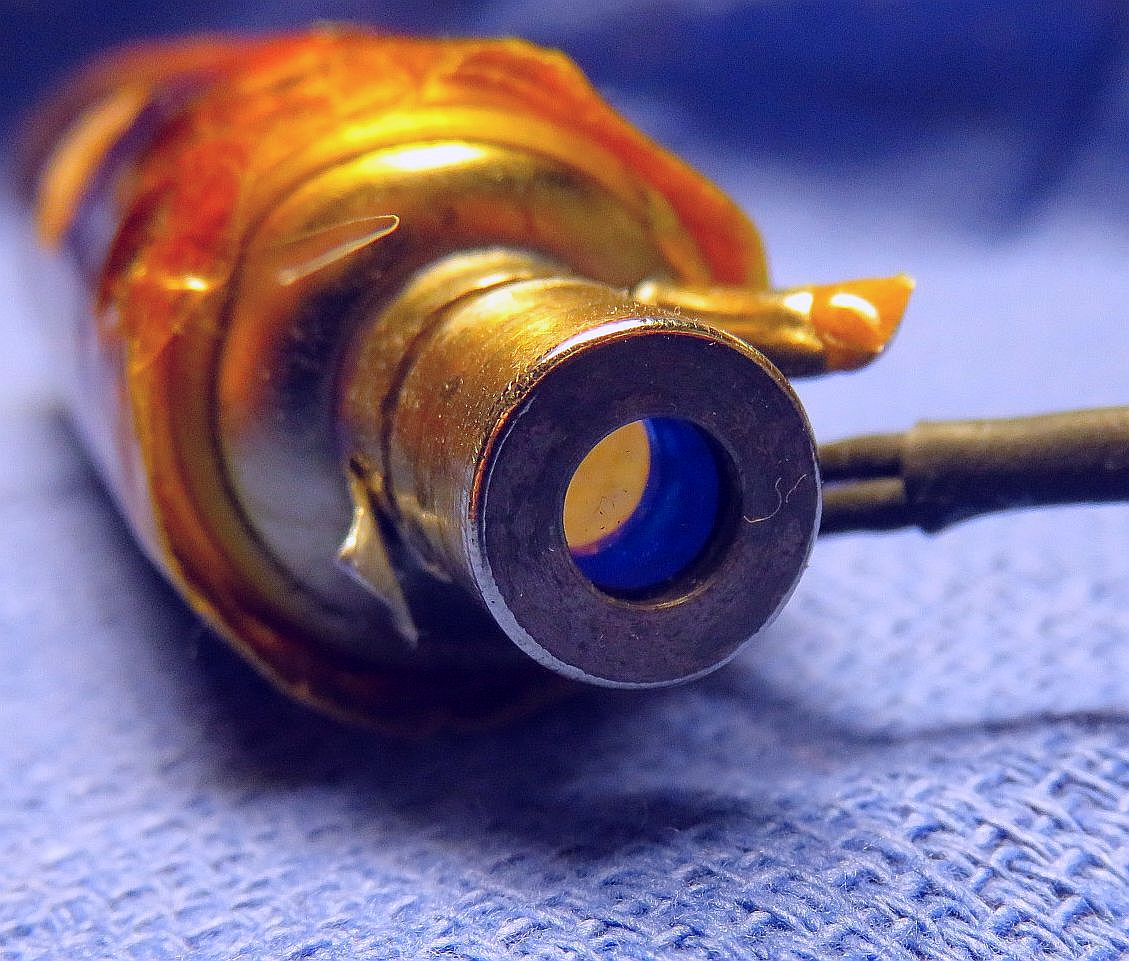

The main beam may emerge from either end of the tube depending on its design,
not necessarily the cathode-end as shown. (For most applications it doesn't
matter. However, when mounted in a laser head, it makes sense to put the
anode and high voltage at the opposite end from the output aperture both for
safety and to minimize the wiring length.) A much lower power beam will
likely emerge from the opposite end if it isn't covered - the 'totally
reflecting' mirror or 'High Reflector' (HR) doesn't quite have 100 percent
reflectivity (though it is close - usually better than 99.9%). Where both
mirrors are uncovered, you can tell which end the beam will come from without
powering the tube by observing the surfaces of the mirrors - the output-end
or 'Output Coupler' (OC) mirror will be Anti-Reflection (AR) coated like a
camera or binocular lens. The central portion (at least) of its surface will
have a dark coloration (probably blue or violet) and may even appear to vanish
unless viewed at an oblique angle.

Since the reflection peaks at a single wavelength, this type of mirror
actually appears quite transparent to other wavelengths of light. For
example, for common HeNe laser tubes, the mirrors transmit blue light quite
readily and appear blue when looking down the bore of an UNPOWERED (!!) tube.
Blue light from the electrical discharge will also pass out of the
mirrors as a diffuse glow when running. No, you don't have a blue HeNe
laser!

However, the shelf life of the tube depends on types of sealing method used
in the attachment of the optics. There are two types of internal mirror HeNe
tubes:
The frit is basically powdered low melting point glass mixed with a liquid
to permit it to be spread like soft puddy or painted on. The frit can be
fired at a low enough temperature that the mirror mount or glass mirror
itself is not damaged, there is virtually no distortion introduced by the
process, and manufacturing is greatly simplifed compared to using normal
(high temperature) glass or ceramic joints. Some tubes use frit seals at
other locations in addition to the mirrors (like the end-caps) rather than
glass-to-metal seals. The same process is used for other permanently sealed
tubes like those in internal mirror argon ion lasers as well as some xenon
flashlamps and similar devices.
Note that the electrical connections on those tubes that don't use the
mirror mounts will generally be glass-metal seals which do not leak.
Mirrors can't use glass-metal seals since they require high temperatures
to make which would distort or totally destroy the mirrors. You can tell
if a seal is frit or Epoxy by how easily it scratches: Frit is like glass
and requires something hard to make a mark while Epoxy can be scratched
with a good solid fingernail. Another way to tell is the color: Frit is
generally gray or tan while Epoxy is clear or white.
Should you care, the metal parts of the tube are likely made from Kovar, an
alloy commonly used with frit seals since there is a very good CTE
(Coefficient of Thermal Expansion) match of the Kovar to the frit glass.
CAUTION: The frit seal is thin and relatively fragile, even more so than
the fragile optical glass, so avoid placing any stress on the mirrors!
